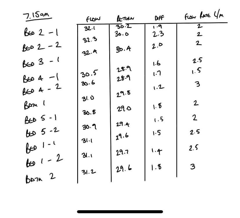

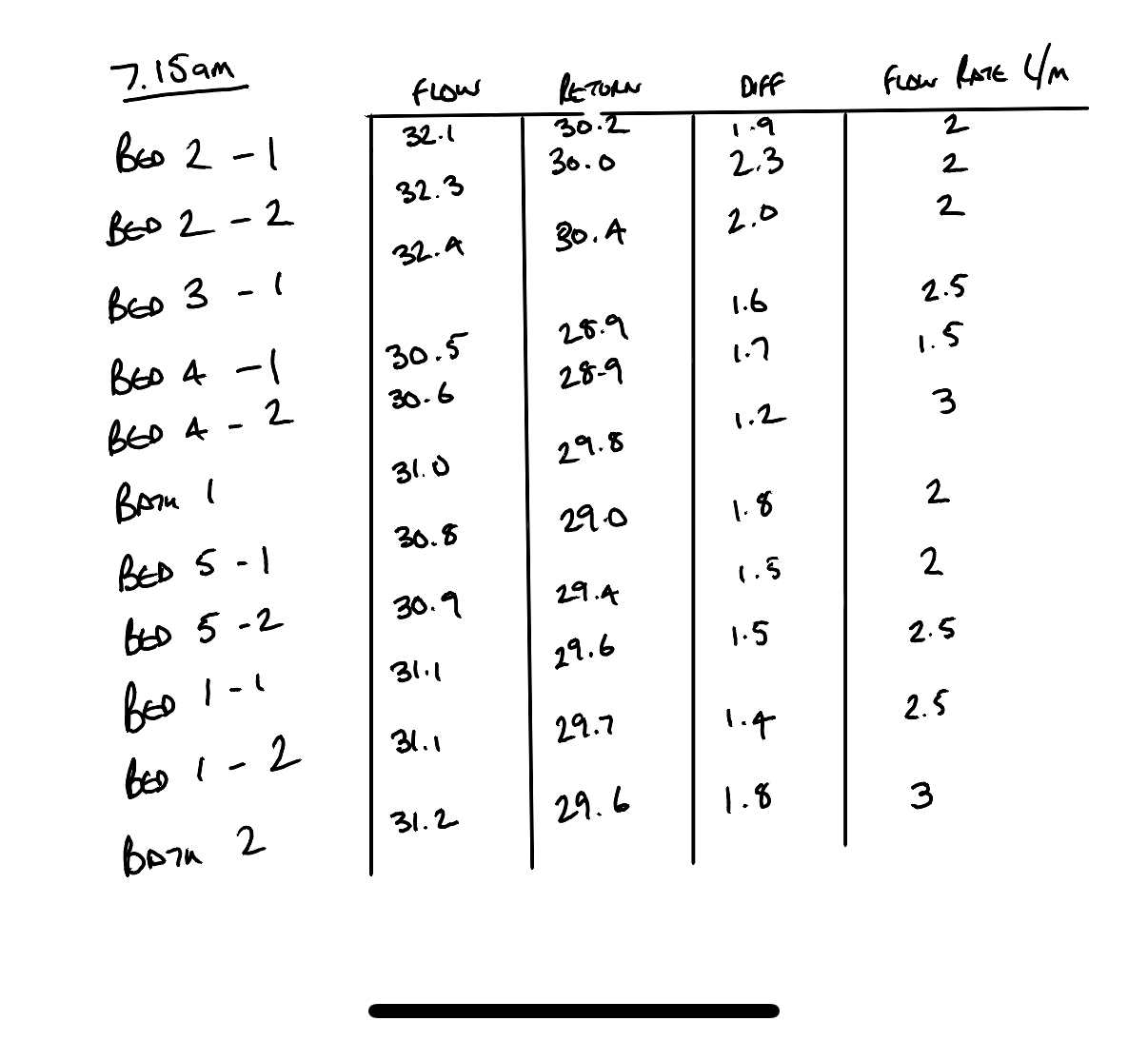

Yes I can understand the low dT, I checked the temps again this morning and loops ranged between 1-1.8 deg loss, but IR camera was bouncing around a little so hard to be super accurate
I will turn off the GF manifold again so the the pump just feeds the FF to see what flow rates I can achieve per loop.
currently the ASHP feeds a buffer tank and then pumped from there to both manifolds using a single pump.

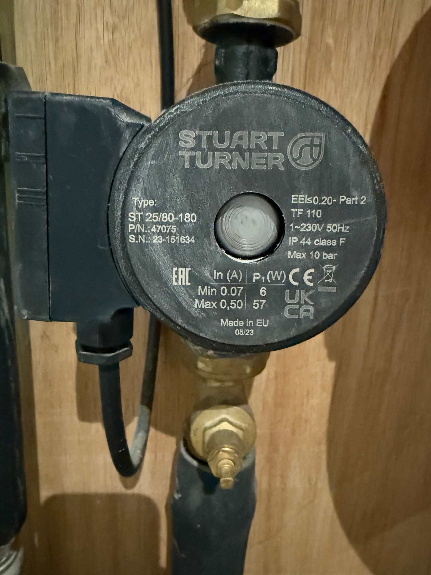

You might check the Stuart Turner circ pump mode&setting, it has three constant curve settings and three proportional pressure settings, ensure its on constant curve setting 3, if not sure of the modes, tahe a photo of the pump switch or LEDs while running.

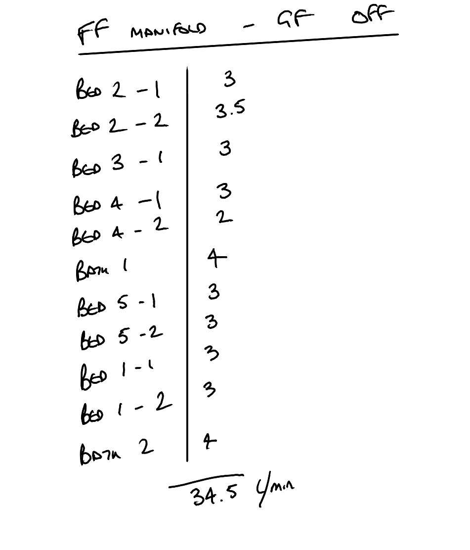

I just turned my GF manifold off and checked the flow rates of the FF one
Basically when the downstairs is on its looking approx 24/25
When the downstairs is off its about 35
Is that what people would expect?

Right after looking on the internet
My pump was on proportional power - medium (flashing green)
I have now changed this to constant power - highest power (constant orange)
Modern pumps are a real head fug - they are a bit to damn clever sometimes
My limited understanding is the faster the pump speed the smaller the delta between flow and return so you give the emitter more time to get rid of the heat (That's the impact in my house) but in your case where you are trying to get the emitter to give off more heat it may well prove effective - guess testing and monitoring are required
Having said that constant curve is what I settled on (mainly because the flow on proportional settings changed from when I first set the pump up to maybe a week or so later - some learning logic I think)
I will look into the pump settings shorty
Blimey 34.5 litres a min is 2070 litres per hour.... that feels like a heck of a lot of flow.
Changing the pump mode should result in  increased flow, interesting to see if it actually does.

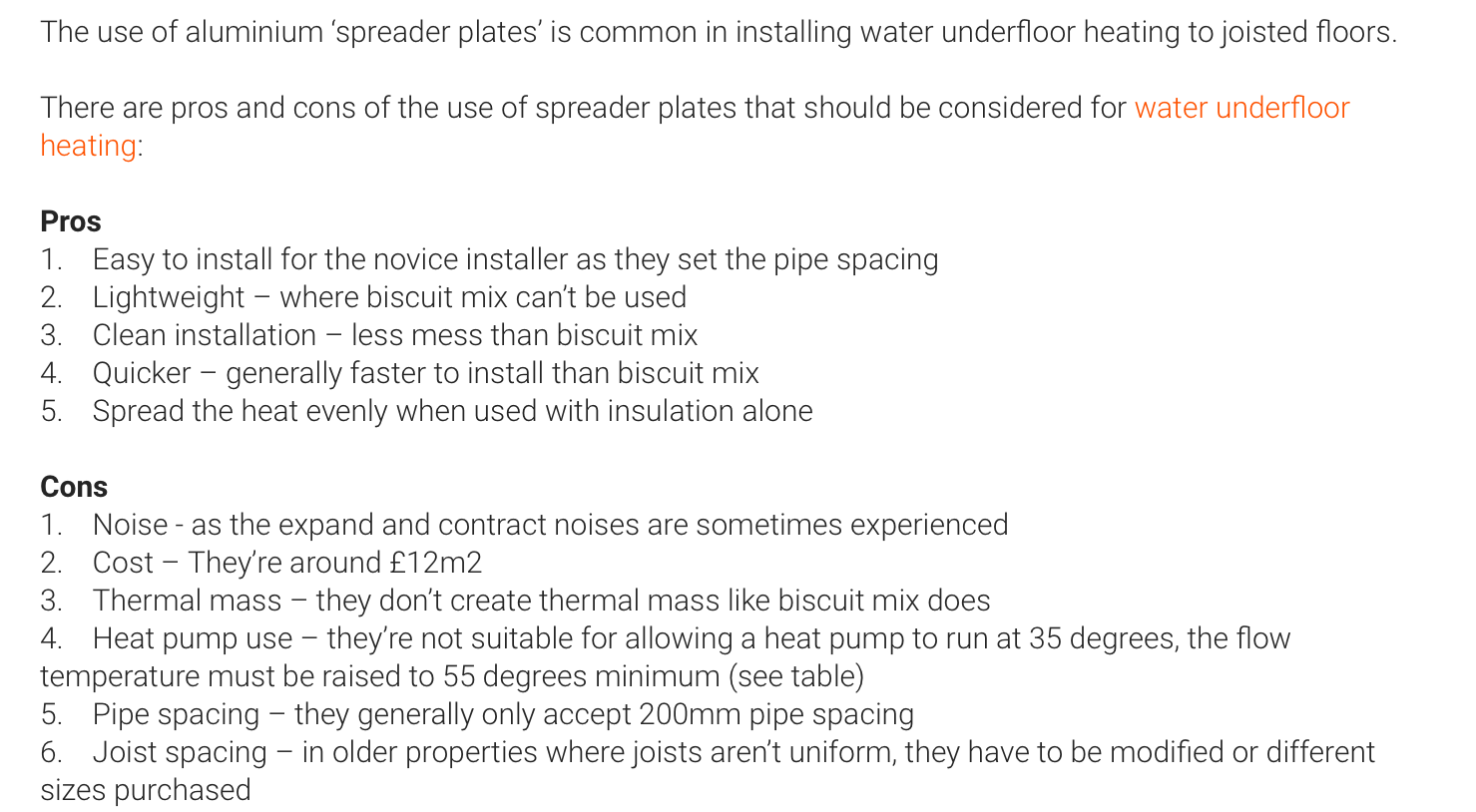

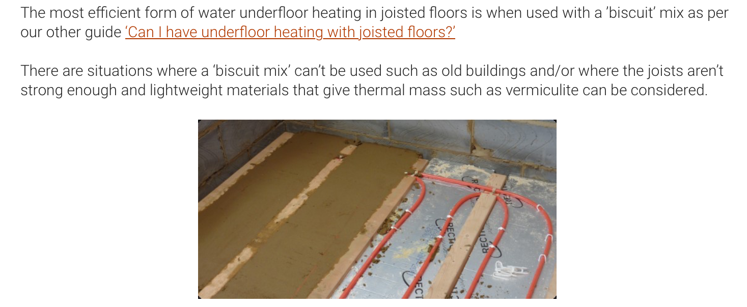

@richo106, I have not been following this thread, but I feel your pain now that the cold winter weather has arrived.
I’m not familiar with this approach or the design trade offs. I have no special knowledge about UFH installs. Just another amateur forum member.
This blog advocates against using aluminium spreader plates with ASHP. They say it will need flow temp as high as 55°C, not 35°C.
https://underfloorheating1.co.uk/blog/article/Water_Underfloor_Heating_and_Aluminium_Spreader_Plates?srsltid=AfmBOoositKuZ1fOjlxZgV8ygJwVgrd35zIhyDGKj6mPuA0uxoPp7vSo
The approach they advocate, might be a possible retro fit. But still a lot of work.
https://underfloorheating1.co.uk/blog/article/Can_I_have_underfloor_heating_with_joisted_floors?srsltid=AfmBOopQsQvvgP2zHQn6UMCldTzV5P6j8MawfYv3Le-SGh1CHtie8wYo
