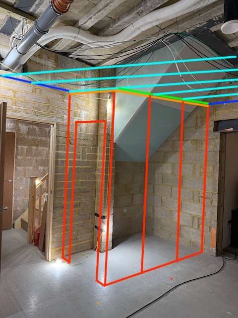

Thorfun Posted October 26, 2025 Posted October 26, 2025 afternoon all. firstly I've put this in the general joinery section as we don't have a metal frame section on the forum I could see! I know metal framing isn't joinery but I couldn't think of a better place to put it. anyway, winter is coming and I'm hanging up my golf clubs to do some more work on the basement. the room I'm working on has the under-the-stairs bit and I want to frame it out to make a cupboard. no big deal I think. but I am also needing to drop the ceiling by about 500mm so I can cover the soil pipe (the picture below tells the story). my concern is that the walls where I've coloured the lines orange won't have anything to fix to apart from a ceiling top-hat (in light blue). is that sufficient? also where do I attach the ceiling perimeter channel coloured green that will take the top hats to? I'm struggling to envision how it all works and if it will all be sturdy enough! we want to eventually hang a TV off the cupboard wall. can anyone put my mind at ease and tell me it'll be fine? also any advice for doing this sort of "free-standing"-ish wall and ceiling? I

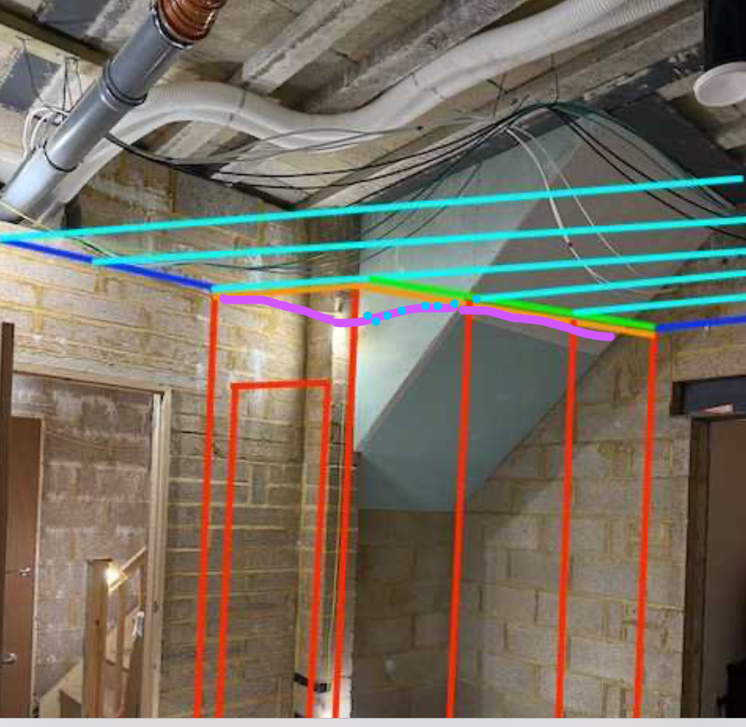

Nickfromwales Posted October 26, 2025 Posted October 26, 2025 Those two walls will act as buttresses to themselves, so once boarded they would stand alone with ease. I would firstly fly the ceiling (cyan lines) into the z shaped wall, purple, so you have more structure meeting the staircase and side wall to the door.

Thorfun Posted October 26, 2025 Author Posted October 26, 2025 2 minutes ago, Nickfromwales said: Those two walls will act as buttresses to themselves, so once boarded they would stand alone with ease. I would firstly fly the ceiling (cyan lines) into the z shaped wall, purple, so you have more structure meeting the staircase and side wall to the door. but the z-shaped purple line under the stairs' perimeter channel will be pointing at an angle down unless I can cut a piece of wood at the right angle to make the channel sit at 90deg?

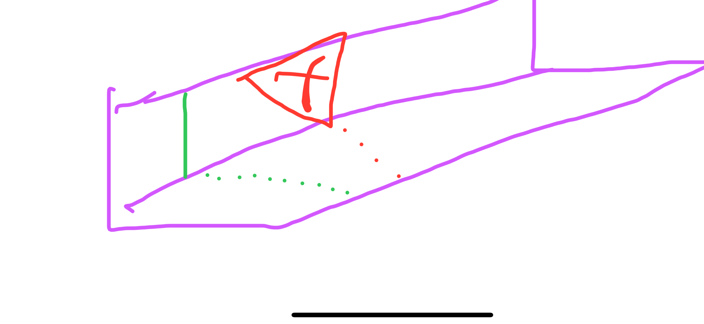

Nickfromwales Posted October 26, 2025 Posted October 26, 2025 14 minutes ago, Thorfun said: but the z-shaped purple line under the stairs' perimeter channel will be pointing at an angle down unless I can cut a piece of wood at the right angle to make the channel sit at 90deg? You just cut small off cuts and snip the middle, to make little ‘angle-adjustable’ brackets, to hold this firm. Fit it horizontal / flat from the right hand wall to the wall that returns to the side of the stairs, then install 3 or 4 of your home made brackets to take any wiggle up. Quicker and easier than fecking about shaping wood.
Thorfun Posted October 26, 2025 Author Posted October 26, 2025 13 minutes ago, Nickfromwales said: You just cut small off cuts and snip the middle, to make little ‘angle-adjustable’ brackets, to hold this firm. Fit it horizontal / flat from the right hand wall to the wall that returns to the side of the stairs, then install 3 or 4 of your home made brackets to take any wiggle up. Quicker and easier than fecking about shaping wood. Not sure I understand what you mean. 😢
Nickfromwales Posted October 26, 2025 Posted October 26, 2025 Get a bit of the wall / angle metal and cut about 100mm long. Cut out the red bit, bending along the red dotted line. Cut the green line, and bend that along the green dotted line by 90° to make an end return. Fix the bracket to the stairs sloping wall, then screw up through the flat section (that you don’t want to slope) into the tab created by the green fold. 3 of them, 2 of 200mm in from each side and one centred, will take out any twang. Red dotted line should have been parallel with the green one. Prob quicker if I fold 3 and post them to you lol. 1
Thorfun Posted October 26, 2025 Author Posted October 26, 2025 18 minutes ago, Nickfromwales said: Get a bit of the wall / angle metal and cut about 100mm long. Cut out the red bit, bending along the red dotted line. Cut the green line, and bend that along the green dotted line by 90° to make an end return. Fix the bracket to the stairs sloping wall, then screw up through the flat section (that you don’t want to slope) into the tab created by the green fold. 3 of them, 2 of 200mm in from each side and one centred, will take out any twang. Red dotted line should have been parallel with the green one. Prob quicker if I fold 3 and post them to you lol. thanks. next saturday when I'm doing the job I'll see if I can figure it out!
