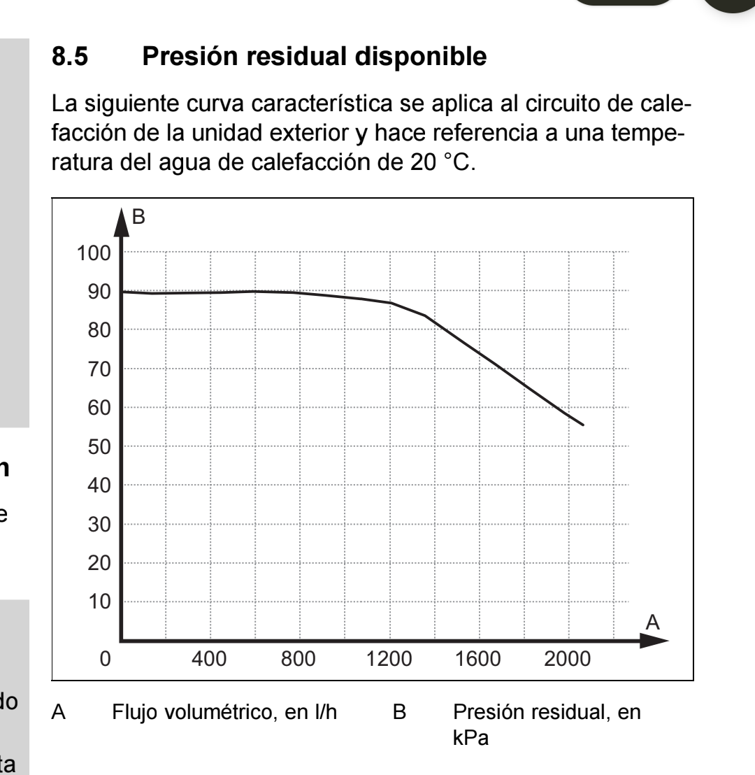

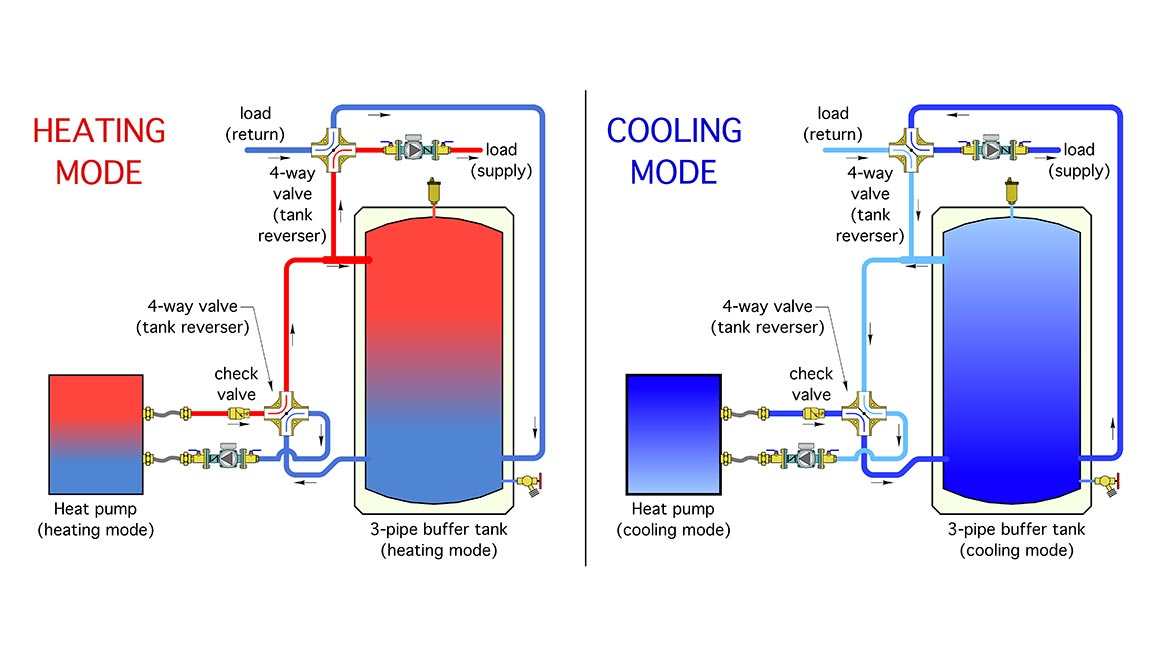

jamesdiyer Posted 17 hours ago Author Posted 17 hours ago (edited) Can somone point me to a post on how a true buffer tank would work. I'm assuming it just does it exactly the same way as it would without a buffer (running true WC) and then that heated water in the buffer is pushed around the circuit by a secondary pump and then is returned colder which retunes to heatpump. The inefficiency people talk about comes from lost heated water that's mixed in the buffer and secondary pumps. I'm still not sure we would hit the magical 2000l/h from just changing the primaries - it would be close and depend on what losses are incurred by the connections and 90s. At 1750l/h we have a pressure of 70kPa. I calculated the current primary as 11.5kPa and that reduces to 4.5kPa for 32mm internal. Being generous we come to 60kPa which moves is to 1900l/h. This does give a 11kW at delta 5C or 13 at 6. The 15kw machine is capable of 11.3kw at -7C for 45C - so having more flow doesn't seem needed, but perhaps I'm overlooking something. I'm inclined to think a simpler system the better. But maybe I'm making a mole hill and just re plumbing the volumizer we have as a buffer is just ok too. Shame this subject seems to be a bit of a (unnecessary) art and argument on what's best with different experts. Edited 17 hours ago by jamesdiyer
JohnMo Posted 16 hours ago Posted 16 hours ago 43 minutes ago, jamesdiyer said: Can somone point me to a post on how a true buffer tank would work Do a search on 2 port, 3 port and 4 port buffers on Google. If I was doing a buffer a big one only which you have. But would only do 2 port nothing else. This way a fully open system mostly flows around the buffer. A port buffer looks like this A video worth watching, talks 4 and 3 port a 2 port is a simplified 3 port
sharpener Posted 16 hours ago Posted 16 hours ago 1 hour ago, jamesdiyer said: Can somone point me to a post on how a true buffer tank would work. Think there is a useful article on the Caleffi web site.
SimC Posted 15 hours ago Posted 15 hours ago At 1750l/h we have a pressure of 70kPa. Where was the 70 kPa measured? If across just the pump, what was the pressure drop across the HP heat exchanger?
jamesdiyer Posted 14 hours ago Author Posted 14 hours ago (edited) 1 hour ago, SimC said: At 1750l/h we have a pressure of 70kPa. Where was the 70 kPa measured? If across just the pump, what was the pressure drop across the HP heat exchanger? Hi, maybe I've made a false assumption, but I read it from the pump graph from vaillant posted above. Flow rate l/h v Residual pressure kPa. Dies it not work like this? If we have flow of X at pump running 100% then it's working against pressure Y? Edited 14 hours ago by jamesdiyer
JamesPa Posted 12 hours ago Posted 12 hours ago (edited) 5 hours ago, jamesdiyer said: The inefficiency people talk about comes from lost heated water that's mixed in the buffer and secondary pumps Nearly. The loss of efficiency comes from the liklihood that cool return water is mixed with warm flow water thus reducing the flow temp to emitters relative to the ft from the heat pump. Since the flow temp to emitters governs their output, you need to increase the ft from the heat pump to compensate. The cop of a heat pump reduces with increased ft hence loss of overall cop. It an be made to work with little or no loss, but for that the water in the buffer needs to be properly stratified, which has implications for buffer design and size, and the pump rates also need to be controlled. This (it seems) almost never happens presumably because the people who know how to do it properly also know how to design out a buffer in almost all domestic situations. The typical dumpy 50l buffer is unlikely to have any material stratification. Edited 12 hours ago by JamesPa 1
SimC Posted 11 hours ago Posted 11 hours ago 2 hours ago, jamesdiyer said: Hi, maybe I've made a false assumption, but I read it from the pump graph from vaillant posted above. Flow rate l/h v Residual pressure kPa. Dies it not work like this? If we have flow of X at pump running 100% then it's working against pressure Y? Assuming the pump is performing correctly at 100% speed, yes you can use the chart to lookup the reported flow value to determine the pressure generated by the pump. I would have expected the Vaillant technician to have measured the pressure drop of the HP heat exchanger, or at least the residual pressure difference between the flow and return connections to the HP unit with the pump running. The 70 kPa developed by the pump is all lost across the whole circuit including the HP heat exchanger, so if the heat exchanger loss is say 25 kPa then only 45 kPa is available to generate the required flow in your heating pipes and emitter system. The published Vaillant manual should at least provide the expected HP HEX pressure drop at design flow rate, and the residual pump pressure for your system. My work involves interacting with air and water balance specialists usually in commercial buildings who validate by measurement with calibrated instruments that a system is performing as per the design criteria. By just relying on a unit display value, and not by seperate measurement, Vaillant have not proved that their unit including pump is actually performing to specification. Obviously you have also highlighted concerns with sections of the distribution pipework sizing, that should also be resolved to improve the resulting flow rate when heating, but you could be chasing your tail if it turns out there is an issue with the pump not actually generating 70 kPa pressure.
jamesdiyer Posted 5 hours ago Author Posted 5 hours ago (edited) 6 hours ago, JamesPa said: Nearly. The loss of efficiency comes from the liklihood that cool return water is mixed with warm flow water thus reducing the flow temp to emitters relative to the ft from the heat pump. Since the flow temp to emitters governs their output, you need to increase the ft from the heat pump to compensate. The cop of a heat pump reduces with increased ft hence loss of overall cop. It an be made to work with little or no loss, but for that the water in the buffer needs to be properly stratified, which has implications for buffer design and size, and the pump rates also need to be controlled. This (it seems) almost never happens presumably because the people who know how to do it properly also know how to design out a buffer in almost all domestic situations. The typical dumpy 50l buffer is unlikely to have any material stratification. Thanks for the explanation. And yes it seems a buffer was initially specified here, because it just makes up for other inadequacies in planned inital install. Edited 5 hours ago by jamesdiyer
jamesdiyer Posted 5 hours ago Author Posted 5 hours ago 6 hours ago, SimC said: Assuming the pump is performing correctly at 100% speed, yes you can use the chart to lookup the reported flow value to determine the pressure generated by the pump. I would have expected the Vaillant technician to have measured the pressure drop of the HP heat exchanger, or at least the residual pressure difference between the flow and return connections to the HP unit with the pump running. The 70 kPa developed by the pump is all lost across the whole circuit including the HP heat exchanger, so if the heat exchanger loss is say 25 kPa then only 45 kPa is available to generate the required flow in your heating pipes and emitter system. The published Vaillant manual should at least provide the expected HP HEX pressure drop at design flow rate, and the residual pump pressure for your system. My work involves interacting with air and water balance specialists usually in commercial buildings who validate by measurement with calibrated instruments that a system is performing as per the design criteria. By just relying on a unit display value, and not by seperate measurement, Vaillant have not proved that their unit including pump is actually performing to specification. Obviously you have also highlighted concerns with sections of the distribution pipework sizing, that should also be resolved to improve the resulting flow rate when heating, but you could be chasing your tail if it turns out there is an issue with the pump not actually generating 70 kPa pressure. Thanks for the explanation. That's interesting. The graph, which I didn't copy well I re attach. It is 'residual.pressure available'. Page 39 here https://www.vaillant.es/product-images/0020326641-03.pdf.pdf Let me have a think about your point, though I think it would be a case of pushing vaillant to confirm that, after having changed piping. I'm just concerned about pushing the installer to change piping, but not for a buffer, and then still not hitting this magic flow rate. And then having the fit a buffer still, or just not fitting a buffer if we hit a flow rate I deem ok.
