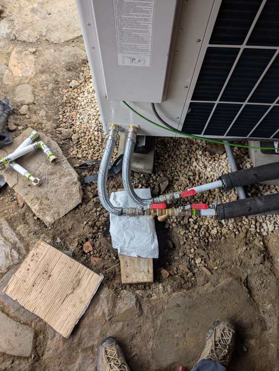

I've had a 15kw vaillant aerotherm plus installed. I'm getting a flow rate of 1700l/h, pump set to 100%. Volumiser of 100L, no buffer. Only machine pump. Manual says max flow is 2050l/h.
I'm trying to determine if this is enough/acceptable.
We have a heat loss off about 10kw at -7C. Unit does 12kw at -7.

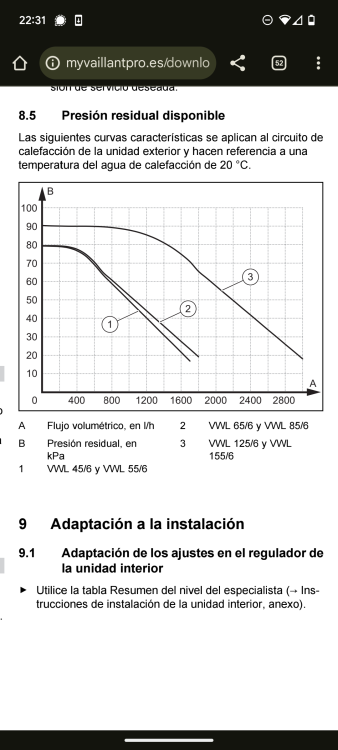

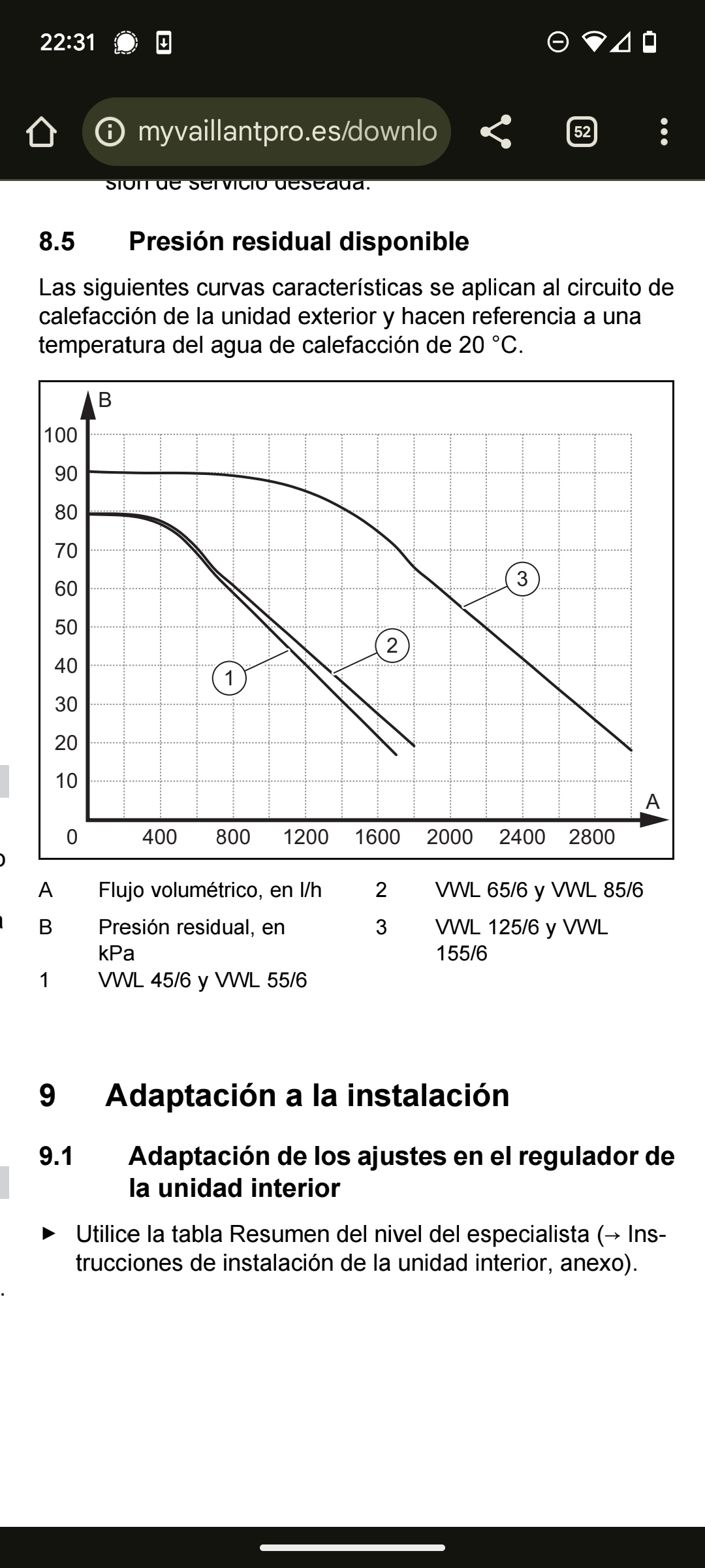

Here is pump curve. Number 3, VWL155/6

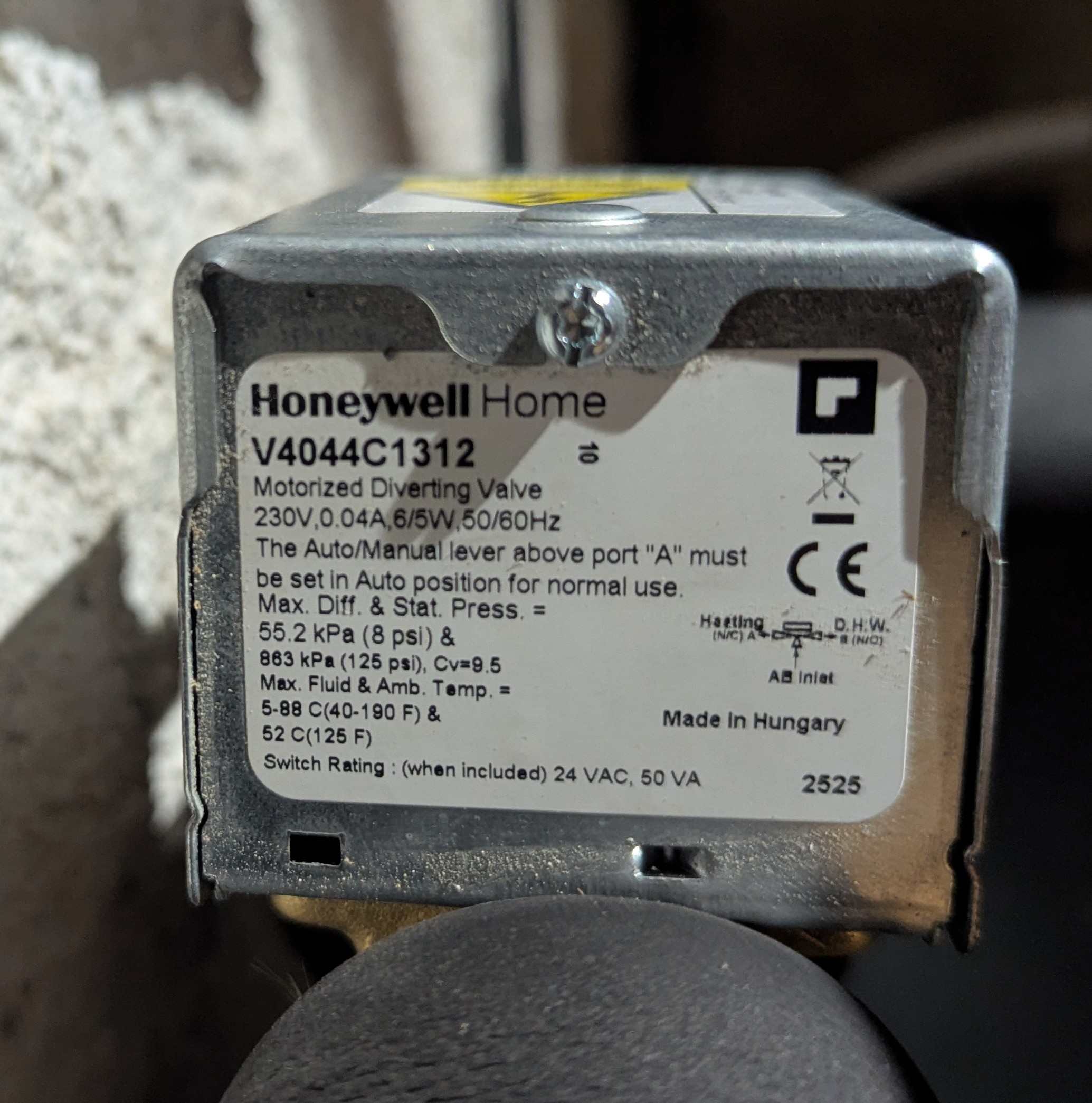

This is the 3 way diverter. Is the cv value the K? And this its 9.5?

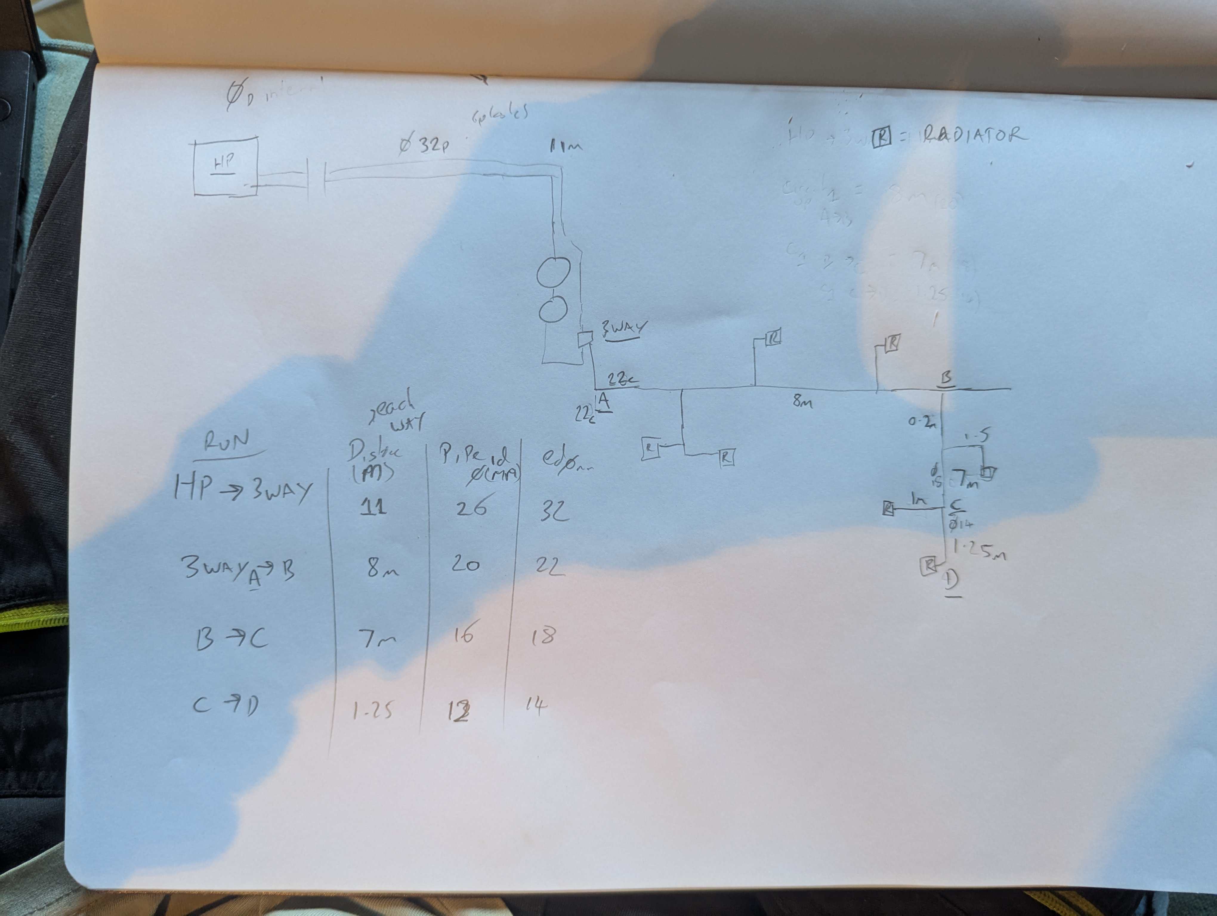

This is my rough circuit sketch of what I believe to be the index radiator, a point D.
Edited by jamesdiyer
What the two circles, one must be your cylinder what is the other. How does the return piping from the heating interact with the two circles as you only have return pipe from the two circles?

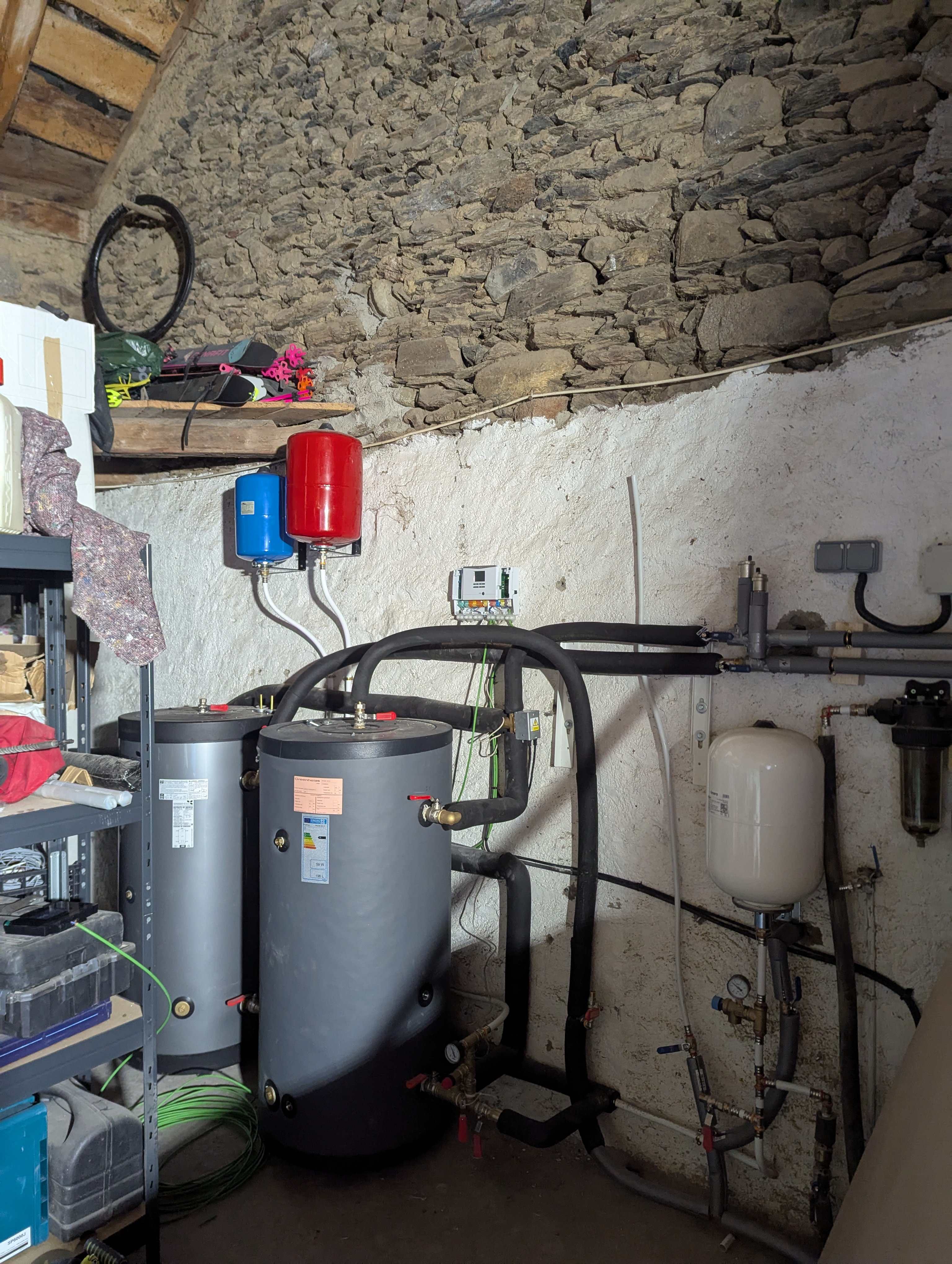

Sorry, I did say rough and I meant it. Good question.
One tank is DHW, the other is a 100L volumiser, plumbed on the return leg to the ASHP, radiator pipe in at top of tank, exit to ashp at bottom.
DHW right, volumizer left.
The issue with volumiser plumbed as is, (if I have understood correctly) during DHW heating cycle, you are also having to heat an extra 100L of water every DHW heat cycle.
You ideally have the volumiser in the central heating return only and tee in the DHW cylinder return after the volumiser.
Okay thanks for the suggestion. This wouldn't have an effect on heating circuit or overall flow though no?
No - no affect on ultimate flow rates through system just energy usage.

It seems the k of that honeywell diverter is 8. So this might be something to look at changing. And check the filter as said.

I would have as last on my list of things to improve. A kvs of 8 means it will flow 8m³h of water with a 1bar pressure drop. A kvs of 10 will leave the valve hydraulically invisible at heating flow rates even with glycol (you don't have). 8 is near enough.
