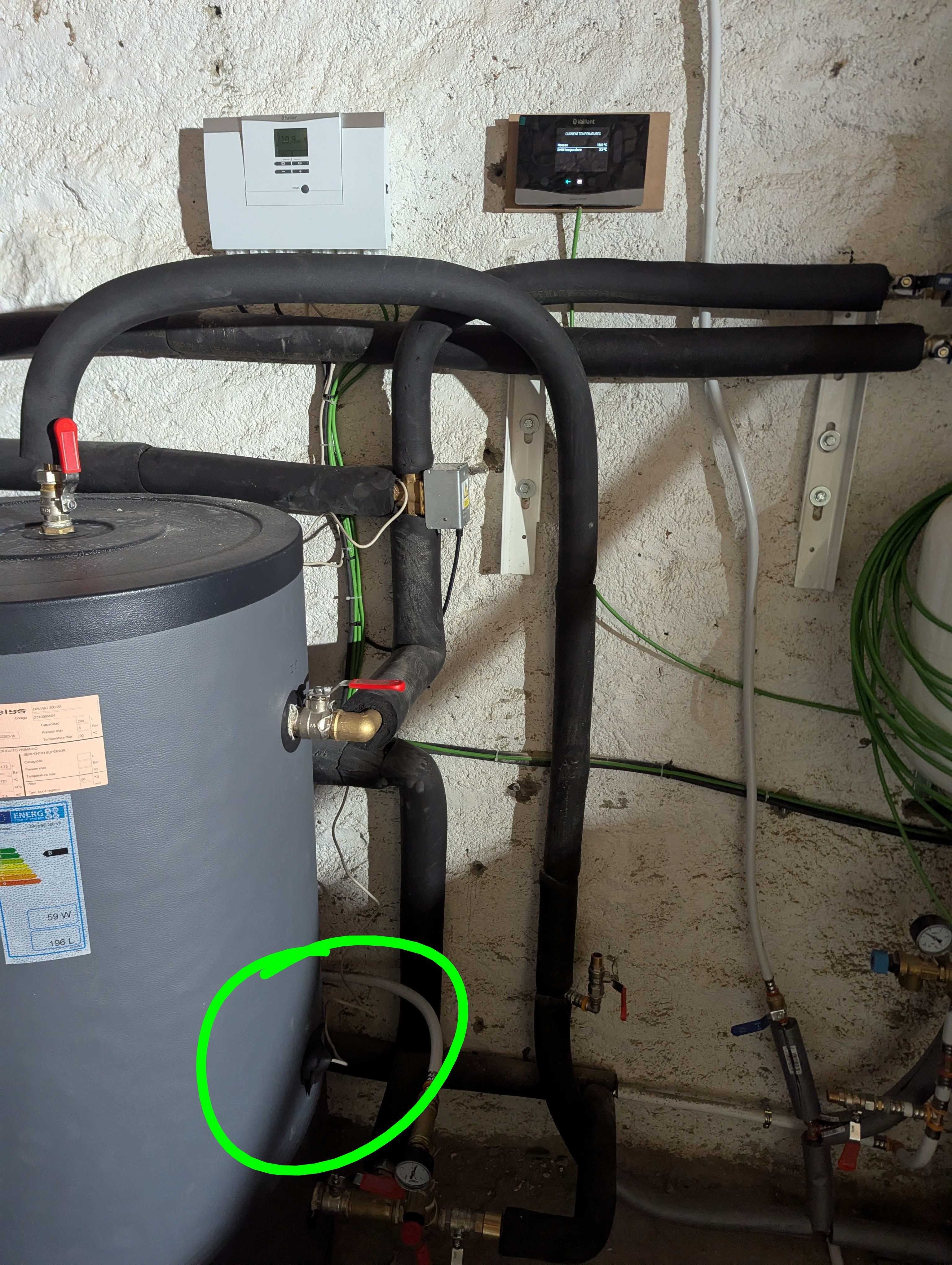

Also the DHW is reading 23C as the sensor is quite low down, as on photo. Maybe this needs be higher. Or mains water arrives around 12C. The tank isn't 23C as it's coming out nice and hot. Suggestions on this one and where it should be would be helpful.
Fairly normal.  DHW manufacturers assume people want something close to a full tank or at least half a tank and locate sensors accordingly.  Putting it at the top would mean that reheat is triggered only when its empty, meaning that there is a period when DHW is unavailable, which the majority of punters will complain about.  Just adjust your schedule/hysterisis to get what you are comfortable with

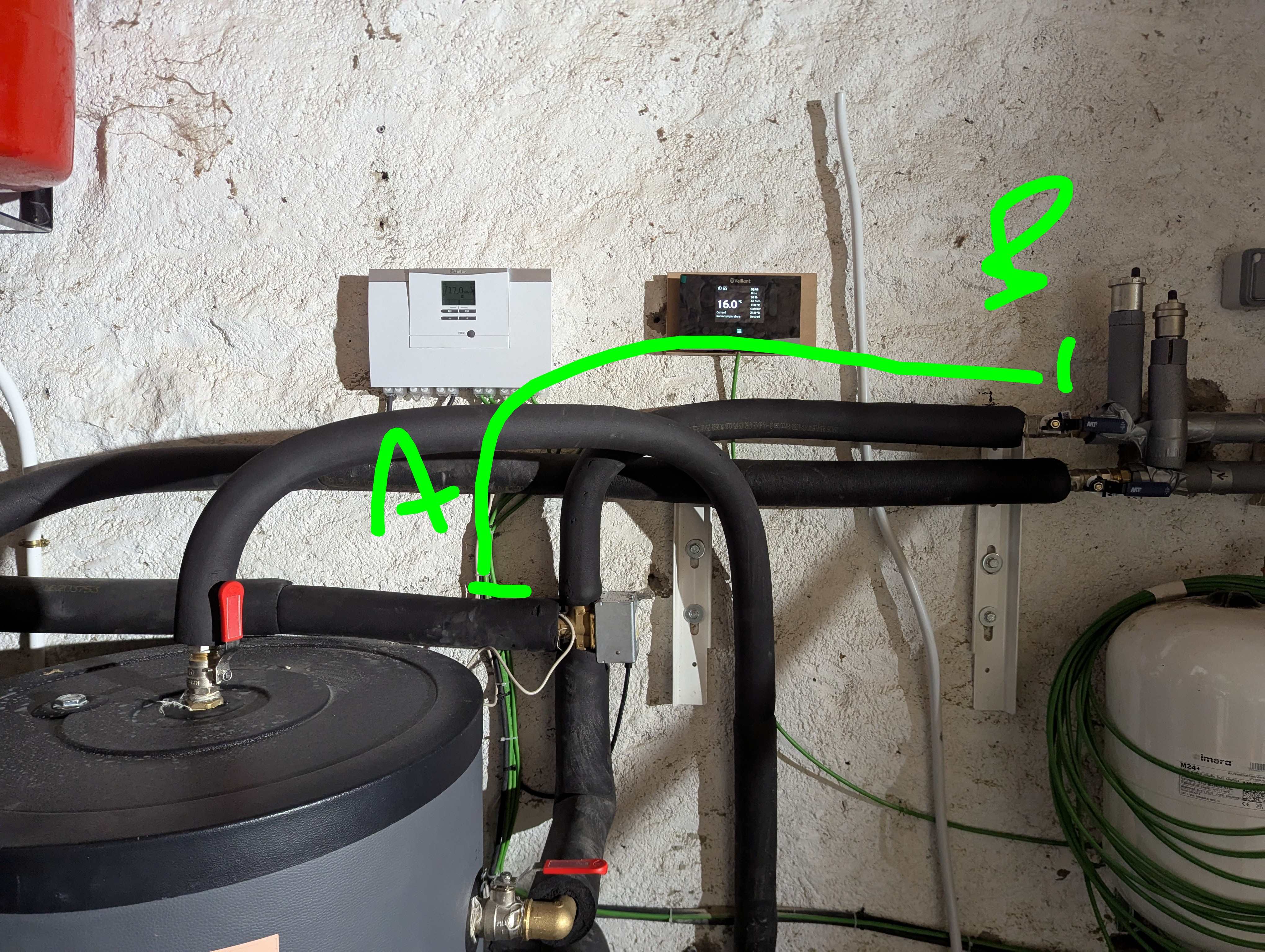

Another question.
I noticed the flow return pipe between the 3way valve / volumiser and radiator input is done in 25mm plastic, so 20mm internal. It's about 3m of pipe overall. From A to B. After point B, the copper pipe splits immediately into two 22mm coppers one for upstairs on for down, so it is a restriction.
The pipe between diverter is 32mm external. If on DHW cycle we get 2000l/h but 1700l/h heating circuit.
Could this short stretch of reduced pipe be reducing flow so much? Before I ask installer to change.

Possibly.  1700l/h is a bit low for 12kW (12000/4200/5*3600)=2000l/h.  I would describe this as sloppy plumbing.
Why is what appears to be the sensocomfort in what appears to be the plant room/garage.  This should be in your house so the heat pump knows the OAT and control the heat pump.  Its normally wireless so you can put it somewhere convenient.  Maybe Ive misinterpreted the photo.  I hope you arent using third party controls/thermostats.

The sensor comfort is there temporarily, it's wired and I couldn't decide where to put it - walls are 80cm think. I'm running pure weather compensation.
Yes your comment alludes to my first question, I felt 1700l/h is low - and I have a 15kw machine. But others here said running 32mm external 26mm internal plastic pipe over 11m isn't enough bore.

What the plumber has done with the plastic pipe is just lazy.  It's the 'never time to do it right, always time to do it twice mentality'.

Just a random thought from me - those valves are full bore ones and not the restrictive types?

Good question. The red ones yes. The blue ones on the heating pipes should have come out during the install but we're left. They were only placed there so I could pressurise the system prior to installer coming to check some repairing I'd done was fine. So they'll come out when he's back.

Actually looking the part manual they seem to be full bore and they're 1" so 22 internal but will know when off.
If we're talking restrictions, then the plastic 25mm pipe fittings are internal of that. The pipe id is 20 and so you're looking at 15mm inside of the fitting id. But that's a very tiny distance, so I'm not sure it matters? (Everything matters in totality)

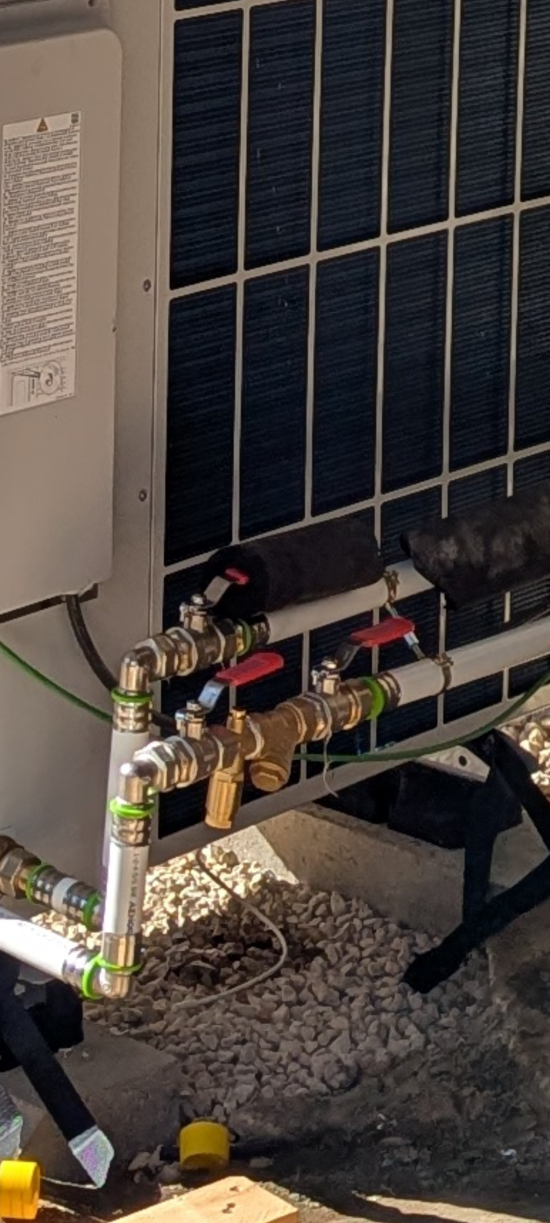

All those pipes need external (UV resistant) insulation.

And yes the pipes are on the snagging list (they ran out of insulation). The rubber feet are also incorrect.

all those elbows on the back if the unit will be adding massively to restriction
