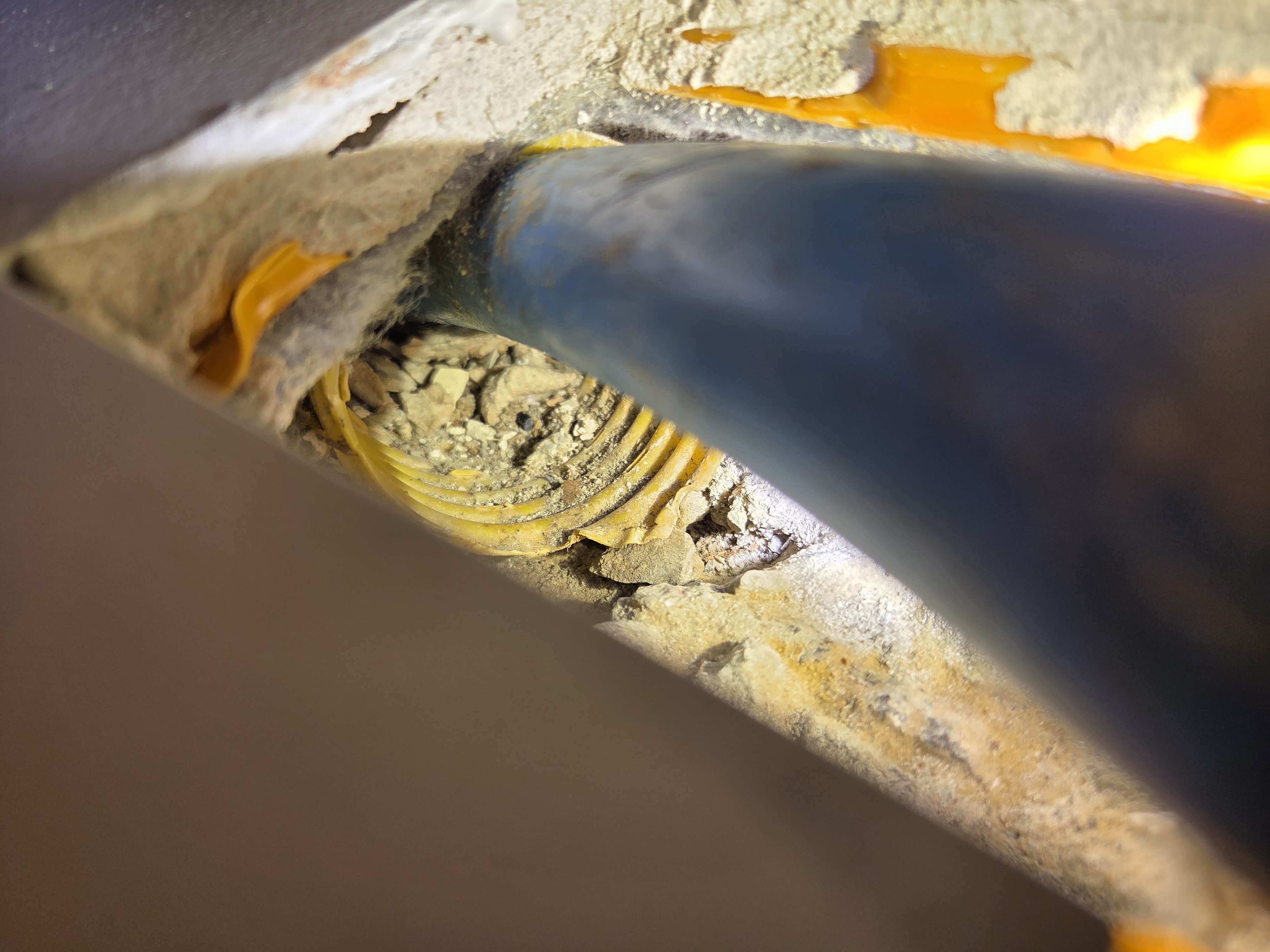

gambo Posted October 31, 2025 Author Posted October 31, 2025 I've now removed rockwool mineral wool from the hole and the pipe insulation from mdpe. The mineral wool is wet at the bottom. Not very wet but enough to assume that it may get quite wet if left for longer. I know it's breathable but will this not cause an issue if it attracts condensation quicker than it breaths? I wonder if just leaving it open is more sensible. I can cover the pipe partially as the whole and angle of the pipe doesn't allow to push it all the way to the ducting.
JohnMo Posted November 1, 2025 Posted November 1, 2025 Are you sure you haven't got a leak? If you aren't drawing water off, you won't get condensation forming normally. So overnight it should be perfectly dry. If wet you have a leak at one of the joints or at the valve stem. Most days it should remain dry all the time .
Nickfromwales Posted November 1, 2025 Posted November 1, 2025 Assuming this is a continuous piece of MDPE to the stopcock, the only place a dribble could be occurring and going unnoticed is from that ungodly stopcock which is brass compression onto the MDPE. I hate them, as the least amount of excuse you provide will result in this failing. I always go MDPE > copper via an MDPE fitting which is specific for this job. @gambo are you 1000% sure this MDPE > brass connection is 100% leak-free?
gambo Posted November 1, 2025 Author Posted November 1, 2025 Yes, unfortunately there is no leak at stopcock. I've checked it in number of ways. I can feel and smell damp further down and it smells like when you are inside bristol-bath two tunnels path.
Mr Punter Posted November 1, 2025 Posted November 1, 2025 I would hoover out as much crap as I could then slide some pipe insulation down as far as it will go. That will stop the condensation. A bit naughty using gas ducting but it could be worse.

gambo Posted November 1, 2025 Author Posted November 1, 2025 It's late 80s house build, I think, by David wilson. This has ducting is not the worse I've seen during the renovation. 1 hour ago, Kelvin said: What’s at the other end of the duct? Could water have got into it from outside? One of my ducts filled up with water before I sealed and buried it as rain was running down the cable that ran into it. I had to make up an extension for my hoover and suck it all out. The other end is probably around the water meter 12m from this place and around 4m from the fron of the house, although I can't see it due to an amount of mess/soil around the meter. I spent 1hr digging and removing the soil just to be able to turn off water. If the condensation is from either some sort of leak (would need to be very small if the meter doesn't move when turned off) or rain/soil then isn't it better to let it escape by not pushing the pipe insulation to deep? If I put pipe insulation that doesn't go inside the hole than that covered pipe doesn't attract condensation and it just sits and breath on the pipe inside the hole.

Nickfromwales Posted November 1, 2025 Posted November 1, 2025 3 hours ago, gambo said: Yes, unfortunately there is no leak at stopcock. I've checked it in number of ways. I can feel and smell damp further down and it smells like when you are inside bristol-bath two tunnels path. Can you get a hoover in there and suck the debris out? Then, get some bendy straws to fit on the foam gun and pack it out with FM 330 foam. That’ll be the end of this saga then , to the top of the tiles. Then pipe insulation and job done.
