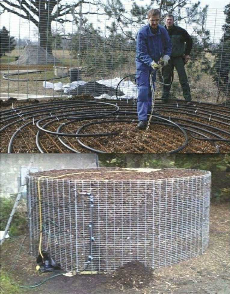

TheMitchells Posted October 9, 2025 Posted October 9, 2025 Hows this for an idea? And as a compost heap does get very hot - why not? From Unwaste the Planet on FB.... Instead of burning wood for warmth, more and more people are turning to a clever, low-cost alternative: building a compost pile over coiled plastic water lines from the hardware store. As the plant material decomposes, it naturally produces heat — reaching temperatures of up to 149°F (65°C). With a simple circulating pump as the only moving part, this compost heating system is remarkably reliable, lasting on average 12 to 16 months and sometimes up to two years, while providing enough energy to heat a 1,500 sq. ft. home and supply up to 80% of its hot water.

torre Posted October 9, 2025 Posted October 9, 2025 2 hours ago, TheMitchells said: more and more people I don't think there are that many people with the plant, materials and experience to safely build a double garage size compost heap and a ready supply of half a m3 of compostables per week to feed it, presumably needing a digger to load efficiently, but I guess it points to being able to heat a garden room from something more manageably sized. It'll produce most of its heat when you need it the least though (summer) and during the winter if you draw off too much heat from the compost won't you risk the whole system stalling?

Marvin Posted October 9, 2025 Posted October 9, 2025 This is a subject I have researched and worked on in detail. The production of heat is caused by the bacteria reaching between 37 and 54 degrees centigrade with the right amount of oxygen and water. Far below 37 it just rots and takes ages. Far above 54 and it dries out and goes crispy. In huge commercial trials this has been hard to duplicate for several reasons. Although you can calculate the heat potential, controlling it, is nigh on impossible. Information, and my own trials, show that the mound needs to be at least 1 cubic meter and live material. Yes the compost goes better in summer but you can insulate around it in winter, but then it can over heat and the bacteria dies. Also it needs to be mixed correctly. 1

Marvin Posted October 10, 2025 Posted October 10, 2025 (edited) 46 minutes ago, Ferdinand said: I think this was one where one of those mad-scientist hippy types did some experiments in the 1990s with ginormous compost heaps like long barrows. Also there were industrial scale trials. But look at the big scale and the fact that they couldn't easily regulate the output. https://www.pure.ed.ac.uk/ws/portalfiles/portal/8885379/Energy_from_Waste_Reuse_of_Compost_Heat_as_a_Source_of_Renewable_Energy.pdf 14 hours ago, TheMitchells said: And bark is slow to decompose - should last quite a while. The mix to obtain the warm reaction needs to be live. Mixing grass cutting, green (not evergreen) stuff and an amount of shredded sticks works quite well because of the mix of aeration, moisture and bacteria. I expect to start a pile next week and will supply info. I only use this as a way to produce great compost of garden waste. (not vegetable waste either!) Edited October 10, 2025 by Marvin
