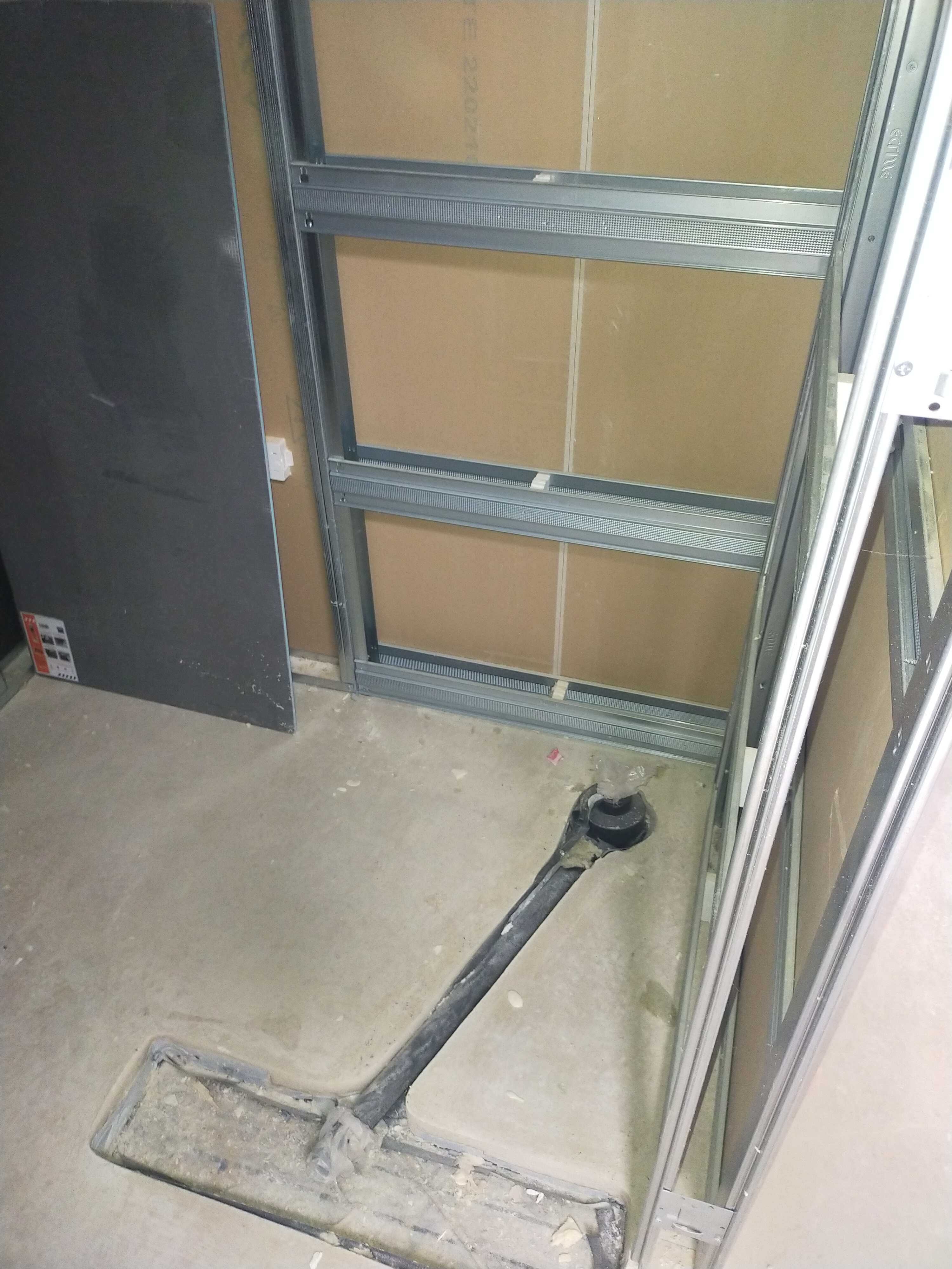

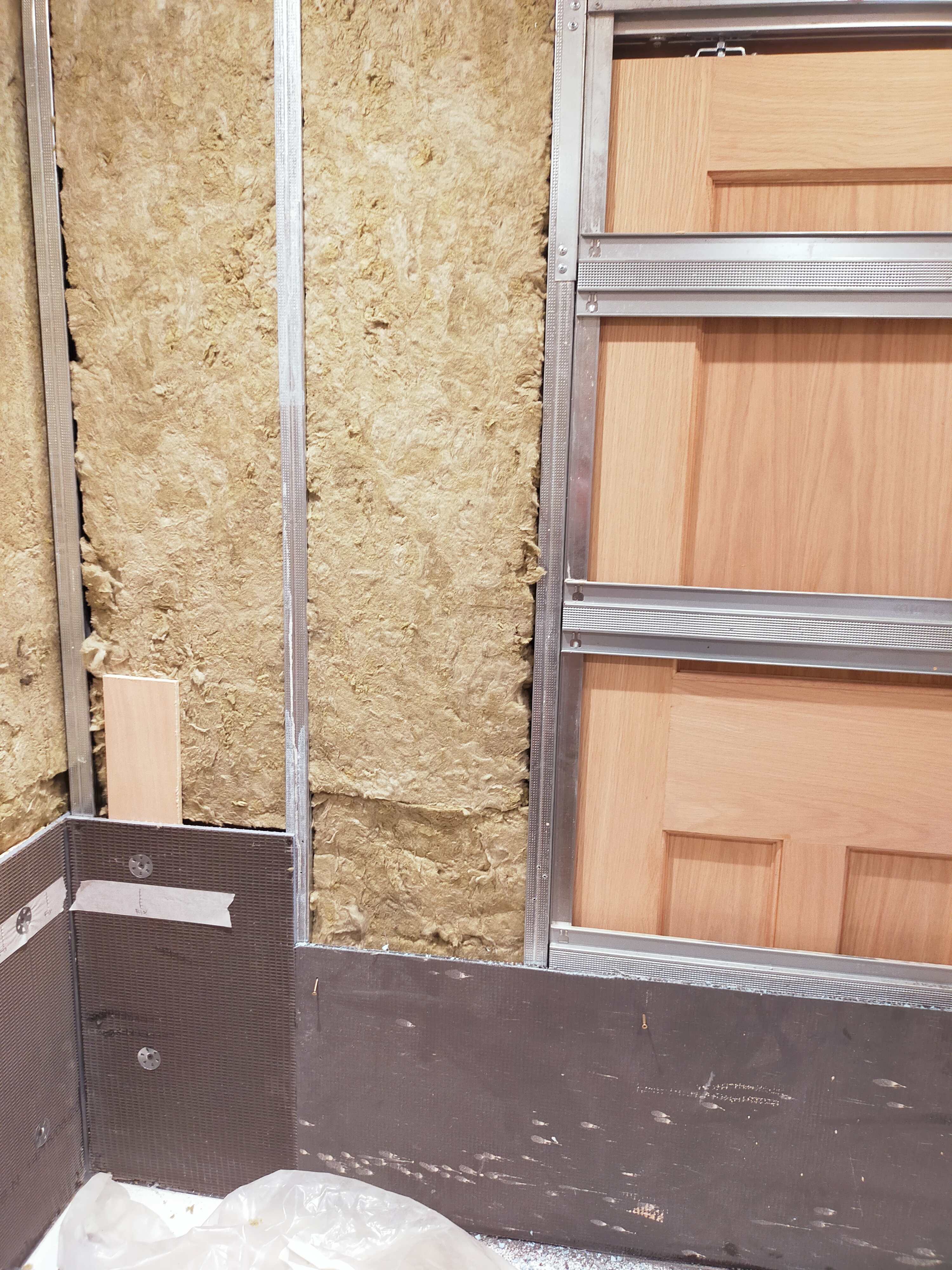

October 12, 20251 yr I used eclisse pocket doors in our SB, for the master bedroom, bathroom, en suite, WC, and utility room. All other doors are standard swinging ones. I went for the pocket doors as it's a small building and I squeezed every inch out of it to get all the rooms I needed in there. Without the pocket doors I couldn't have done it. From that perspective, they are brilliant. I found building the frames easy enough, and it worked well with the rest of the internal walls as I made them all out of metal frame. My internal walls are 100mm thick so as to save on space, and I've found no problem with that, but be aware that slim walls like that prevent you from fitting acoustic insulation in the area the door will occupy. In our case that means that noise from the bathroom shower is noticeable in the adjacent bedroom. Not the end of the world, and not much I could have done differently anyway, but worth thinking about at the design stage. We've been in for almost a year now and so far no signs of maintenance issues, though time will tell. Finally, take care that none of the plasterboard screws go through into the pocket space. We've now got a horizontal scratch on one of the doors due to this!
October 12, 20251 yr Here's a pic of two of my pocket door frames connected to form a right angle. You can see that the pocket prevents insulation being installed.
October 13, 20251 yr Author 21 hours ago, Tony K said: I used eclisse pocket doors in our SB, for the master bedroom, bathroom, en suite, WC, and utility room. All other doors are standard swinging ones. I went for the pocket doors as it's a small building and I squeezed every inch out of it to get all the rooms I needed in there. Without the pocket doors I couldn't have done it. From that perspective, they are brilliant. I found building the frames easy enough, and it worked well with the rest of the internal walls as I made them all out of metal frame. My internal walls are 100mm thick so as to save on space, and I've found no problem with that, but be aware that slim walls like that prevent you from fitting acoustic insulation in the area the door will occupy. In our case that means that noise from the bathroom shower is noticeable in the adjacent bedroom. Not the end of the world, and not much I could have done differently anyway, but worth thinking about at the design stage. We've been in for almost a year now and so far no signs of maintenance issues, though time will tell. Finally, take care that none of the plasterboard screws go through into the pocket space. We've now got a horizontal scratch on one of the doors due to this! Hi Tony, Appreciate your reply, exactly what I was hoping to here! and looks very similar to what I have in mind.
October 13, 20251 yr 39 minutes ago, Jord said: Hi Tony, Appreciate your reply, exactly what I was hoping to here! and looks very similar to what I have in mind. No worries. A couple of other small things to think about: You can just about tell from the photos that the horizontal bars in the pocket frame sit proud of the width of the metal studwork in the walls. You may have to double line the wall adjacent to the pocket so that it all lines up flush. I think that still allowed me to limit the width of the wall to 100mm, but base your design on the width of the pocket door housing rather than the stud walls, as the former is slightly greater. Also, a lot of the metal stud companies do excellent technical detail sheets for corners, openings, walls etc. Worth looking at.

October 14, 20251 yr 7 hours ago, Jord said: Hi Tony, Quick question. on the data sheet for the Eclisse pocket door, the overall height installation is 2056. which is top of finished floor level to bottom of header stud work. I'm mounting the system straight onto my floorboards, but once I have my tile backers, adhesive and tiles down (approx. 25mm), the door won't shut. Am I correct with this? If so, whats the solution. Thank you You can either pack the framework up so that it starts where you expect FFL to be (which is IMO the best solution), or once you have it all installed order a door of the appropriate (shorter) height to hang above the flooring.
November 5, 20251 yr On 14/10/2025 at 14:14, Jord said: Hi Tony, Quick question. on the data sheet for the Eclisse pocket door, the overall height installation is 2056. which is top of finished floor level to bottom of header stud work. I'm mounting the system straight onto my floorboards, but once I have my tile backers, adhesive and tiles down (approx. 25mm), the door won't shut. Am I correct with this? If so, whats the solution. Thank you Sorry, I don't log in very often these days! As @andyscotland says, you can pack the frame up, or pick a shorter door. Obviously the first option works best if you don't need to then pack up all the surrounding framework as well, and the latter if your choice of doors permits. Personally I didn't have to worry about it. As you can see from my photos above, I had a screed base to fix directly onto. Underneath that is my underfloor heating, then insulation. I only needed to add either a combination of ditra matt and tile, or underlay and carpet, straight on top. That's probably about 17mm or so, and our standard doors were fine. You could trim the base of the doors, or perhaps adjust the hanging connectors where the doors meet the frame. From memory, there might be some scope for adjustment there which could get you over the problem.
