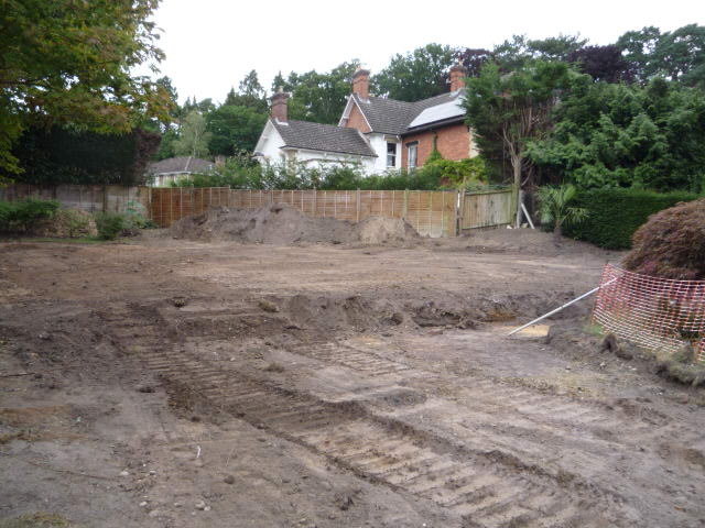

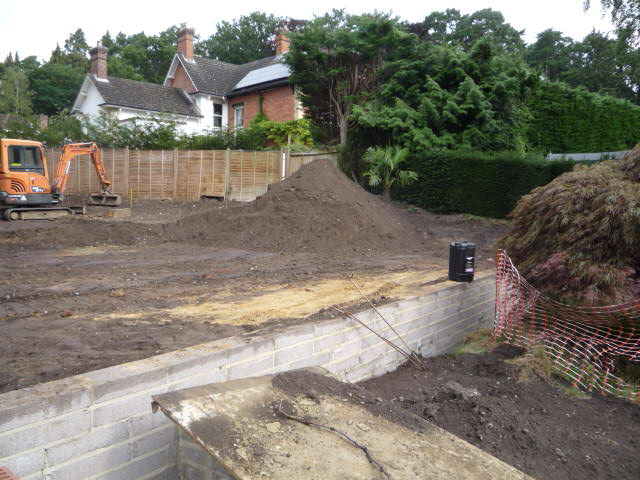

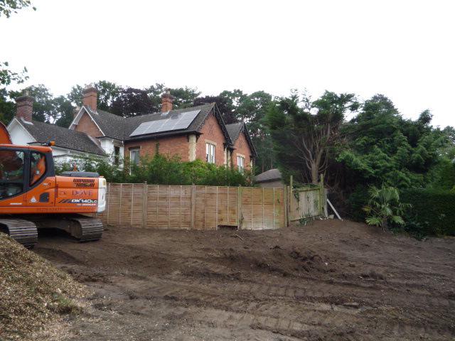

Jeremy Harris Posted January 10, 2018 Share Posted January 10, 2018 (edited) Good plan to use a structural engineer, but shop around for quotes. We had quotes from over £4000 to £300 for our retaining wall design by a structural engineer. Needless to say we used the chap that was £300! If you want some idea of the design work that went into our retaining wall, these blog posts illustrate the size and complexity of it. In total we removed around 900 tonnes of earth............ http://www.mayfly.eu/2013/07/part-six-there-we-were-digging-this-hole/ http://www.mayfly.eu/2013/07/part-seven-pouring-concrete/ http://www.mayfly.eu/2013/07/part-eight-the-wall/ and these are the drawings and calcs we got from our structural engineer: 20717.pdf 20130228093748130.pdf Edited January 10, 2018 by JSHarris typo Link to comment Share on other sites More sharing options...

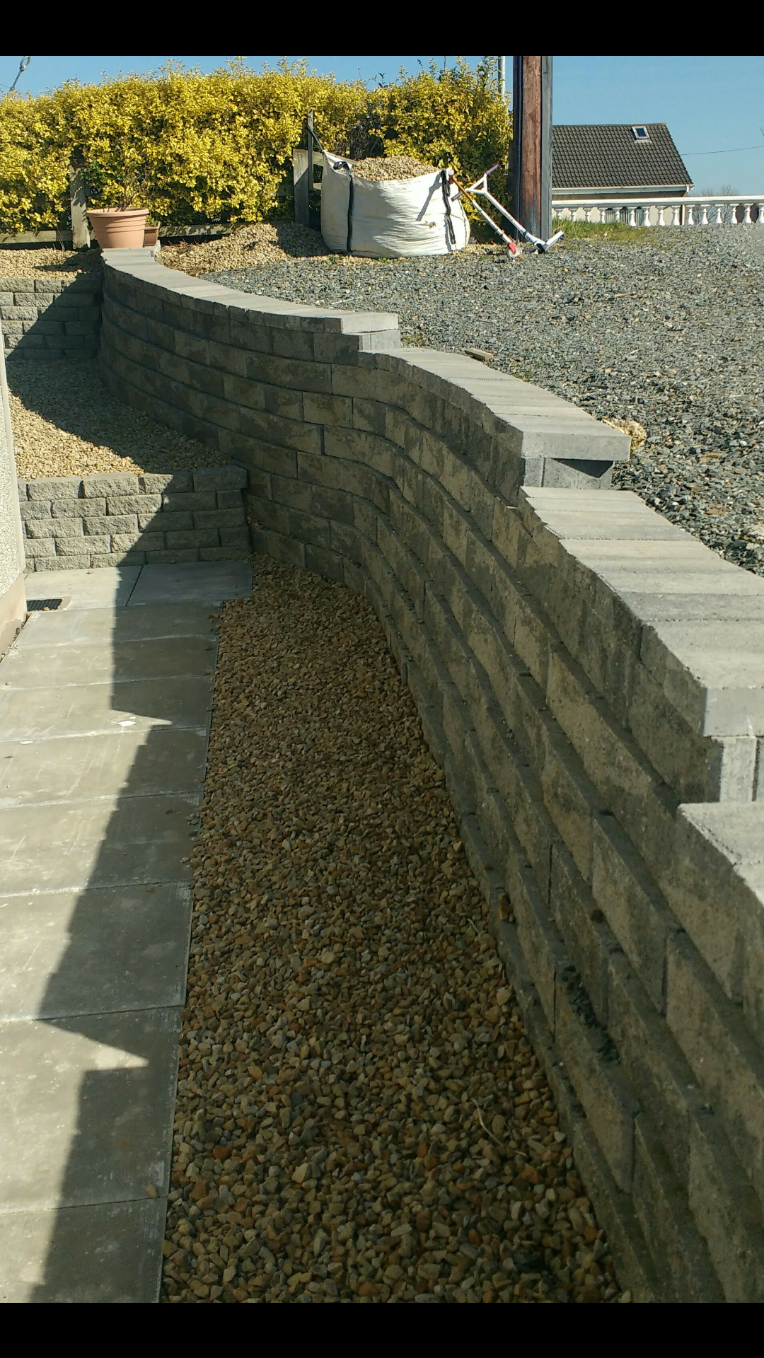

Declan52 Posted January 10, 2018 Share Posted January 10, 2018 (edited) I used one of the dry stone systems to hold back my driveway. It doesn't need a concrete base but you can put one in if you want. It's very simple to build, the blocks have a lip at the back edge so you can really go wrong. My wall at its highest is 1.6m so I had to use the larger blocks. The other smaller walls in the pic are made with a much smaller block but you can't go higher than 1.2m so as Jeremy suggests I used two walls with decorative some in between to get me the height I needed. There is near 30m of wall and it cost approx £2000 over 3 years ago. This is where I got it from. https://professional.ag.uk.com/products/retaining-walls/anchor-diamond It goes to a max height of 3m with the use of a geo grid. Edited January 10, 2018 by Declan52 1 Link to comment Share on other sites More sharing options...

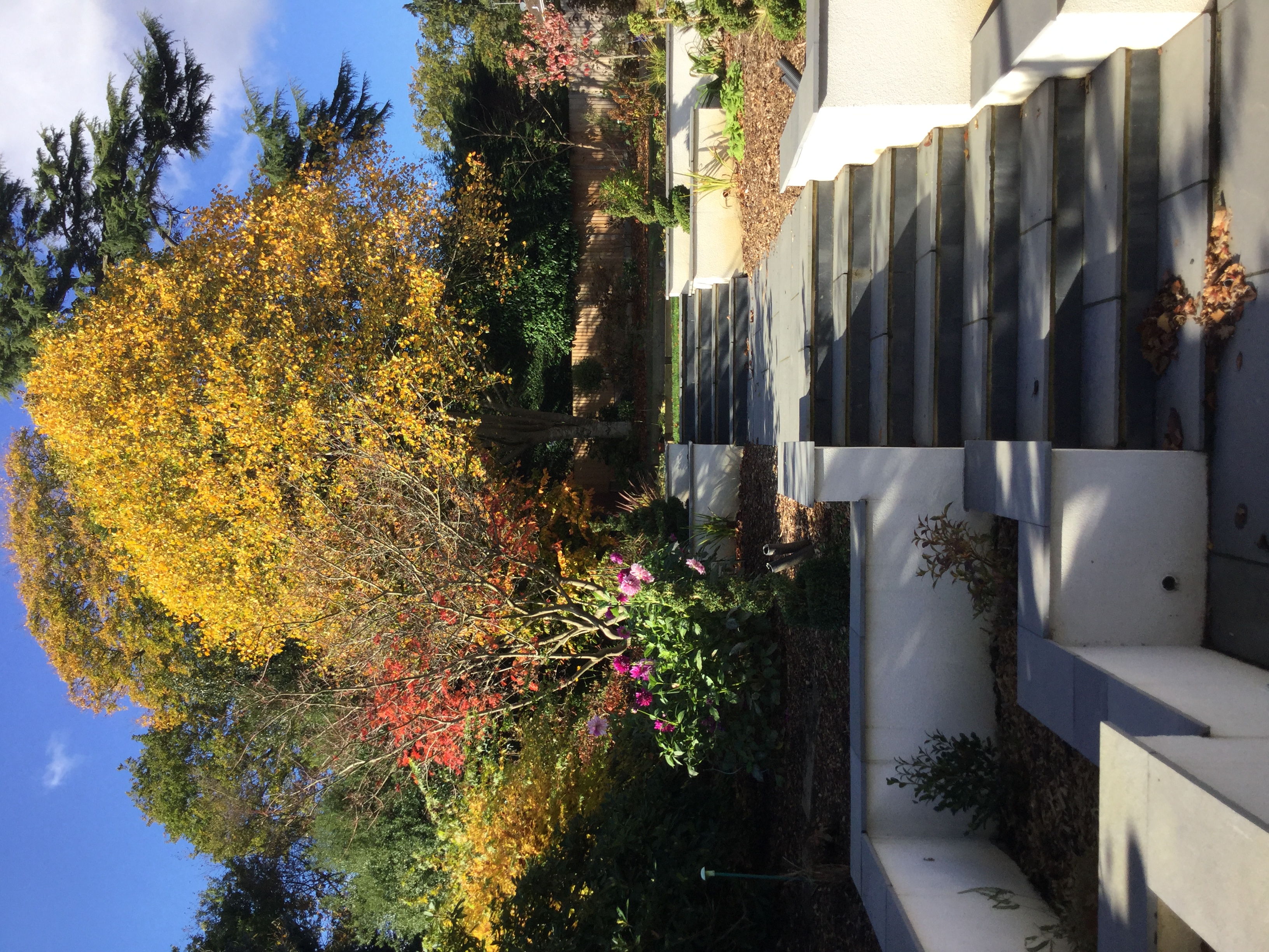

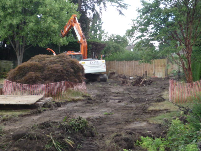

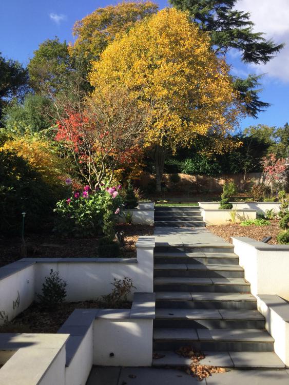

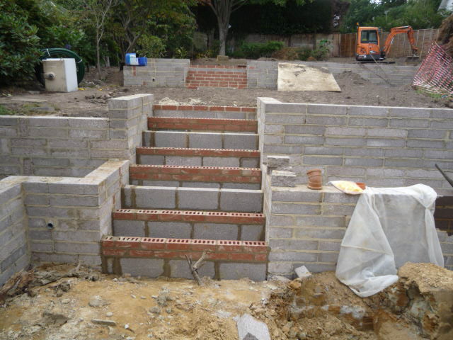

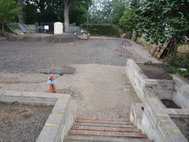

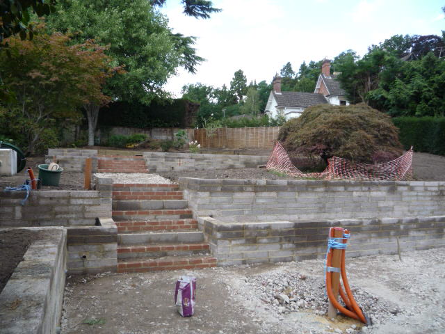

HerbJ Posted January 11, 2018 Share Posted January 11, 2018 (edited) 0ur site was not as challenging as yours appears to be but our plot does rise over 3m from the front boundary to the rear and slopes from right to left, looking up from the front. We had a lot of existing shrubs, trees and hedges that we wanted to retain from the existing house and the landscaping had to deal with this and the slope. We could not get our head around a decent design and engaged a landscape designer to produce a design. The landscape design wasn't cheap but my OH (who is the garden expert) insisted on it. In the event it was money well spent for the following reasons: As @JSHarris recommends, it allowed us to incorporate the landscape design in the Planning Application, though it was never included as a Condition in the Approval. All the work was VAT exempt from our contractor It allowed us to get good cost estimates and manage the work, with the groundwork contractor responsible for the ground clearance, hard landscaping, underground services and base for the passive foundation,. It allowed us to plan all the critical ground clearance and landscaping work that had to be completed with the heavy equipment before the foundation and underground scope was started. There was no way that we could have attempted this work after the house was built, as we could not any big equipment onto the site, except a small digger and it would been a long and laborious job. It minimised the amount of material that had to be taken off the site and eased the lorry movements (we had 69 lorry movements for this part of the project), which was important to us as we are opposite a school on a busy road and we wanted to have minimum impact from our build on the neighbours, including the school. In fact, we planned the major groundworks, including all the hard landscaping, except finishing the terrace and drive with paving slabs and Suds blocks, to be be executed in the school summer holidays. It was 4 weeks for the groundwork contractor and another week for MBC to install the passive slab. It allowed my OH to plant the garden before the house was finished, though the lawn elements were left until later. I believe that key for you is to get some ideas on landscaping including the retaining walls/terracing that meets your needs, incorporate the landscape design in your Planning Application/Approval and then it will give you a good starting point to execute it in the most effective manner as part of an overall plan for your project. Edited January 11, 2018 by HerbJ typos and tidy up the text and intent 1 Link to comment Share on other sites More sharing options...
Maria Posted January 12, 2018 Author Share Posted January 12, 2018 Thanks again for your input... Herb, your garden looks amazing! I think we'll be planning to terrace the embankment. This way we might be able to avoid taking a lot of muck off site as well. The embankment is at the highest point behind the build and we can potentially redistribute the excavated earth to build up the levels further away. The architect confirmed that we don't have go through planning for this. We just need to see if we want to get an approval in order to claim VAT back as you, guys, suggested. Time might be an issue though, as we bought the plot with the planning permission already in place, and it runs out end of May, beginning of June. Link to comment Share on other sites More sharing options...
HerbJ Posted January 12, 2018 Share Posted January 12, 2018 (edited) pm me and I will send you some other documents to give you some better idea of the landscape design drawings. They were't very detailed but enough to incorporate directly onto then plot plans and elevatton. We then prepared drawings for the groundwork contractor, using a building design technician and SE for the retaining walls Use the time, if you can manage it. Time spent planning at this stage will save you £1000's in execution and potentially give you a more usable garden space. You may be able to make a "substantial start to construction" to make your existing Planning Approval extant and then you have lots of time to do what you need to do. This is what we did with similar timeframe to you after we bought a house with Planning Approval. We completed the purchase of hour plot at the end of July 2014 and the Approval was due to lapse at the beginning of November 2014. We submitted a complete new planning application for a new house design without any concern for the original approval lapsing. We demolished the existing house using the original Approval in February/March 2015 and started our ground works on 24 July 2015, after getting Approval for the new design. Edited January 12, 2018 by HerbJ Link to comment Share on other sites More sharing options...

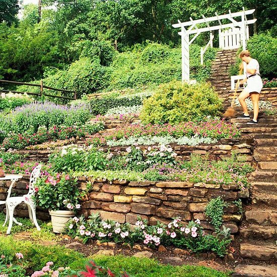

Russell griffiths Posted January 12, 2018 Share Posted January 12, 2018 On a previous house we needed a retaining wall aprox 3m high and found out that any structure used for retaining would require engineering drawings if over 1m high, so we built 3 terraces all aprox 900mm high with a very light slope aprox 3m wide and built timber planters on the relatively flat bits and turned it into a veggie garden, it worked very well as each flat area was sheltered by the one above. Just bear in mind a group of terraces will take up more land than a vertical method. 1 Link to comment Share on other sites More sharing options...
Russell griffiths Posted January 12, 2018 Share Posted January 12, 2018 Sitting here bored. I found these for you. 3 Link to comment Share on other sites More sharing options...
