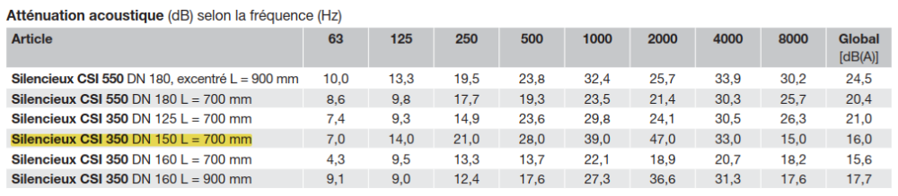

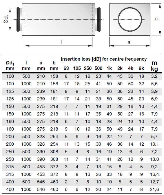

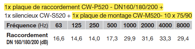

Mike Posted October 25, 2025 Posted October 25, 2025 Since silencers attenuate the sound differently at different frequencies it would be worth sampling the noise with an audio spectrum analyser, so that you can compare that with the spec of silencers you consider. I only looked at attenuators that used foam to avoid the risk of blowing mineral / glass fibre through the ducting. I think the only one available in the UK is the Zehnder CSI, which comes in 700mm long for 150 diameter (Brink, Westaflex and Vasco were also on the shortlist):

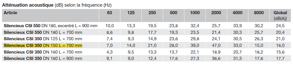

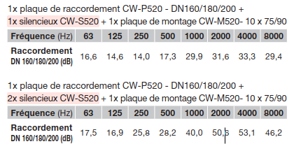

Mike Posted October 25, 2025 Posted October 25, 2025 42 minutes ago, Mattg4321 said: audio spectrum analyser BTW, to illustrate why it's useful, compare the frequency attenuation of the Zehnder CSI (above) with this one for the Zehnder silenced manifold that I mentioned on the previous page: The silenced manifold beats the dedicated silencer at frequencies of 63, 125, 4000 & 8000 Hz.

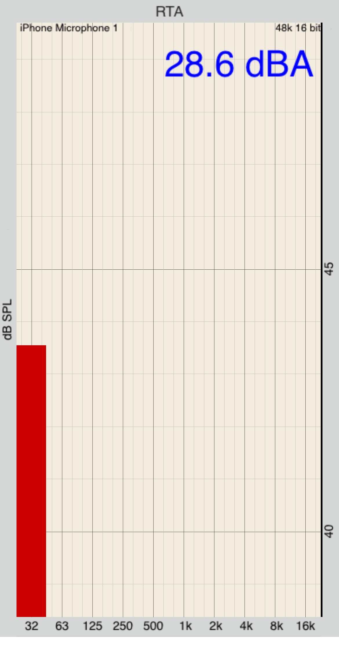

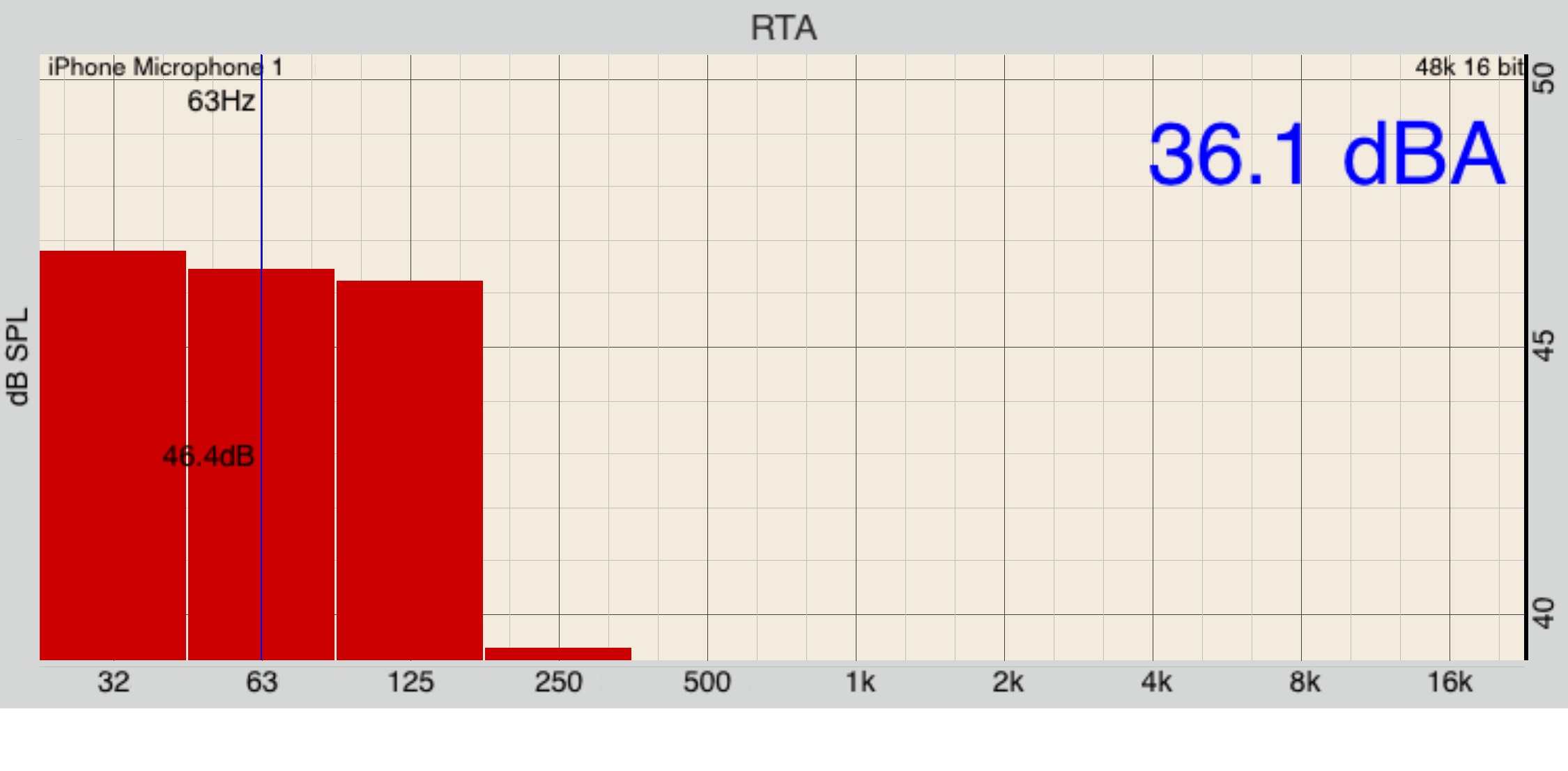

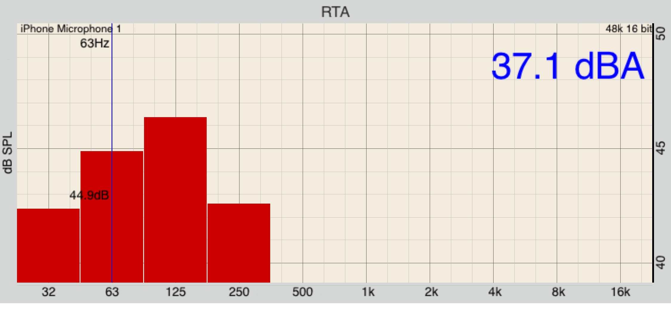

Mattg4321 Posted October 25, 2025 Author Posted October 25, 2025 (edited) 1 hour ago, Nick Laslett said: @Mattg4321, I did link to the iPad/iphone spectrum analysis tool I use earlier in this thread. Not sure how I missed that. I just downloaded it, but not sure what I’m doing. The 1st picture is with phone microphone a few mm below the centre of the terminal in bed 1. The 2nd picture is the same test in bed 2. Obviously the results are jumping around a bit - possibly as I’m not that still! Only a snapshot in time, but it does appear that bed 1 is slightly more weighted to the lower frequencies than bed 2 for whatever reason. unit currently on 30% as someone in the bath! Edited October 25, 2025 by Mattg4321
Mattg4321 Posted October 25, 2025 Author Posted October 25, 2025 1 hour ago, Mike said: BTW, to illustrate why it's useful, compare the frequency attenuation of the Zehnder CSI (above) with this one for the Zehnder silenced manifold that I mentioned on the previous page: The silenced manifold beats the dedicated silencer at frequencies of 63, 125, 4000 & 8000 Hz. Are those results for both used in conjunction with eachother?
Mike Posted October 25, 2025 Posted October 25, 2025 48 minutes ago, Mattg4321 said: The 1st picture is with phone microphone a few mm below the centre of the terminal in bed 1. The 2nd picture is the same test in bed 2. Very useful results. So it is the lower end of the frequency range causing the problem. If I were choosing only between the 2 Zehnder options, I'd choose the silenced manifold. BTW, results would normally measured at 1m distance from the source of the noise (ceiling terminal in your case), so the chances are that the 14dB reduction provided by the silenced manifold at 250Hz would be enough, even if your chart suggests that you have 42.5dB of 250Hz noise a few mm away from the Bedroom 2 terminal. You could measure again at 1m to give help decide. 23 minutes ago, Mattg4321 said: Are those results for both used in conjunction with each other? No - that is for the manifold only. It helps to know that the manifold is modular - that is you can fit different 'end plates' to it depending on what you want to connect. The results in the table above are measured for the following: a connector plate for 1 x DN160 or 180 or 200 duct on one end (the first part in yellow) a connector plate with 10 x 75 or 90mm semi-rigid duct connectors on the other (the second part in yellow) the CW-S520 is the main body of the manifold (not in yellow). Note that there is a regular manifold body too, without the sound attenuation - the 'S' indicates that it's a silencer version. You would want a connector plate for a 150mm duct (Zehnder 990323568, by the look of it), which isn't one of the ones they used in the test, but the size is so similar to the ones that they did use that performance would undoubtedly be similar / identical.
Mattg4321 Posted October 25, 2025 Author Posted October 25, 2025 3 minutes ago, Mike said: Very useful results. So it is the lower end of the frequency range causing the problem. If I were choosing only between the 2 Zehnder options, I'd choose the silenced manifold. BTW, results would normally measured at 1m distance from the source of the noise (ceiling terminal in your case), so the chances are that the 14dB reduction provided by the silenced manifold at 250Hz would be enough, even if your chart suggests that you have 42.5dB of 250Hz noise a few mm away from the Bedroom 2 terminal. You could measure again at 1m to give help decide. No - that is for the manifold only. It helps to know that the manifold is modular - that is you can fit different 'end plates' to it depending on what you want to connect. The results in the table above are measured for the following: a connector plate for 1 x DN160 or 180 or 200 duct on one end (the first part in yellow) a connector plate with 10 x 75 or 90mm semi-rigid duct connectors on the other (the second part in yellow) the CW-S520 is the main body of the manifold (not in yellow). Note that there is a regular manifold body too, without the sound attenuation - the 'S' indicates that it's a silencer version. You would want a connector plate for a 150mm duct (Zehnder 990323568, by the look of it), which isn't one of the ones they used in the test, but the size is so similar to the ones that they did use that performance would undoubtedly be similar / identical. Thanks. I’ll look into it. I’m about to go away for a week so nothing much will be done until after that. This is the reading from 1m away from bed 1 terminal. 1

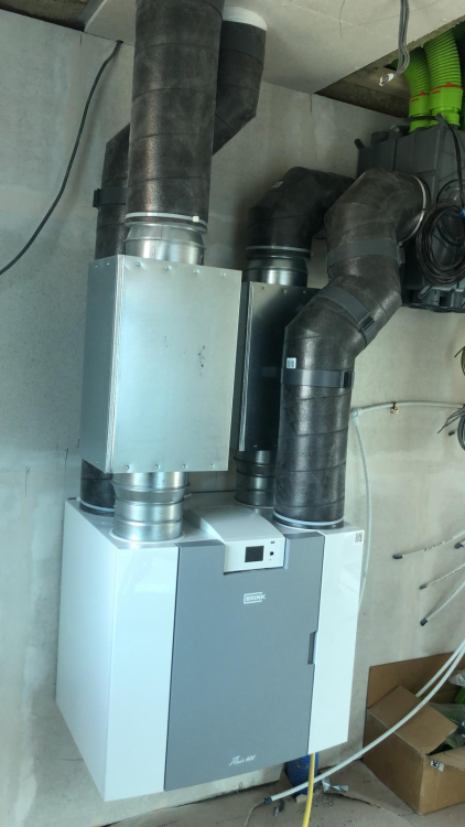

Nickfromwales Posted October 25, 2025 Posted October 25, 2025 7 minutes ago, Mattg4321 said: That Zehnder manifold looks like it costs over £500 with all the necessary parts!!!! Think I’ll look into a few more options first! Just fitted 2 of these, but they're expensive, yes, but very good build quality; both acoustically and thermally insulated so no need to insulate externally which is a wonderful thing when you're working in the worlds smallest / most awkward plant space! 1
