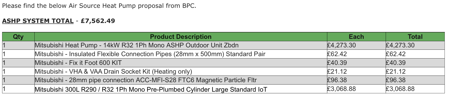

Great_scot_selfbuild Posted September 25, 2025 Posted September 25, 2025 I've been searching around (a lot) for ASHP and who to go with - this is one of the strangest responses. I've attached their quote; I then queried how they came up with the 14kW size. Our timber frame house will be almost passivehaus level of performance and at least 0.6ACH on air tightness. We're expecting (based on a similar house we've visited) to need a 6kW ASHP, UFH downstairs only and bathrooms with electric UFH pads and towel rails. This was their response to me asking why they came up with 14kW. What has Part F (ventilation) got to do with it? Grateful for your thoughts / experience of them (I've not ruled them out yet). "In line with part F regulations for new builds, the minimum heating loads & property floor area have been placed in the manufacturer's selection software. This is the result. If your property is not a new build, please provide your SAP report to allow us to verify & calculate a new unit."
JohnMo Posted September 25, 2025 Posted September 25, 2025 Do your own heat loss calculation. 14kW is just rubbish and generally not needed unless your house is massive, leaks air and heat like a seize. No need to waste that money on a pre plumbed cylinder, 300L cylinder £3k, should really only be spending £1500 or less. 1 1
JamesPa Posted September 25, 2025 Posted September 25, 2025 (edited) 47 minutes ago, Great_scot_selfbuild said: I've been searching around (a lot) for ASHP and who to go with - this is one of the strangest responses. I've attached their quote; I then queried how they came up with the 14kW size. Our timber frame house will be almost passivehaus level of performance and at least 0.6ACH on air tightness. We're expecting (based on a similar house we've visited) to need a 6kW ASHP, UFH downstairs only and bathrooms with electric UFH pads and towel rails. This was their response to me asking why they came up with 14kW. What has Part F (ventilation) got to do with it? Grateful for your thoughts / experience of them (I've not ruled them out yet). "In line with part F regulations for new builds, the minimum heating loads & property floor area have been placed in the manufacturer's selection software. This is the result. If your property is not a new build, please provide your SAP report to allow us to verify & calculate a new unit." Probably the same bollox that led two surveyors each spending 3hrs in my house to conclude that my loss is 16kW. My loss is in fact 7kW confirmed by a proper calculation, gas consumption, the successful replacement of a gas boiler with a 7kW ASHP and subsequent measurements. Be suspicious of the use of assumed high ach values, double counting of room to room losses, and ignoring of any fabric components that are better than building regs at the time your house was first built. Don't believe any survey calculation that isn't somehow sanity checked. The MCS 'rules' appear, in many cases, massively to oversize and do the public a massive disservice as a result. Also suspect anyone offering a pre plumbed cylinder. The principal advantage is that they can employ complete rookies to do the onsite work. In case you haven't already been alerted, reject any quote involving a buffer, phe or llh between heat pump and emitters. The sole purpose of these components, in almost all cases, is to avoid call outs at the expense of a significant increase in running costs and material complication of fault diagnosis for the customer. A 2 port volumiser either on flow or return (but not between the two) is ok. Also no external controls other than those specifically designed for heat pumps namely homely, adia or havenwise. Under no circumstances fit 'smart' thermostats. I and others can explain why if necessary. Edited September 25, 2025 by JamesPa 2 1
