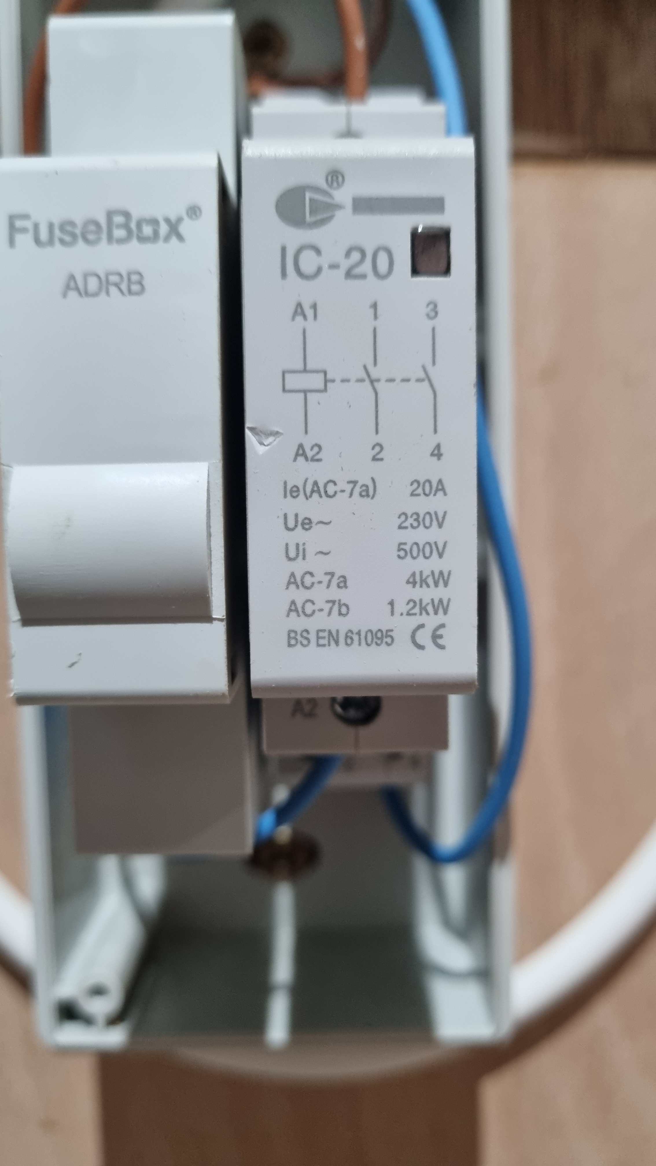

We have an electromagnetic relay in our heating circuitry that was purchased at short notice so I was not able to research. It has a very annoying loud click. It's inside an enclosure in the plant room behind a solid door.
I want to replace this with a silent SSR. The control and load are both AC.

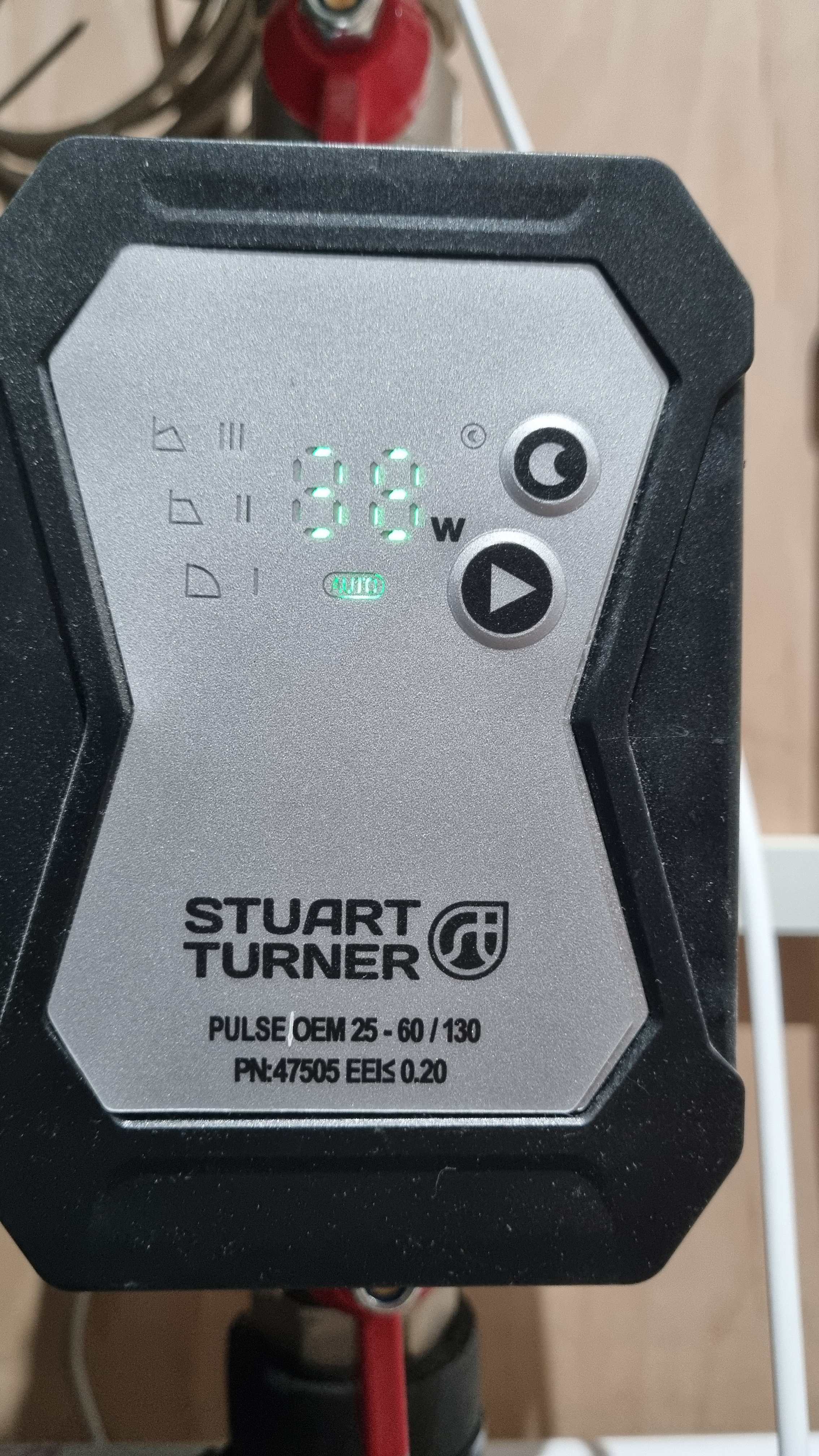

The load, a circulation pump for the UFH, is a Stuart Turner Pulse OEM 25-60/130, with a power consumption of 4.5 to 38W, which I work out to be <0.2A current draw.
Will the 10AA version of this SSR be OK?

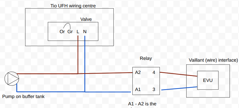

6 minutes ago, BotusBuild said:
Looking at your diagram, the wiring centre IS providing Switched L and N to the pump. and A1 and A2 on the relay is the relay coil.  So the relay turns on when the pump is running.  3 and 4 are a normally open contact on the relay.
So the relay is NOT switching the pump, it is providing a volt free open / close contact to the EVU
This relay should not be necessary as most UFH controllers will already provide a volt free contact of some sort often labelled as boiler or call for heat, which will provide this volt free contact without needing the relay.
Can you post a manual or a close up picture of the connections available for your UFH controller?

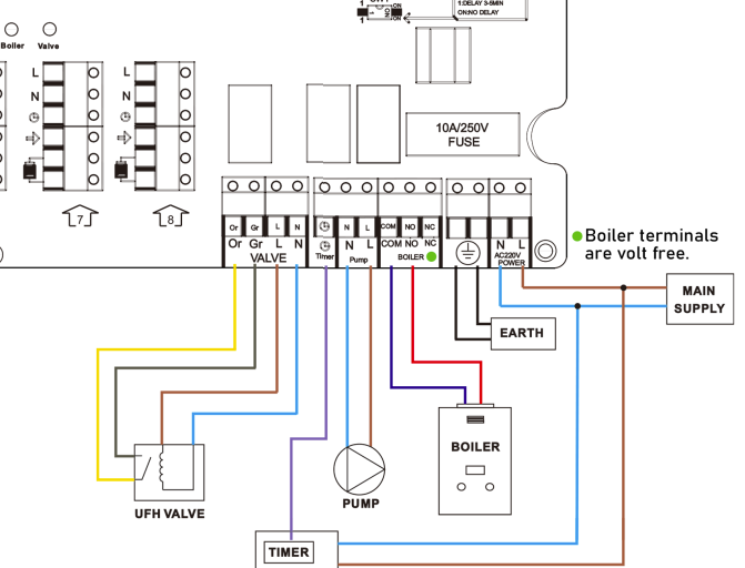

19 minutes ago, BotusBuild said:
Yes.
A screen grab of the important bit

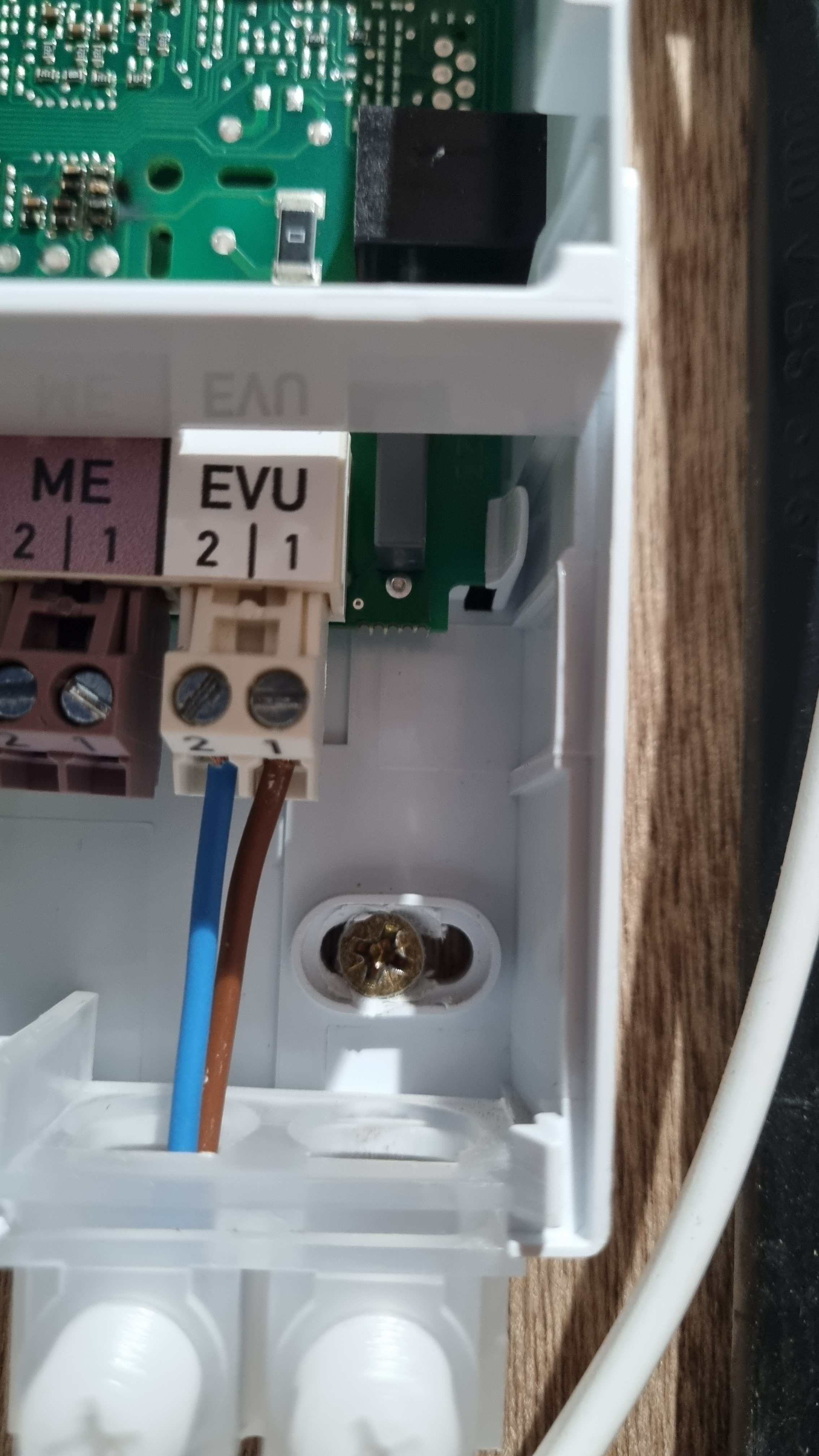

The red and blue wires shown here going to the boiler are a volt free normally open contact that does exactly what your relay is doing, closes when the UFH pump is on.
Ditch your relay and connect the Red and Blue shown here to the EVU

Should I leave the circulation pump connected to the Valve terminals? Or move them to the above Pump terminals?
5 minutes ago, BotusBuild said:
Thank you @ProDave.
Yes move that to the pump terminals.

EVU is the standard way of controlling the HP from a third-party device when the HP system itself doesn't have multiple zones (for these you need a VR70 or 71 Wiring Centre with its own call for heat inputs).

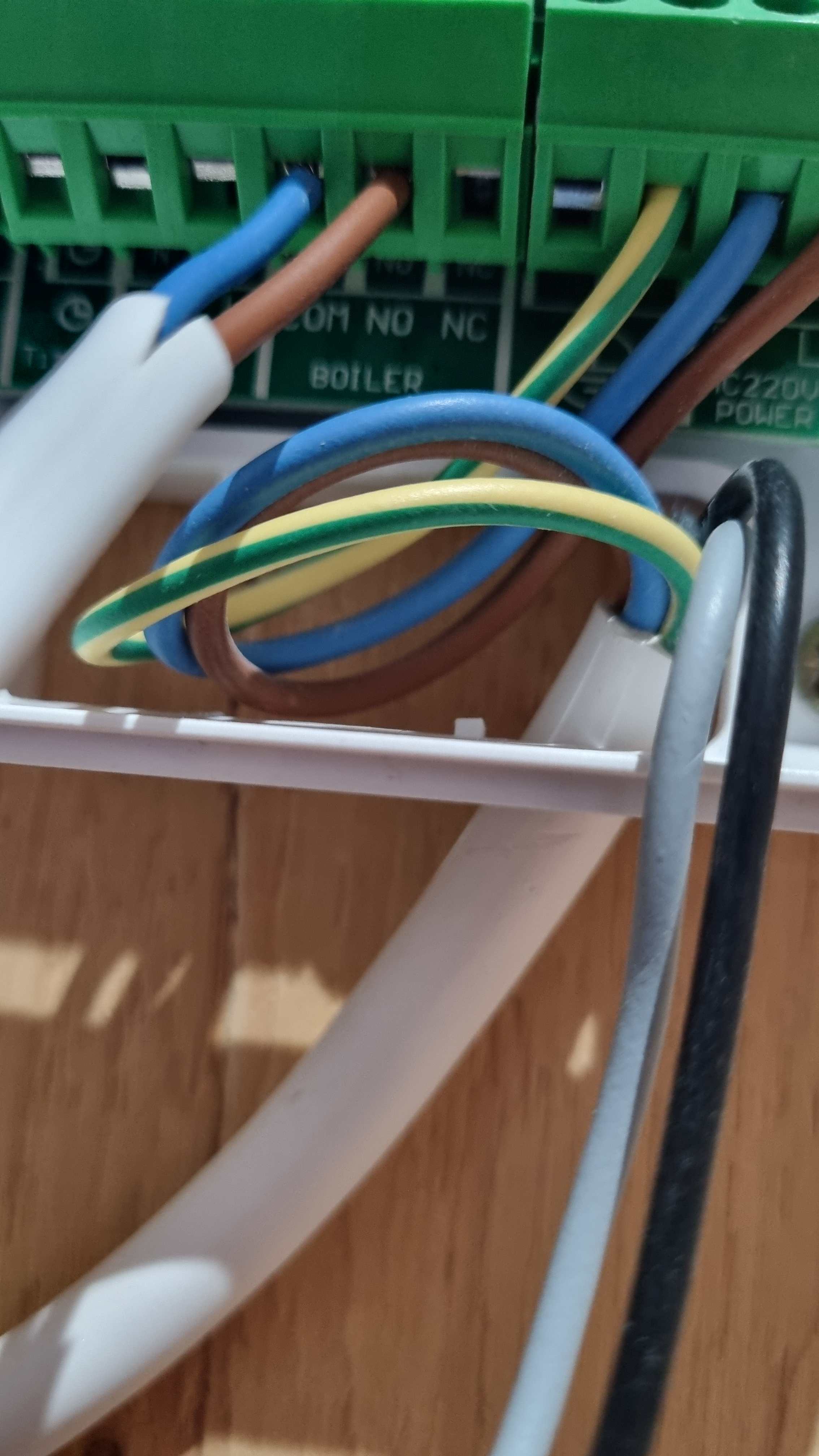

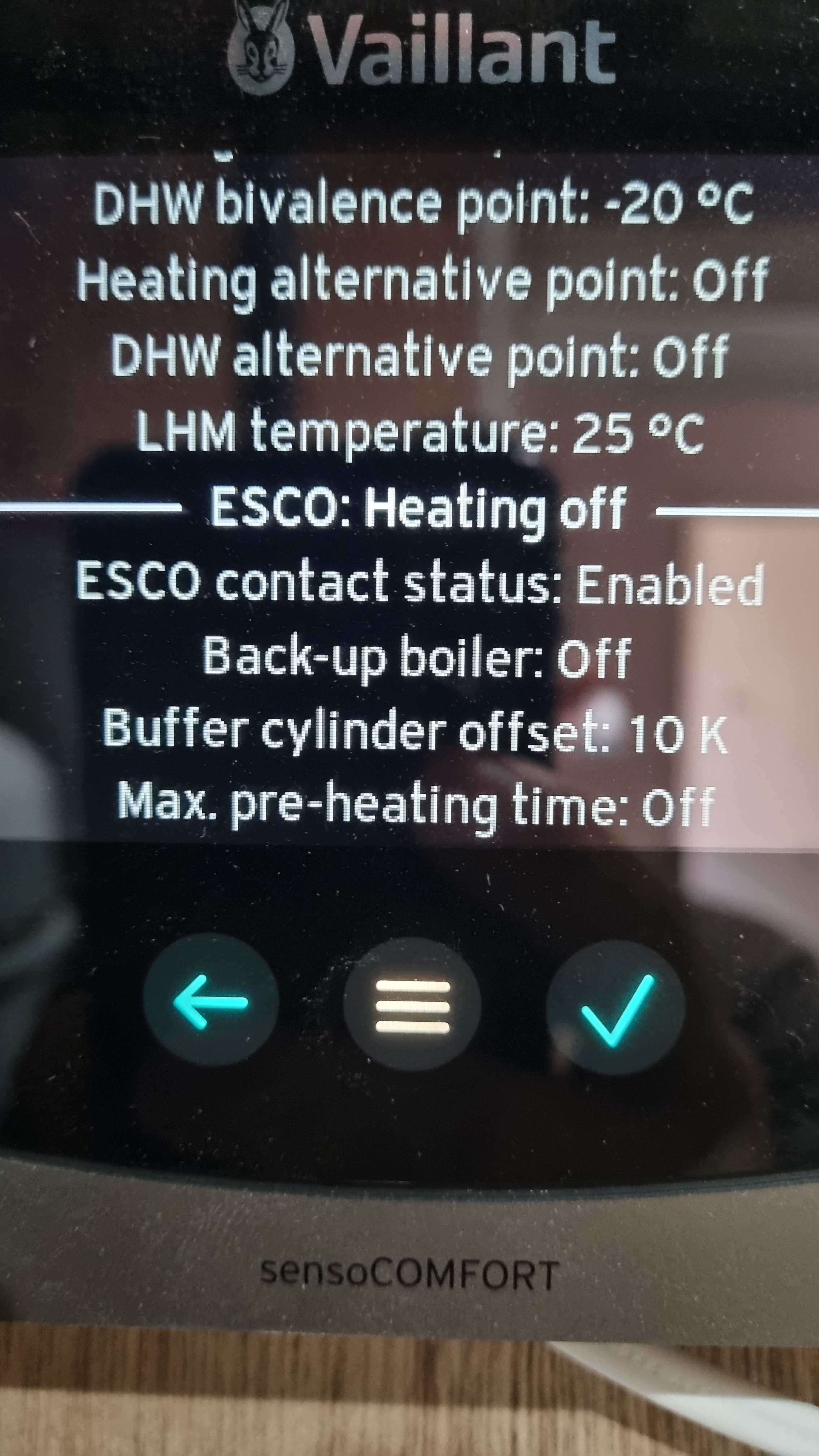

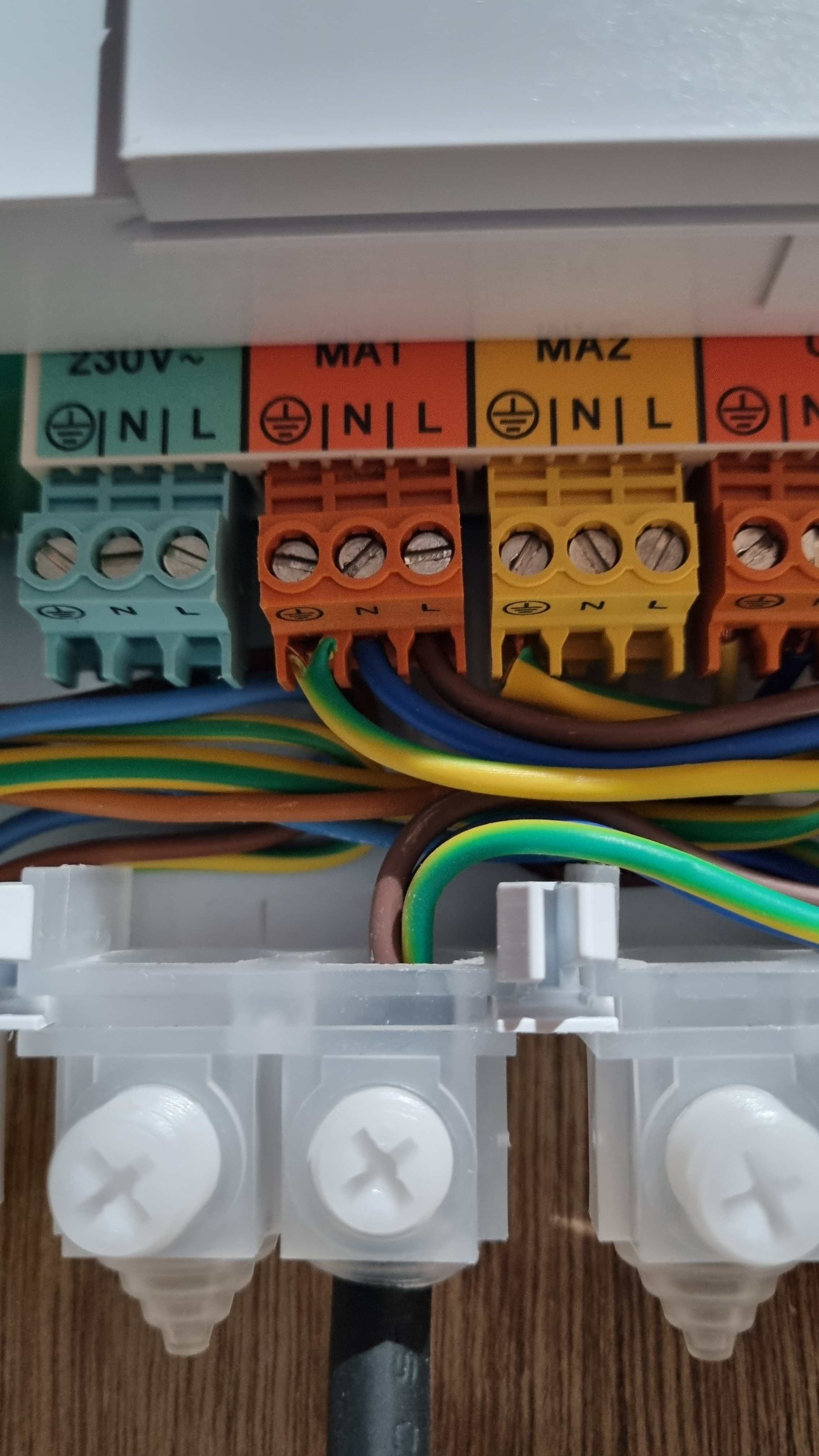

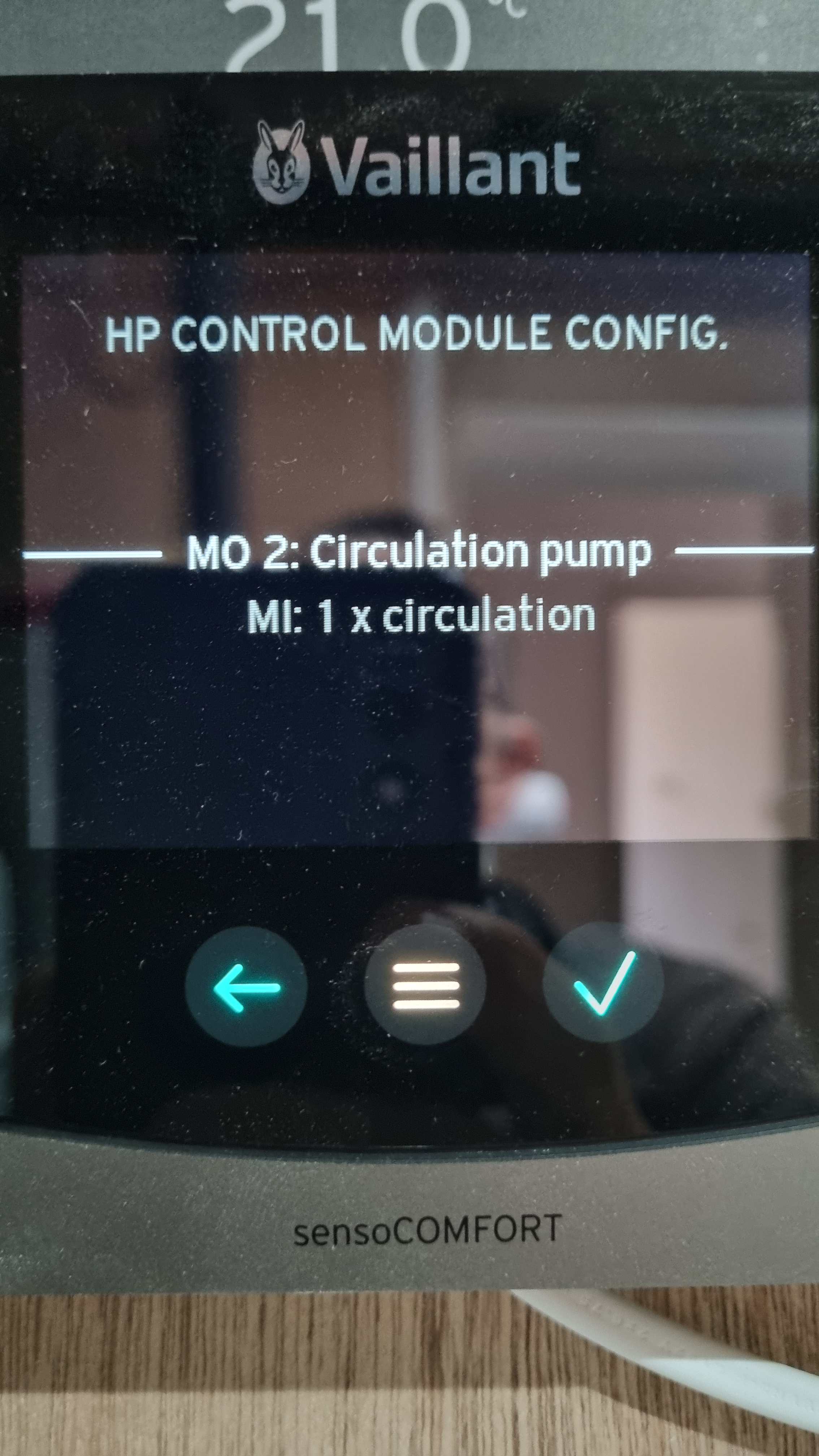

Update (summary - pump running constantly!):
Boiler COM and NO (normally open?) now connected to EVU 2 and 1 respectively (see pics)
20251001_113721.thumb.jpg.bf6b896b0883401a1f81b667c35d4438.jpg20251001_113733.thumb.jpg.2c1d4f6d0ed091a8525ca1854996374c.jpg
Pump connected directly to MA1.
PROBLEM: The pump (the one after the buffer tank) is on all the time whether the stat is set to require heat input. So, whether the wiring centre is calling for heat or not the UFH circulation pump is running.
Settings which I think are relevant:
20251001_113130.thumb.jpg.fc4ba6ac0507c8192068579c614ebbd1.jpg20251001_113235.thumb.jpg.1086bdb9932a774bd6c80b0ec5095ed2.jpg
Anyone shed any light on why the pump is always running.

  • Have you followed all the settings on the 3rd page of the relevant schematic, in particular system diagram set to 10?

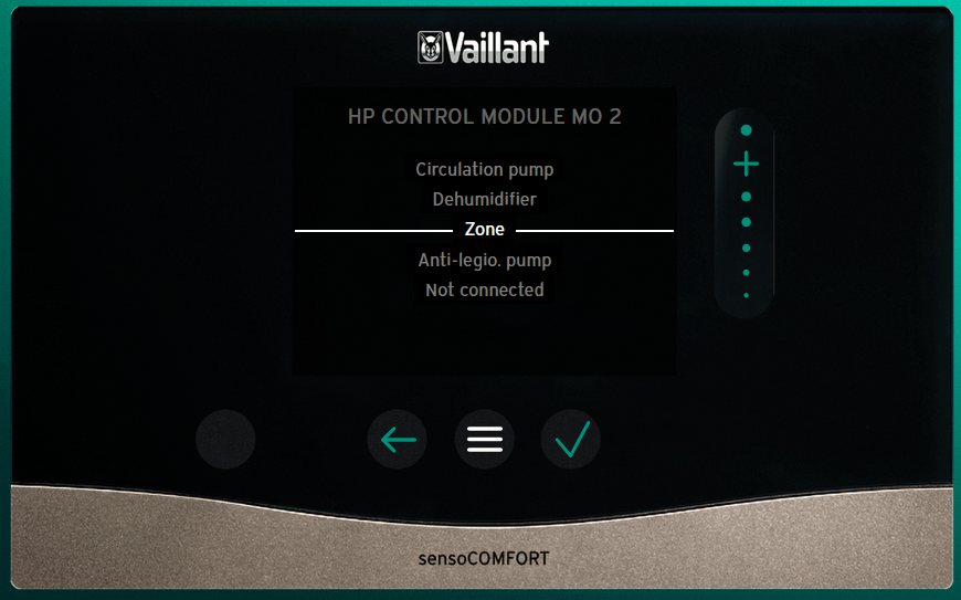

  • However I am not sure about connecting to MA1 anyway as I can't see a way of configuring it in the black controller menu using this simulator (https://simulator.vaillant.com/vrc720/at/#/simulator). But there is this in the white controller manual though none of these options seem appropriate for yr system:
  • You could alternatively connect to MA2, with the right choice of option, IIRC it is set by default to HW circulation which is not what you want, try Zone
  • Alternatively you can leave it on hw but set up a time schedule, which is not as good as having it follow the demand but better than having it running 24/7
