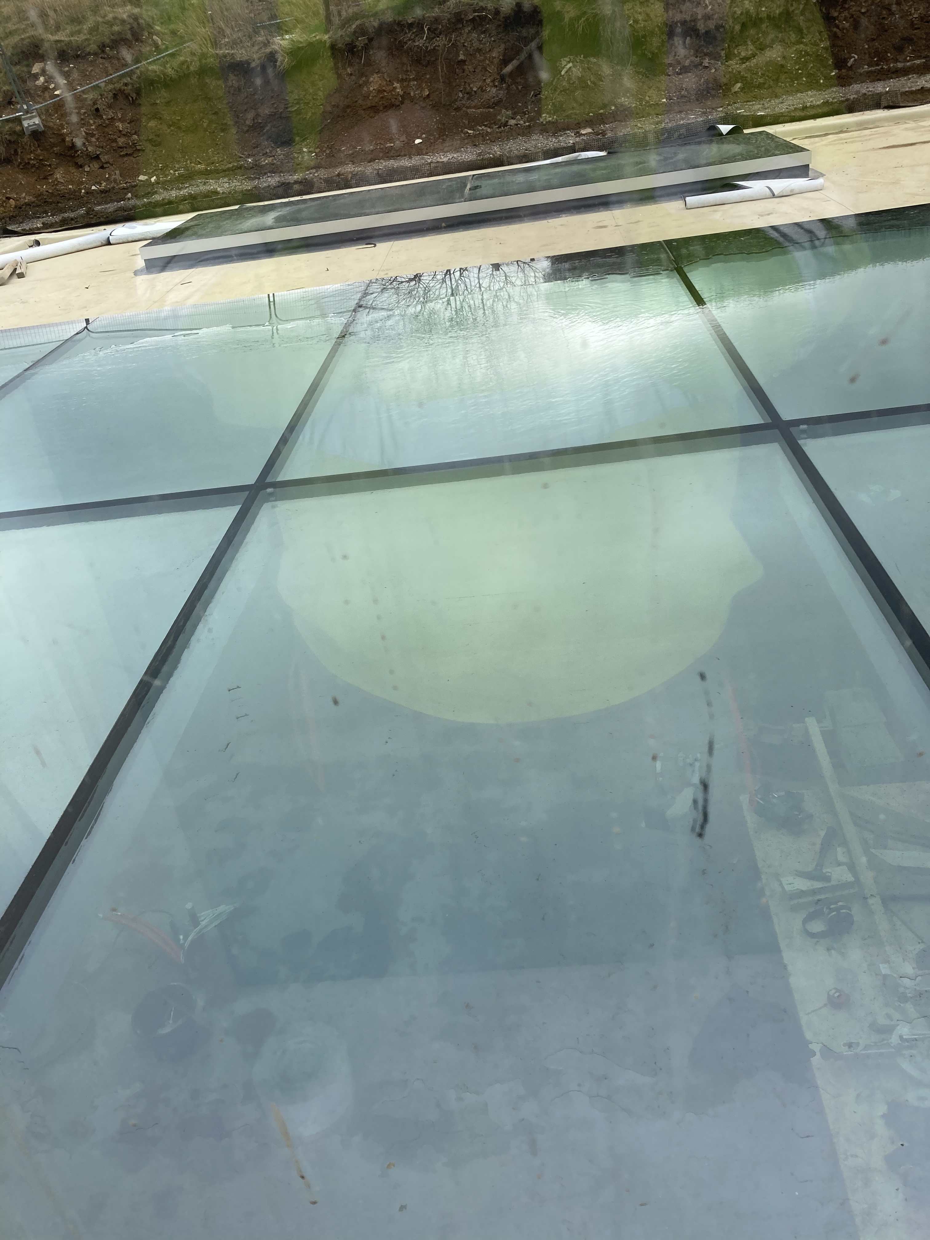

These where fitted on a recent job Craned in by specialists
Leaked and pooled in the middle 8k x 8 Blaming everything except themselves Never bothered to check the fall as they went Rea basic stuff I could post you examples all day
Posted
We both could post examples all day, don’t deny it but it is a trade but I do agree that there is a substantial amount of unskilled installers.
