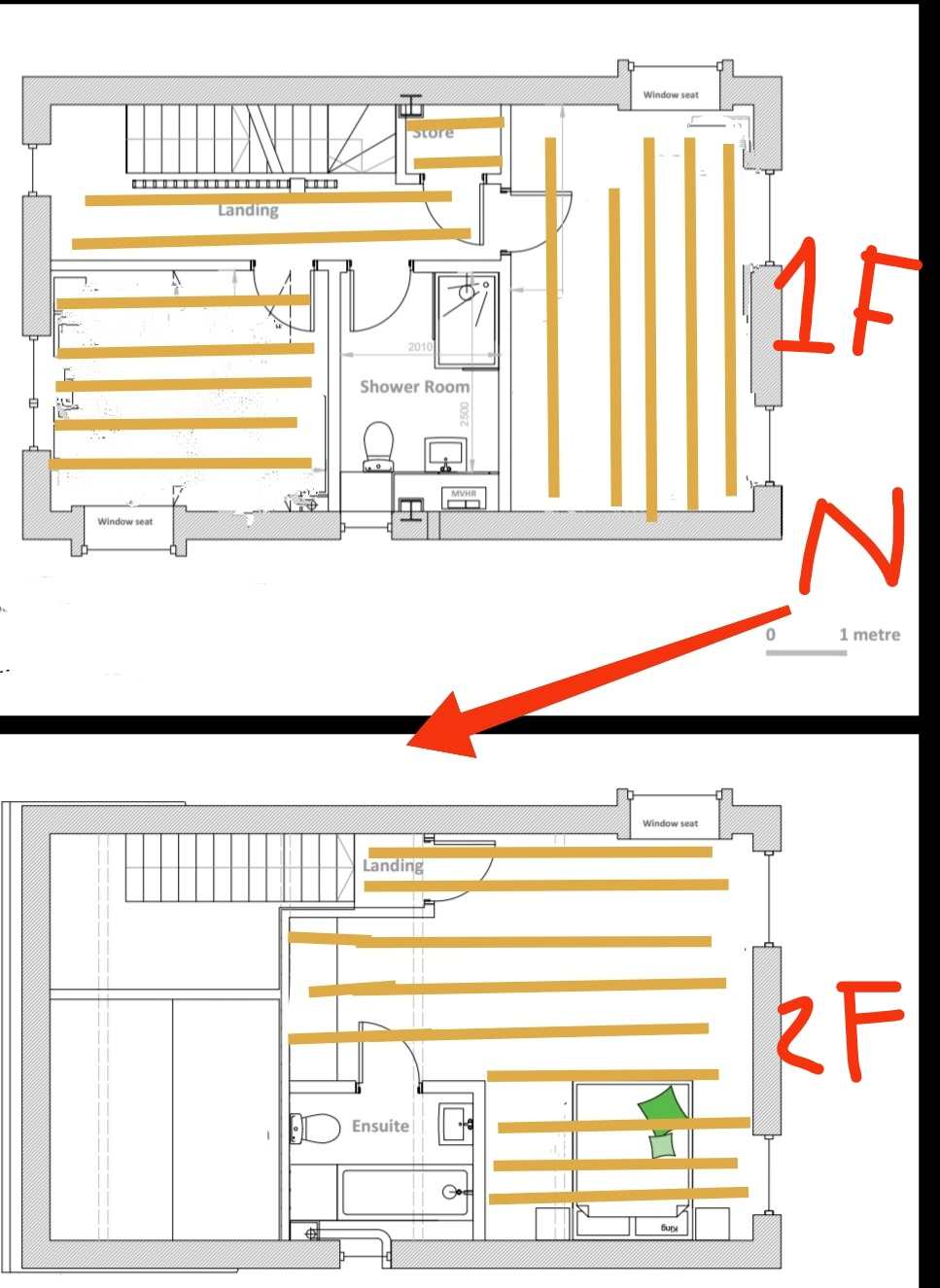

YorkieSelfBuild Posted 19 hours ago Posted 19 hours ago Hi, I'm trying to decide on the orientation of plank flooring. I think I'd prefer to avoid transition strips so the landing dictates it goes left to right. The right hand side bedrooms are complicated as they have double aspect windows so sunlight will come from top and right, and the 1st floor room's longest wall is vertical while the 2nd floor room's is horizontal. Currently I have the planks follow the longest wall. What do people think? Any suggestions to improve it? Cheers
Crofter Posted 16 hours ago Posted 16 hours ago It's really just a question of aesthetics, but I don't like the idea of using different plank directions on the same floor of the house.
nod Posted 11 hours ago Posted 11 hours ago Ideally planks should run along the length of the room Even if it means them changing direction from room to room
nod Posted 11 hours ago Posted 11 hours ago Just now, nod said: Ideally planks should run along the length of the room Even if it means them changing direction from room to room 1
JohnMo Posted 10 hours ago Posted 10 hours ago Just choose a direction and sticks with it. Left to right for all rooms and halls or up down for all. I prefer them running from windows instead of across the main windows, so my case all would run left to right.
nod Posted 9 hours ago Posted 9 hours ago 1 hour ago, JohnMo said: Just choose a direction and sticks with it. Left to right for all rooms and halls or up down for all. I prefer them running from windows instead of across the main windows, so my case all would run left to right. It’s more to do with keeping looking realistic The joists would normally span the shortest part of the room Hence the boards running length ways
ProDave Posted 8 hours ago Posted 8 hours ago 39 minutes ago, nod said: It’s more to do with keeping looking realistic The joists would normally span the shortest part of the room Hence the boards running length ways Mine all span the longest part of the room. But mine are structural so span across the joists, which of course all span the shortest part of the room.
nod Posted 8 hours ago Posted 8 hours ago 25 minutes ago, ProDave said: Mine all span the longest part of the room. But mine are structural so span across the joists, which of course all span the shortest part of the room. Normally😂😂
YorkieSelfBuild Posted 8 hours ago Author Posted 8 hours ago I'm leaning towards all left to right now, which was my original idea. It's LVT so I'll loose lay to see if vertical works for that 1st floor bedroom. Thanks for all the replies!
