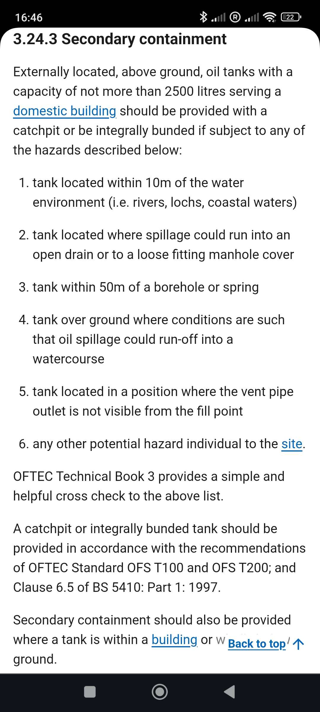

saveasteading Posted Friday at 22:21 Posted Friday at 22:21 Our 2000 iitre, plastic oil tank is getting old. It is fading, and perhaps getting brittle after 30 years. It is about 1.5m to the boundary, with nothing near. There is no drainage or watercourse near. My reading of the building regulations is that it can be single skin on a hard base (blinded stone would be easiest). I see lots of 'advice' online saying that it "should" or " must" be bunded, double bunded, double skin (i know these all mean the same) and on concrete. The regulations do not say any of this, so the advisers would be wrong; deliberately so or mistakenly. The cost difference will be about £2k. What do you say? What I'd really like is a magic paint.

saveasteading Posted Saturday at 15:01 Author Posted Saturday at 15:01 7 hours ago, JohnMo said: bund done correctly allows water (rain) to drain away, but not oil. Clever that! Any idea how that works? I've seen loads and always assumed it was just oversized to prevent that. Even the rainproof double skin plastic ones are said to hold 110%,
Iceverge Posted Saturday at 15:48 Posted Saturday at 15:48 I think single skin is ok if you're more than 10m from a watercourses or 50m from a bore hole. Paving slabs or concrete seem to be suggested though. https://www.oftec.org/consumers/off-gas-grid-guides/home-guide-to-domestic-liquid-fuel-storage-up-to-3500-litres
saveasteading Posted Saturday at 16:21 Author Posted Saturday at 16:21 Thanks @Iceverge. That's one of the pages I found. Vague. Should, might, if etc "Ask one of our approved techiicians" is their main thrust. So now I have to convince an approved technician that should / could etc do not mean the same as must. Or do it myself without the small amount of plumbing being by a proper plumber, which I'd rather it was. We are looking at the difference between a £700 tank or £1800. Plus margins. And whether on the existing stone base or a new concrete one.
Iceverge Posted Saturday at 17:08 Posted Saturday at 17:08 (edited) The whole thing is worded very much like " you really should pay us to do it properly" while stopping short of mandating it. I can't see anything to stop you making a reasoned assessment of the criteria and self installing. I also don't think a good quality single skin plastic tank is much more risky than a double skinned one provided steps are taken to prevent it from external damage. Even an appropriate paint should keep the UV away. Edited Saturday at 17:10 by Iceverge 1

saveasteading Posted Saturday at 22:19 Author Posted Saturday at 22:19 4 hours ago, ProDave said: no problem just installing mine myself on the previous house, I would have to allow for pumping out the oil then returning it to the new tank. Was the plumbing part simple? I wouldn't need to involve the bco. Quote was well over £4k. diy more like 1.5. For a couple of days' work even slowly. I'm hoping there's nothing complex eg the boiler will suck the oil in past the tiger loop.
