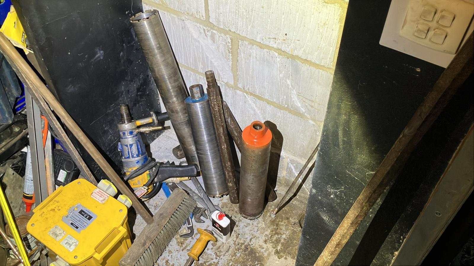

Onoff Posted August 23, 2025 Posted August 23, 2025 I'm core drilling and grinding at the mo off a 32A plug in trannie. Just done 1.3m through solid concrete at 102/107mm dia. Core bit was frequently sticking, amps ramping up and things getting hot. No 13A fuse popped.

Adrock Posted August 23, 2025 Posted August 23, 2025 13 minutes ago, Onoff said: I'm core drilling and grinding at the mo off a 32A plug in trannie. Just done 1.3m through solid concrete at 102/107mm dia. Core bit was frequently sticking, amps ramping up and things getting hot. No 13A fuse popped. What rig are you using? Diamond drilling rigs probably don't get anywhere near 2000W. 13A at 230V is a LOT of power to be using continuously, you'll struggle to do that with one or even two tools on the go.

Onoff Posted August 23, 2025 Posted August 23, 2025 2 hours ago, Adrock said: What rig are you using? Diamond drilling rigs probably don't get anywhere near 2000W. 13A at 230V is a LOT of power to be using continuously, you'll struggle to do that with one or even two tools on the go. Dunno, this wrist breaker!
saveasteading Posted August 23, 2025 Posted August 23, 2025 2 minutes ago, Onoff said: this wrist breaker! Turn the speed down, don't press too hard and let the blade work. If I can do it, so can anyone. I did 4 of 150mm with one layer of mesh in an hour and no pain. The drill was nothing special in weight or Watts, just smooth.
