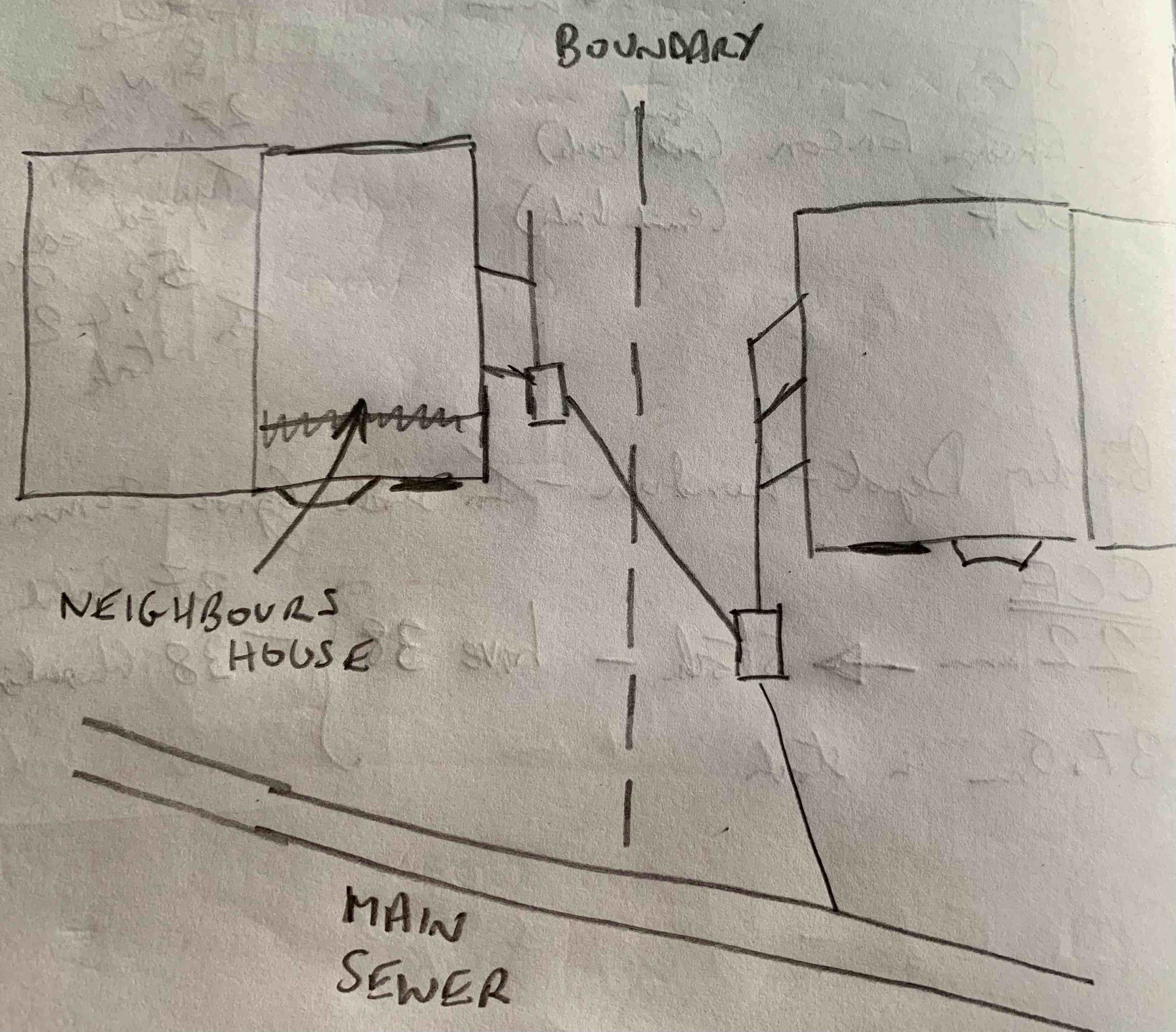

Spinny Posted August 16, 2025 Posted August 16, 2025 Please can anyone advise on building over a domestic drainage access/inspection chamber ? Is this permitted by building regulations ? (My neighbour has advised he plans to build an extension over the access/inspection chamber for his drain and install a floor hatch for access. (Sub floor void likely to be 60-75cm). This drain then crosses the boundary to join our drain and therefore as I understand it becomes a public drain at that point.)
Mr Punter Posted August 16, 2025 Posted August 16, 2025 They will need to retain the access / inspection chamber or make alternative access / inspection points.
JuddlyFire Posted August 16, 2025 Posted August 16, 2025 Buildings or extensions should not be constructed over a manhole or inspection chamber or other access fitting on any sewer (serving more than one property) (Document G, Section Index, paragraph 1.3, page 808)↗. Approved Document H1 Section 2, paragraph 2.53 provides that access points to sewers (serving more than one property) should be in places where they are accessible and apparent for use in an emergency (Document G, Section Index, paragraph 1.3, page 808)↗. If an extension is to be constructed, the access/inspection chamber must be retained or alternative access/inspection points made, as indicated in the requirement that buildings and extensions should not be located where they would remove such a provision where this already exists, unless an alternative access point can be provided on the line of the sewer at a location acceptable to the owner (i.e. the sewerage undertaker in the case of a public sewer) (Document G, Section Index, paragraph 1.3, page 808)↗. Note that the drain in question becomes a public drain once it crosses the boundary and joins the neighbor's drain, so it would be subject to the regulations regarding public sewers. The_Merged_Approved_Documents_Oct24.pdf 1
Spinny Posted August 16, 2025 Author Posted August 16, 2025 (edited) The neighbour's drain does not 'serve' my property, rather the neighbour's drain exits the inspection chamber at the side of his property then crosses the boundary and feeds into the inspection chamber on my property. My drain also feeds into the inspection chamber on my property. The inspection chamber on my property is then connected onwards to flow into the main sewer serving the houses on my side of the street. So unless there is some special meaning to the word serve, it would seem the inspection chamber on my property and the pipe that crosses the boundary onto my land to connect to it 'serves' his property. Therefore it seems he can build over it ? He says he will retain access to it via a hatch in the floor above it. Am I missing something ? Edited August 16, 2025 by Spinny
Spinny Posted August 16, 2025 Author Posted August 16, 2025 (edited) Also note that none of these drains are shown on the 'sewer map' held by the local sewer company. Their map only shows the main sewer and does not show any of the chambers and pipework that connect all the properties to the main sewer. When I last spoke to the sewer company they said my chamber and the pipe to the boundary were indeed public sewers even though not shown on their map. Furthermore they said they did not need to be added to their map as all public sewers were their responsibility anyway. (Not sure now whether this might just be the sewer company avoiding extending their map ?) This seems like a huge hole in the building regulations...? (Is this really meant to mean you can do as you please with a drain/sewer not shown on a map - which presumably means millions around the country ?) Quote Requirement H4 applies only to work carried out: (a) over a drain, sewer or disposal main which is shown on any map of sewers; or (b) on any site or in such a manner as may result in interference with the use of, or obstruction of the access of any person to, any drain, sewer or disposal main which is shown on any map of sewers. Edited August 16, 2025 by Spinny

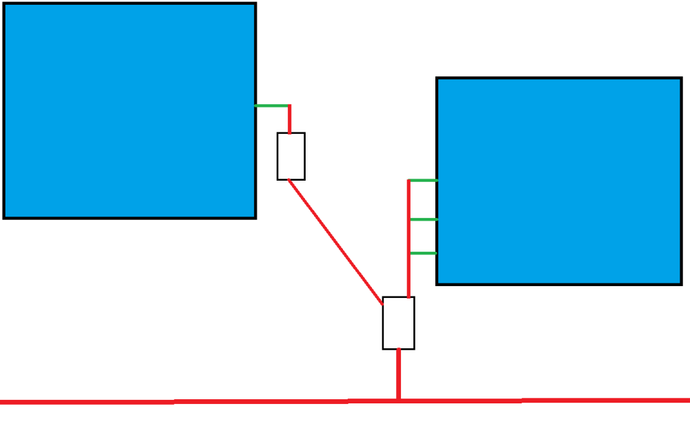

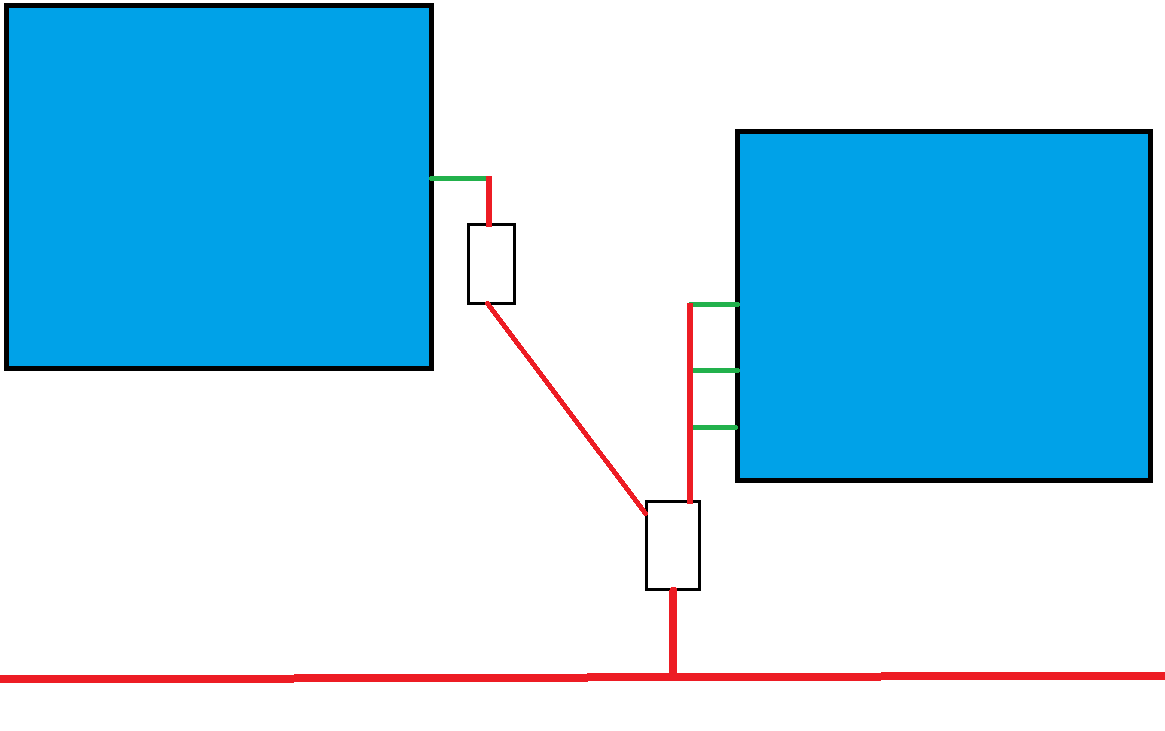

JuddlyFire Posted August 17, 2025 Posted August 17, 2025 The core regulation states: "Buildings or extensions should not be constructed over a manhole or inspection chamber or other access fitting on any sewer (serving more than one property)." (Document G, Section Index, paragraph 1.3, page 808)↗ This is quite clear - you generally cannot build over these access points when they serve multiple properties. In this specific case, the critical question is whether the drain in question qualifies as a "sewer serving more than one property." Based on your description and diagram, since the neighbour's drain crosses the boundary and connects to your inspection chamber (which both properties feed into), this appears to be exactly the type of sewer the regulation is addressing yet the sewer company identifies the entire system as a public sewer (even if not on their map) conflicts with this interpretation. (Document G, Section Index, paragraph 1.3, page 808)↗ There's an important exception to note: "Buildings and extensions should not be located where they would remove such a provision where this already exists, unless an alternative access point can be provided on the line of the sewer at a location acceptable to the owner (i.e. the sewerage undertaker in the case of a public sewer)." (Document G, Section Index, paragraph 1.3, page 808)↗ This means: Simply installing a floor hatch (as your neighbour proposes) might be acceptable BUT it must be approved by the sewerage undertaker The alternative access must be "on the line of the sewer" and "acceptable to the owner" Regarding your concern about maps: The regulations do state "These provisions apply to the construction, extension or underpinning of a building over or within 3m of the centreline of an existing drain, sewer or disposal main shown on the sewerage undertaker's sewer records..." (Document G, Section Index, paragraph 0.1, page 807)↗ However, the sewer company has already confirmed this is a public sewer despite not being on their map. The key precedent here is that the sewer company has already stated these are public sewers. Their position carries significant weight in determining regulatory applicability. You should contact them directly with your neighbour's plans to get their official position. I'd recommend your neighbour: Formally consult the sewerage undertaker before proceeding (Document G, Section Index, paragraph 0.3, page 808)↗ Submit detailed plans showing how the floor hatch will provide adequate emergency access Get written approval from the sewerage undertaker Without this approval, building control would likely reject the plans since "Where it is proposed to construct a building over or near a drain or sewer shown on any map of sewers, the developer should consult the owner of the drain or sewer..." (Document G, Section Index, paragraph 0.3, page 808)↗ - and in this case, the sewer company has already established it's their responsibility. This isn't a "huge hole" in the regulations - it's a situation where professional judgment from the sewerage undertaker is required, which is common in boundary drainage situations. Source File: The_Merged_Approved_Documents_Oct24.pdf 1
mjc55 Posted August 17, 2025 Posted August 17, 2025 But at that point it isn't actually serving more than one property. When the utility took over the maintenance of sewers on private land (was it early 2000's or early 2010's - I can't remember) the first in the line of drains remained private and only became public on the second property they served. 1
JuddlyFire Posted August 17, 2025 Posted August 17, 2025 1 hour ago, mjc55 said: But at that point it isn't actually serving more than one property. When the utility took over the maintenance of sewers on private land (was it early 2000's or early 2010's - I can't remember) the first in the line of drains remained private and only became public on the second property they served. That makes intuitive sense. Do you have a link or reference?
Spinny Posted August 17, 2025 Author Posted August 17, 2025 1 hour ago, Nickfromwales said: It will not / cannot affect you in any way whatsoever It can and may well affect us in multiple ways. 1/ The chamber on our land has blocked several times in the past. Difficult to definitevely assign cause between the properties but has sometimes appeared to be caused by products used by the previous neighbour. 2/ When that shared chamber becomes blocked it causes backup down our drains because our property is about 1 meter lower than the neighbours. Anything from the neighbours drain that cannot then exit the chamber will back flow down our drains and in extremis emerge through our surface drains. 3/ Once built over, whatever the theory that they will lift a hatch in their floor, unseal their underfloor drain cover (releasing smells into their property), send a rodder under the floor to clean/inspect then reseal etc seems unlikely in practice. So any future drain issue on their property is likely to generate requests to service their drains from our property as they will have no ready access from their own chamber. 4/ They have no construction plans and have declined to answer any polite questions about the rainwater drainage arrangements which appear to include taking water from the main roof and extension and using downpipes at the boundary with no apparent drainage routes. 5/ Should they build without adhering to the regs, it may not just impact the saleability of their own property, but given the connection and being lower lying - our own property too once searches and questionnaires show the existence of the shared/public drain on our land. No building notice is registered yet despite work being imminent. Few, polite and straightforward questions were all rejected at the party wall stage - a truly ridiculous game of chinese whispers and obstruction. Odd, dishonest, and deceiving behaviour throughout. I accept it is 'up to them' to adhere (or not) to regs but given the circumstances remain extremely concerned.
Nickfromwales Posted August 17, 2025 Posted August 17, 2025 1 minute ago, Spinny said: 1/ The chamber on our land has blocked several times in the past. Difficult to definitevely assign cause between the properties but has sometimes appeared to be caused by products used by the previous neighbour. 2/ When that shared chamber becomes blocked it causes backup down our drains because our property is about 1 meter lower than the neighbours. Anything from the neighbours drain that cannot then exit the chamber will back flow down our drains and in extremis emerge through our surface drains. Respectfully, that info would have been appreciated a little earlier on in the thread…… Agreed, that changes the dynamics here.

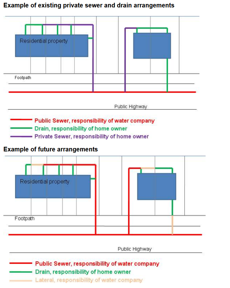

mjc55 Posted August 17, 2025 Posted August 17, 2025 (edited) 15 minutes ago, JuddlyFire said: That makes intuitive sense. Do you have a link or reference? Could have a look here Includes the statement Quote On 1 October 2011 all privately owned sewers and lateral drains which communicate with (that is drain to) an existing public sewer as at 1 July 2011 will become the responsibility of the sewerage undertaker – normally the water and sewerage company for the are On page 7 there are diagrams indicating how this would change the ownership of various parts of the system. Edited August 17, 2025 by mjc55 2
Onoff Posted August 17, 2025 Posted August 17, 2025 My first house was a terrace. A communal footpath, serving all houses ran behind the houses with the back gardens beyond that. The sewer ran under this path. Everyone had their own manhole. It served 7 terraces and the pub on the end. It then ran along to the end terrace, up the side of that into the main sewer. I seem to recall some council or water board obligation whereby if it became blocked they always cleared it without charge.
JuddlyFire Posted August 17, 2025 Posted August 17, 2025 2 hours ago, mjc55 said: Could have a look here Includes the statement On page 7 there are diagrams indicating how this would change the ownership of various parts of the system. "A. Which assets will be transferred? (i) The Scope and Extent of Transfer 1. The aim of transfer is to relieve the owners of private underground drainage of responsibility for its maintenance where that drainage connects to the public sewerage system. Where existing foul, surface water or combined sewers, and any drains of that nature serving individual properties which are outside the curtilage of the property they serve, connect to the public sewerage system then the ownership of and responsibility for their maintenance will transfer to the water and sewerage company for the area." & 4 hours ago, JuddlyFire said: The core regulation states: "Buildings or extensions should not be constructed over a manhole or inspection chamber or other access fitting on any sewer (serving more than one property)." (Document G, Section Index, paragraph 1.3, page 808)↗ This is quite clear - you generally cannot build over these access points when they serve multiple properties. In this specific case, the critical question is whether the drain in question qualifies as a "sewer serving more than one property." Based on your description and diagram, since the neighbour's drain crosses the boundary and connects to your inspection chamber (which both properties feed into), this appears to be exactly the type of sewer the regulation is addressing yet the sewer company identifies the entire system as a public sewer (even if not on their map) conflicts with this interpretation. (Document G, Section Index, paragraph 1.3, page 808)↗ There's an important exception to note: "Buildings and extensions should not be located where they would remove such a provision where this already exists, unless an alternative access point can be provided on the line of the sewer at a location acceptable to the owner (i.e. the sewerage undertaker in the case of a public sewer)." (Document G, Section Index, paragraph 1.3, page 808)↗ This means: Simply installing a floor hatch (as your neighbour proposes) might be acceptable BUT it must be approved by the sewerage undertaker The alternative access must be "on the line of the sewer" and "acceptable to the owner" Regarding your concern about maps: The regulations do state "These provisions apply to the construction, extension or underpinning of a building over or within 3m of the centreline of an existing drain, sewer or disposal main shown on the sewerage undertaker's sewer records..." (Document G, Section Index, paragraph 0.1, page 807)↗ However, the sewer company has already confirmed this is a public sewer despite not being on their map. The key precedent here is that the sewer company has already stated these are public sewers. Their position carries significant weight in determining regulatory applicability. You should contact them directly with your neighbour's plans to get their official position. I'd recommend your neighbour: Formally consult the sewerage undertaker before proceeding (Document G, Section Index, paragraph 0.3, page 808)↗ Submit detailed plans showing how the floor hatch will provide adequate emergency access Get written approval from the sewerage undertaker Without this approval, building control would likely reject the plans since "Where it is proposed to construct a building over or near a drain or sewer shown on any map of sewers, the developer should consult the owner of the drain or sewer..." (Document G, Section Index, paragraph 0.3, page 808)↗ - and in this case, the sewer company has already established it's their responsibility. This isn't a "huge hole" in the regulations - it's a situation where professional judgment from the sewerage undertaker is required, which is common in boundary drainage situations. Source File: The_Merged_Approved_Documents_Oct24.pdf Leaves you in a strong position to protest any works, or more realistically have the neighbour install a new inspection pit as part of their build.
mjc55 Posted August 17, 2025 Posted August 17, 2025 10 minutes ago, JuddlyFire said: "A. Which assets will be transferred? (i) The Scope and Extent of Transfer 1. The aim of transfer is to relieve the owners of private underground drainage of responsibility for its maintenance where that drainage connects to the public sewerage system. Where existing foul, surface water or combined sewers, and any drains of that nature serving individual properties which are outside the curtilage of the property they serve, connect to the public sewerage system then the ownership of and responsibility for their maintenance will transfer to the water and sewerage company for the area." & Leaves you in a strong position to protest any works, or more realistically have the neighbour install a new inspection pit as part of their build. You haven't looked at the diagram. The neighbours drains are private.
JuddlyFire Posted August 17, 2025 Posted August 17, 2025 What am I missing? "ownership of and responsibility for their maintenance will transfer to the water and sewerage company"
mjc55 Posted August 17, 2025 Posted August 17, 2025 (edited) 14 minutes ago, JuddlyFire said: What am I missing? "ownership of and responsibility for their maintenance will transfer to the water and sewerage company" The first house that connects to the drain run will still have private drains, it is only the subsequent connections that are public. i.e. the property where the run commences. Edited August 17, 2025 by mjc55
