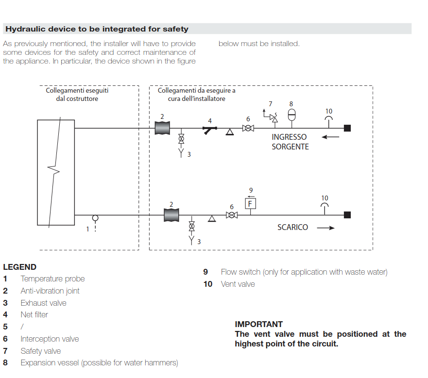

SimonD Posted May 27 Posted May 27 22 minutes ago, Pocster said: https://cooleasy.co.uk/products/powrmatic-vision-h2o???? 3k! presumably is the condenser aswell??? For a minute I thought you'd uncovered a blinder of a solution. Well, maybe not quite as simple as hoped, unless you're happy to tap into your heating system. Have a look at the required schematic. Easier to go with the 2 hole versions probably.
Pocster Posted May 27 Author Posted May 27 49 minutes ago, SimonD said: For a minute I thought you'd uncovered a blinder of a solution. Well, maybe not quite as simple as hoped, unless you're happy to tap into your heating system. Have a look at the required schematic. Easier to go with the 2 hole versions probably. My link is!. water in, electric in, drain out. Cost is upsetting though.... Looking back at cheap mobile units where you jsut sticka vent out the door and seal that gap up....
SimonD Posted May 27 Posted May 27 53 minutes ago, Pocster said: My link is!. water in, electric in, drain out. If only it were that simple. The screenshot is from the installation manual for that exact model - the Powrmatic Vision H20. I'm more inclined to believe the manufacturer than the salesman? Think about it. It's a bonkers idea that you just turn a mains tap on and then let it run into a drain? 1 hour ago, Pocster said: Cost is upsetting though Yes, the through wall ones can be had for about 1/2 that price.

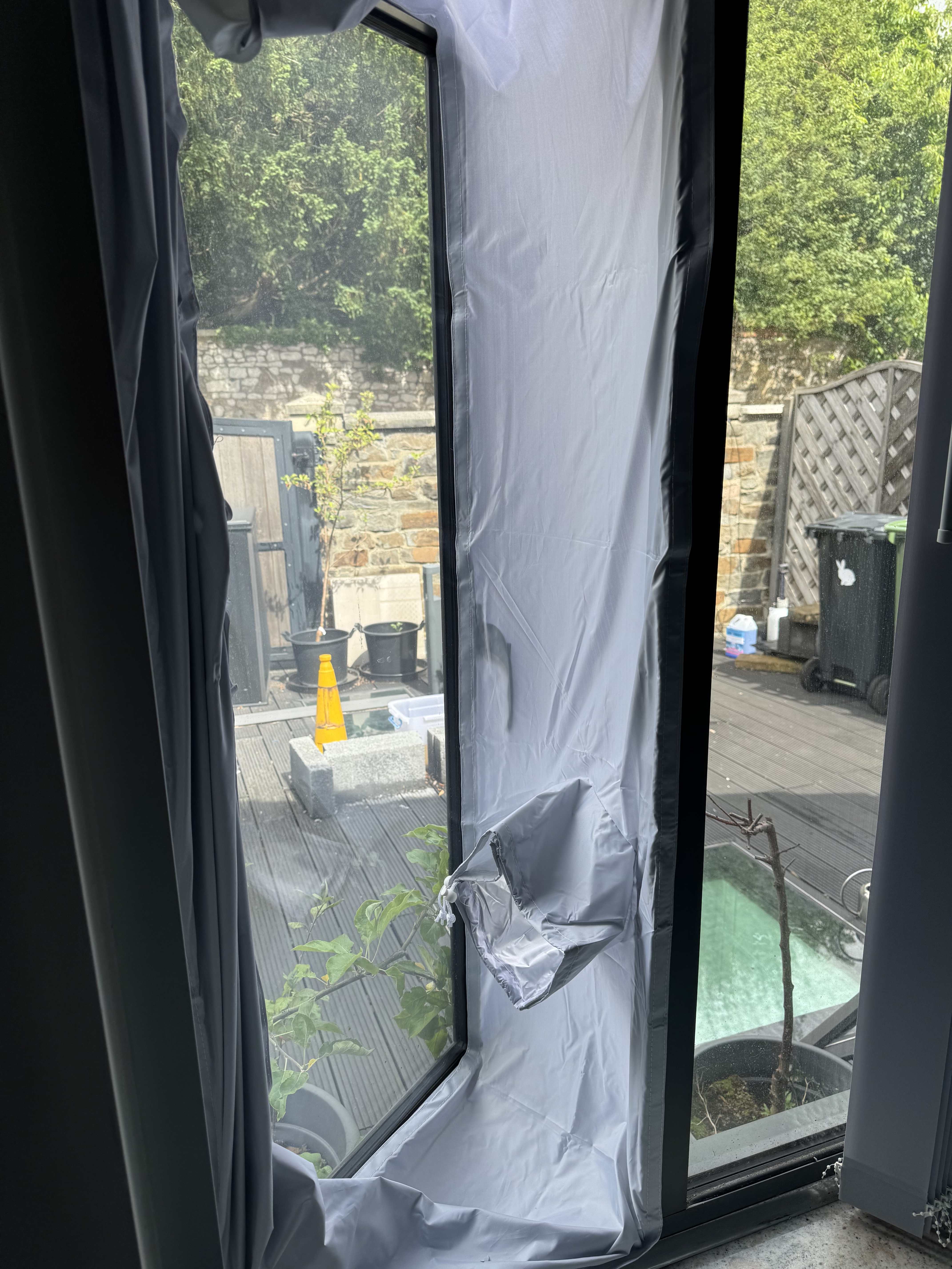

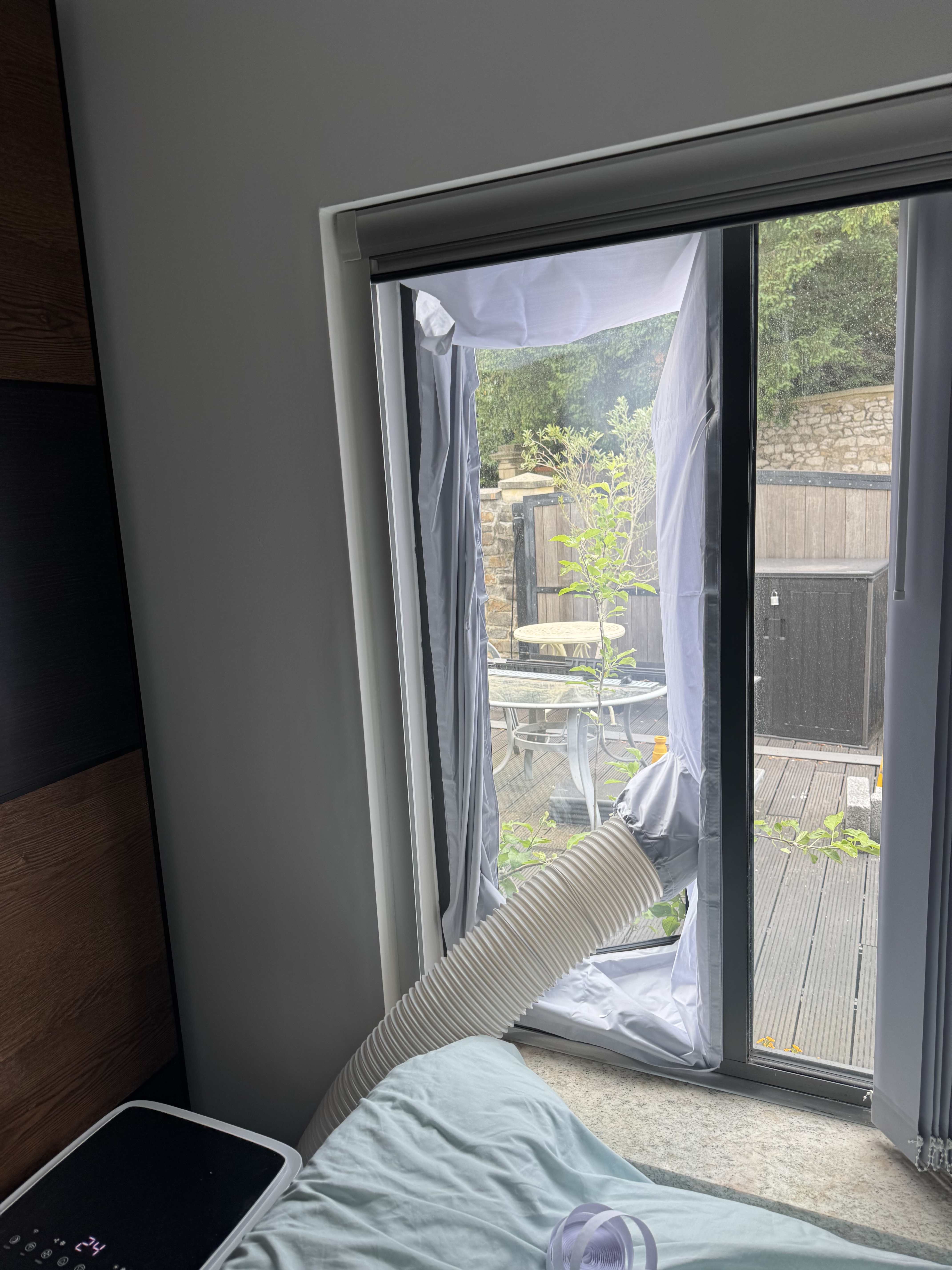

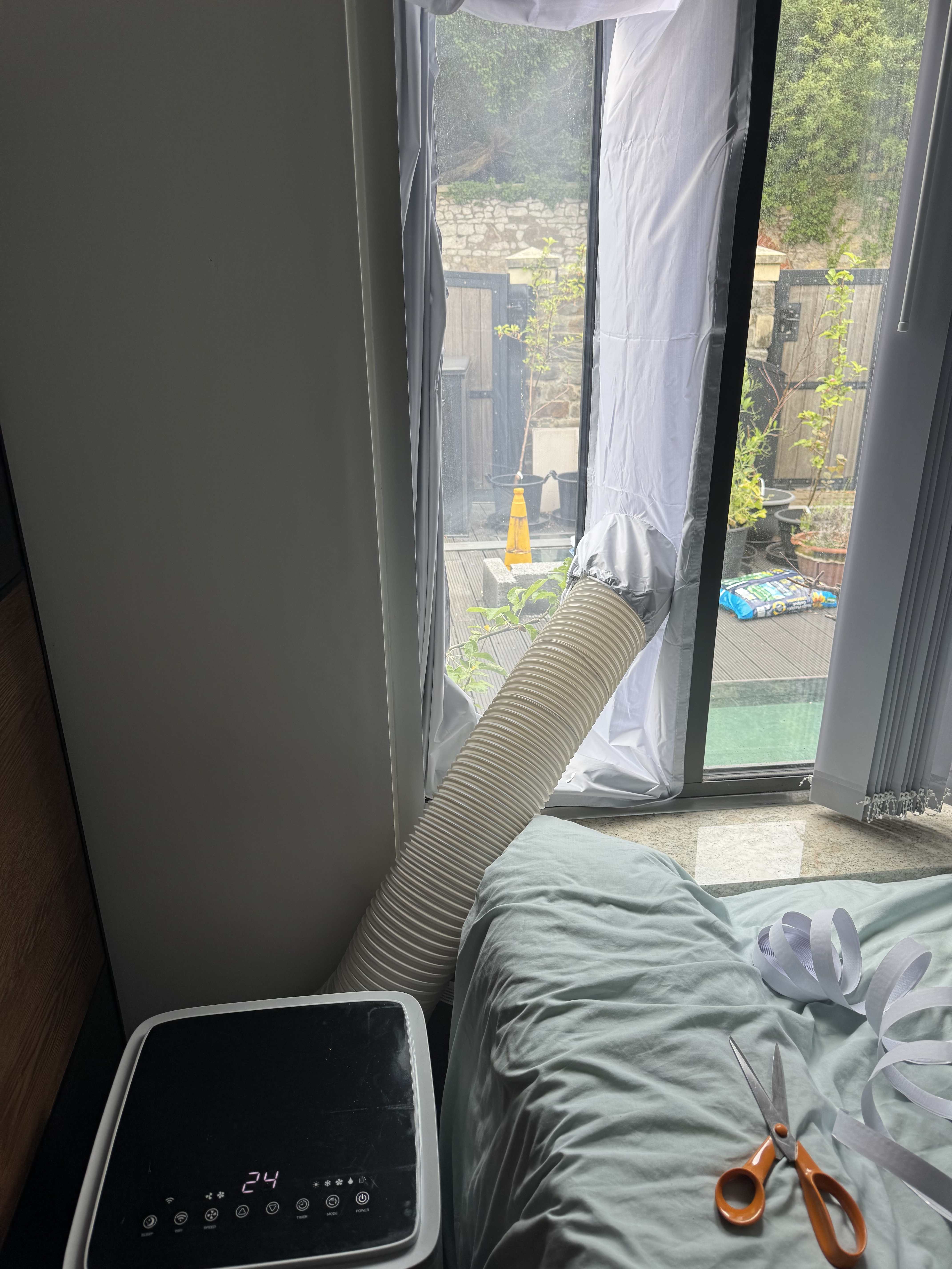

Pocster Posted June 2 Author Posted June 2 What a pile of wank . I think just a piece of ply somehow fixed to opening ( not (expletive deleted)ing window ) would be better ! Wank concept and wank install 2
Pocster Posted June 2 Author Posted June 2 (edited) Presumably I go out and burglar just opens window and steals everything. shite I think a simple piece of board fixed against frame with hole in would be better . Take seconds to setup and take down . This is shite with a capital S ! Edited June 2 by Pocster 2

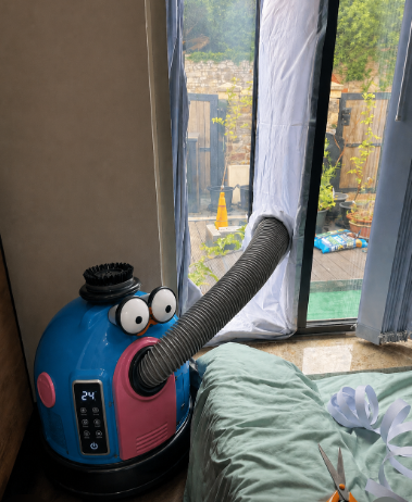

Pocster Posted June 2 Author Posted June 2 4 minutes ago, crispy_wafer said: what the feck on earth is that? Don’t just don’t !
Ed_ Posted June 2 Posted June 2 Some of these portable AC units can be simply modified so that the air intake is ducted outside too which makes it closed loop. A whole internet ecosystem of people doing it!
