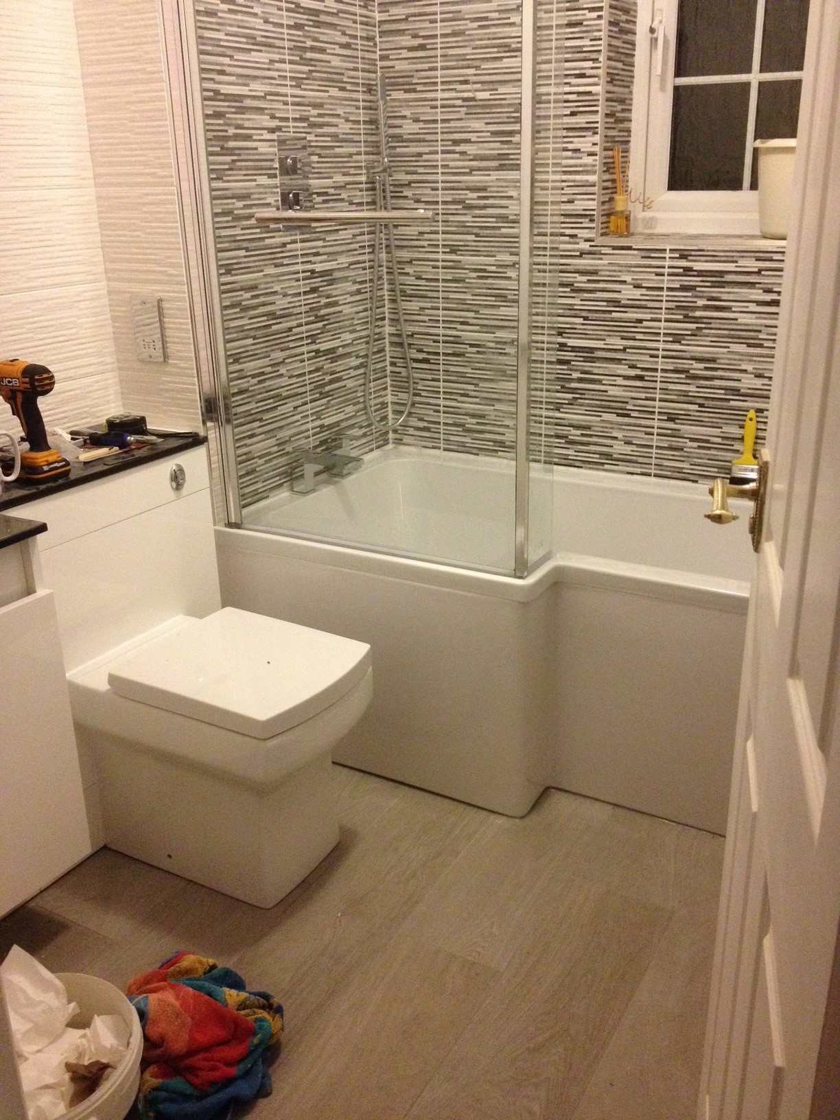

Nickfromwales Posted Thursday at 21:57 Posted Thursday at 21:57 I'd say avoid steel. I've seen too many with the enamel chipped and then they start to rust. Search up trojan cast too, for properly tough reinforced acrylic / grp types. Standard flimsy baths are not designed for you to stand in, that's why shower-baths always come slightly more robust, to take the point pressure of you standing in one spot. 29 minutes ago, marshian said: My solution was to use the feet from the previous bath as well as the ones supplied with the new bath (so 8 feet not 4 feet) Same. Makes a good job great, and as I was often removing U/S baths I kept the tidy feet for such instances. 1
marshian Posted Thursday at 22:23 Posted Thursday at 22:23 (edited) 33 minutes ago, Nickfromwales said: Same. Makes a good job great, and as I was often removing U/S baths I kept the tidy feet for such instances. I couldn't put my finger on why it didn't feel right it just didn't - it wasn't tiled in or siliconed to the wall but in hindsight the way a bath is used for a shower is completely different in terms of feel to when it's used as a bath - 80 litres of water and an 85 kg person laying down in it is completely different loading to zero water and an 85 kg person standing at one end with the bath supported by 4 points of contact aligned more to the middle section. Increasing the number of braces to 4 and feet to 8 really changed the solidity of the bath. One day I'll get rid of the cheap ass plastic panel and build a proper tiled one with the spare tiles I bought to do it and kept aside under the bath Yeah we all have one day jobs like that.............. But then again as Mrs Alien chose the tiles and they my my eyes squint and remind me of a stiff little fingers album cover I probably won't Edited Thursday at 22:31 by marshian Add picture 1
Nickfromwales Posted Thursday at 23:39 Posted Thursday at 23:39 1 hour ago, marshian said: I couldn't put my finger on why it didn't feel right it just didn't - it wasn't tiled in or siliconed to the wall but in hindsight the way a bath is used for a shower is completely different in terms of feel to when it's used as a bath - 80 litres of water and an 85 kg person laying down in it is completely different loading to zero water and an 85 kg person standing at one end with the bath supported by 4 points of contact aligned more to the middle section. Increasing the number of braces to 4 and feet to 8 really changed the solidity of the bath. One day I'll get rid of the cheap ass plastic panel and build a proper tiled one with the spare tiles I bought to do it and kept aside under the bath Yeah we all have one day jobs like that.............. But then again as Mrs Alien chose the tiles and they my my eyes squint and remind me of a stiff little fingers album cover I probably won't Not sure how to tell you this......... ..but the tiles are on wrong. The lines are suppose to go up/down not left/right. Should be a quick fix though
marshian Posted Thursday at 23:42 Posted Thursday at 23:42 1 minute ago, Nickfromwales said: Not sure how to tell you this......... ..but the tiles are on wrong. The lines are suppose to go up/down not left/right. Should be a quick fix though It’s ok it’s balanced out in the other bathroom they go up down 😉
Nickfromwales Posted Thursday at 23:48 Posted Thursday at 23:48 4 minutes ago, marshian said: It’s ok it’s balanced out in the other bathroom they go up down 😉 Ah........... I was hoping you wouldn't bring that up tbh....... Theyre wrong too. 1
