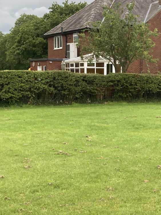

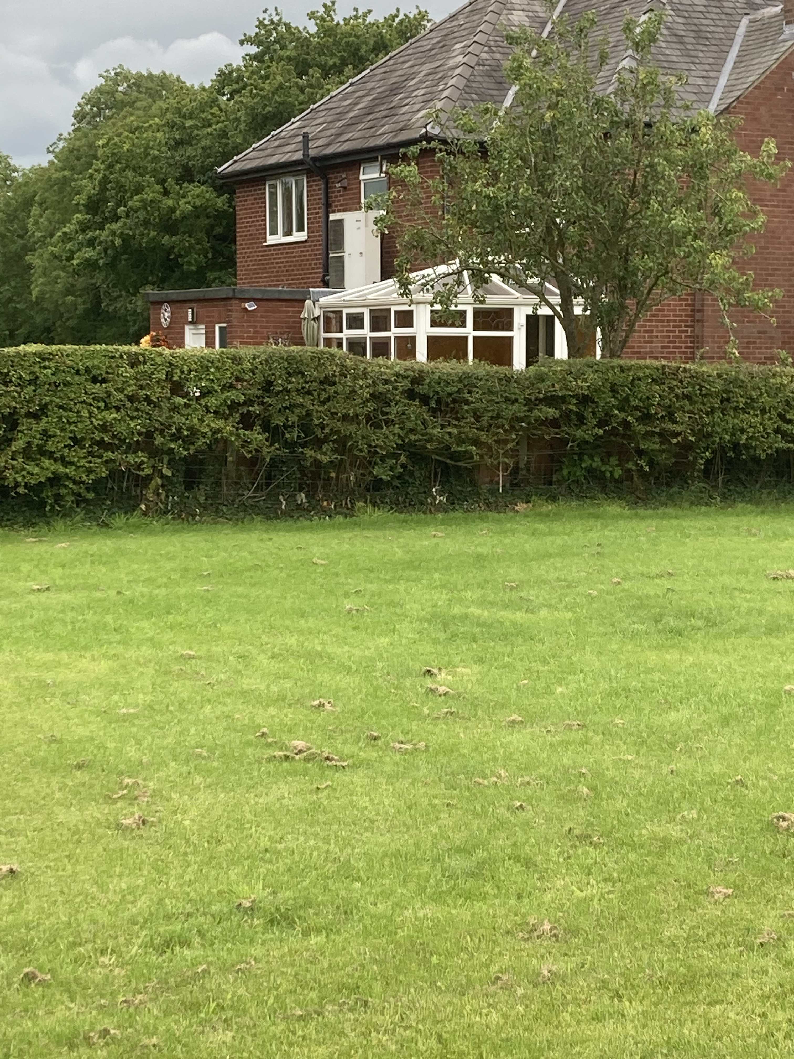

Our neighbor sited there’s on there flat roof some  ten years ago
and it’s been fine up and till this year
Home serve came out to service it and it was deemed a Health and safety risk Three vans later they buggered off with looking at it
They got someone local who had a ladder 😁F9101E4E-AEBA-4FB6-9E13-115F3AF9E485.thumb.jpeg.dc4ae6ee10a21e067c3fe9cd4c5d64b0.jpeg
