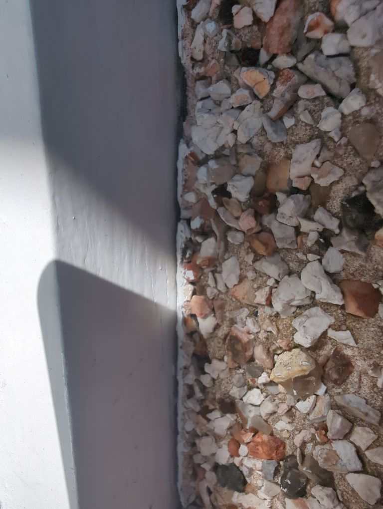

The other day I have removed the silicone in the corners and looked at the door frame (took some pictures) and it looks like the exterior insulation but also the interior plaster came after the doors so it looks like the frame goes deeper than I thought.
I think I have to hack away the plaster to get a better idea and take realistic measurements. From what I know you need to give like 5mm gap on either side of the frame.

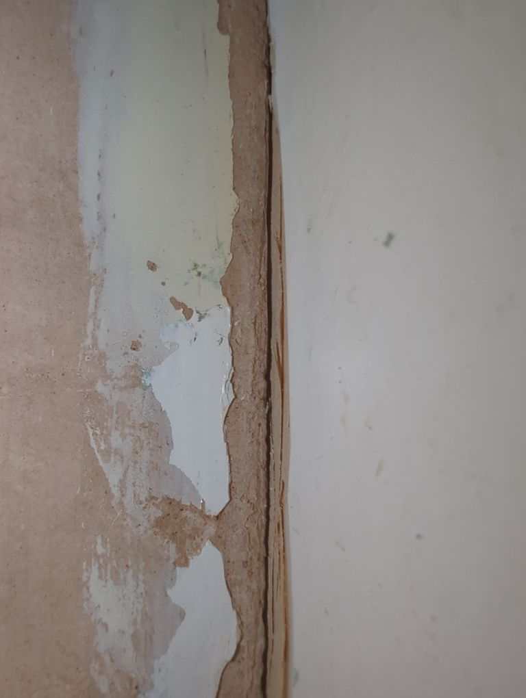

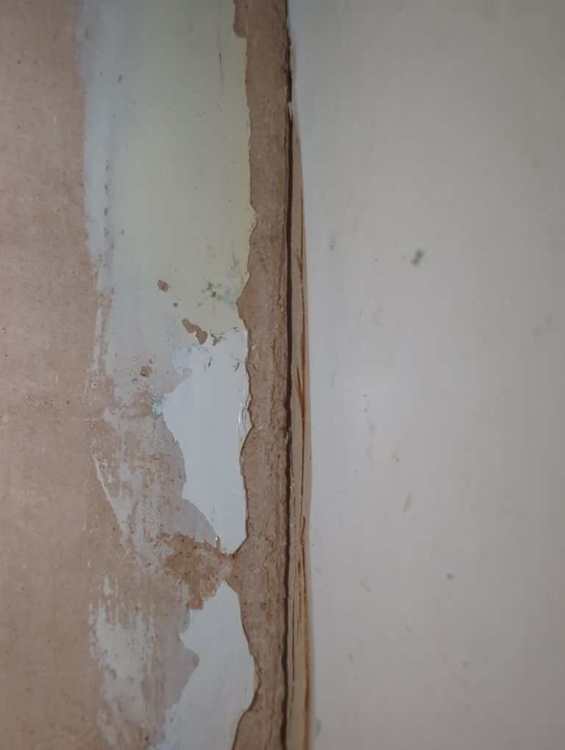

I think the missing is the measurements of the opening itself.
On the top I can see the frame is like 2cm deep into the plaster/plasterboard (second picture). On the sides it is about 0.5cm on each side.
I think I need to hack off more plaster if I want to fit a similar size frame in there.

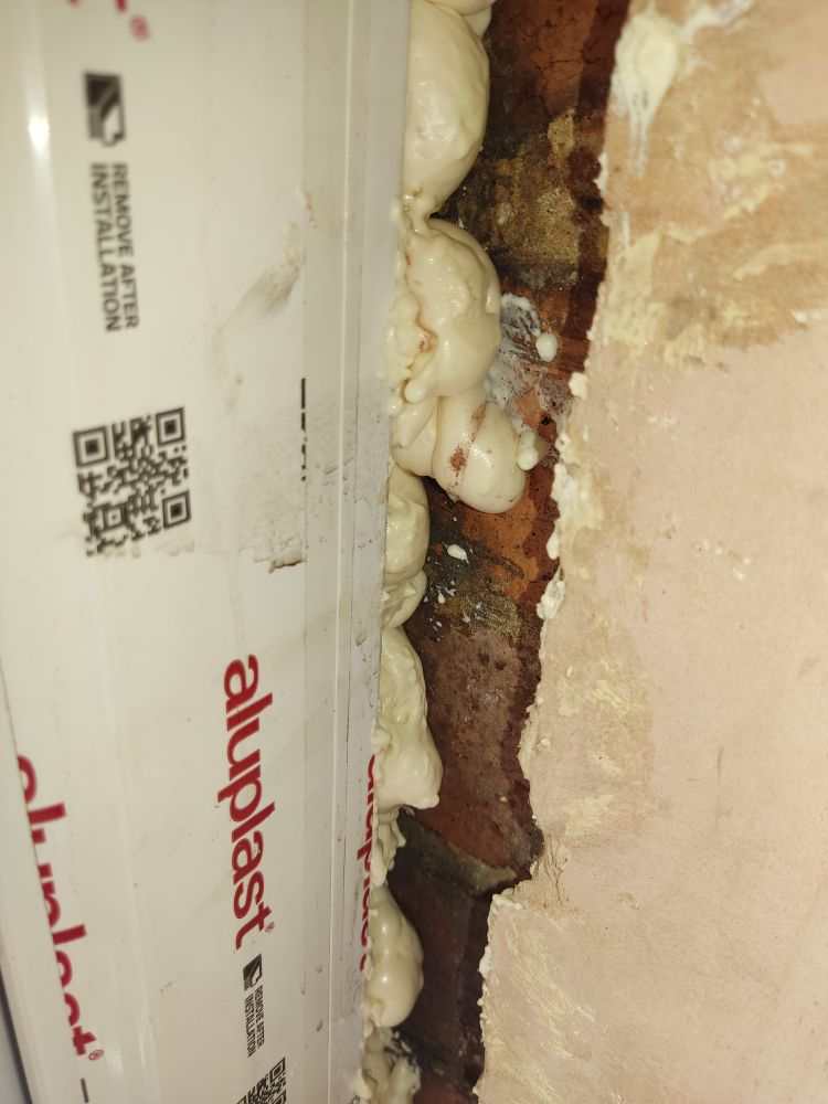

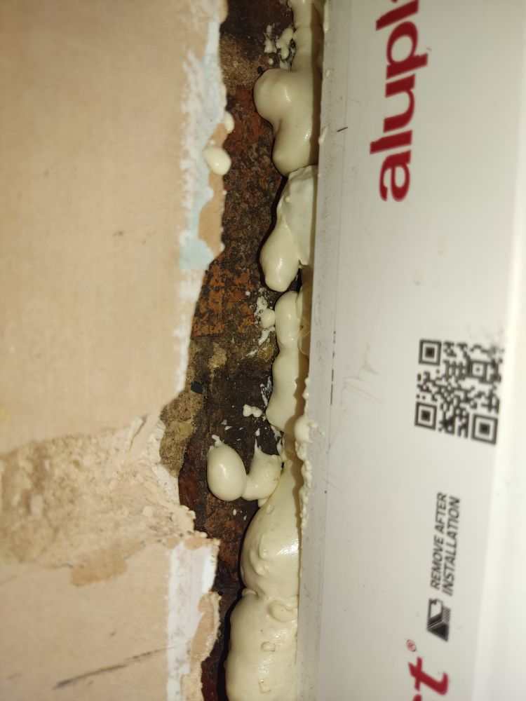

Finally got around replacing the back door.
Do I need to put more foam in there or just plaster it now?
IMG_20260804_143308.thumb.jpg.a51a60b58cd5a604cd5995481c68def5.jpgIMG_20260804_143258.thumb.jpg.1d68f9673c23048e29b56d1b54d1ef0a.jpg
Foam just needs tidied up and then plaster, also aluplast, well done. 4000, 8000 or Energeto? Did you purchase from a UK supplier?
Edited by craig
Do you mean to cut the foam so its flush with the frame?

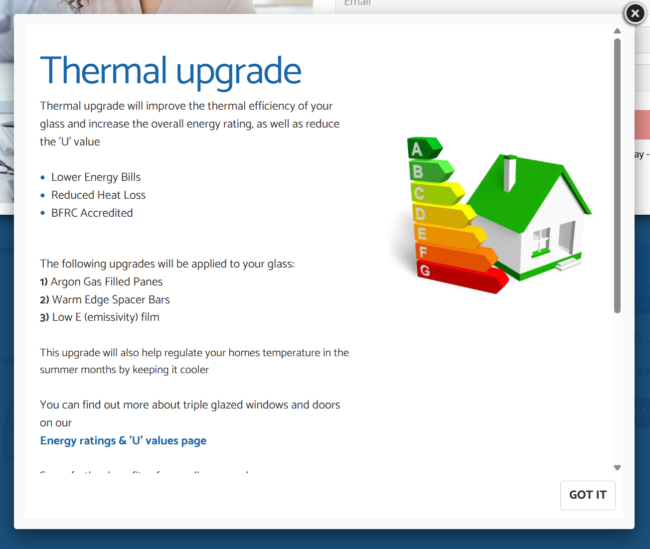

I actually don't know the full spec. It's a bit difficult to find this info at JustValueDoors.
It does have a Thermal upgrade included whatever that means.
Yes, just trim it back, will make your life easier. Without knowing the product supplied, I can't really say what the values are as I would be guessing but in principle, if triple and insulated frame (foam injected into the frame), you're probably looking at the Energeto 8000.

Thermal upgrade is only to the glass
1) Argon Gas Filled Panes
2) Warm Edge Spacer Bars
3) Low E (emissivity) film
JustValueDoors don't state anywhere what maker of the doors they supply or give any options of Aluplast doors.
