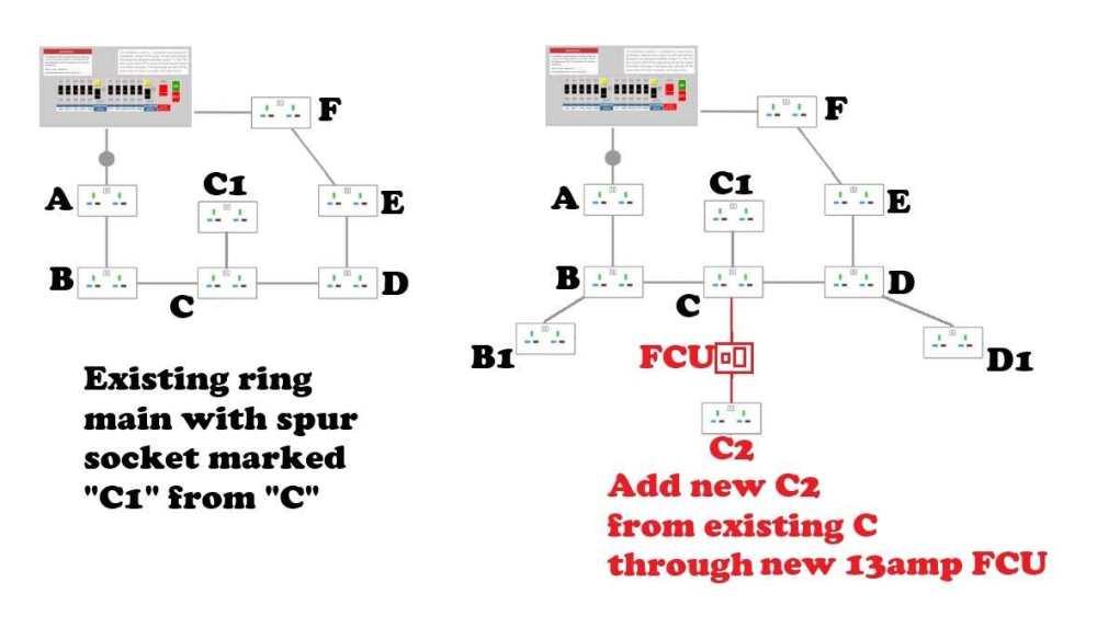

Hey,
I want to add additional socket on a ring main. Initial plan was to spur from existing socket C, however it appeared to be that C and all the other nearby sockets (B and D) already have spurs attached to them ( I am not exactly sure where these spurs from B, C and D are located, as all the wires are in the subfloor and I have not traced the cables nor did any continuity checks).
Could you please let me know if the proposed option on the right is feasible and within the regulations? Or do I need to find locations of either B1, C1 or D1 from B, C and D resprectively, do the break between them to place a 13amp FCU in between and wire these up in order as it should have been done the proper way?
Looking for the suggestions

What you're proposing is permissible, just needs a good eye for making the connections in to the socket that will have 4x2.5mm2 cables in it. No need for the FCU as you can spur off a ring with 1x 1G 13a socket, or 1x2G 13a socket, or 1x 13a FCU feeding whatever, and the only time you need an FCU here is if you planned to take more than 1x the above from the ring.
Is it ideal, no, should you expand the ring main, yes, so the question would be; if you can get single cables to these extra outlets then why not run two and make it one big ring? You'd just Wago the cables in the back-boxes and open the ring up, quite simple to do and you can ask questions here if you need support.
If you're as much as 10% weary of what you're doing then give the job to a sparky. Just do the chases yourself in advance, install the back-boxes, and ask for them to just run cables and connect. A one day visit most prob so budget £250-300 for labour and consumables if you do the "donkey work"

But there is already a spur (C1) off C, so it isn't permissible to also add a FCU spur feeding an additional socket (C2).
Without seeing the cable routes, these appear to be the two easiest solutions:
1) disconnect C1 from C, add the FCU as a spur next to C, and then connect both C1 and C2 to the FCU
2) insert the FCU into the ring by disconnecting the cable between C and D, connecting that cable to the FCU along with a new cable between the FCU and C. You can then add as many extra sockets as you like off the FCU
B1 and D1 are fine - you can add a single spur off an existing socket on a ring.
Not afaik.
C is the ring, so C1 is a single radial spur, and C2 is a single radial spur, each from the ring. Technically this is fine and the terminals in the back of a socket are designed to take 3x 4mm2 or 4x 2.5mm2 also.
As an apprentice electrician the instructor took great pleasure in seeing if anyone had cut strands out of the 3x 4mm2’s when we had tasks to do 4mm radials with multiple spurs. Trick was not to twist the strands, which you learned quickly.
C1 and C2 off C is a go afaic, no problems there whatsoever, but obvs opening the ring for at least one of these would be the better job.
Good news these days is there are usually no 3kw electric fires with 13a plugs on them any more.

Also, the FCU is entirely permissible, and then you could add as many sockets after it as you liked. Caveat is, after you’ve pulled more than 13a you’re on borrowed current and will eventually pop the fuse in the FCU.
Ideal solution if you’re adding lots of sockets in a bedroom which will only have a hair drier, tv, lamps, pc etc, so run that radially off a FCU off the ring (which can still be a spur).
Oh, OK, didn't know that. That's really interesting. I understand that, as you describe, you essentially have two spurs, rather than a spur feeding two sockets, but I thought you were only allowed one spur from a single accessory;
"Only one unfused spur, supplying either a single 1-gang or 2-gang socket-outlet, should be connected to any accessory forming a part of the circuit (Appendix 15 of BS 7671 refers)." https://electricalapprentice.co.uk/connecting-equipment-to-a-socket-outlet-circuit/?utm_source=chatgpt.com#:~:text=Only one unfused spur%2C supplying either a single 1-gang or 2-gang socket-outlet%2C should be connected to any accessory forming a part of the circuit (Appendix 15 of BS 7671 refers).
But then Appendix 15 of BS 7671 only states that "an unfused spur should only feed one single or one twin socket-outlet only" - it doesn't explicitly say you can only have one unfused spur from a single accessory, even if that is commonly accepted...
Indeed, often as clear as mud!
My very good sparky friend from Oxford (he’s wired a few BH members houses by coincidence) always took all 4 cables into 6-way push fit Wagos and then the 5th wire reconnected the socket that became the junction box.
This stopped the cluttered cabling at the socket terminal and made the process far more digestible. I’d recommend this approach for a competent DIY’r, but you MUST be sure to mark each core with a sharpie and use a combination pliers to push each core fully home into the Wago, or you end up with a crappy connection and likelihood of arc’ing or overheating.
Many ways to skin this cat, just needs competency and knowledge.

Indeed. I think they've invented that requirement (or are repeating from a scheme provider who have invented it). Neither BS7671 or the On Site Guide specify any limit on the number of unfused spurs connected to a single outlet. The only stated limit is for outlets on a spur.
The only factor would be the requirement (only present in the On Site Guide) not to have more unfused spurs than outlets/appliances actually in the ring. And of course the capacity of the outlet terminals as @Nickfromwales said.
Spurs on ring finals are a bit of a historical anomaly. Despite being ubiquitous in the UK, until the 17th edition these circuits were barely covered in 7671 itself, and only detailed in the On Site Guide. The OSG is basically just there to save everyone having to work from first principles (and make mistakes).
The overall requirement is that the circuit is not likely to be overloaded for a significant period and that load is reasonably distributed around the ring. This is what allows using a cable that is technically undersized for the protective device (in fact a little overheating helps by increasing resistance and sending some current down the other leg of the ring).
However since there is no requirement for any particular spacing between outlets, you could without question have two double sockets or two junction boxes beside each other and a spur off each one.
Taking two spurs from one socket is essentially identical electrically - arguably better, since there are fewer sockets overall at that point in the ring.
But it does depend on a little common sense about expected use. If you want to plug in 6 phone chargers and laptops, no problem. If you're needing to plug in 6 kettles then that might not be the best circuit design.

Just to clarify, the FCU is not needed, just go straight from C > C2.

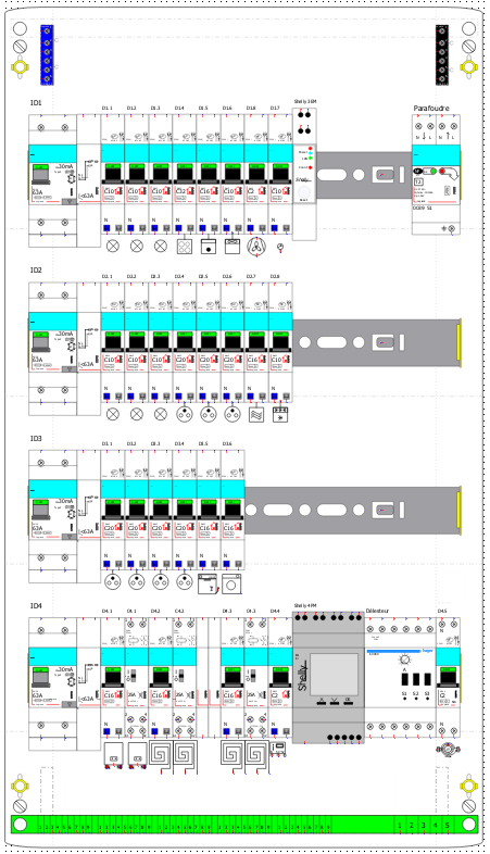

Posted
19 hours ago, Mike said:
They no doubt regarded as a potentially dangerous British curiosity here in France
I believe that EU wiring regs are based on our legislation, with a few minor changes for local markets.
The UK was the first European country to embrace electricity with major developments in the 1920s and 1940/50s. Why we have a very robust national grid.
Posted (edited)
There's certainly been international cooperation for decades, and current UK & European regs are based on CENELEC HD 60364 (itself a variation of IEC 60364) with local deviations. Ring mains, twin-and-earth cable, fused spurs, on-wall cooker switches and metal consumer units are probably the UK's main peculiarities.
On 27/07/2025 at 23:29, G and J said:
So if they are radially wired presumably their CUs are very different to ours or they sit next to boxes that are the electrical equivalent of manifolds.
I've only studied the UK & French regs (informally, not as a qualification) but yes, modern French CUs are certainly much bigger. That's partly due to the use of radials everywhere, but also because the French rules just require everything to be split into more circuits. I'm not sure if that's a French peculiarity, or common across Europe.
For example, a UK 20A radial circuit can serve 50m²; in France it can serve just 12 sockets (doubles count as 2), or 6 sockets if serving a kitchen worktop. Plus separate circuits for each dishwasher, washing machine, freezer, etc. Consequently, excluding lighting, my living room has 3 radials and my kitchen has 8 (though I could have got away with 6). By the time I've added lighting, the other rooms, MVHR, water heating, a couple of Shellys, Willis heaters, a load-shedder, and a lightning protector, this is the CU that I'm installing (and that's just the first part):
In addition, I have several dimmers & LED drivers to accommodate, but I can't add them all to the CU without exceeding the mandatory 20% unused capacity, so they'll be going in a separate 2-row cabinet. Then, since it's an apartment, there's another 2-row cabinet for the smart meter and the main RCD / isolator.

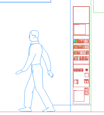

And there's more - a separate communications cabinet for TV, telephone & internet cabling, with another for a broadband router / TV box.
My 'electrical technical space' will therefore extend from floor to ceiling with 5 separate cabinets plus an access hatch:
