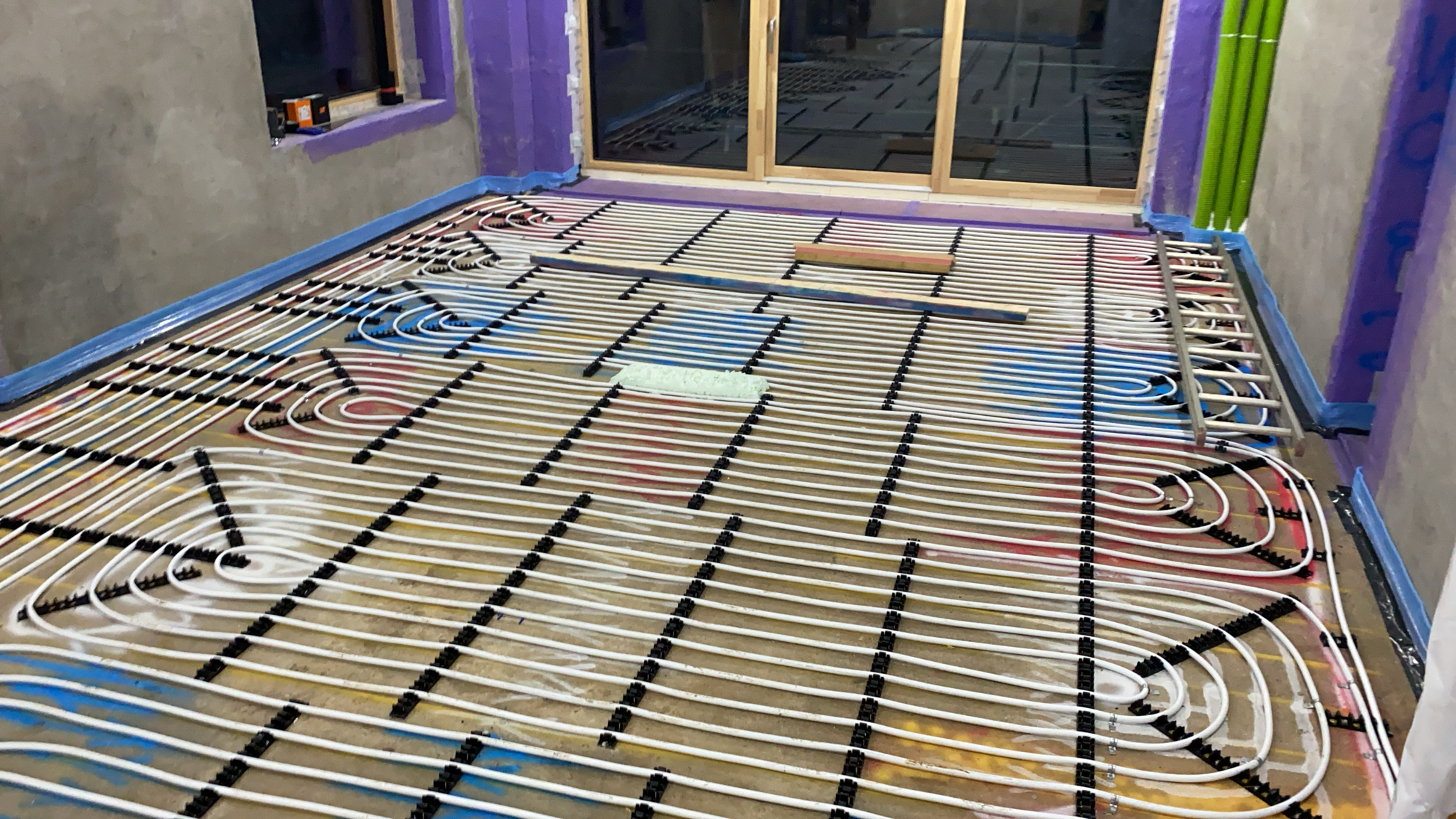

So to help my understanding, why would heating our poorly insulated slab (100mm EPS under) directly, i.e. pipes on top of the slab, be much different to (apparently) heating it indirectly via pipes on top of 25mm PIR? The implication is you get the same system performance (same downward heat loss)?
Remembering that said 25mm PIR is already purchased and down, with a layer of DPM underneath, then DPM on top, and Profix PLUS panels affixed to the top slip sheet (plus PIR upstands around the edge of each room).

Previous comments have clearly stated to NOT decouple the heating from the slab, as the thin layer of insulation is pointless.
image.thumb.png.89ccccf0cbc546bdde23b9898dd54a3e.pngimage.thumb.png.6bd0683a07ffc1618c6658adb8f6e8e1.png
Same here, where I gas nailed the UFH pipes to a constructional slab, and then 65mm of liquid screed got pumped over it.
During the heating season this just sits there like a giant storage heater. Flow temp is about 3°C higher than target room temp.
The only thing that’s left to manipulate here is the pipe centres, and how many manifolds service the total area.
You mention 1st and 2nd floor heating is on the menu, perhaps we can stay ahead of that curve.
My 2 cents would be to put the loops in at 100mm centres to get as much water volume into the GF screed as is possible, and then dial back zones / loops after you’ve commissioned, according to the heat needed for each space.
