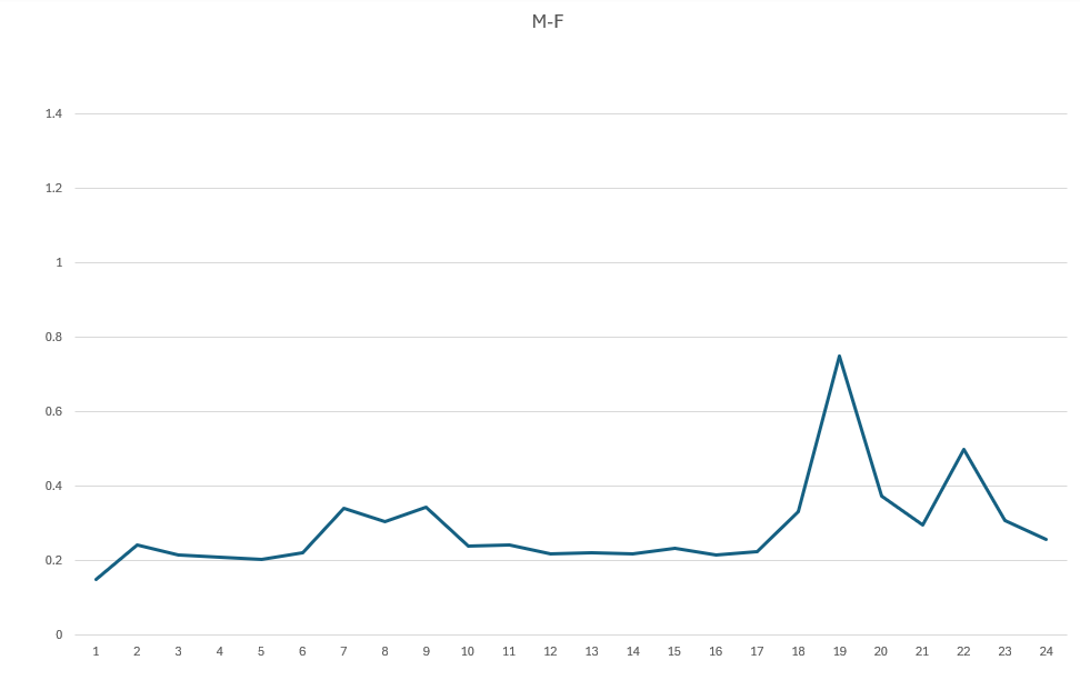

When it gets dark and cold, I get a candle out.
When it gets really dark and cold, I light it.
Fun comparisons
Weekdays
Roughly Translated to Sleep - Wake up Get Up - Work - Get Home - Have tea - drink tea - bed

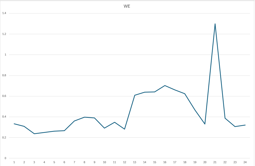

Weekends
Roughly Translated to Sleep - 1 person wake up - get up and do stuff - 2nd person get up - stick on laundry 3 loads - tea Oven - watch movie - bed
Winter is heavier on laundry due to TD/dehumidifer drying usage
