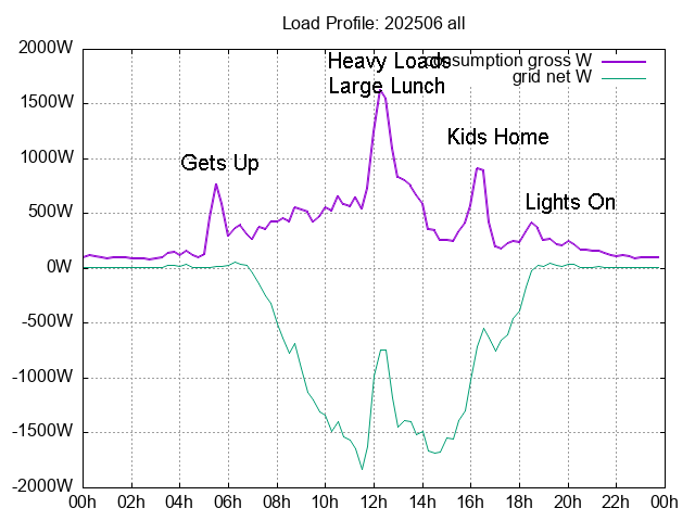

DamonHD Posted July 21, 2025 Posted July 21, 2025 Well, in case it helps anyone else knock ~16% (!) off their standing load in two shakes of a lamb's tail like that... Times are UTC. More data/graphs: https://www.earth.org.uk/img/PV/load-profile/202506/

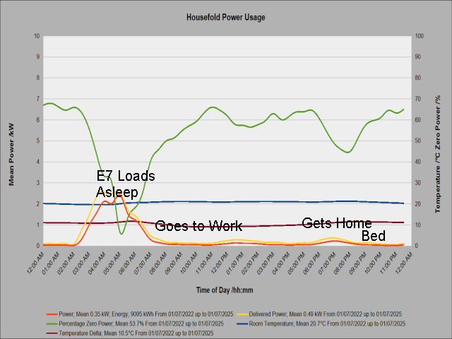

SteamyTea Posted July 21, 2025 Author Posted July 21, 2025 (edited) I have loaded up my mighty spreadsheet of my energy usage, and looking at the last full 4 years, my breakdown is as follows. This is for an all electric house on Economy 7. Day Mean Power 0.09 kW Delivered Power 0.18 kW % Zero Power 58% Night Mean Power 0.89 kW Delivered Power 1.1 kW % Zero Power 44% The greatest power I have drawn, over a half hour period, is 8.9 kW. During the cheaper night rate, considering there is 3 hours (185 minutes) when no power has been drawn from the grid at all, and I have a 100 A supply, charging batteries would not be at all challenging. When I look at just January, February and December, when I am usually heating the house: Jan Day Mean Power 0.14 kW Delivered Power 0.23 kW % Zero Power 52% Jan Night Mean Power 2.63 kW Delivered Power 3.14 kW % Zero Power 32% Feb Day Mean Power 0.11 kW Delivered Power 0.2 kW % Zero Power 51% Feb Night Mean Power 2.19 kW Delivered Power 2.67 kW % Zero Power 33% Dec Day Mean Power 0.14 kW Delivered Power 0.23 kW % Zero Power 51% Dec Night Mean Power 2.52 kW Delivered Power 3.02 kW % Zero Power 33% So to power my house during the winter days, by charging batteries at night, I would need a battery system that can store a deliverable 2.5 kWh, and deliver a peak of 10 kW. I currently have a 20p kWh difference between day and night rates and looking at my latest bill, which was waiting for me when I came home, I have used 1281 kWh on the day rate and 4538 kWh on the night rate. Those have to be halved as that is for two years, so 640 kWh day, and 2269 kWh night. At current rates that is £215 on Day Rate. If that was on Night Rate it would be £86 a year. So a difference of £130 (with a bit of rounding here and there). Now I have no idea what a suitable system would cost to install, but being generous and assuming that there are only 5% losses during each charging and discharging cycle, and that after 5 years, 90% of the capacity is available, a 3 kWh storage system would be needed and a 10 kWp inverter. Anyone know what that would costs, or to put it another way, it would have to be less than £1300. Edited July 21, 2025 by SteamyTea

DamonHD Posted July 21, 2025 Posted July 21, 2025 (edited) Not quite! Peaks are actually: DHW top-up by heat pump, DHW top-up from PV, evening meal being cooked, DHW top-up by heat-pump! Please admire the chunk of exports that I've managed to notch out, ie avoid spilling to a busy grid, at noon! FWIW, my laptop is using ~4W. Edited July 21, 2025 by DamonHD
