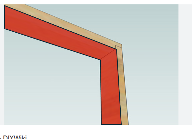

MortarThePoint Posted yesterday at 13:11 Author Posted yesterday at 13:11 (edited) I need to fit before having the doors because the decorator is here and can paint along with the architrave, lining, etc. I don't have the doors yet. Can I trust the thickness specification of the door manufacturer? They're fd30 doors and 45mm thick ( most manufacturers do 44mm thick but Deanta are a tad thicker it seems). I was thinking to leave 1mm for 'paint' so recess the stops 46mm from Door lining surface. What do I do if the doors end up thinner or thicker? Edited yesterday at 13:11 by MortarThePoint

MortarThePoint Posted 23 hours ago Author Posted 23 hours ago 1 hour ago, ProDave said: I always fit door stops at door hanging time 1 hour ago, Nickfromwales said: It’s a really bad idea to fit the stops before the doors are swung, like a REALLY bad idea, especially if they’re going to be painted into place. Oh dear, I've made a mistake here then. Painter is in and busy painting and I am a while away from having doors on site let alone hung. I guess that leaves me these options: Fit the door stops where I hope they should be and let the painter at them Have the door linings painted along with the architrave and skirting, then fit painted door stops later and hope the joint can then be tidily painted over to make the join disappear Somehow not paint the door lining face (i.e. the bit shown red below)
Nickfromwales Posted 22 hours ago Posted 22 hours ago 1 hour ago, MortarThePoint said: Oh dear, I've made a mistake here then. Painter is in and busy painting and I am a while away from having doors on site let alone hung. I guess that leaves me these options: Fit the door stops where I hope they should be and let the painter at them Have the door linings painted along with the architrave and skirting, then fit painted door stops later and hope the joint can then be tidily painted over to make the join disappear Somehow not paint the door lining face (i.e. the bit shown red below) Option 2 prob best, but will need the stop and the red area painting again to blend in satisfactorily imo.
