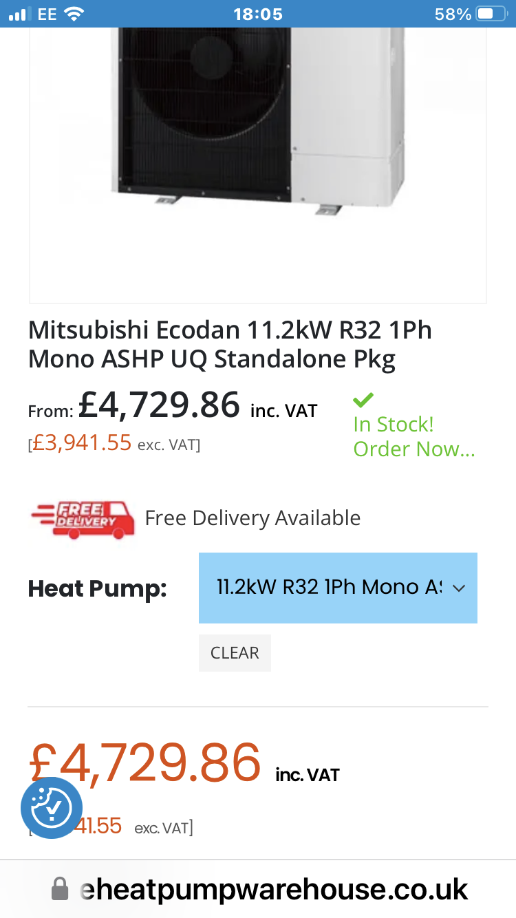

nod Posted July 3, 2025 Posted July 3, 2025 Just to add to all of the above We paid just short of 5 k after the grant for 11kw Echodan I couldn’t source the materials and pay someone for 5k

nod Posted July 3, 2025 Posted July 3, 2025 16 minutes ago, JohnMo said: To add to the above - didn't bother with MCS. I paid £800 for a heat pump specific 210L cylinder, new from City Plumbing. £1300 for a monobloc 6kW ASHP, billy bargain from eBay. £ a couple of hundred for cable, pipes and fittings. Installed myself, except final electrical hookup - electrician for 1 hour, while doing other work. So all in circa £2500. No heating mods needed, as I have UFH. I must be looking in the wrong places 😂The tank they used was about £1200 plus’s buffers 3 pumps etc

nod Posted July 3, 2025 Posted July 3, 2025 1 hour ago, JamesPa said: Why do you want buffers and 3 pumps? Unless your house is very unusual no buffering and one pump (often included in the heat pump itself) is the way to go assuming you don't want to increase running costs by 15% or more for no benefit to anyone other than the installer. Also no fancy controls unless specifically designed for heat pumps (which currently means only homely, adia or havenwise sofaik). The bus can save money certainly, but not if you accept unnecessary components and/or a grossly oversized heat pump because any installation savings will quickly be consumed by increased running cost. My personal advice is take the bus, but not at the expense of being saddled with the wrong system. Shop around!
marshian Posted July 3, 2025 Posted July 3, 2025 2 hours ago, nod said: I’d love someone to post all of that new foe 3k Looks lovely however the point remains - why did you think you needed it? 1
timhowes Posted July 3, 2025 Author Posted July 3, 2025 Thanks all - really helpful detail which has armed me with the necessary info to progress. No doubt I'll be back for more help... Cheers!
nod Posted July 3, 2025 Posted July 3, 2025 (edited) 16 minutes ago, marshian said: Looks lovely however the point remains - why did you think you needed it? Like most plumbers and heating engineers I new nothing about HPs I worked on a site in 2008 that was all HPs and these guys where fitting them and since set up on there own Both are Aircon backgrounds and know there stuff I was guided by them Apart from a persistent L9 fauslt that turned out to be a flo switch UFH which fitted and they set up ASHP All work fine and still waiting for someone to post the same HP as mine for a few hundred quid 😂😂 Edited July 3, 2025 by nod

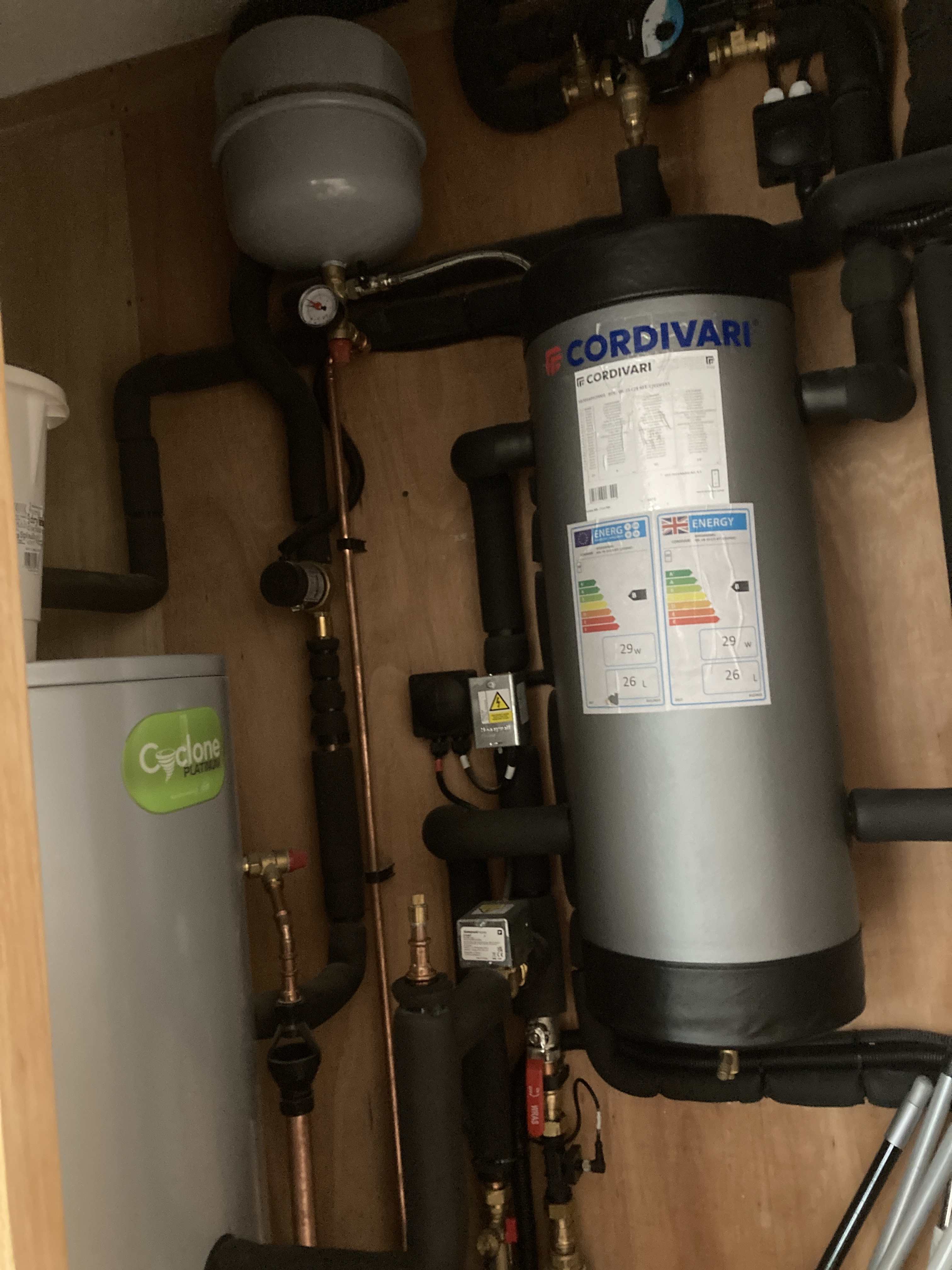

JoeBano Posted July 3, 2025 Posted July 3, 2025 In 2008 you would need a buffer as they were all fixed output, now with inverter driven heats pump like yours they can modulate down to the heat demand. I managed to get a grant aerona3 10kw, megaflow cylinder and a cordvari buffer for £1600. Right place right time.
