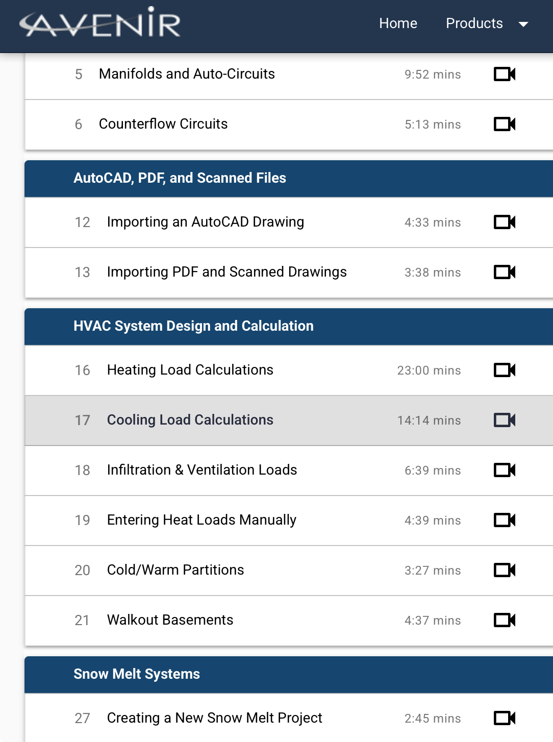

LnP Posted July 21, 2025 Posted July 21, 2025 Can anybody recommend a good way to calculate cooling load? There are a few tools on t'internet, but it seems to be more complicated than heat loss.
Nick Laslett Posted July 22, 2025 Posted July 22, 2025 (edited) 7 hours ago, LnP said: Can anybody recommend a good way to calculate cooling load? There are a few tools on t'internet, but it seems to be more complicated than heat loss. You can calculate cooling loads in LoopCAD. You can use it free for 30 Days. Link is to page of tutorial videos. There is a 14mins video on how cooling loads work in the software. Watch video see if it makes sense. https://www.avenir-online.com/AvenirWeb/support/tutorial/?productLine=loopcad Edited July 22, 2025 by Nick Laslett 1
