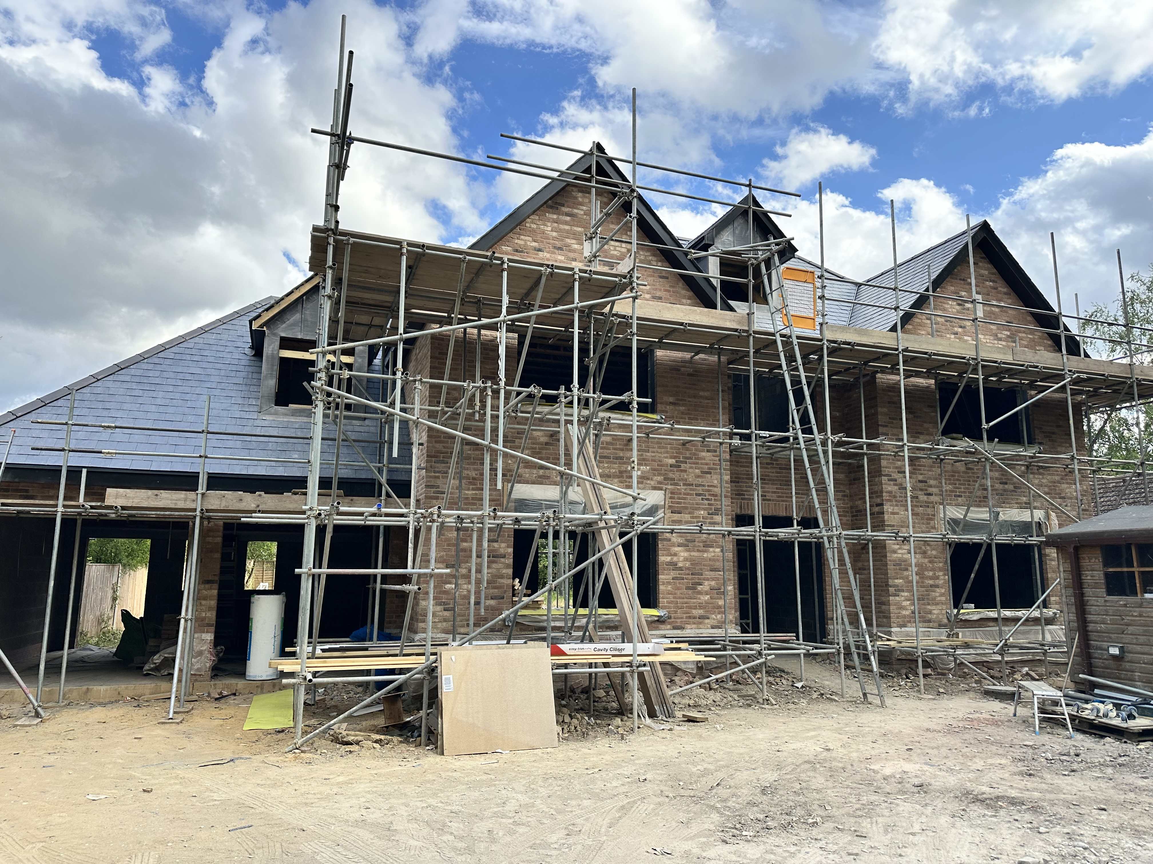

Berkshire_selfbuild Posted June 25 Posted June 25 Hi all. We’re at first fix stage of our self build (cheeky pic added) and need to make a decision of going traditional wet plaster or dot and dab plasterboard. My build is thermalite blocks inside, 100mm pir plus 50mm air gap, and then my facing bricks. I have MVHR going in and hoping for reasonably high levels of airtightness as possible. I have only ever lived in properties with traditional wet plaster and am used to solid feeling walls and being able to hang up TVs etc without issues, and generally the feeling of solidness and quality which I’m worried dot and dab won’t give me. Any wise words of wisdom out there to sway me one way or another? It’s a home for life so want to make sure I make the right decision.
