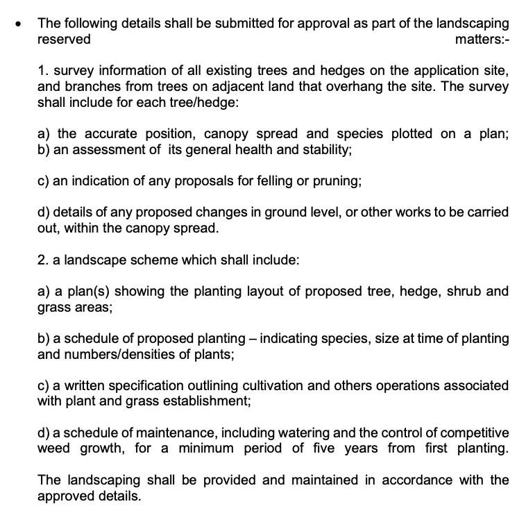

garrymartin Posted June 25, 2025 Posted June 25, 2025 I've asked for some to be removed in my appeal paperwork. It seems like the planning officers just randomly tick from a long list of standard conditions with no regard to the size, scale, or application circumstances. As an example, I have landscaping conditions applied to my single dwelling that would be more appropriate to a large commercial scheme in terms of the detail of information required and the monitoring and commitments over a 5-year period! Everyone should definitely check their conditions carefully and challenge any that do not seem appropriate using the mandatory tests.

garrymartin Posted June 25, 2025 Posted June 25, 2025 26 minutes ago, nod said: You can simply ignore many of the conditions Such as landscaping It's an Outline Application at this stage, so the conditions relate to information that I must provide and gain approval for at the Reserved Matters stage.
Temp Posted June 25, 2025 Posted June 25, 2025 That's a fairly normal request. We had similar in 2005. It sounds like a lot but it's not so bad if you already have a site plan. It might be possible to do it all the yourself but they may want an arboriculturist to do it.
Russell griffiths Posted June 25, 2025 Posted June 25, 2025 2 hours ago, garrymartin said: It's an Outline Application at this stage, so the conditions relate to information that I must provide and gain approval for at the Reserved Matters stage. There’s nothing there that a simple tree report would not cover, and a couple of pages of text highlighting what you intend doing. £1200 would see it done assuming your only talking about a building plot of an acre or less.
garrymartin Posted June 25, 2025 Posted June 25, 2025 17 minutes ago, Russell griffiths said: There’s nothing there that a simple tree report would not cover, and a couple of pages of text highlighting what you intend doing. £1200 would see it done assuming your only talking about a building plot of an acre or less. I get that - I just question whether it meets the six tests, especially the "reasonable..." one. If you look at the model conditions, they are much more straightforward... "Approval of the details of the siting, design and external appearance of the building[s], the means of access thereto and the landscaping of the site (hereinafter called "the reserved matters") shall be obtained from the local planning authority in writing before any development is commenced"

nod Posted June 25, 2025 Posted June 25, 2025 5 hours ago, garrymartin said: It's an Outline Application at this stage, so the conditions relate to information that I must provide and gain approval for at the Reserved Matters stage. Your no choice with pre conditions Your survey will address these £1000 plus vat seems to be the going rate
Oz07 Posted June 25, 2025 Posted June 25, 2025 You can discharge all pre conditions at once saving multiple app fees. If its outline at this stage can you not just submit these docs as part of your reserved matters and kill 2 birds.
