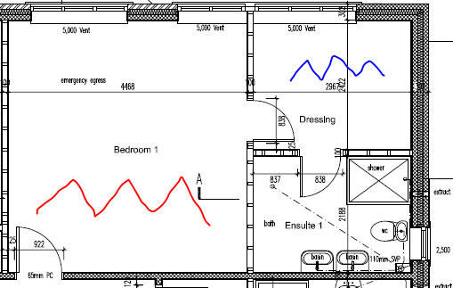

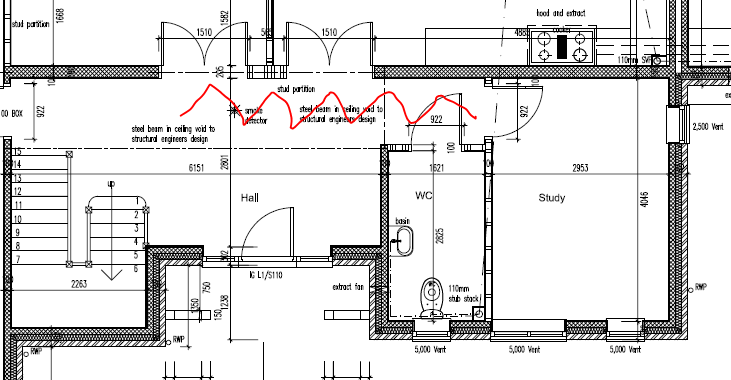

MortarThePoint Posted June 28, 2025 Author Posted June 28, 2025 9 hours ago, Gus Potter said: If you lay the flooring parallel to the main view direction it not only makes the room look bigger it also mitigates any bumps in your floor slab as folk walk into the room. Good point and in one room that gets me thinking. I had intended to lay the laminate (10mm Egger EHL175) in the direction of the long axis of the study which also leads to the predominant light source. That does however leave it perpendicular to the direction of room entry. The red zigzag is the direction of the herringbone in the hallway. I have a similar situation in the sitting room, but there is a bay window at the end and it will also run through into the dining room with patio doors at the end so I think it only makes sense to have it going parallel to the long axis in there. That's likely to be 14 or 15mm engineered oak flooring so a different consideration to the laminate. Upstairs, we are having Herringbone 8 laminate (8mm) in the main bedroom and also I expect in the dressing room, though that may end up carpet to better cope with the possibility of wet feet. 9 hours ago, Gus Potter said: Can you tells us what your floor slab is sitting on Ground floor is Thermabeam insulated precast concrete planks over 300mm void and first floor is 150mm HCF planks. I particularly liked the idea of the Thermabeam as it keeps the concrete inside the insulated envelope unlike standard beam and block. HCF was good for speed of installation and again thermal mass inside the insulated envelope. I'd be concerned if either had any mid-span settling. They've been down for 5 years and covered in screed (50 - 60mm Cemfloor cement-based liquid screed) for almost 4 years. We've only had one screed crack in a position I partly expected it on a long narrow run where I proposed a break anyway. The screed is extremely flat, with the odd bubble crater or piece of aggregate sticking up about 1mm. I think I'm over thinking it and a 3mm underlay would be fine, though I'll still hunt down and grind any pimples with a brick as @saveasteading suggests and a grinder if anything more significant, but I'd be surprised if I needed that.

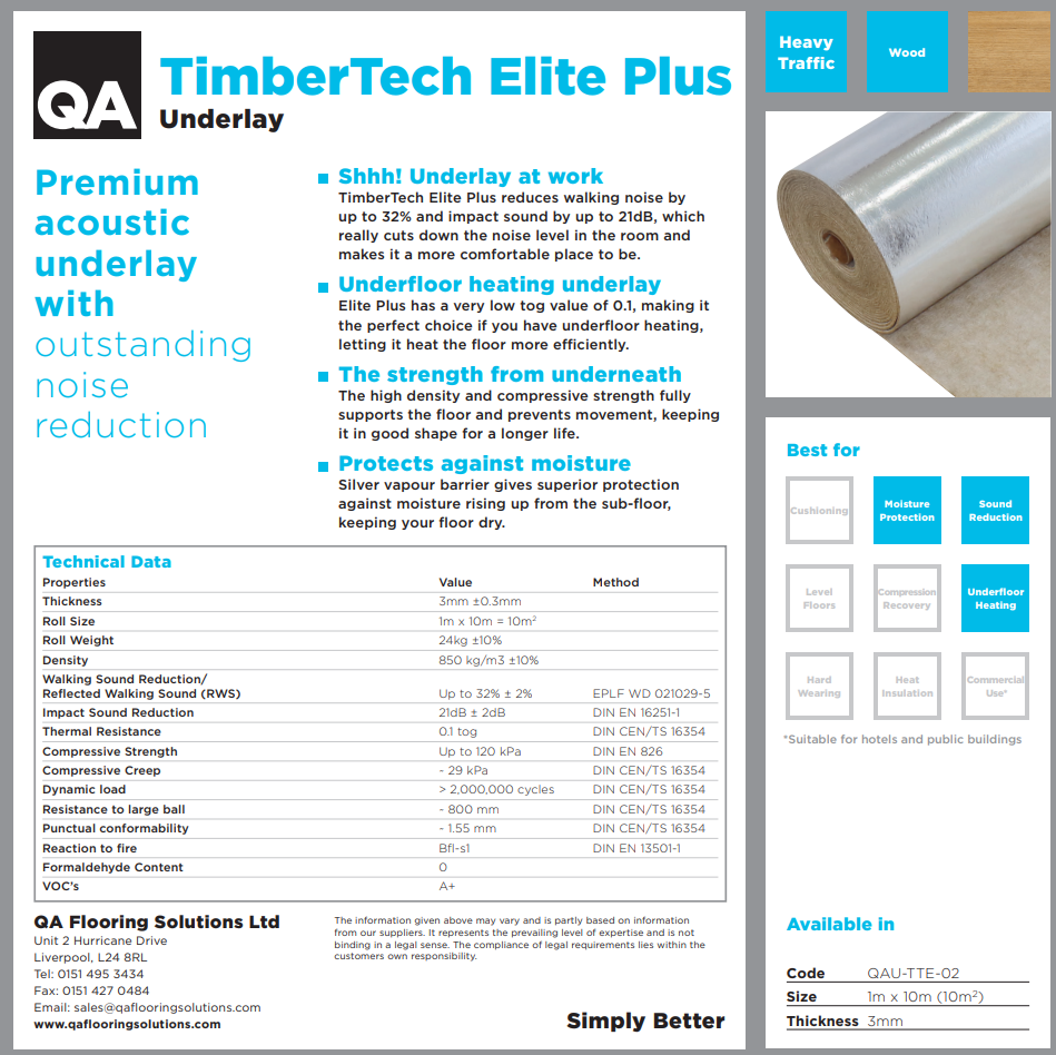

MortarThePoint Posted July 1, 2025 Author Posted July 1, 2025 (edited) A handy specification that may go unnoticed is 'punctual conformability'. Nothing to do with ability to be on time, but the ability to cope with small defects. No idea what the 'resistance to large ball' specification means. Parador appear to call this "Compensation for punctual unevenness" and their 500 product (2.6mm thick) has a figure of 1.15mm. I'm going with TimberTech Elite Plus 3mm, also 0.1tog but more available, which is 3mm thick and has 1.5m of 'punctual conformability' Sorry @Nickfromwales, good advice about UFH but we're going to pop insulation over it in some rooms. Laminate and underlay should total 1tog or less which is a R-value of about 0.1 m2.K/W which in my mind I compare to the Rsi value that is likely around the same. Many have questioned my putting UFH upstairs and I think this is an example of where it's going to give me options. Compromises, compromises. Edited July 1, 2025 by MortarThePoint

MortarThePoint Posted July 14, 2025 Author Posted July 14, 2025 Herringbone 8 flooring needs <=2mm and >=150kPa, so went with the QA 2mm 0.1 tog version (Elite QAU-TTE-01) there.
