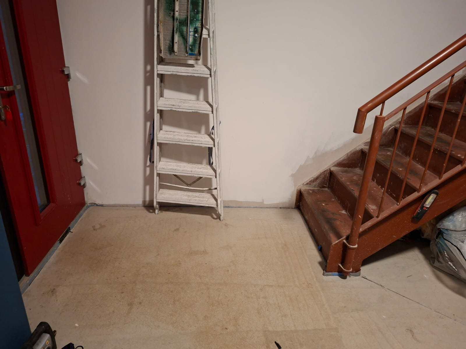

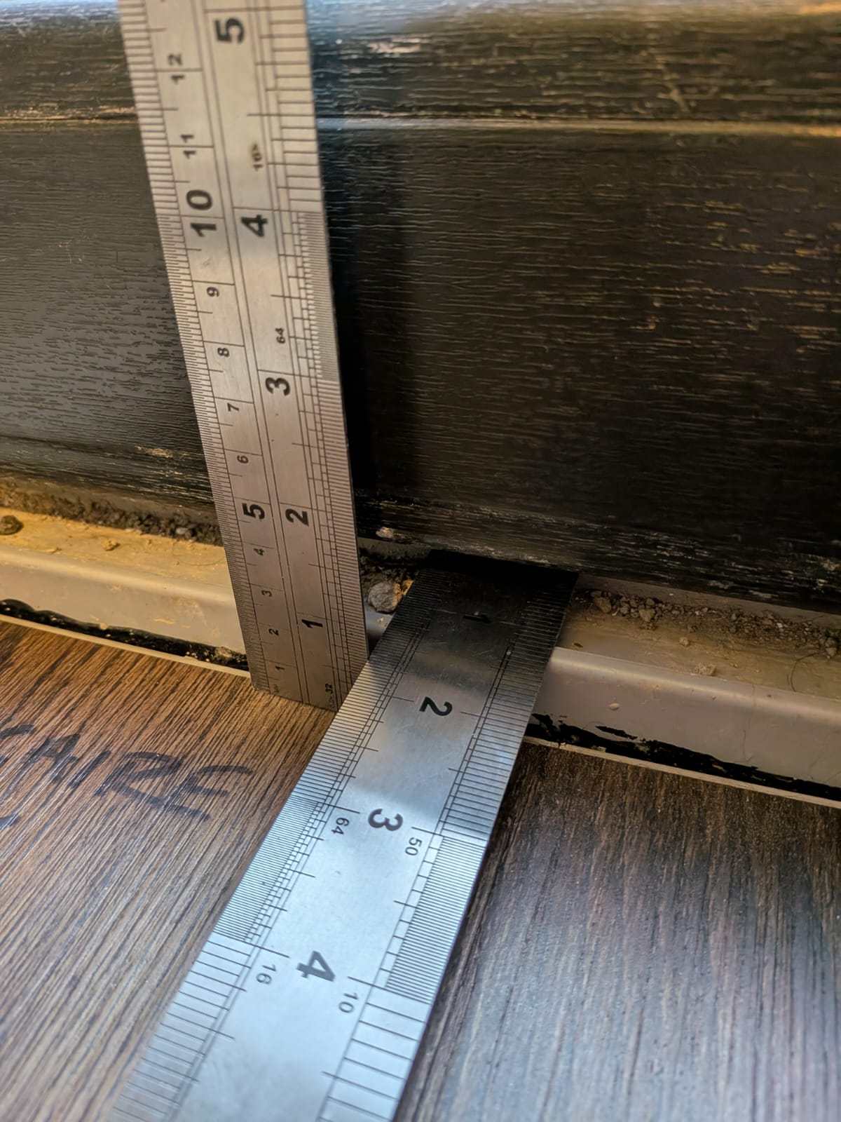

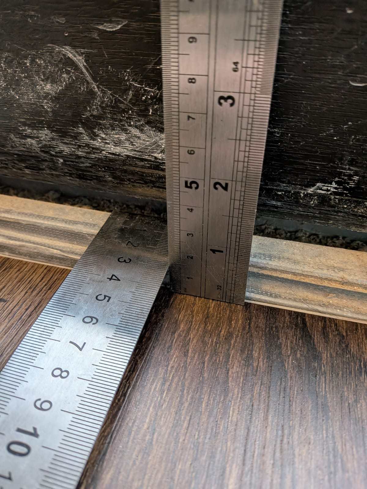

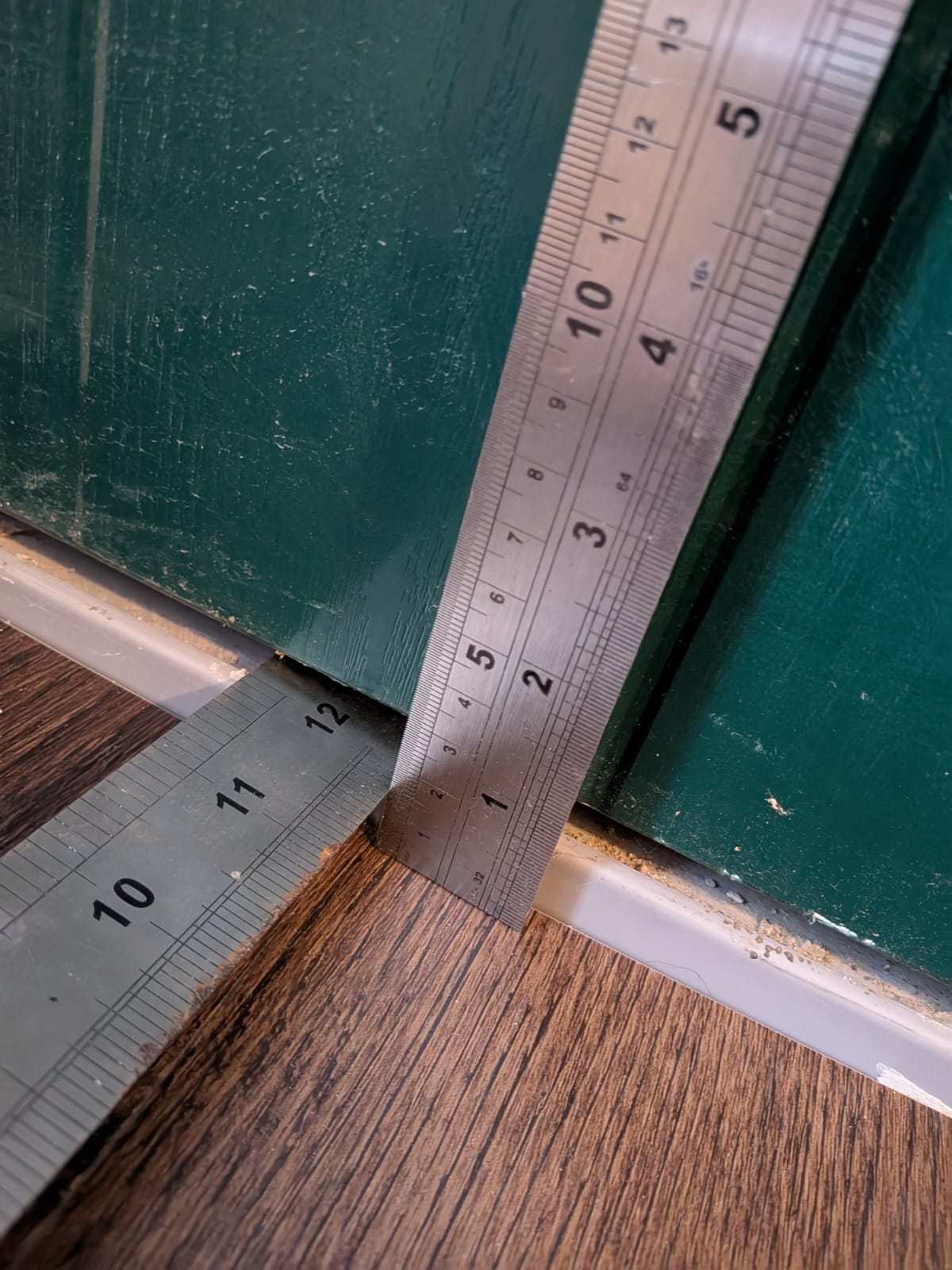

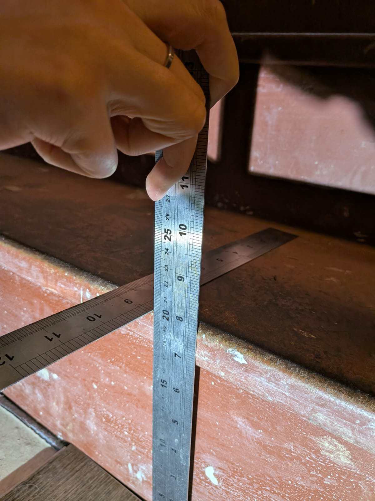

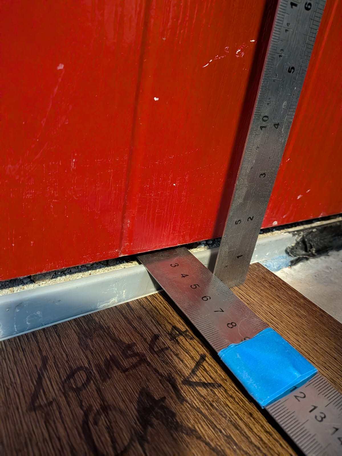

CalvinHobbes Posted Friday at 20:54 Posted Friday at 20:54 Hello, so we really need a floor. Every night our dog goes for a swim in the local river then comes in so we need a waterproof floor. We liked this spc, walnut kinda look to it and can get it for 21 per sq m in the morning (down from 29) But our building control officer does things by the book, no shortcuts. Do you think the levels on these 4 external doors would pass? (there is a granny annexe) Mums front door is the green one and its supposed to be accessible.

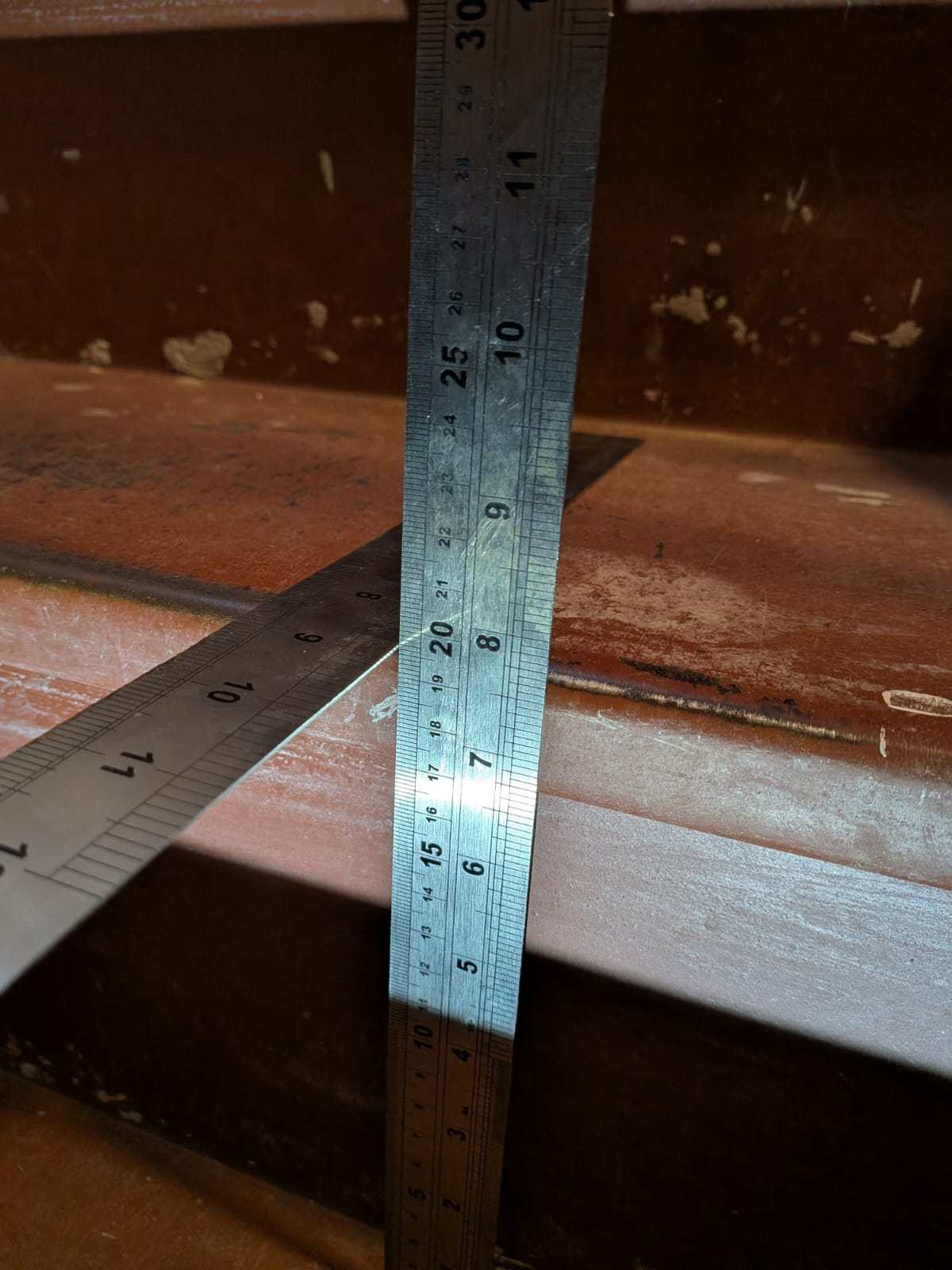

CalvinHobbes Posted Friday at 21:42 Author Posted Friday at 21:42 I think they are all ok apart from the green door and perhaps we could just get threshold ramps to make it work? Of more concern is the bottom of the staircase. I think the 6mm flooring is still going to leave the first step too high compared to all the rest. We have underfloor heating. I wonder what can we do to get around this, I guess build a step or ramp and the bottom of the steps?
nod Posted Friday at 22:11 Posted Friday at 22:11 If its the disabled access that you are worried about Weve 35 mil drop on the inside Fine to run a wheelchair off BC came round today to do the sign off and didn’t mention it 1
Thorfun Posted 16 hours ago Posted 16 hours ago If your BCO is walking around with a tape measure checking every minutiae then you’ve got the only one! 1
Mr Punter Posted 16 hours ago Posted 16 hours ago No issue at all. Doormats can be 20mm thick. You would not notice the staircase unless it was more than 20mm out. 1

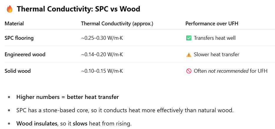

CalvinHobbes Posted 14 hours ago Author Posted 14 hours ago Thing is, this seems the most water resistant choice possible. Is there really a waterproof option? The joins in click are always going to be dodgy. We have a dog who swims in the river every day and an alzheimers patient who spills everything possible. I suppose we could go for tiles but they are hard and unforgiving plus we need to do this ourselves so having never tiled before or put wooden floors down, click seemed the less challenging. Floor is too wide for vinyl sheets and the only other thing is resin which is a bit cosmic and eye wateringly expensive.
JohnMo Posted 14 hours ago Posted 14 hours ago 17 minutes ago, CalvinHobbes said: dog who swims in the river every day Have a towel by the door, dry the dog before they come into the house? We always wipe the dogs feet and dry off if wet. The dog now expects it, waiting outside until told to come in. Also have a carpet runner or floor mat that doesn't show to many marks at the door. Then put some proper wooden floor down, that can be glued to the screed, so you get decent heat transfer from your UFH.
CalvinHobbes Posted 13 hours ago Author Posted 13 hours ago 1 hour ago, JohnMo said: Have a towel by the door, dry the dog before they come into the house? We always wipe the dogs feet and dry off if wet. The dog now expects it, waiting outside until told to come in. Also have a carpet runner or floor mat that doesn't show to many marks at the door. Then put some proper wooden floor down, that can be glued to the screed, so you get decent heat transfer from your UFH. I appreciate anyone loving wood more,I do myself. That said the heat transfer thing did swing me.
Jenki Posted 12 hours ago Posted 12 hours ago 7 minutes ago, CalvinHobbes said: I appreciate anyone loving wood more,I do myself. That said the heat transfer thing did swing me. UFH is different from radiators, it doesn't need to be a fast reactive heat. Well insulated air tight houses don't need rapid heat transfer. The heat from the slab (assuming very good insulation levels underneath) WILL heat the house, if it take 4 hours longer the first time the heating comes on so what? save your money and worry about something else 1
JohnMo Posted 12 hours ago Posted 12 hours ago Suspect the thermal transfer is actually similar compared to wooden floor glued down with no air pockets. Compared to SPC that is floating and with the underlay. 14 hours ago, CalvinHobbes said: Do you think the levels on these 4 external doors would pass? All 4 doors don't have to pass. You only need one accessibility door. So all criteria needs to accessed including what's outside. We also have many doors and all are flush thresholds. But only the front door is the accessibility door for building regs 1
