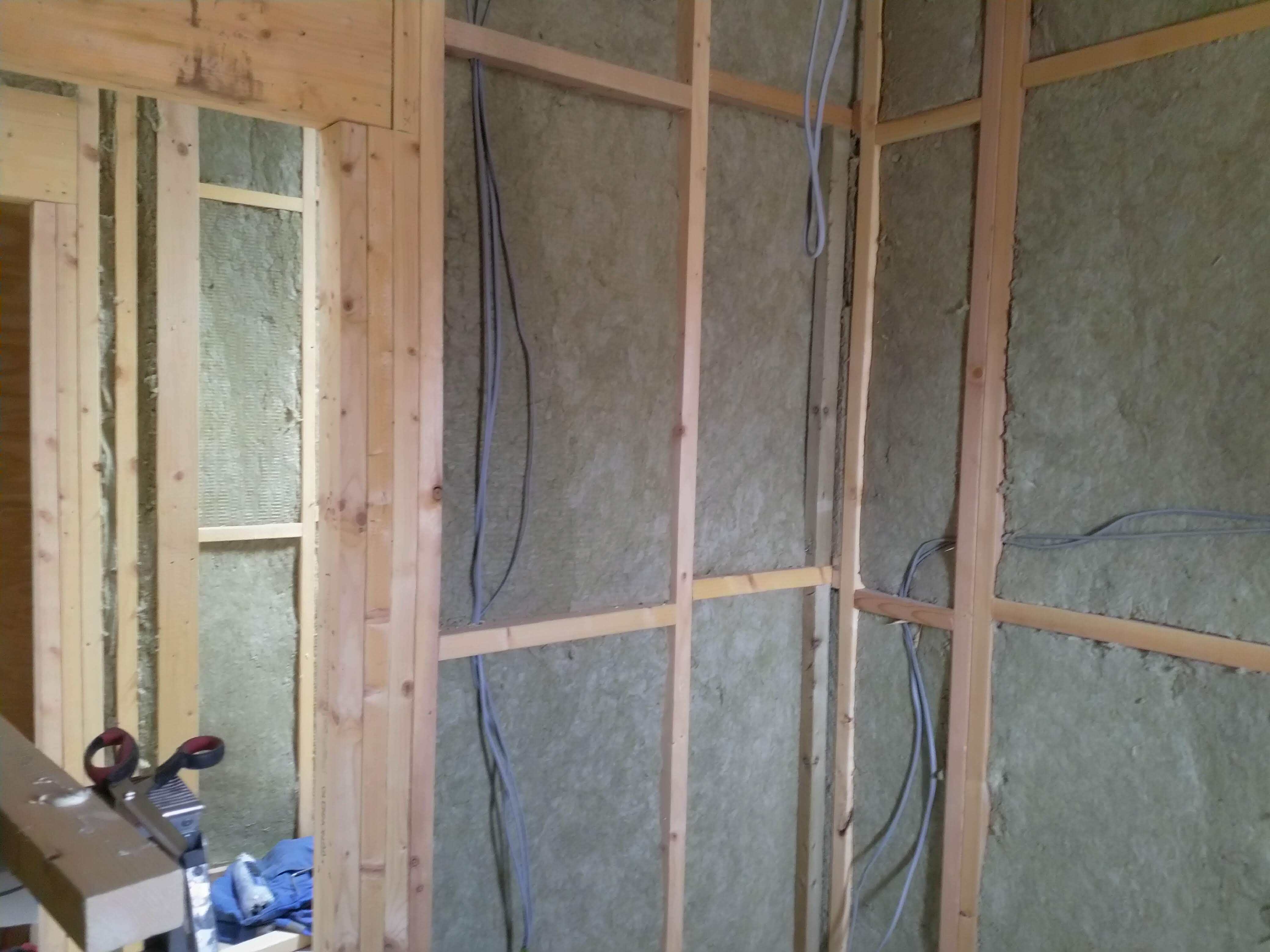

We’re getting a plasterer to board out the internal walls while we get on with other jobs.
After some advice please on what’s the best way of fitting it within a stud wall so that it’s still in place when the plasterer comes to board out? Any top tips?
Usually friction fit between the studs, nothing special required.  Just cut ever so slightly oversize

Or just use rockwool Flexi for internal partition stud walls, for acoustic insulation. If a 75mm or 100mm stud use 50mm and fit in the centre of the stud, so you have an air gap both sides.
Make it a good interference fit (not huge so it bulges) it will stay put for as long as needed.
Doing it for sound reduction in walls, heat insulation in the ceiling between ground and first floor. Internal new stud walls in a new build timber frame which has factory fitted PIR with an additional 50mm PIR which we fitted to all exterior walls, followed by  membrane and battens. We can’t board one side first because we are doing rockwool ourselves and it has to be done first because of our timings.

Friction fit worked fine for us you can tap some long nails in on the studs to hold it too.
Pay special attention to sockets etc.
Air paths are the easiest way to transfer sound through a wall.
For added mass consider putting scrap plaster in there loose. Better than throwing it in the skip or spending a fortune on higher density insulation.
