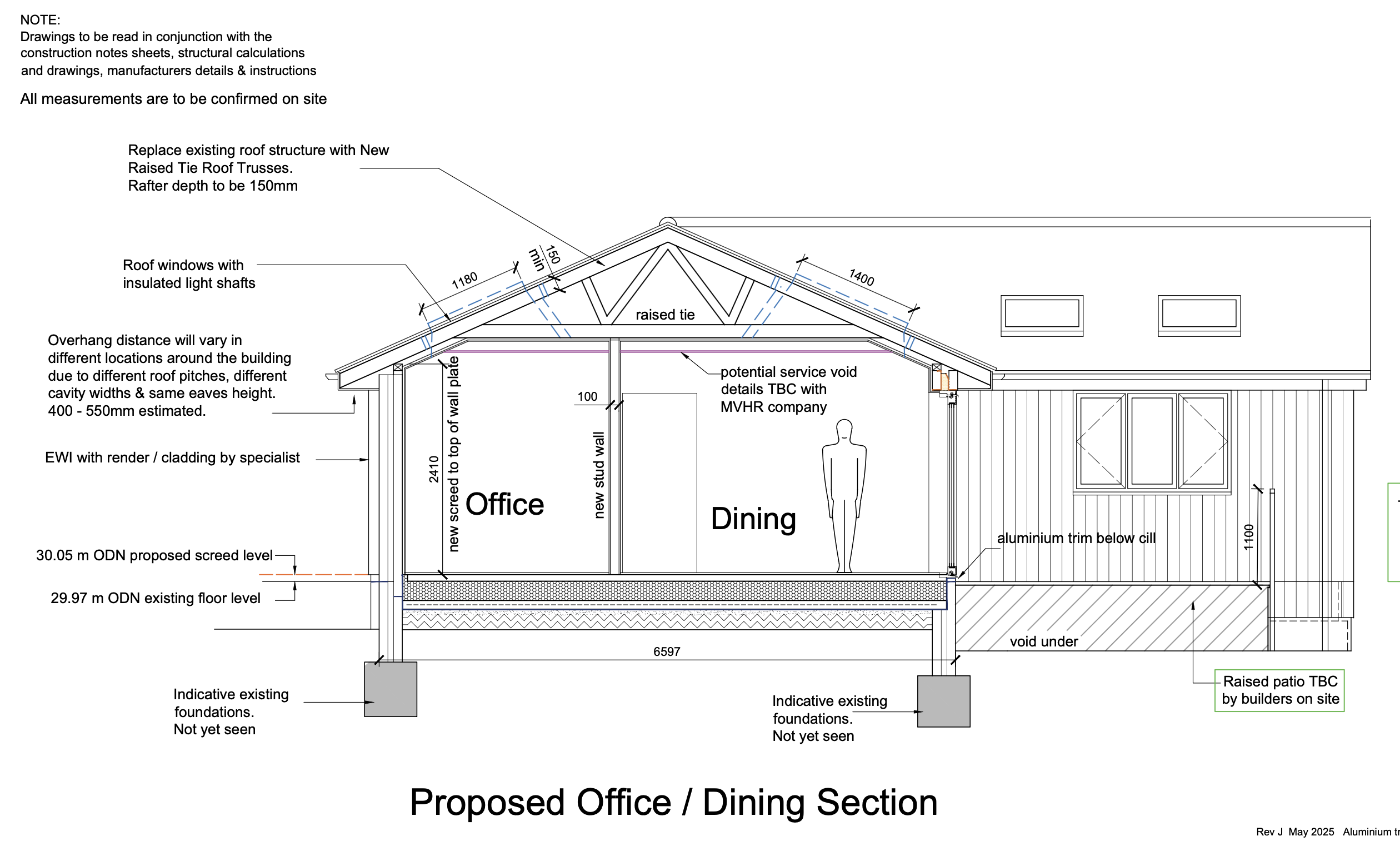

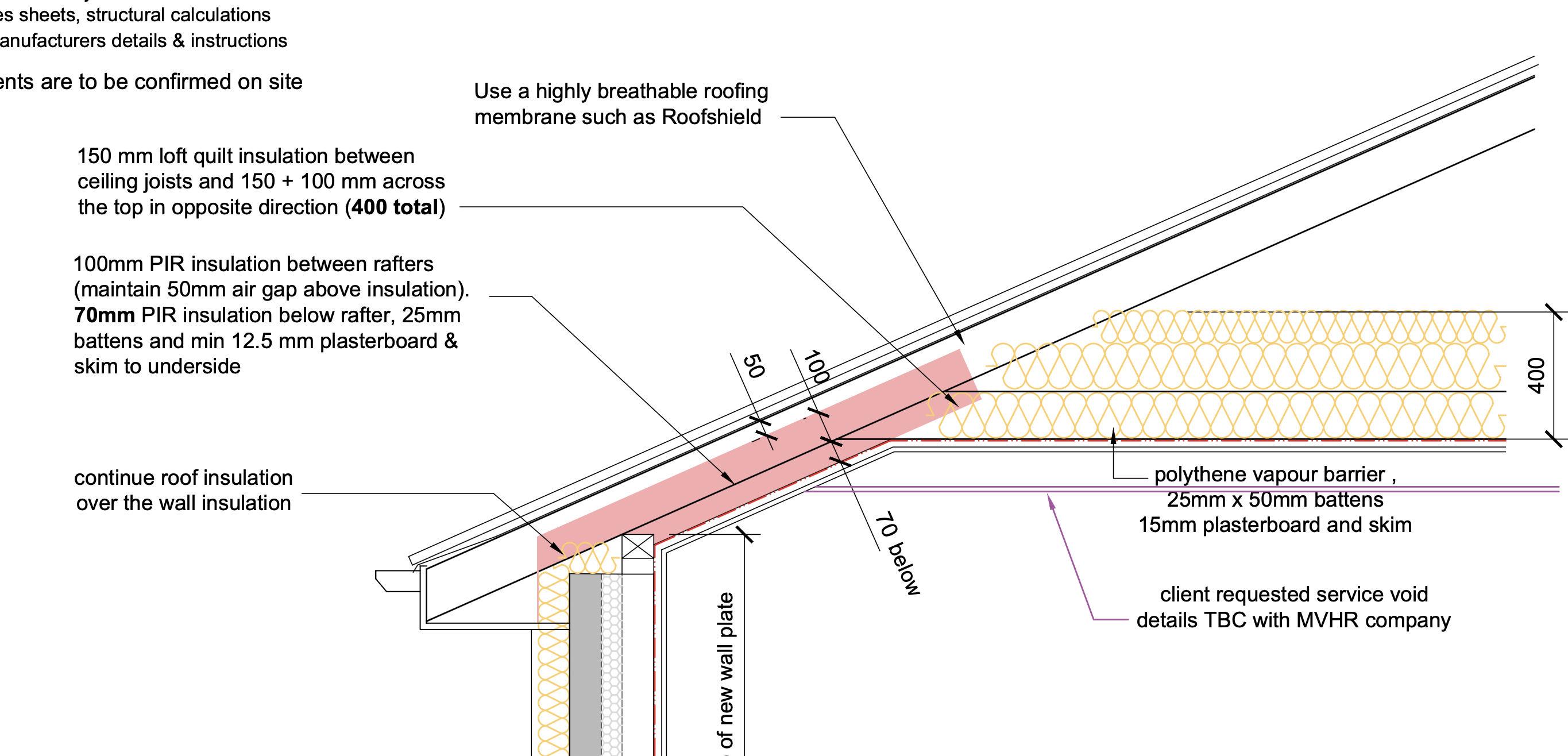

boxrick Posted Tuesday at 14:39 Posted Tuesday at 14:39 I am having a complete new roof on my existing house and extension. The design is to have roof lights punching through holes and a raised ceiling. However now I am just contemplating just vaulting my ceiling instead and to stop messing about with something I only half want, my roof is already very shallow and my floor is very high so I want to maximise ceiling space So based on that, what would be a sensible makeup of insulation to get equivalent performance to below? Would I still be able to have a service void for electrics, MVHR on warm side? Any recommendations before I go ahead and try and get this changed?

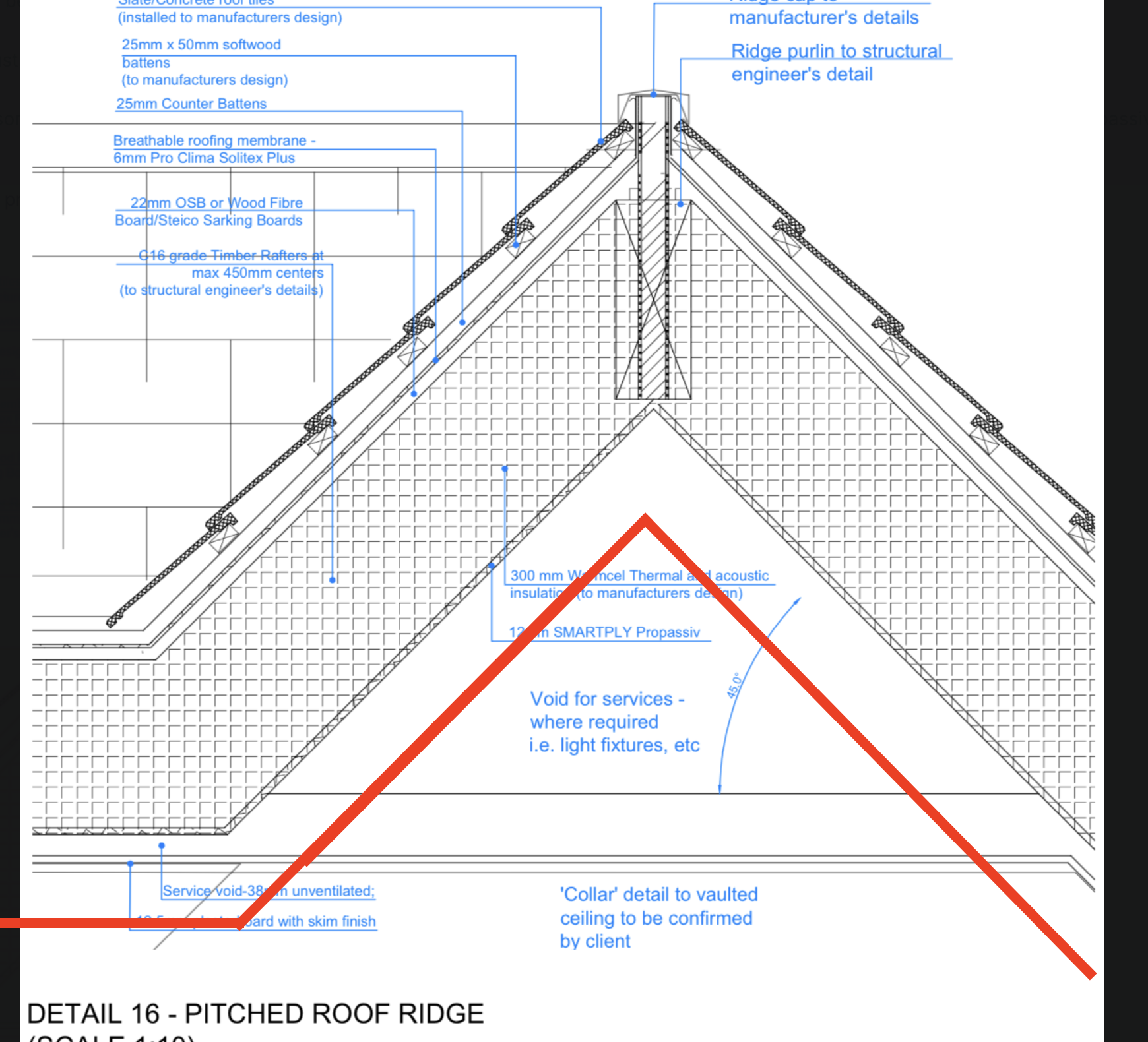

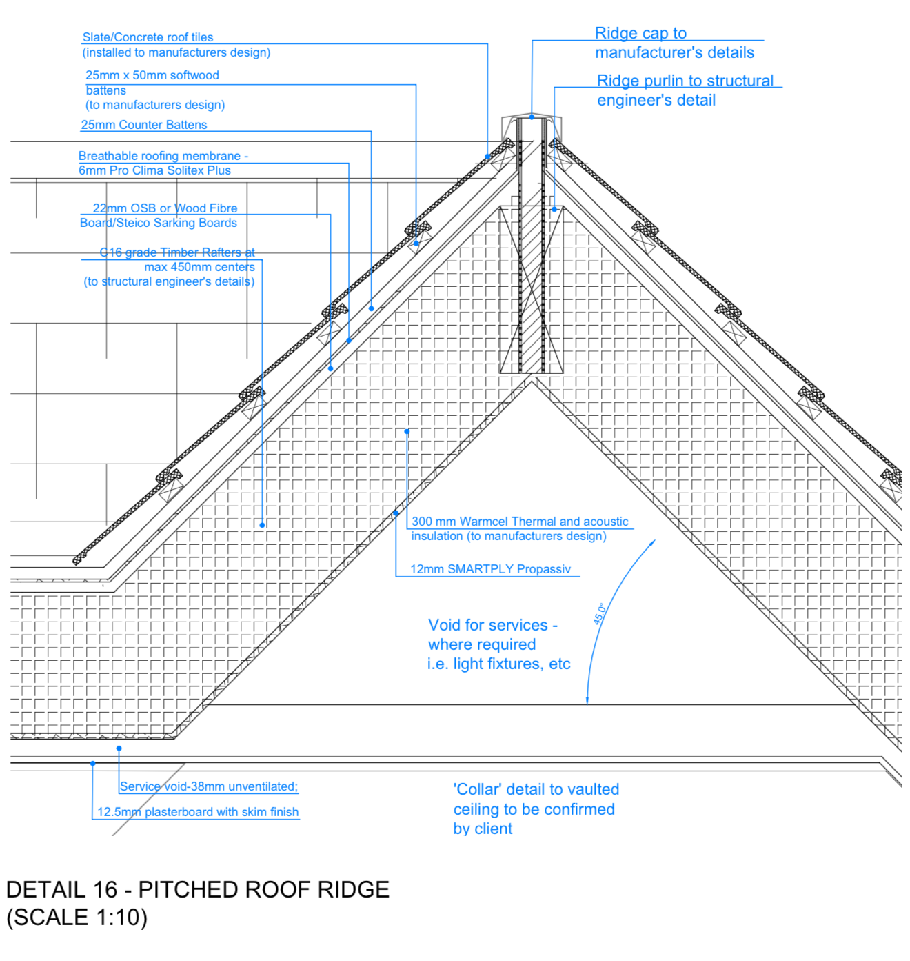

SBMS Posted Tuesday at 21:04 Posted Tuesday at 21:04 (edited) 22 minutes ago, boxrick said: Shes pretty good to be fair, but I think I have made so many design changes at this point I am driving her mad. Regardless I have just contacted Mitek asking for help with a design. Thanks for the push in the right direction. Does anyone have some diagrams or similar to help me understand what it may look like in respect of my 'service void'? I would like to approach passivehaus levels of insulation or as close as I can sensibly get. Here is our design. We probably won’t even put the collar detail in and keep it vaulted as high as possible Edited Tuesday at 21:04 by SBMS
boxrick Posted Tuesday at 21:18 Author Posted Tuesday at 21:18 13 minutes ago, SBMS said: Here is our design. We probably won’t even put the collar detail in and keep it vaulted as high as possible Thanks so much for sharing this, can these red lines I have added in work as a service void for MVHR pipes and roof lights?
SBMS Posted Tuesday at 21:25 Posted Tuesday at 21:25 4 minutes ago, boxrick said: Thanks so much for sharing this, can these red lines I have added in work as a service void for MVHR pipes and roof lights? Yep. That’s exactly what we are doing - architect didn’t draw it but we will be counter battening the entire inner surface of the smartply, running services/spots in that and then plasterboarding on top. You can get 50mm flat MVHR ducting but you could also do wall outlets (or even floor outlets).
boxrick Posted Tuesday at 21:39 Author Posted Tuesday at 21:39 12 minutes ago, SBMS said: Yep. That’s exactly what we are doing - architect didn’t draw it but we will be counter battening the entire inner surface of the smartply, running services/spots in that and then plasterboarding on top. You can get 50mm flat MVHR ducting but you could also do wall outlets (or even floor outlets). Ahh ok And any reason warmcell insulation instead of something like Knauf Earthwool Rafter Roll 32?
SBMS Posted Tuesday at 22:01 Posted Tuesday at 22:01 20 minutes ago, boxrick said: Ahh ok And any reason warmcell insulation instead of something like Knauf Earthwool Rafter Roll 32? It gets blown into every nook and cranny so reduces the dependence on skilled labour to fit. It also gets blown in between the metal web which would be tricky to do with rafter roll. When I priced up both they were very similar priced.
