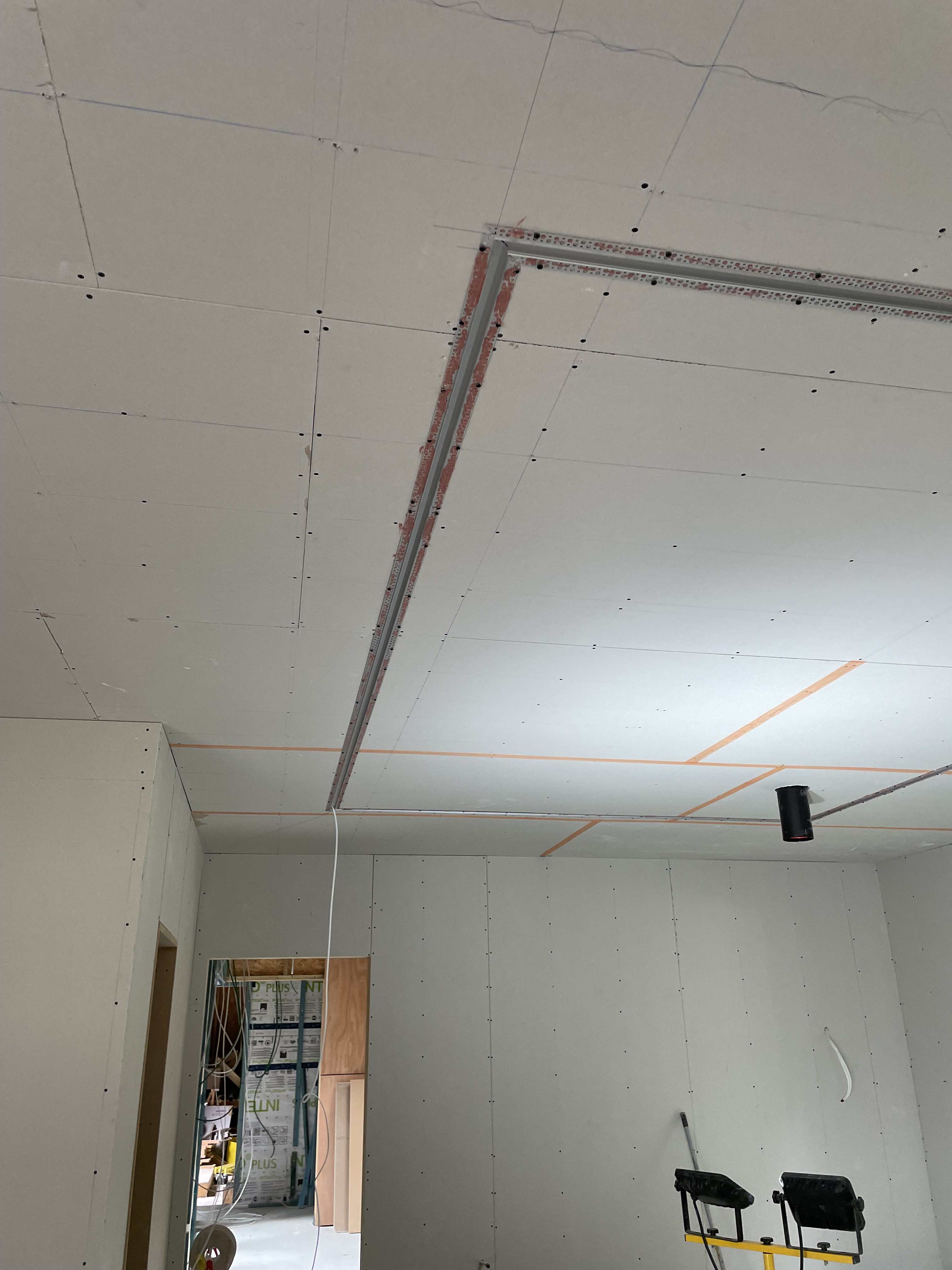

markharro Posted June 2, 2025 Posted June 2, 2025 I am trying to understand how this is done as the profile is normally screwed into the plasterboard and presumably then into a background joist but this isnt possible when using res bars so how do you keep the profile in place? I am assuming just screwing into the plasterboard wont be enough? Would it be better gluing with something like CT1? Thanks
Spinny Posted June 2, 2025 Posted June 2, 2025 Don't all plaster-in lights like downlights just get screwed into the plasterboard and then the skim coat also helps to hold them in place. By definition you can't put a downlight underneath a joist. Don't you just need to use a plaster-in LED profile, screw it to the plasterboard and then plaster it in with the skim coat ?
Thorfun Posted June 2, 2025 Posted June 2, 2025 looking at the photo looks like I used some plasterboard screw as well. Can’t remember if they were in to the res bars or not though. Sorry. i’m sure pink grip would be strong enough though. Our plasterers used it for all the edge beadings. @nod will be able to give you a definitive answer though.
Spinny Posted June 2, 2025 Posted June 2, 2025 Didn't know you could get crazy bendy profile like this one... https://reeltechdirect.com/products/flexible-plaster-in-led-profile Admittedly a lot of these profiles are as deep as the plasterboard. I guess maybe double boarding the ceiling is the answer or you will end up cutting right through the board ? I am putting some in rooflight upstands, but here the plasterboard attaches directly to the continuous insulated plywood upstand.
nod Posted June 2, 2025 Posted June 2, 2025 The easiest way is to mark you lights on the floor and run a length of top hat either side Then add a 100 mil pattress in between the two top hats Board your ceiling Then transfer the lines from the floor and cut out If you must use res bar You can fix pattress in between but on to the joists If you don’t put timber in They will crack

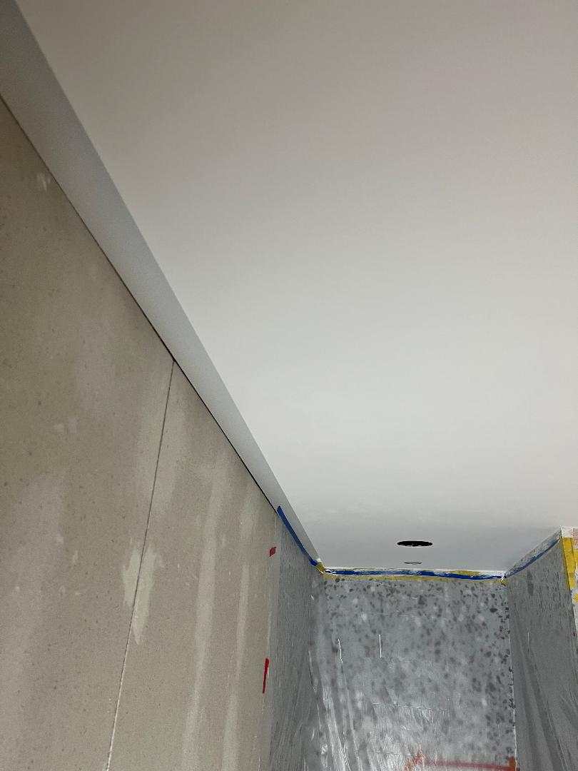

markharro Posted June 23, 2025 Author Posted June 23, 2025 Yes I did. I used this stuff https://soundstop.co.uk/products/genieclip-furring-strip?variant=43491336880351 and these clips https://soundstop.co.uk/products/genieclip-rst-soundproof-system?variant=43491336782047 I found this company really good to deal with and very helpful over the phone. Fixing the bars was pretty easy - shimming the joists took the most time. I bought 2 different types of LED profile - one like in @Thorfun photo above (yet to fit this) and another being this one - https://www.ultraleds.co.uk/plaster-in-wall-washer-led-aluminium-profile-85-5mm-x-56-8mm which butts up against the wall. I have fitted the latter only and what I did was to measure the gap for it very carefully and then fit the first metal bar so that the screws through the profile would go into the metal channel. As ever the time was in the working it out and measurement. Once I had got my head around how to do it things went very smoothly. Here is a photo of the ceiling now painted. I won't be fitting the others for a while. Haven't really thought about how to do these. One way I guess is to fit 2 parallel resilient bars with a gap just wide enough for the profile?
