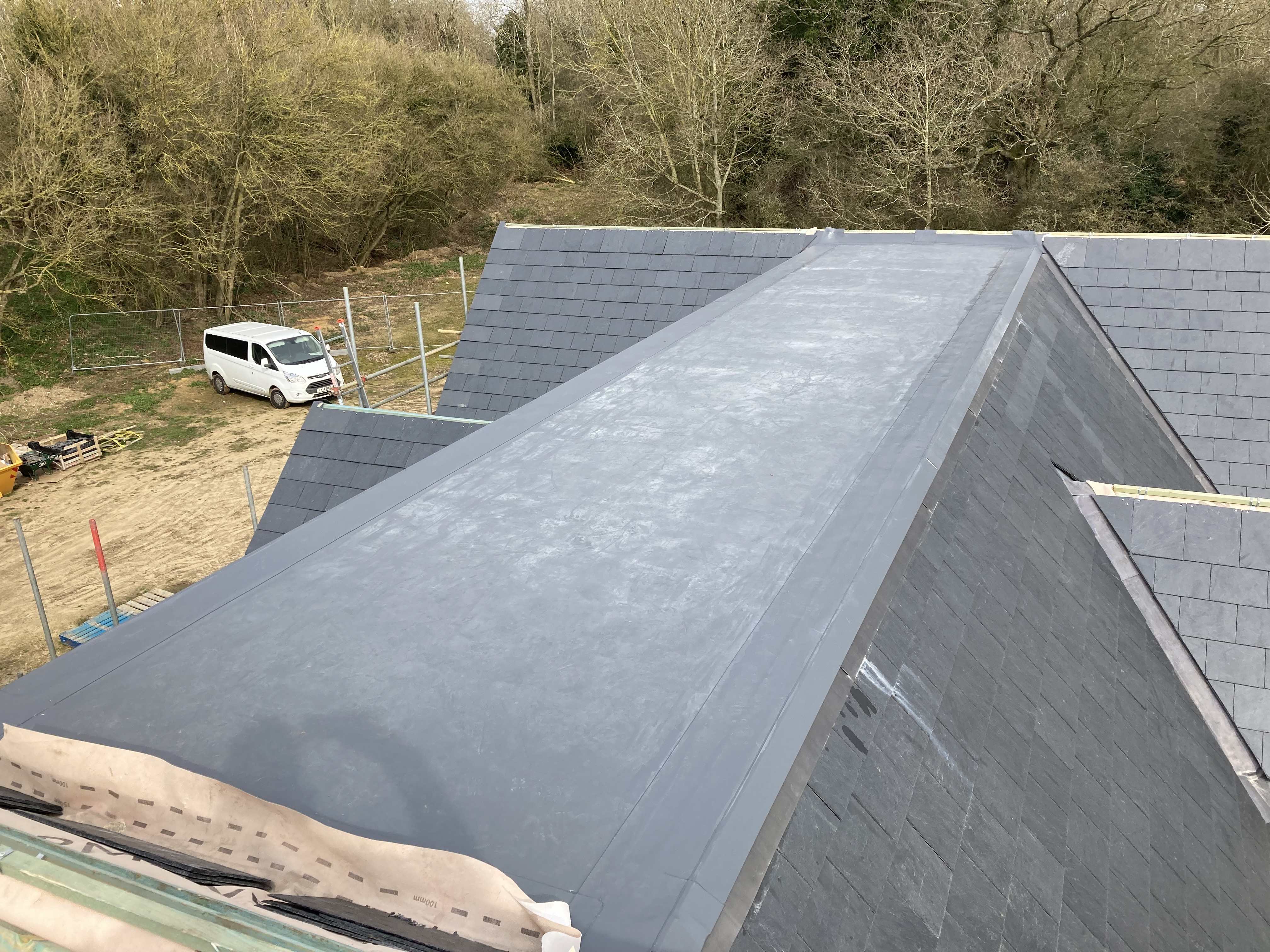

JohnMo Posted Sunday at 21:26 Posted Sunday at 21:26 5 hours ago, G and J said: welded PVC single ply membrane We've got a Sarnafil mechanically fixed and welded membrane. Great stuff, easy to do upstands etc. Comes with 10 year manufacturer guarantee, only qualified installers get to install. 1
G and J Posted Sunday at 21:35 Posted Sunday at 21:35 2 minutes ago, JohnMo said: We've got a Sarnafil mechanically fixed and welded membrane Will look that up. Thank you. 6 hours ago, mjc55 said: Interesting, did they say why EPDM was unsuitable? We are going for a green roof and currently thinking EPDM underneath. Essentially that on EPDM upstands, etc. are fixed with glue like a pushbike tyre and properly welded single ply membranes are stronger. They also cited the fact that EPDM often ends up wrinkly. Problem is they don’t do EPDM so one suspects bias. 59 minutes ago, Nick Laslett said: Good thread here on this topic. Like most of these discussions, the choice of material is less important than the skill and experience of the installer. Thank you Nick. Will read.
Kelvin Posted yesterday at 06:32 Posted yesterday at 06:32 We have this stuff. Similar to Sarnafil. https://www.alwitra.co.uk/single-ply-membranes
Nick Laslett Posted yesterday at 11:27 Posted yesterday at 11:27 13 hours ago, JohnMo said: We've got a Sarnafil mechanically fixed and welded membrane. Great stuff, easy to do upstands etc. Comes with 10 year manufacturer guarantee, only qualified installers get to install. @G and J, good luck understanding the various Sika offerings. Their website is a labyrinthine mess. We have Sika Trocal, which is welded and glued down. But our flat roof is very simple as it is just a table top, chopping off the ridge line. Even Sika Sarnafil has many variations. We have a 20 year Sika Manufacturer guarantee. This is who did our design and installation. http://jcservicesltd.com/services/cladding-installation They talked to Sika technical to clarify the design requirements.
