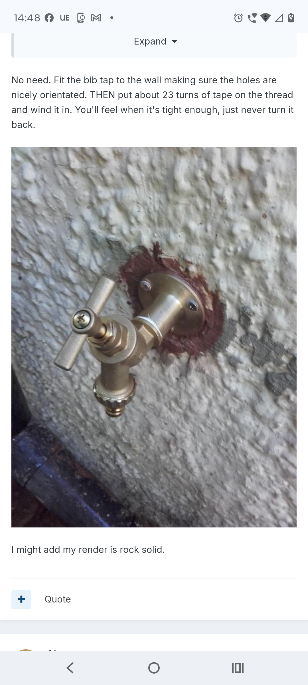

Kelvin Posted May 31, 2025 Posted May 31, 2025 (edited) That’s a dear outside tap. I fitted one of these to our retaining wall piped from the garage rather than attached to the house. Bit more industrial looking especially given the 32mm MDPE is just clipped to the wall rather than the clean look you’re going for. I might eventually box it in but probably won’t. It’s frost resistant but I don’t trust any of them even the ones that claim to be frost proof so I shut the water off to it in the winter. https://www.amazon.co.uk/stores/SHYNE/page/2A393583-03D4-4B3F-9164-5CD61D7831D0?lp_asin=B0CWPPPXRL&ref_=cm_sw_r_apin_ast_store_CFBWW5N3VZ2EC4JVYDEE&store_ref=bl_ast_dp_brandLogo_sto Edited May 31, 2025 by Kelvin

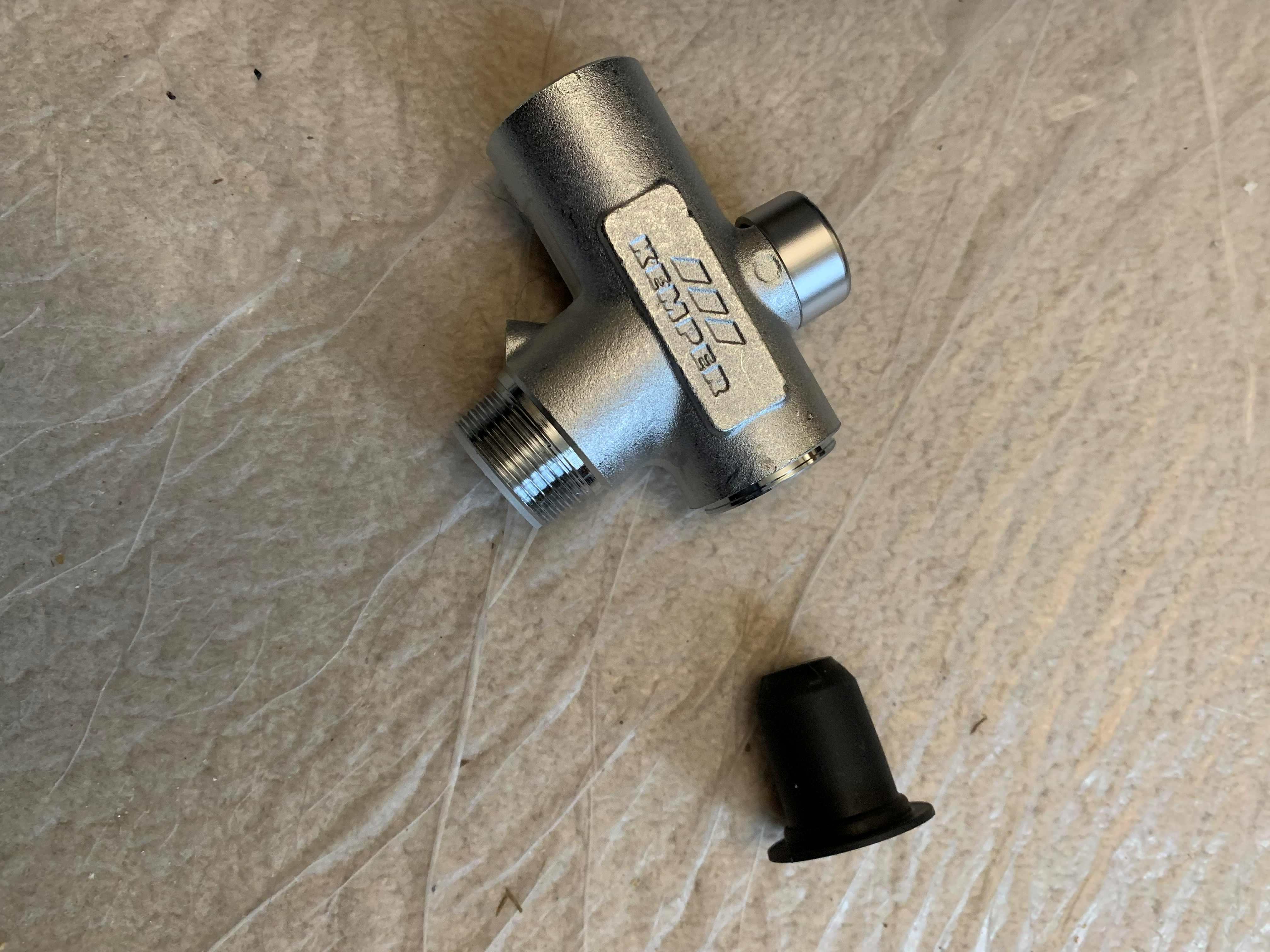

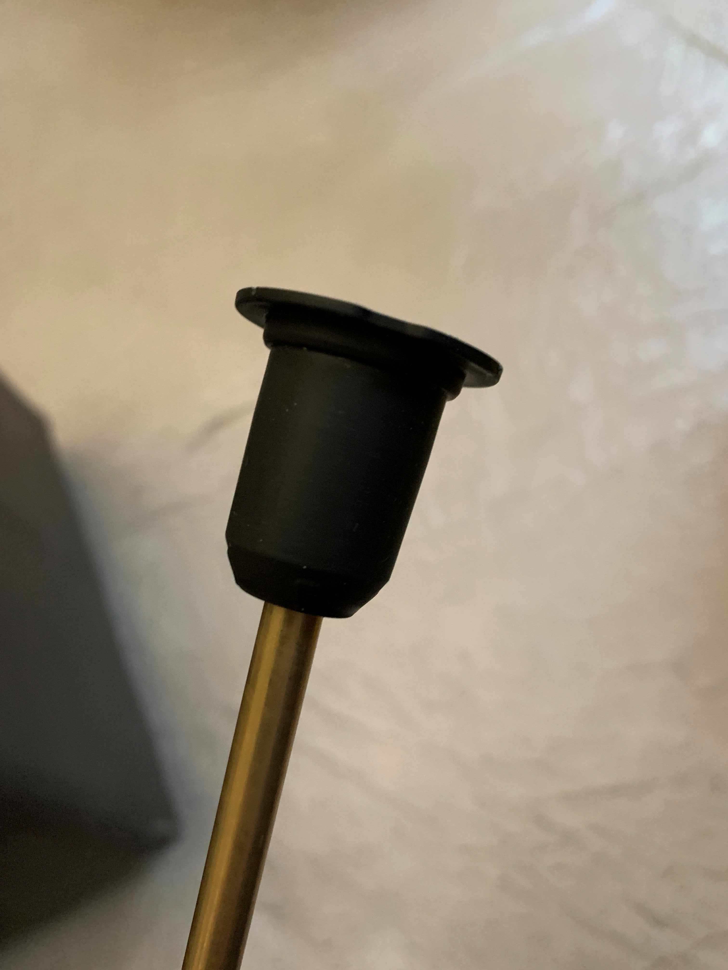

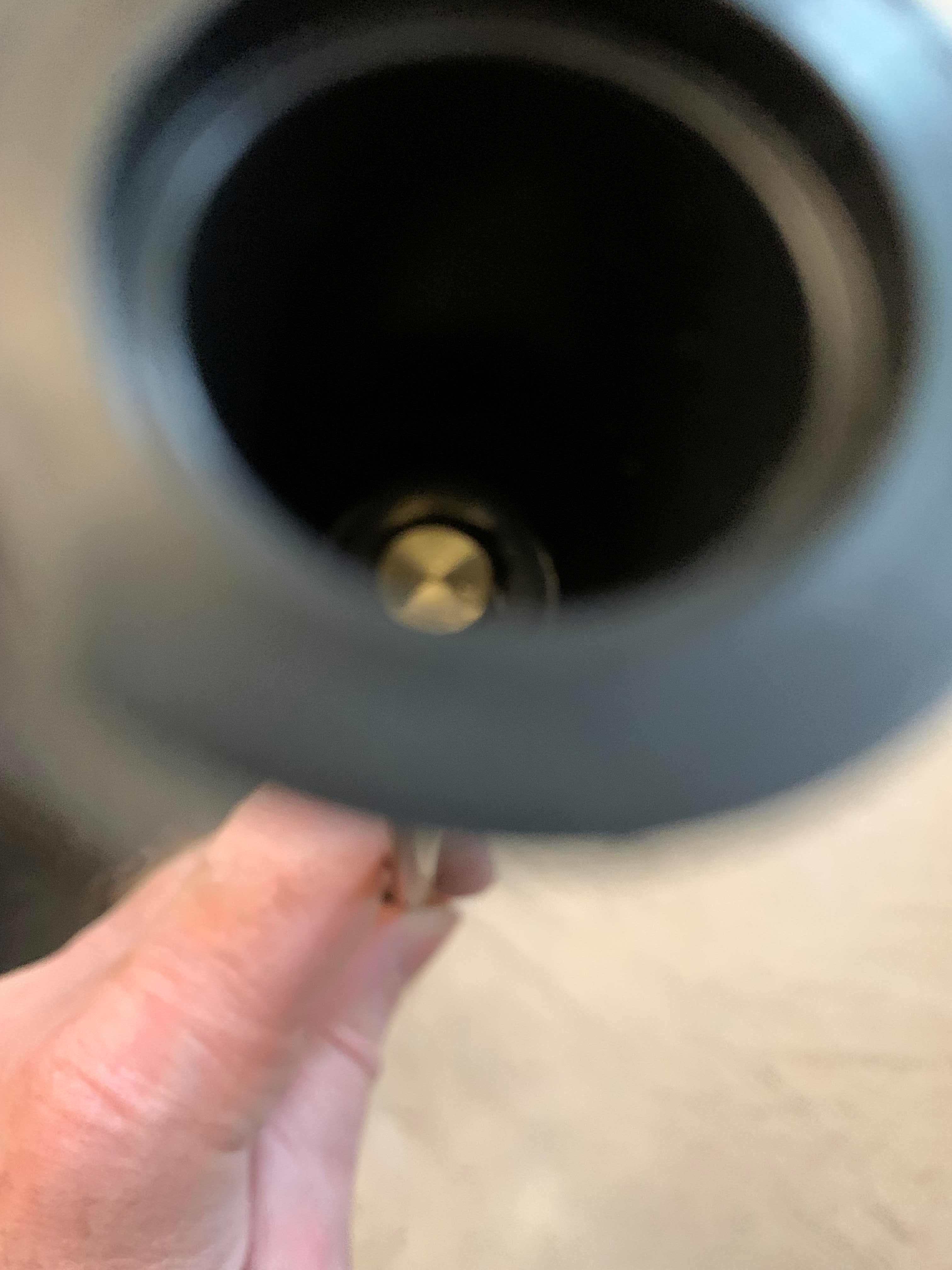

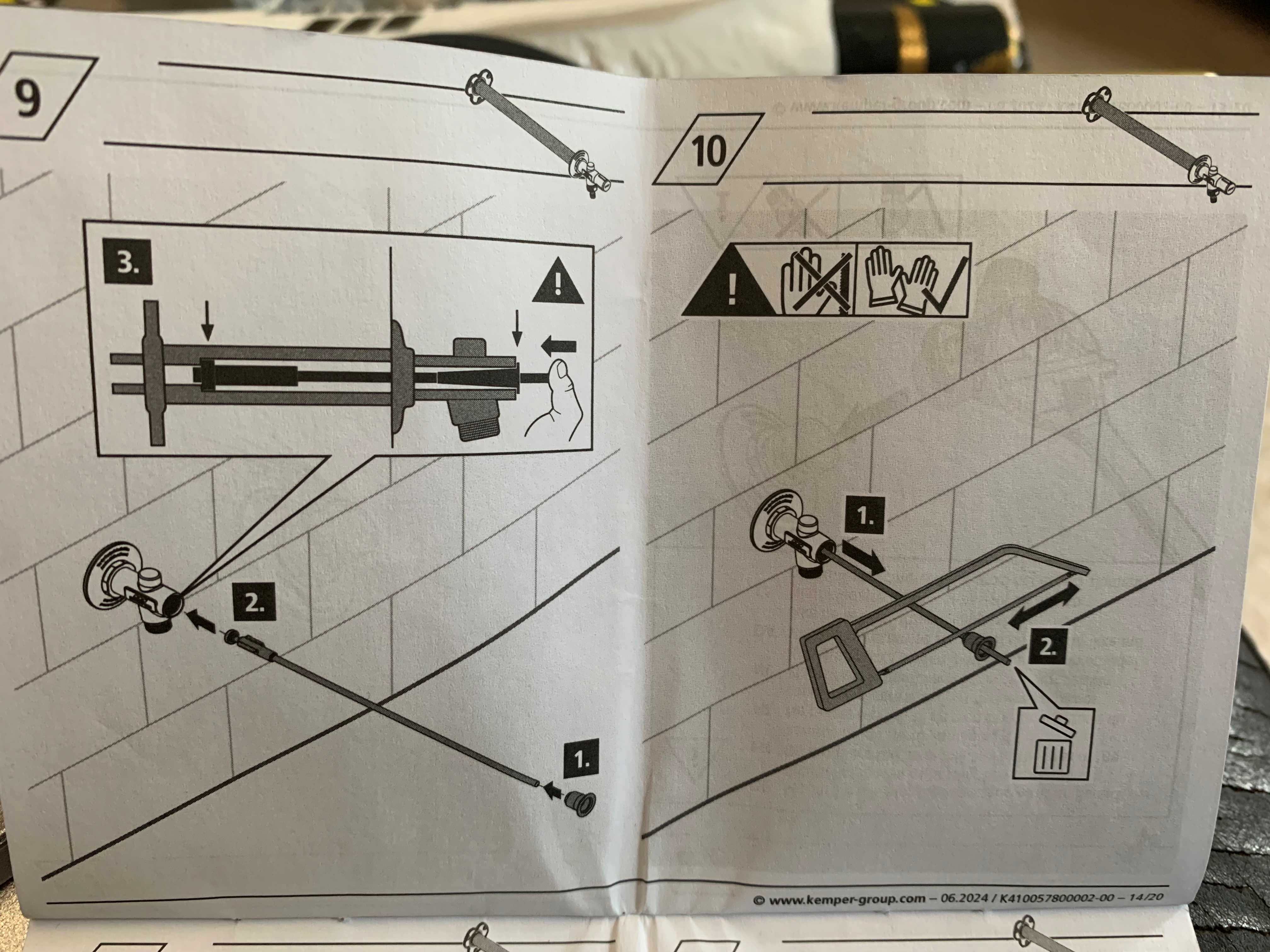

Spinny Posted Monday at 13:01 Author Posted Monday at 13:01 @Russell griffiths and all So I am cutting my Kemper Frosti tap down to the correct length. On the instruction leaflet it implies that a black plastic piece can be slid over and down the inner valve rod in order to mark the correct cutting point for the valve rod. However the black plastic piece does not seem to fit over the rod because the hole in the center is too small to slide over the rod. Anyone else that has fitted a Kemper Frosti had this problem ?
Nickfromwales Posted Monday at 14:00 Posted Monday at 14:00 18 minutes ago, Russell griffiths said: @Nickfromwales one for you. Fitted a few of these but iirc I had to lengthen them for PH dwellings where the walls were thicker than the tap was long. @Spinny, just put the black bit onto the tap without the bar, to see where it seats. Note the position of the face of the plastic bit. Then put the bar in and put the black bit on the end. Measure the two points, face when planted, and face when out too far, and that's the amount to cut off.
Spinny Posted Monday at 17:02 Author Posted Monday at 17:02 1 hour ago, Nickfromwales said: put the black bit on the end Not sure I follow because the black bit will not fit on the end of the rod and slide down it - as shown in this video... Yes I can measure the length of the black bit (which is designed to to seat against the outside edge of the tap block), then mark the position of the outside edge of the tap block onto the rod, then measure down the rod by the length of the black bit. Or I could widen the hole in the black bit so it will fit over the rod. The measurement option is prone to measurement errors. It seems odd that they would supply a thing to make sure you can measure the rod length precisely, but then not have it actually fit the rod. The rest of it all seems to go together very well and is carefully engineered. So makes you wonder a lot when something like that just doesn't fit. There is a small chamfer on the end of the rod which fits the hole in the black bit, but it won't slide down beyond that. You can't achieve what is shown in the inset diagram labelled 3 or on the video. I notice the valve end is spring loaded, so I suppose there is room for error perhaps, but getting the length spot on presumably maximises the spring compression and the strength of the seal.
Nickfromwales Posted Monday at 17:46 Posted Monday at 17:46 Time to push a bit harder? As long as it still has friction, it'll still function as a marker. It's disposable after that?

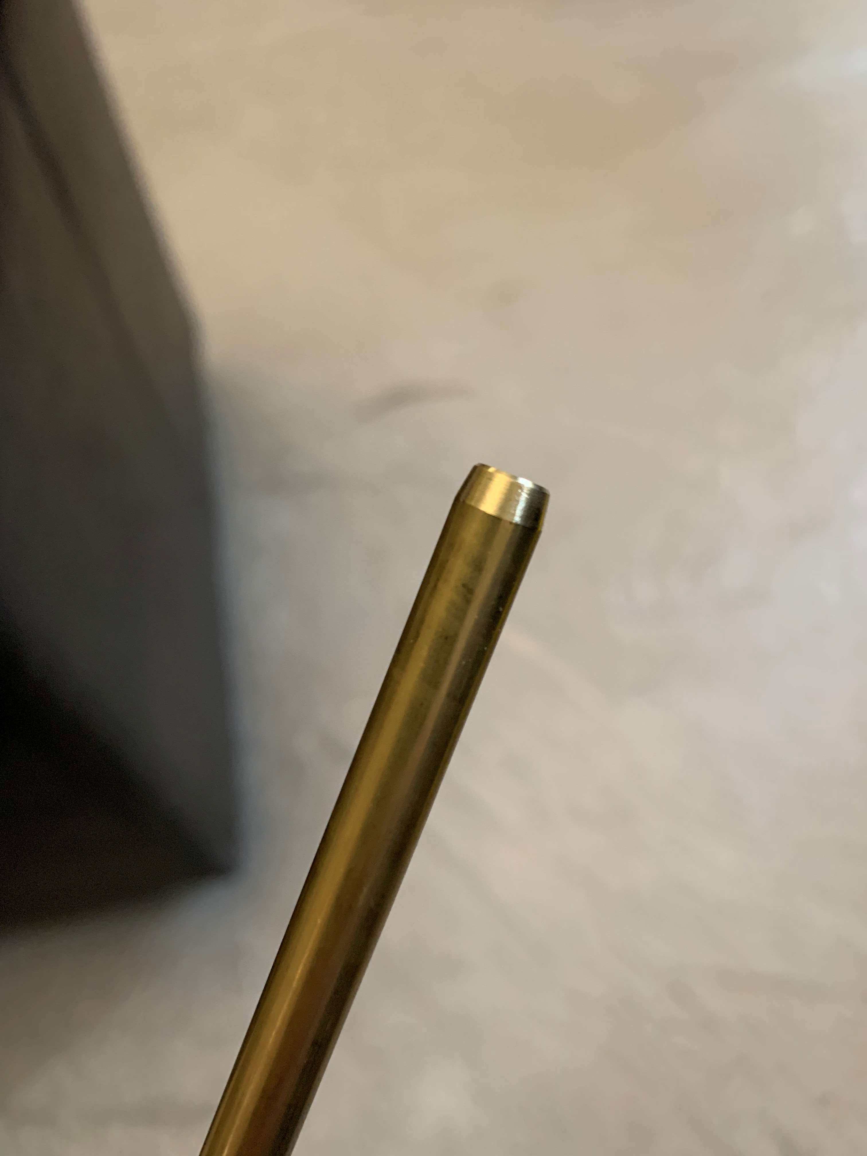

Spinny Posted Monday at 17:59 Author Posted Monday at 17:59 @Nickfromwales Also any other tips from your experience of fitting them, in particular... (a) Wondering what the main tube is made of. It looks quite thickish and when I ran a junior hacksaw across it (admittedly probably a blunt blade) I couldn't even mark it. Planning to get the plasterer/carpenter guy to machine cut it to the length I mark for me, but not sure what blade it might require. (b) The instructions show fitting the 90 degree pipe bend fitting onto the inside end before fitting the outside tap end. So do I defo need to do this first - I am guessing maybe trying to tighten the 90 degree fitting would be tricky if done last as the tap end will want to rotate ? (c) Thinking of using a 90 degree isolating valve on the inside end, and probably another one further along the pipe for ease of access as the inside end will be hidden behind kitchen appliances so rather inaccessible. (c) Any issues when tightening up the outside against a vertical surface given the tube runs at a slight downward angle ?
Spinny Posted Monday at 18:35 Author Posted Monday at 18:35 17 minutes ago, Nickfromwales said: Time to push a bit harder? It would have to be hammer time. I think it would be better to drill or twist out the hole very slightly TBH. What are those German's up to though ?
Nickfromwales Posted Monday at 19:19 Posted Monday at 19:19 1 hour ago, Spinny said: @Nickfromwales Also any other tips from your experience of fitting them, in particular... (a) Wondering what the main tube is made of. It looks quite thickish and when I ran a junior hacksaw across it (admittedly probably a blunt blade) I couldn't even mark it. Planning to get the plasterer/carpenter guy to machine cut it to the length I mark for me, but not sure what blade it might require. (b) The instructions show fitting the 90 degree pipe bend fitting onto the inside end before fitting the outside tap end. So do I defo need to do this first - I am guessing maybe trying to tighten the 90 degree fitting would be tricky if done last as the tap end will want to rotate ? (c) Thinking of using a 90 degree isolating valve on the inside end, and probably another one further along the pipe for ease of access as the inside end will be hidden behind kitchen appliances so rather inaccessible. (c) Any issues when tightening up the outside against a vertical surface given the tube runs at a slight downward angle ? Exactly what kit did you buy? Do you have a link to it?

Nickfromwales Posted Monday at 19:30 Posted Monday at 19:30 1 hour ago, Spinny said: (a) Wondering what the main tube is made of. It looks quite thickish and when I ran a junior hacksaw across it (admittedly probably a blunt blade) I couldn't even mark it. Planning to get the plasterer/carpenter guy to machine cut it to the length I mark for me, but not sure what blade it might require. (b) The instructions show fitting the 90 degree pipe bend fitting onto the inside end before fitting the outside tap end. So do I defo need to do this first - I am guessing maybe trying to tighten the 90 degree fitting would be tricky if done last as the tap end will want to rotate ? (c) Thinking of using a 90 degree isolating valve on the inside end, and probably another one further along the pipe for ease of access as the inside end will be hidden behind kitchen appliances so rather inaccessible. (c) Any issues when tightening up the outside against a vertical surface given the tube runs at a slight downward angle ? I can tell you're unnerved, as you forgot that D comes after C, awwww.....bless. a) Its solid brass, so you need to argue with your wife over something utterly trivial, for a minimum period of 30 mins, then go cut it with a hacksaw with a 32tpi blade. b) use a Hep2o fitting which will allow rotation and be bombproof. Need to see the link to advise further. c1) one isolator is sufficient. 2 is greedy. Put this anywhere where you can get to it. c2) (the rest of us call this a "D" ) as per the video, turn the nut so the belled end goes into the plate, and that then acts like a universal joint so the plate finishes flat and vertical. Remember from a health and safety POV, when you've cut through the thick brass the blade of the hacksaw will be VERY VERY hot, so turn to your missus and say "Can't touch this". Safety first

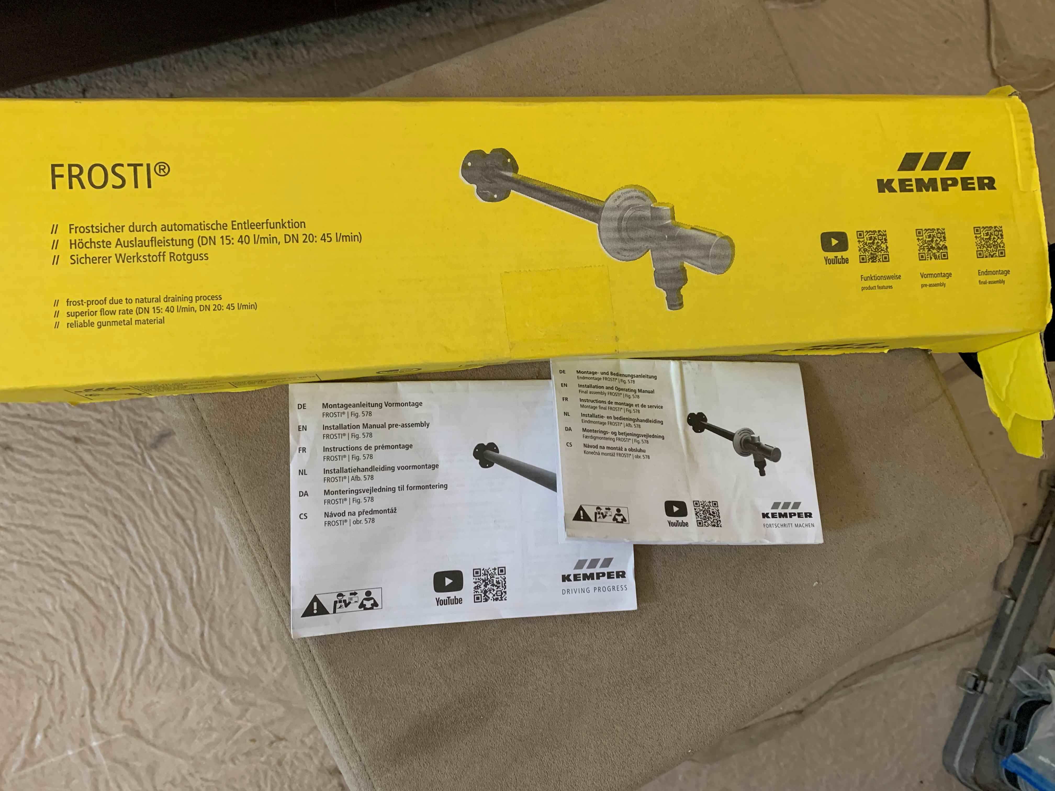

Spinny Posted Tuesday at 13:17 Author Posted Tuesday at 13:17 This is the kit I bought from Amazon Germany...Frosti Tap Photo attached. I now notice the box says it is made of gunmetal - which appears to be a type of bronze or 'red brass' which can be used for canons. (Tempting as it might be to hammer dance, I fear it's effect on my joints. And the last time I danced a Conga a 'friend' posted it on tinternet. My spouse was once my dance teacher though.) 16 hours ago, Nickfromwales said: awwww.....bless Hey I'm not in the old people's home yet - pardon. 1
Nickfromwales Posted Tuesday at 14:56 Posted Tuesday at 14:56 1 hour ago, Spinny said: This is the kit I bought from Amazon Germany...Frosti Tap Photo attached. I now notice the box says it is made of gunmetal - which appears to be a type of bronze or 'red brass' which can be used for canons. (Tempting as it might be to hammer dance, I fear it's effect on my joints. And the last time I danced a Conga a 'friend' posted it on tinternet. My spouse was once my dance teacher though.) Hey I'm not in the old people's home yet - pardon. The exact same one I fitted in Leicester. IIRC I used a threaded fitting from hep2o, and PTFE taped it onto the threads of the Frosti. I had to use that to lengthen the tap though. Are you going to need to have an angled fitting immediately on the end of the tap to connect it flush to the wall?

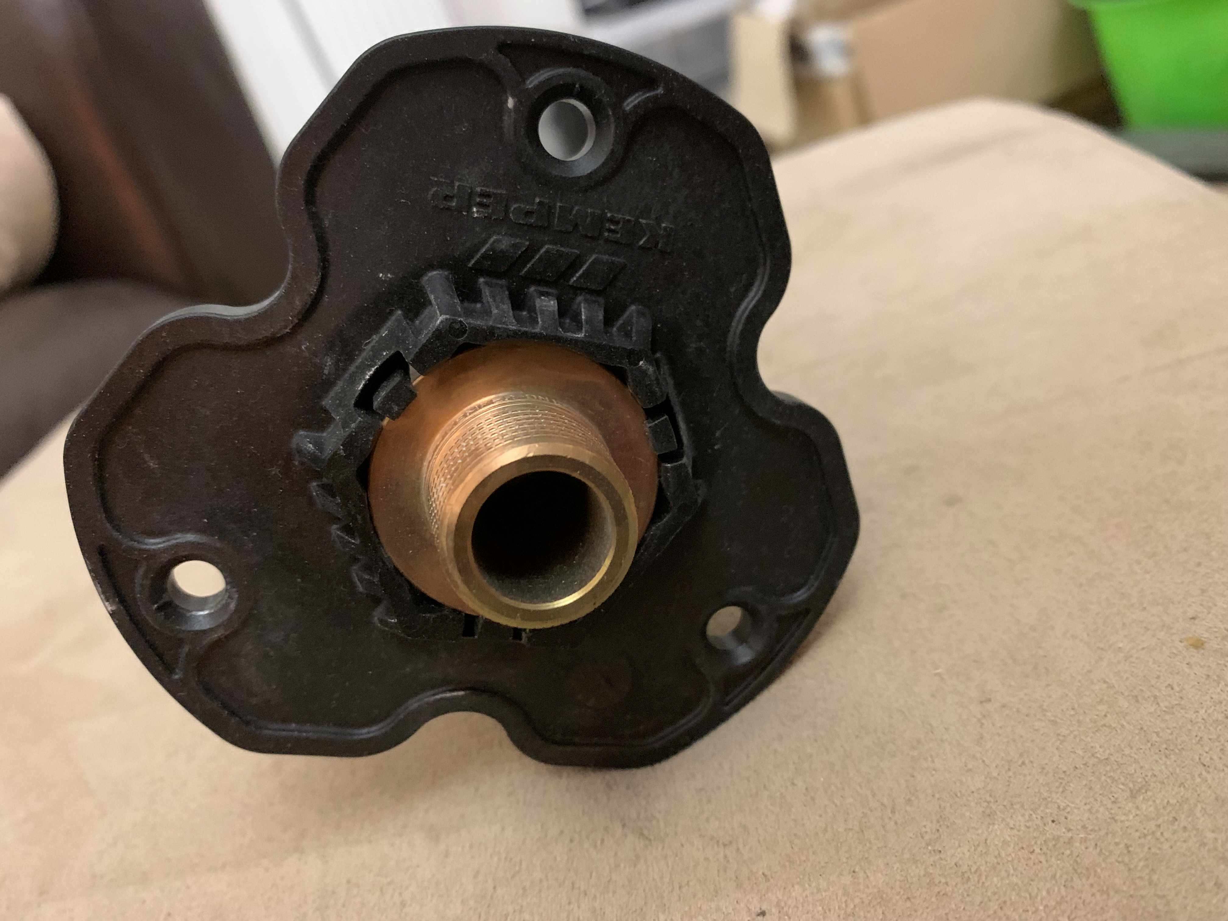

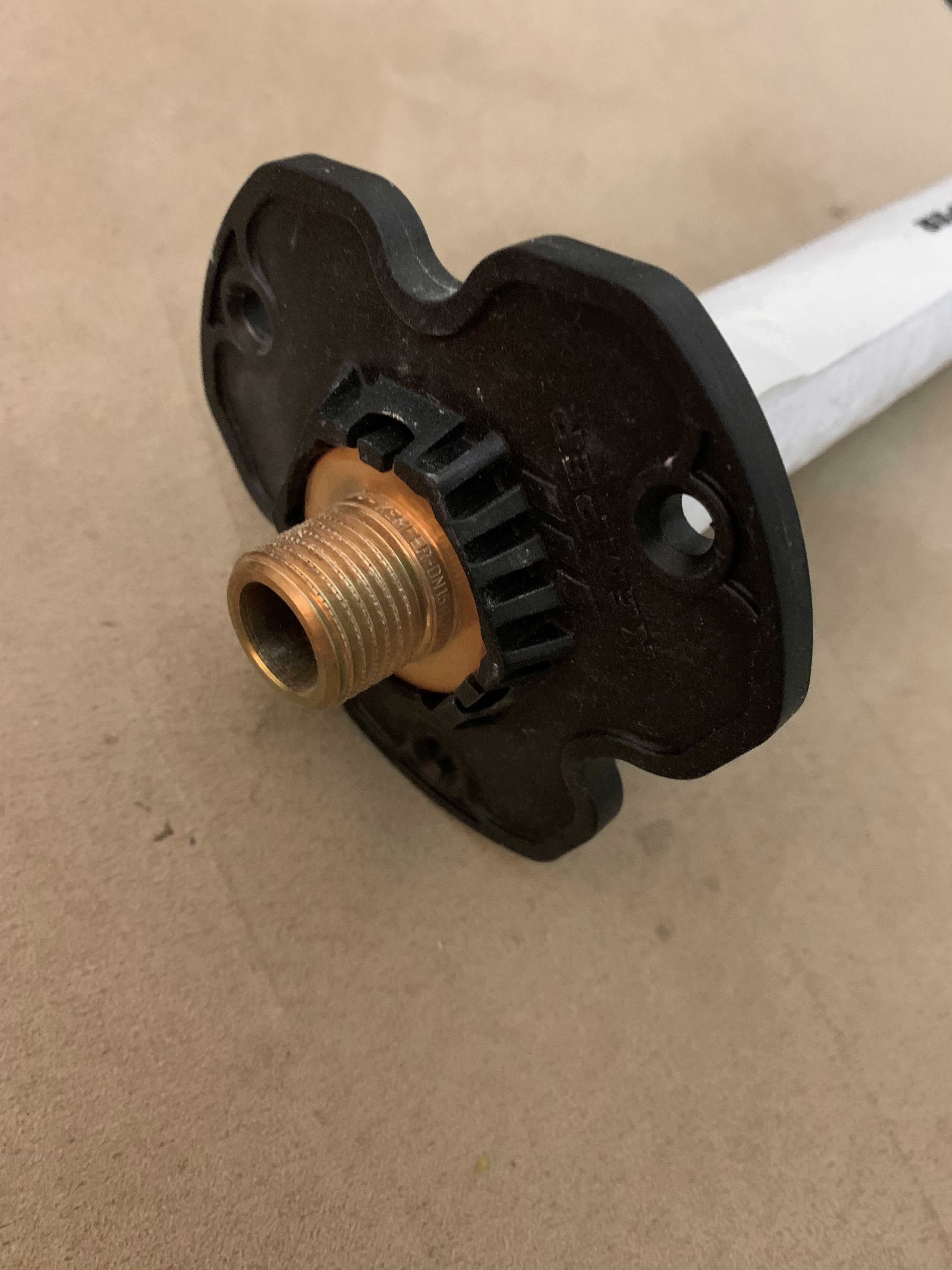

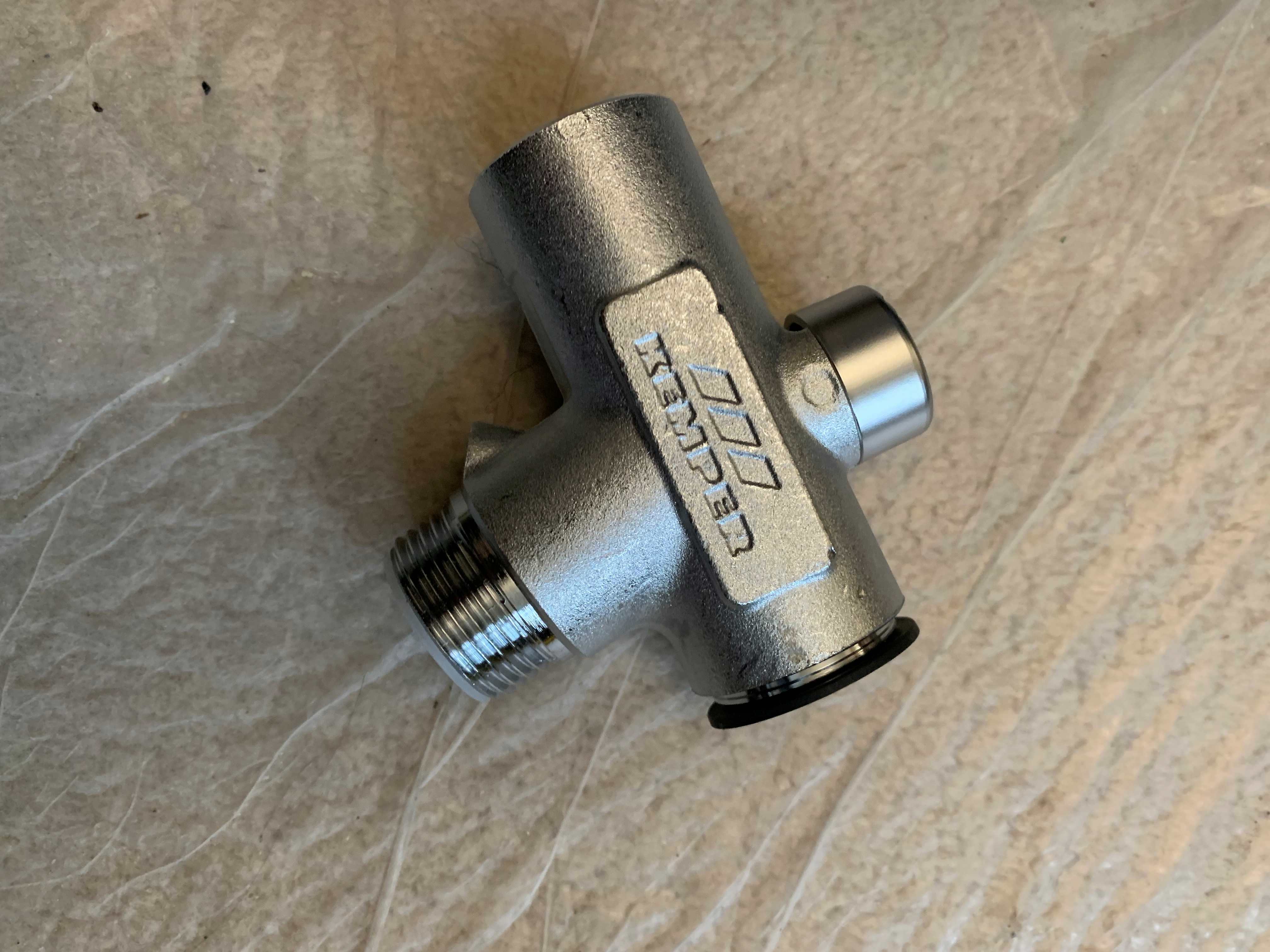

Nickfromwales Posted Wednesday at 09:58 Posted Wednesday at 09:58 Can you post a pic of the internal piece that you need to connect to please? I’ve seen a few variations of these so want to advise according to what you have there.
Spinny Posted 13 hours ago Author Posted 13 hours ago @Nickfromwales Here you go... (Looks like carpenter/plasterer guy has a jigsaw blade that will cut the pipe. If we can get the plaster board problem I just posted solved first)

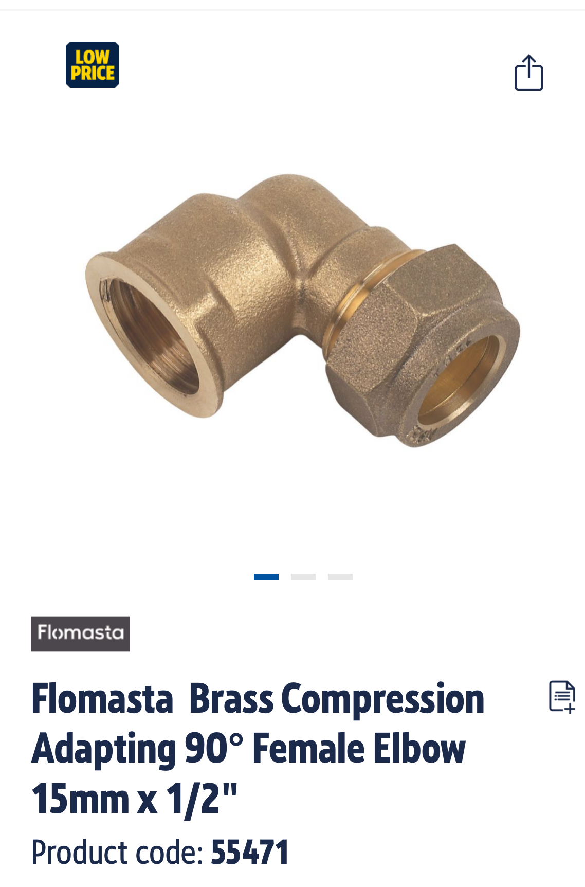

Nickfromwales Posted 12 hours ago Posted 12 hours ago Looks like 1/2” BSP, but would need you to buy a fitting and prove it obvs. Then one of these can be put on the end with 21 turns of PTFE, if you’re feeling brave. You put a short (100-150mm) piece of copper in the 15mm entry and then use a push fit connector to go from copper to plastic, if you’re using push fit? Don’t put push fit into the compression nut or the 4 horsemen will descend upon you. Failing that, I’ll just disapprove.
