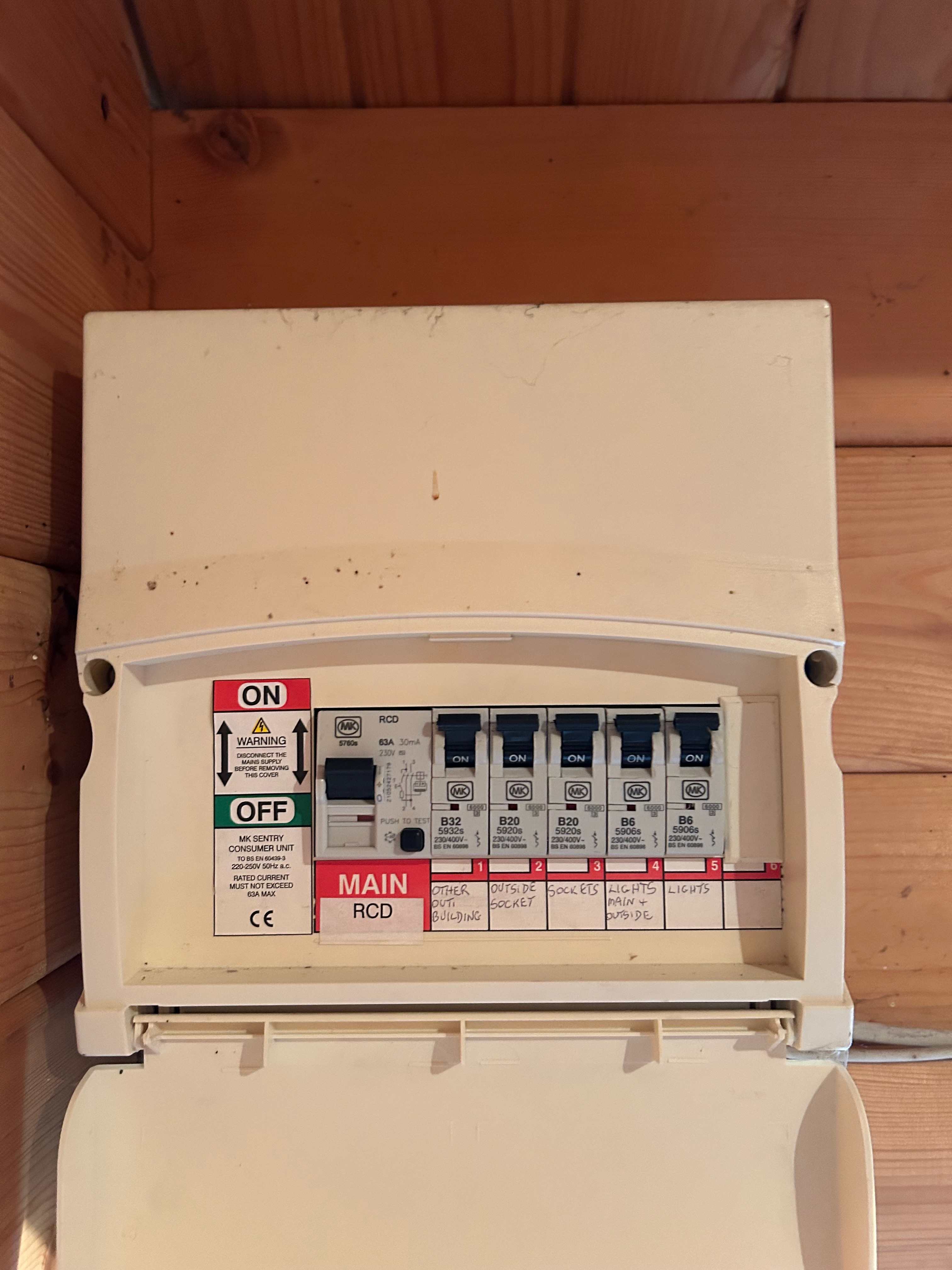

Hi there,
I'm just about to go ahead with a deposit for a solar system but wondering if I should be future proofing more.  Currently on single phase which powers the house and a large separate garage and flat above.  That is fed on a dedicated 24m2 cable.
Solar wise, we are going sig energy and looking at 16kw batteries and 14kw PV. As part of this, we are also getting the multiphase zappi charger. All of this will be housed in the garage.
Upcoming in next year or so: -
  1. ⁠⁠16kw ASHP. Power input I think is around 6kw. This is sized large to also provide heat for workshop.
  2. New large workshop building. It will have a lot of equipment, some needing 16amp supply but as it’s just me in theory I’d only use a large dust extractor (2-3kw max) and 1/2 machines at a time with max maybe an additional 2-3kw.
  3. The existing garage will be converted at some point to an air bnb which may put more concurrent demand on. Likely we may but a small gas boiler in to utilise existing LPG tank we have in order to remove existing electric shower and small water heater for tap.

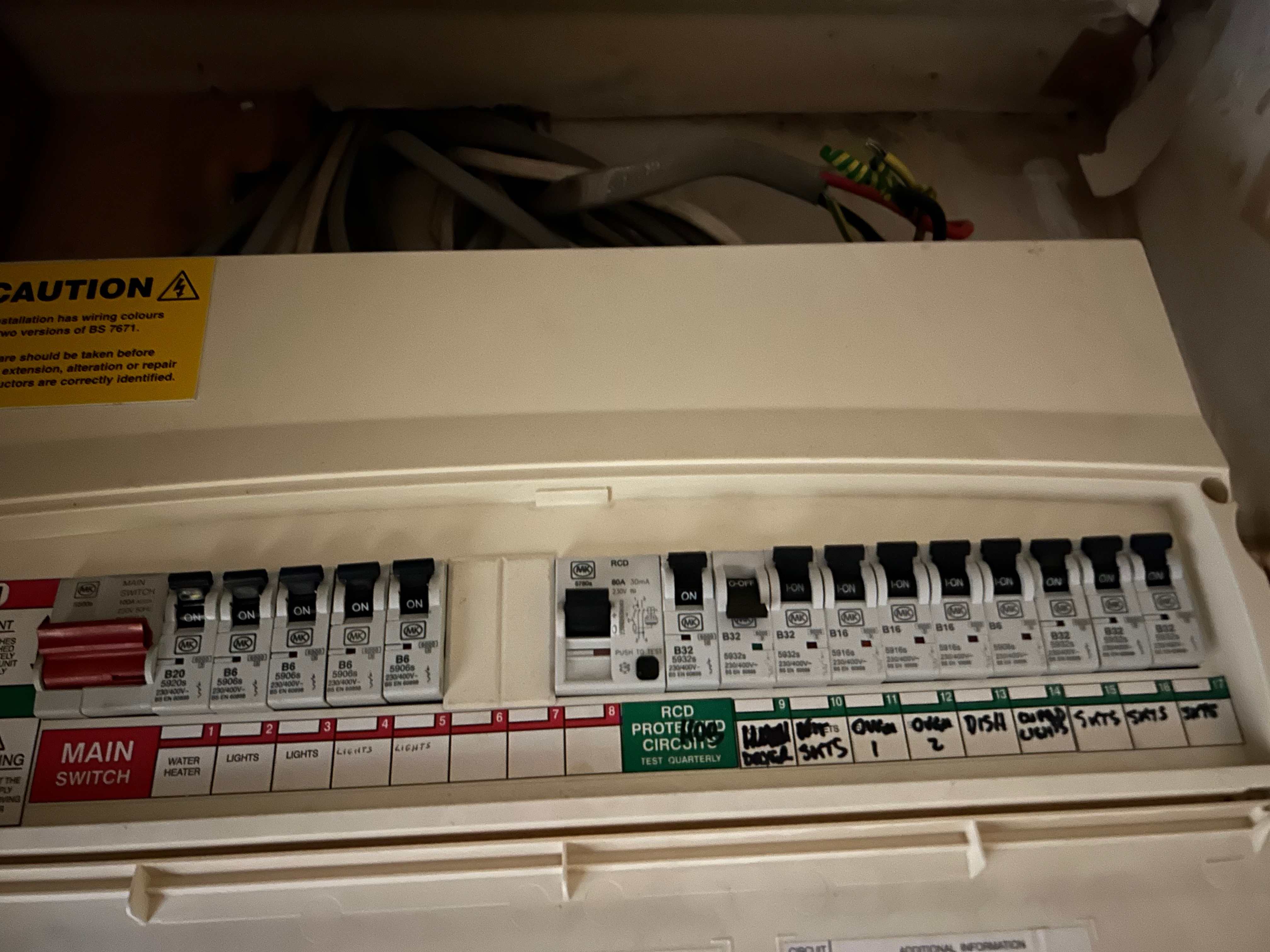

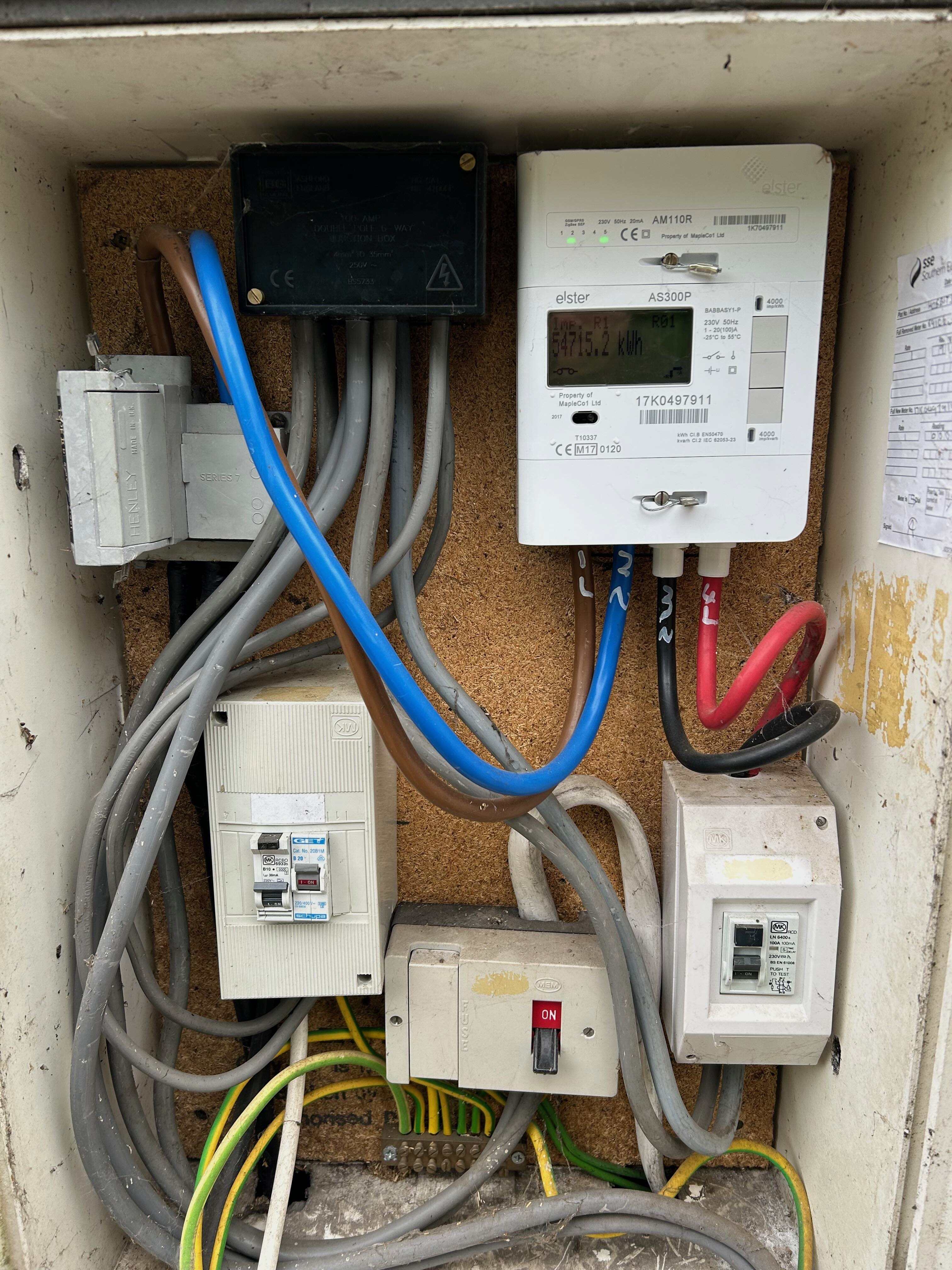

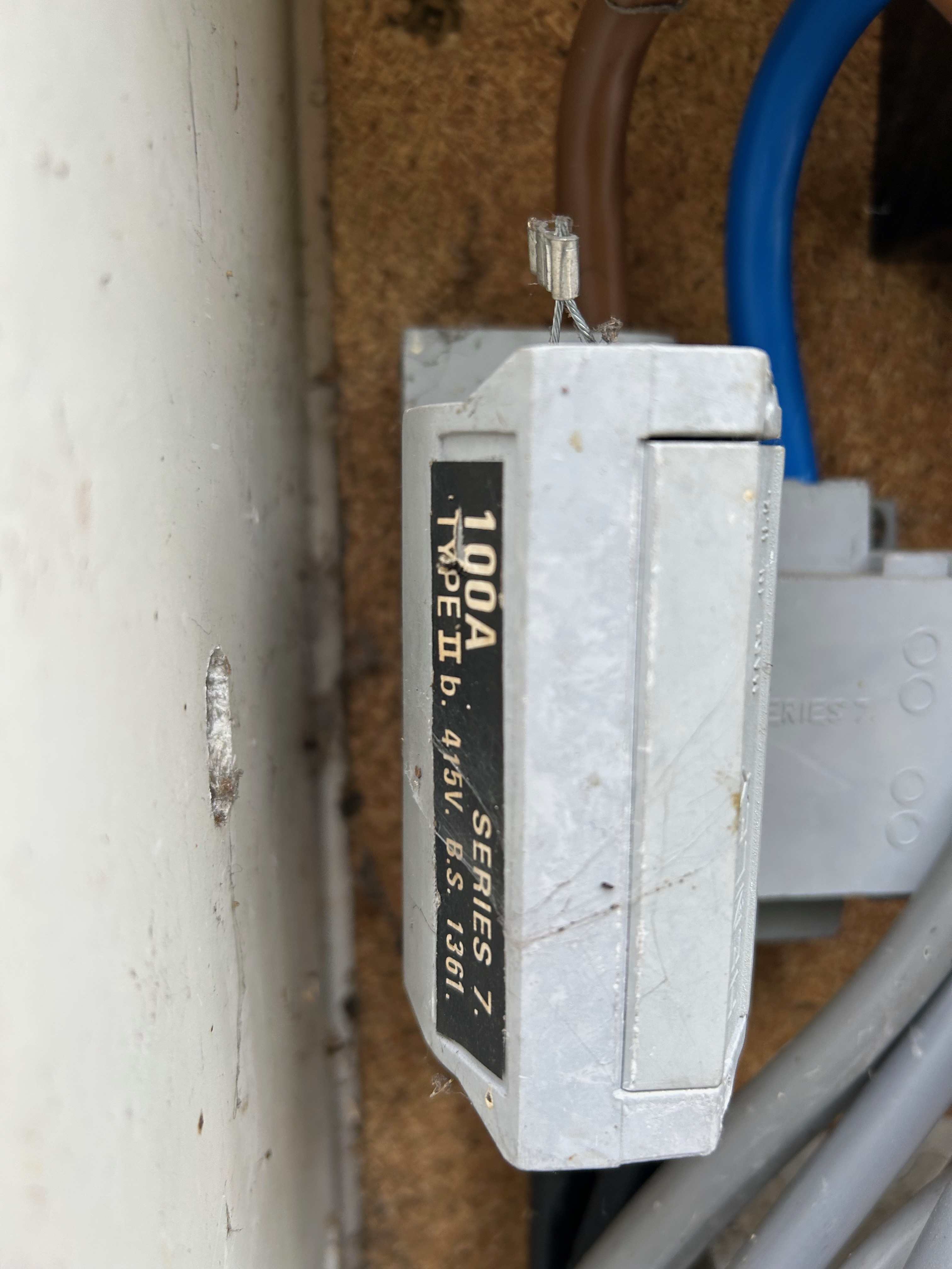

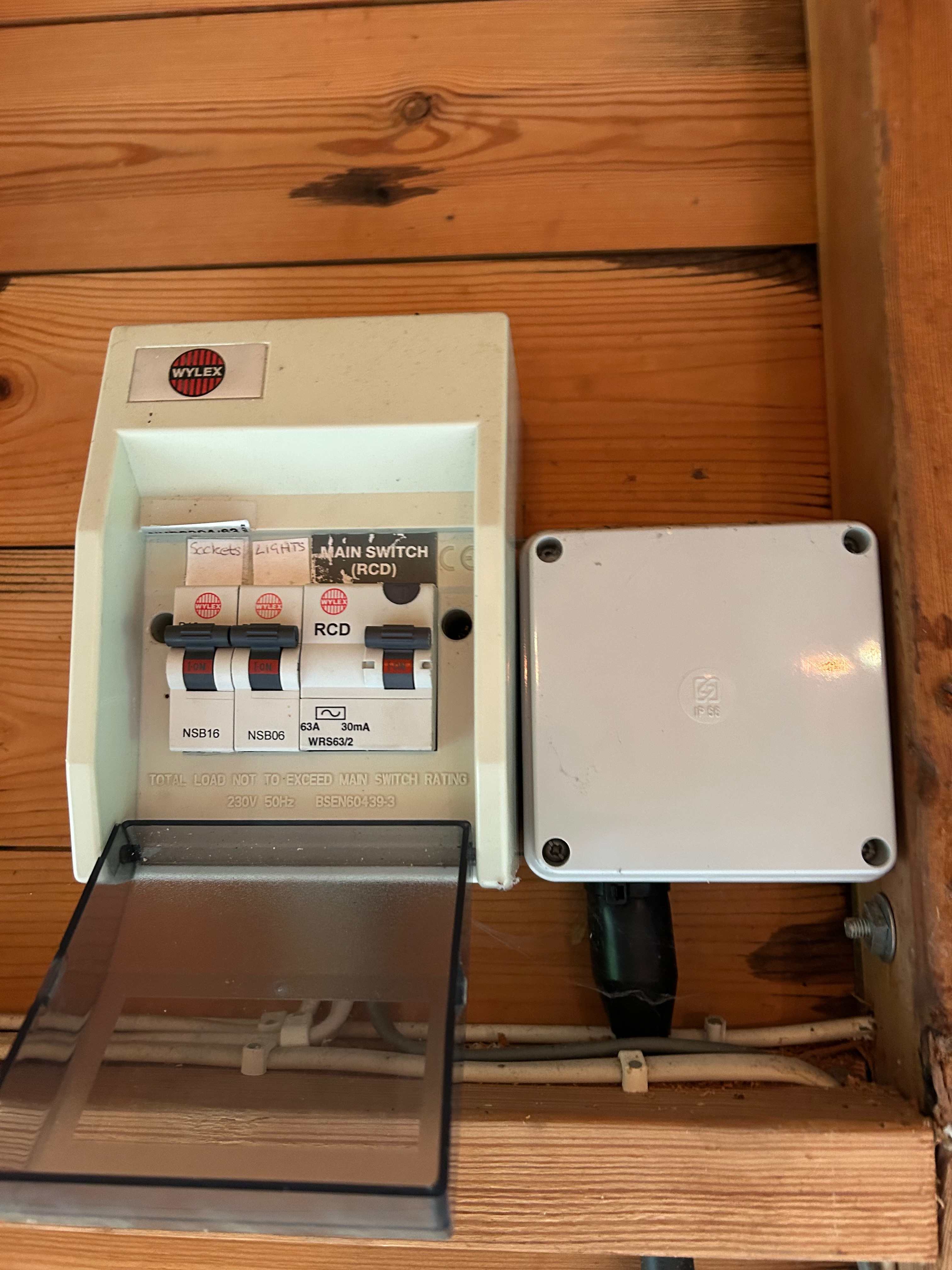

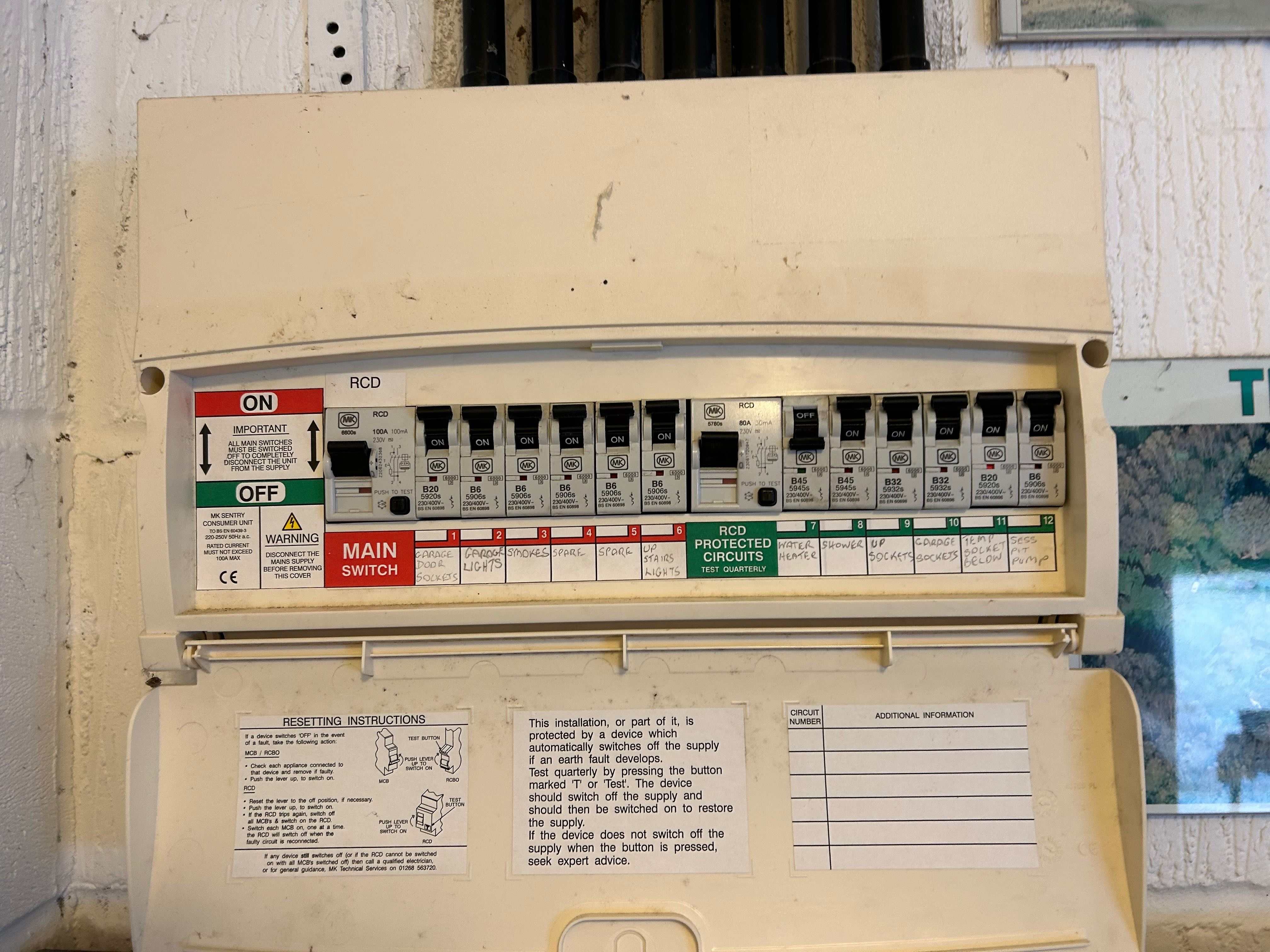

I've attached a few photos of current setup.
So i guess my questions are...
  1. With my future demands (whereby there could be a mix of house, airbnb garage and workshop running at same time), should I be considering 3 phase?
  2. Even if the above demands 3 phase, is it worth getting solar 3 phase equipment? Or would it make more sense to seperate phases to garage, house and workshop?
  3. I'll also note that utilising 3 phase for the car charger and workshop for bigger equipment is a real nice to have
Thanks

Haven't you answered your question.
Wouldn't that need 3 phase?
13 minutes ago, d438a1 said:
small gas boiler in
That will exclude you from any grants, for a heat pump.
The zappi works on single or multiphase. I always charge overnight anyway, so it's not deal breaker if it stays on 7kw.
On the main house I'm replacing an existing LPG boiler with heat pump. I didn't realise it would somehow invalidate that grant if i got a separate gas boiler later for other building?
Thanks

  • Even if the above demands 3 phase, is it worth getting solar 3 phase equipment? Or would it make more sense to seperate phases to garage, house and workshop?
Haven't seen this answered, but, even if you do have different phases to different areas, so long as the whole lot are being supplied via a DNO cut out and single mater,  you can still put a 3 phase inverter onto the main 3 phase supply and then divide the phases out to sub distro boards as needed. To a degree this is always going to be the case - there's no such thing as a 3 phase domestic "ring main" socket so some areas of the house will be on different phases. And you'll probably want all 3 phases in the garage anyway for the car lift or, whatever.
If you're worried about balancing PV generation to demand across phases, don't. Modern meters to net billing so you're only charged for your net import (or paid for net export) across phases at any given moment in time.
Couple more things to note:
- you can't buy a 3 phase inverter now "just in case" and upgrade to 3 phase supply later. A 3 phase inverter needs 3 phases to output onto.
- A single battery often has a power limit lower than it's capacity, e.g. a 16kWh sized battery may only be able to supply 5kW at any given moment. This also limits it's usefulness for high demand users
- do you have DNO approval for 14kW PV ? They may look more kindly to this if on 3 phase.
- have you asked for an indicative price for 3 phase? This maybe prohibitive and will answer your question
- "The 16kw was advised as part of a recent quote I had." - this is obviously just guess work with so much future expansion of use planned. tldr you can always more than you have, the optimum size depends a lot if you just plan to time shift your PV generation or use it for cheap overnight rate time shifting too. With my tariff (Eon Next) it's actually more financially rewarding to sell all PV generation rather than store it, and then fill the battery from grid each night. But that may change when the tariff is updated next year.....

You ideally needs to split your PV across the phases you use during the daylight hours.
Net Metering may be possible with your energy company, but check first, and check if you can get a Net Meter fitted.

2 hours ago, d438a1 said:
Sorry if I'm being slow, but I still didn't quite work out if having 3 phase inverter is worth it :)
If you have a 3 phase supply anyway, and the price is not prohibitively higher, then yes it is.
Splitting your generation over phases means less voltage lift per phase, so less risk of the inverter shutting off if the local supply voltage runs high.

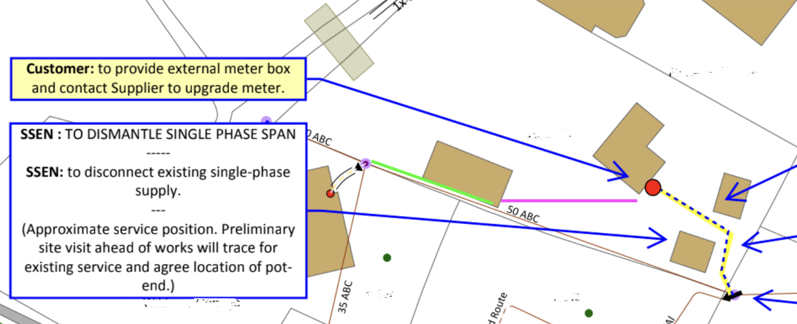

So had a quote back which was pretty reasonable at £1500 inc vat, but with me doing excavation and ducting. I've attached the plan they sent me. Currently my supply is overhead from the pole and they are mandating it needs to be underground following yellow line. However it's quite a tricky run with lots of concrete.
However, I'm now thinking maybe of using the wooden pole near the garage and house the meter, etc in garage or behind garage. I've already got a trench open (in pink line) to then feed back to house. There is also the existing 25m2 armoured cable between house and garage.
What are thoughts on reconfiguring and housing in garage?
