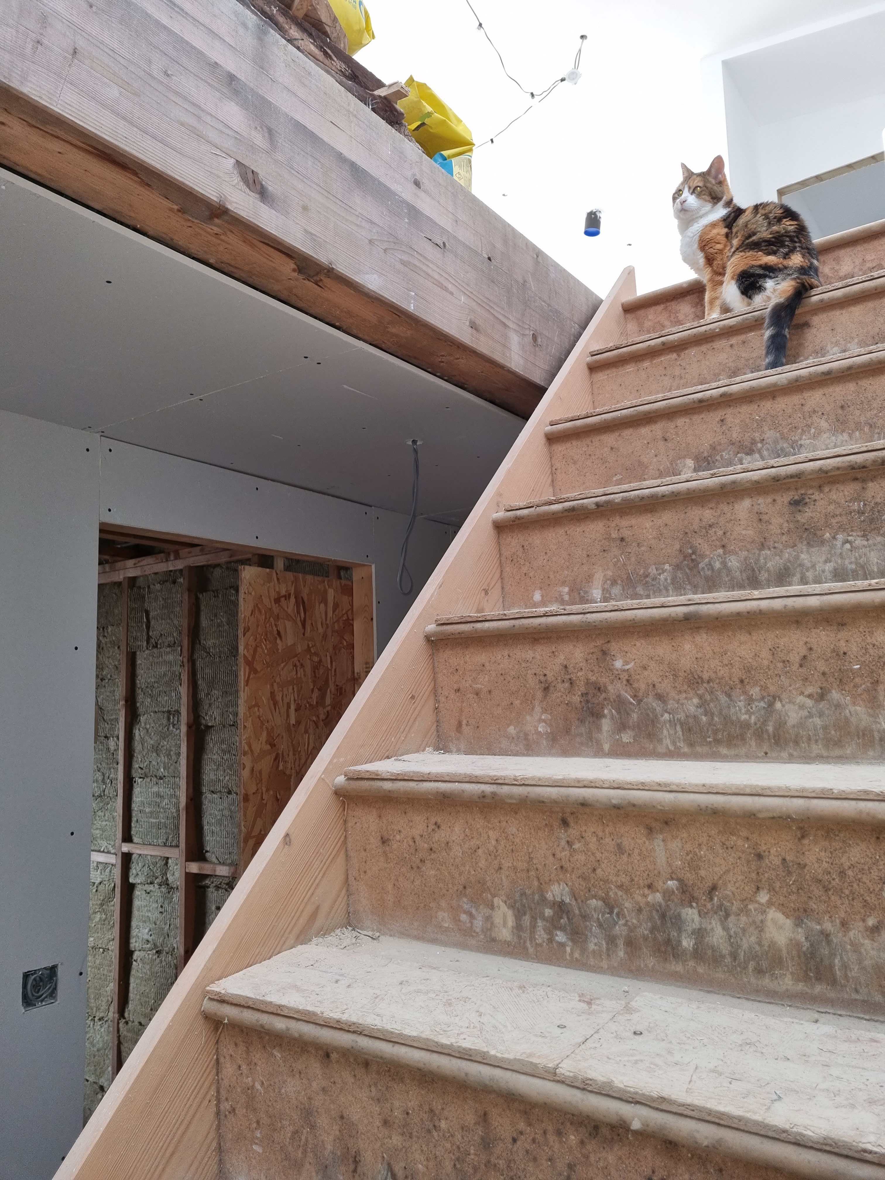

May 28, 20251 yr We have a 6m long Glulam beam that runs along the side of our stairwell that will remain as an exposed feature and it protudes up into the upper living area floor. We will be installing a slatted "wall" between the top of the glulam and the ceiling. PROBLEM: The glulam currently sits about 5-10mm lower than our final floor level. It's this one being inspected by the cat. We've been in touch with the glulam supplier to get a length of the wood that makes up the Glulam beam (6m x 140mm x 40mm) but they can't provide this and suggested just getting a 6m 6x2, which I can get from a number of timber merchants. My experience of these suppliers is warped, like some of the wood supplied. Does anyone know of a supplier who could provide something that is not going to warp or twist, or do I just have to get the piece in and fit it pronto with lots of glue and screws? Anyone got other idea on how to make up the shortfall? Thanks

May 29, 20251 yr Author 13 minutes ago, Mr Punter said: I don't understand why you need a 6 x 2 to make up 5-10mm We actually want the Glulam to come up above the FFL. The extra 30-35mm will do this nicely. Should have said.

May 30, 20251 yr Author Thanks for all the responses. To be clear, I am the joiner (and a lot more besides - see the blogs, this a true self build). Thanks for all the advice and tips. Time to get some bigger clamps. The glulam is exposed underneath, to one side (see photo) and to the top. I'd prefer to do this as a single piece if possible, but thinking about it, the join would only be really visible from the stairs, and eyes will be focussed forwards, not sideways (except mine of course!) What glue would people recommend?
