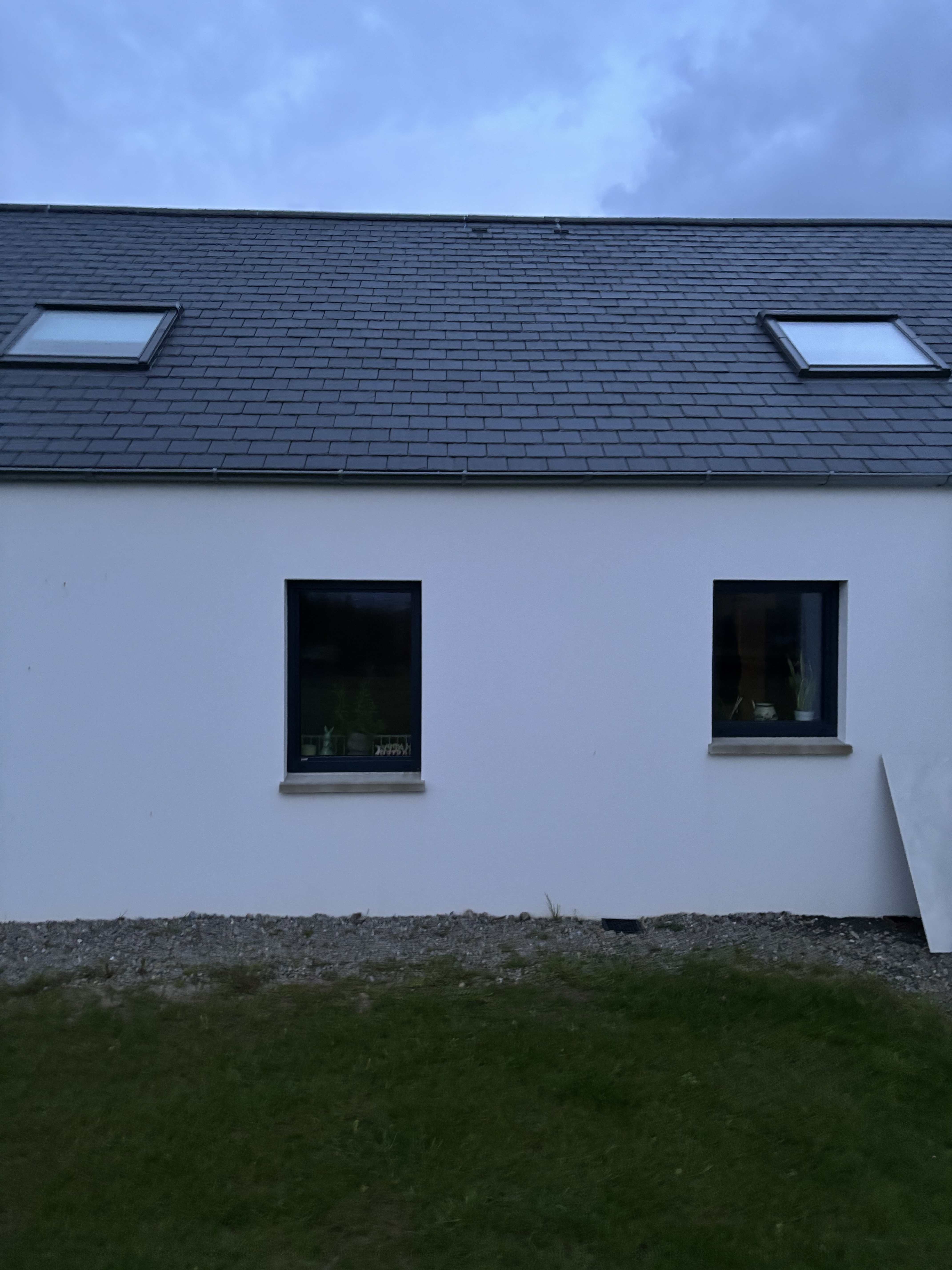

dpmiller Posted yesterday at 04:45 Posted yesterday at 04:45 post a photo of the top of the soil stack at the roof
Richie Posted 16 hours ago Author Posted 16 hours ago Hi Dpmiller, see attached pic of top soil stack, the vents are flush with roof tiles if you can zoom in. The builder says he always fits them this way and has no issue. However he has mentioned he might change them to 2 pipes extended so they are beyond the roof in case the wind is pushing the gas back down.
saveasteading Posted 14 hours ago Posted 14 hours ago A small extension would allow wind to whip over the surface and suck out air, purging the pipes. What about a chimney spinner or "granny" ? Modern ones spin on ball-bearing silently. But I'd think of a way to vent before the house, at that cover. Bigger holes or a pipe. But. Air test first. Remember the builder is keen for it to pass. There are ways to fiddle it.

ProDave Posted 14 hours ago Posted 14 hours ago Those roof vents connect with a flexible connection so that is a potential place for a leak. Is there any loft space at all and if so any access? If so does the loft smell?
