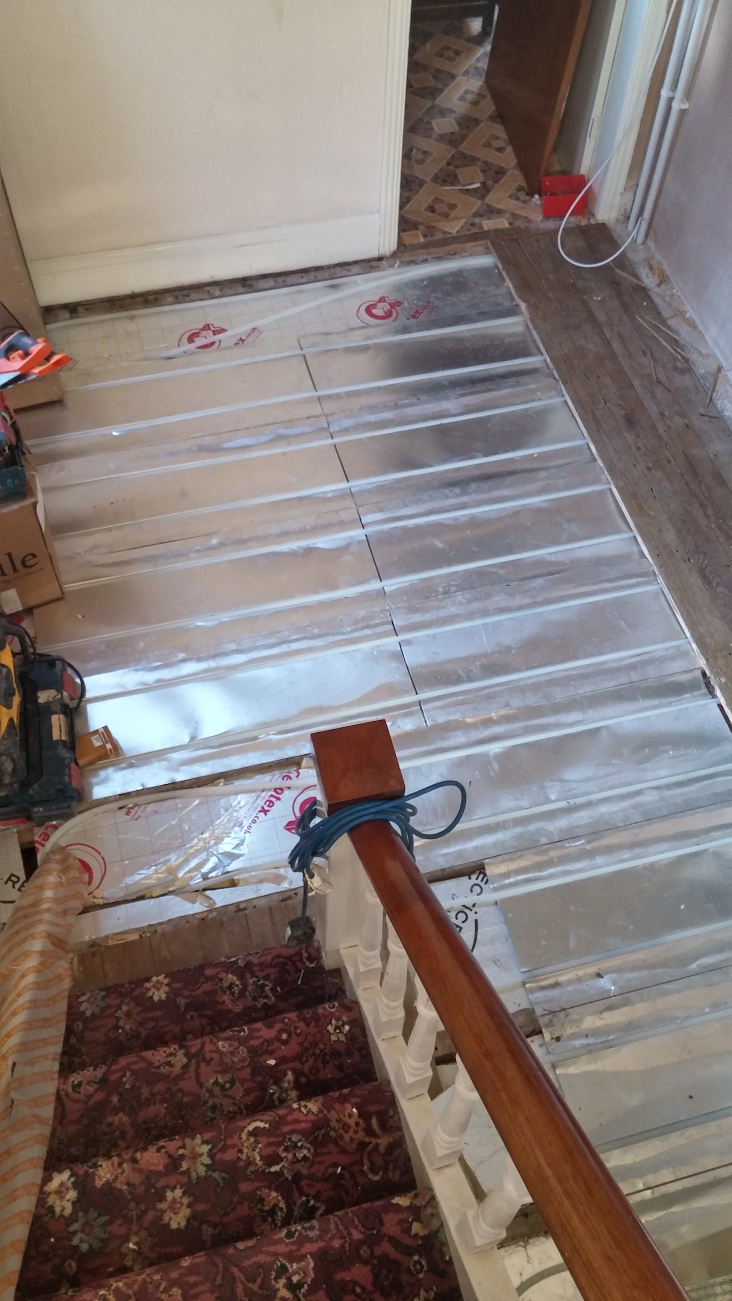

Iain k Posted May 26, 2025 Posted May 26, 2025 Hi, I'm hoping someone can help with our issue. We had a heat pump installed which runs upstairs radiators and downstairs underfloor heating (suspended joists). The radiators work great, and the ufh works - but we can't feel it through the floorboards. We have the thinnest laminate flooring I could find but that hasn't helped. Can anyone suggest something to replace the floorboards with that would allow the heat through ( need to keep the floor level the same). The floorboards are the original ones that were put back down over the ufh and are 15mm thick. Thanks 🤞

Iain k Posted May 26, 2025 Author Posted May 26, 2025 Thanks for responding so far. This was a system that replaced an old gas boiler and rads. Trouble is, the company that did the installation went bust a couple of months after, so we've had no support. The install was insulation between joists then spreader plates above that. The radiators upstairs work great, but the ufh doesn't heat the room - we've left it on for 72hrs + and it made little difference. If you lift a floorboard you can feel the heat - but it isn't enough to heat the rooms. So is there a material that I can put down instead of the boards that may work?

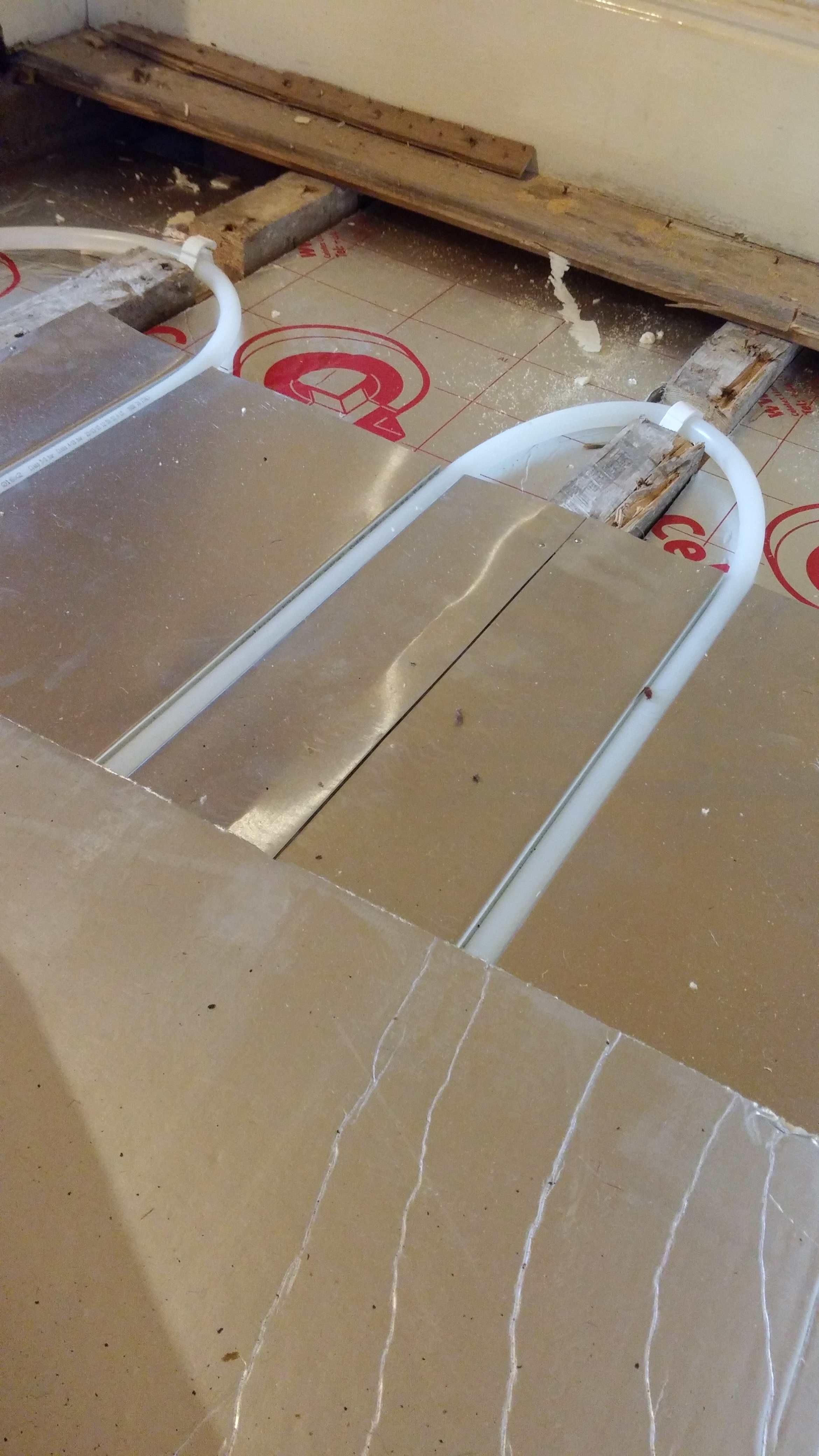

JohnMo Posted May 27, 2025 Posted May 27, 2025 Couple things with the UFH Was there an air gap between the aluminium plates and floorboards? Any gaps acts as insulation so reduced effectiveness. Do you have a drawing of how the UFH was actually done as in the layers from bottom to the finished floor?

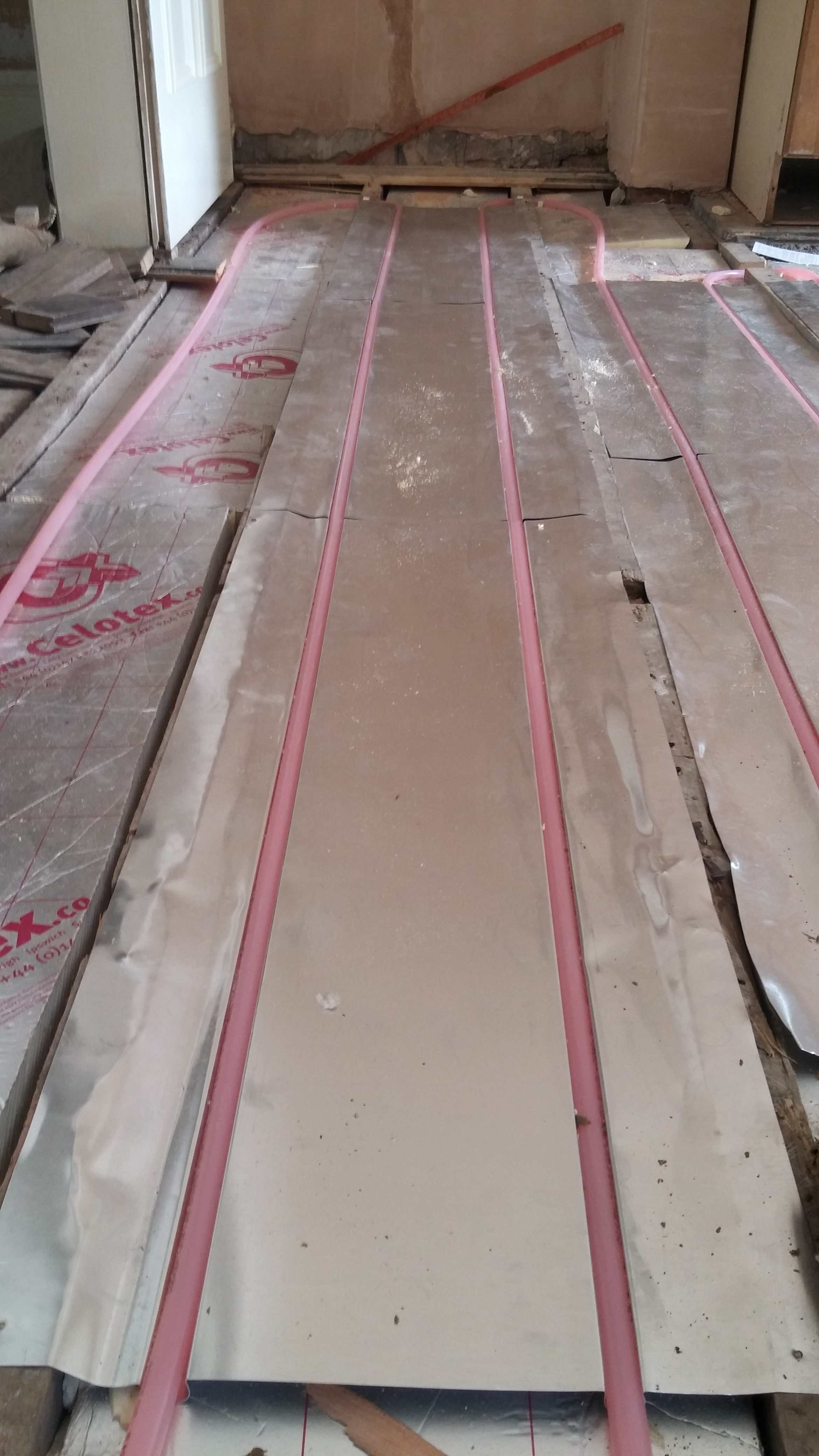

ProDave Posted May 27, 2025 Posted May 27, 2025 That looks to be 200mm spaced pipes. Fine in a well insulated house like ours, we have 200mm pipe spacing and it works fine, but for a retrofit on an older house I would have expected closer. There is an air gap between the insulation and the spreader plates. If the detail at the ends of the run is not good, that void could just be full of cold air from under the insulation. My first thought is lift a floorboard at each end and see if that space is cold, feel for draughts etc. 1
JohnMo Posted May 27, 2025 Posted May 27, 2025 There also looks to be gaps between aluminium plates and the floor boards. This and the things mentioned by @ProDave can all make for poor performance. Requiring high flow temperature to compensate. 1

Spinny Posted May 27, 2025 Posted May 27, 2025 Fit seems quite variable, places where it looks OK ish other places where it really doesn't. Some spreader plates bent out of shape, some insulation not well fitted with gaps, and large void under the spreader plates (what proDave says). You may be heating the flow of cold air through the subfloor void more than the floor above. If you google between joist underfloor heating images then there are several such systems which have insulation bonded directly to the spreader plates or shaped to fit them exactly which would help to avoid a cold void under the plate sucking out heat. Unfortunately I think it is a job that requires patience and precision to properly separate the cold sub floor air from the warm above floor air. I think I was lucky to have a carpenter fitting my u/floor insulation. There are also multiple systems on the market, some better designed than others. All too often builders go for what is cheap and immediately available and incentives their interests rather than what is best, especially if the spec is just generic 'between joist'.
Andeh Posted May 28, 2025 Posted May 28, 2025 As said above, I would guess that cold air is blowing down the gaps/tunnels moving the warmth out. Trying to go around the edge of the room and use expanding foam to deal the end of each of those tunnels would be a good first step to try I think!
scottishjohn Posted May 28, 2025 Posted May 28, 2025 2 hours ago, Andehh said: As said above, I would guess that cold air is blowing down the gaps/tunnels moving the warmth out. Trying to go around the edge of the room and use expanding foam to deal the end of each of those tunnels would be a good first step to try I think! I concur habing done a similar job on old house you will be loosing the heat to drafts andlack of hard contact to the floor. the insulation needs to HARD up to thespreader plates and pushing thepiping hard onto the floor so no quick fix for this rip up floor and do it right then you need to balance the flow of the rrads ,cos water will go easiest way --so turning the flow down on them might help as well thr UFH will never heat up to same as rads and really rads if are original ones from gas boiler will not be big enough --cos of the reduced flow temp from ASHP--genrally they need to twice as big ,cos tmep from UFH will be around 30 and temp fromgas boiler to rads would be 50+ so they need to be much larger surface area to give same heat pout put Iwould not worry too much onthat at this time you need tosort out the downstairs FH problems first and then later you can maybe chane upstairs
