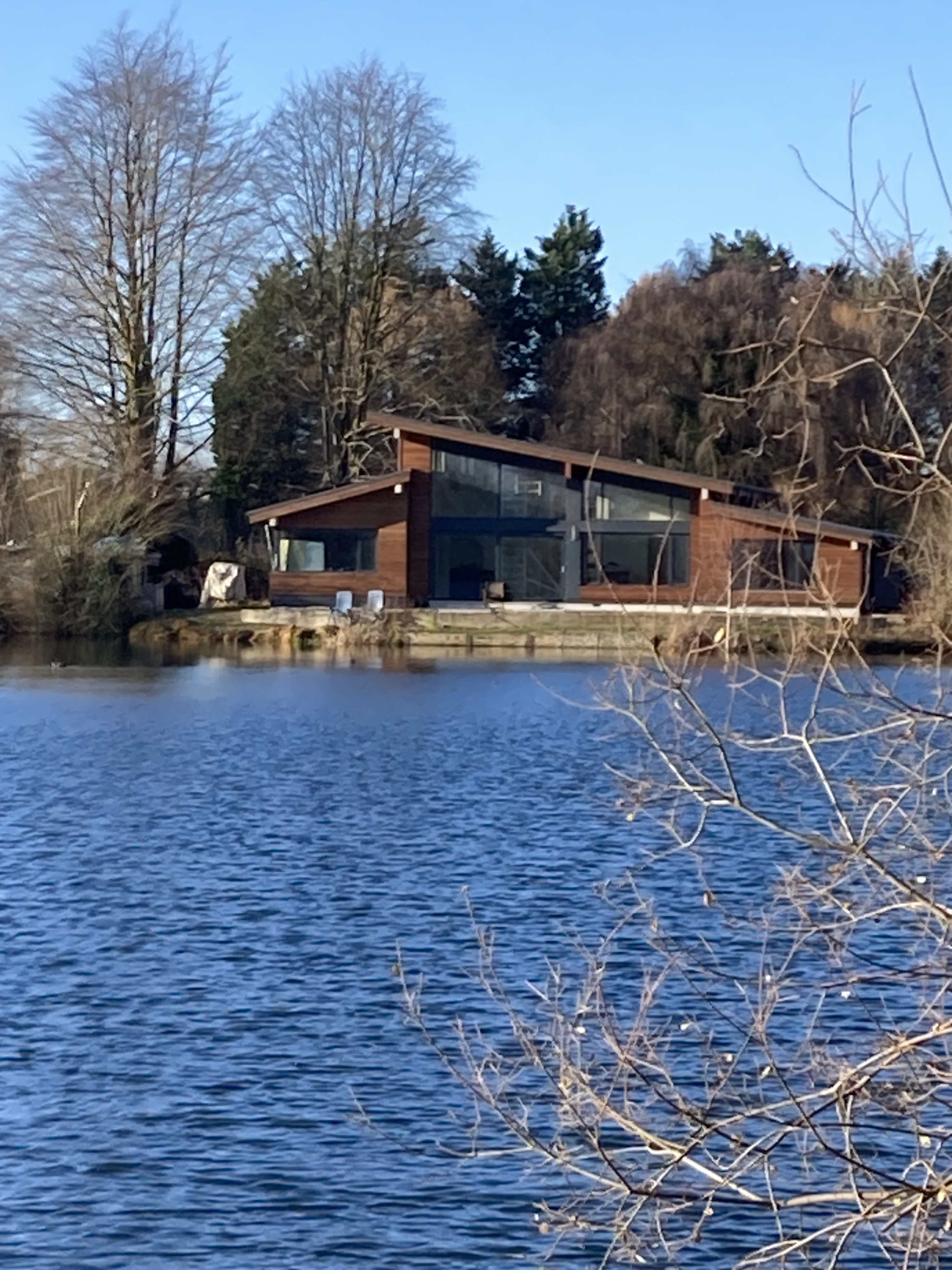

May 18, 20251 yr 4 minutes ago, Markuz said: ... Are there any restrictions in terms of size when you use icf? Or can you go crazy ? ... Restrictions ? Yes Crazy? Within reason - almost The most difficult windows for us were those that are about 300mm wide : the issue was manufacture of the windows, not how to insert them in ICF. (In our case Durisol).
May 18, 20251 yr Author 4 minutes ago, ToughButterCup said: Restrictions ? Yes Crazy? Within reason - almost The most difficult windows for us were those that are about 300mm wide : the issue was manufacture of the windows, not how to insert them in ICF. (In our case Durisol). Thanks very much. is that a sliding door you have there? Looks great.
