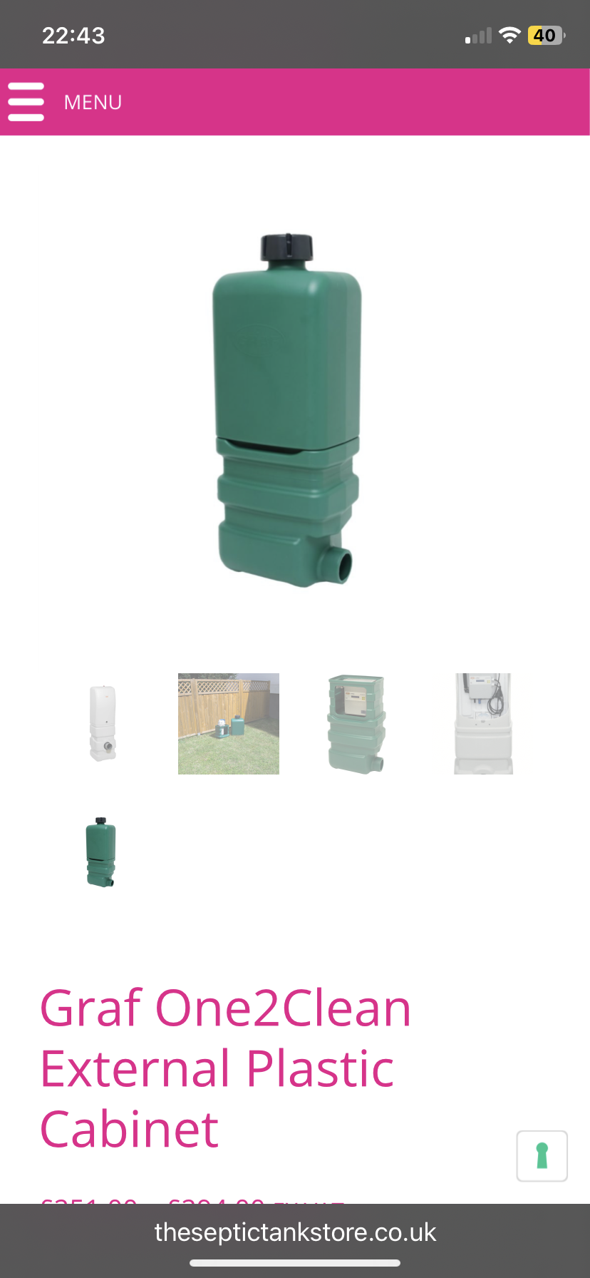

DownSouth Posted May 11, 2025 Posted May 11, 2025 This thing has been put in just 2m from the sewage treatment plant. It’s at the back of the garden ;about 10m from the patio) but is bright green and very visible. How have other people hidden theirs?

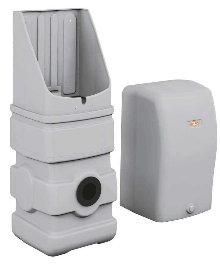

Thorfun Posted May 12, 2025 Posted May 12, 2025 Mine looks like this so isn’t so bad to look at! maybe they’ve changed the design of the external cabinet recently
crooksey Posted May 12, 2025 Posted May 12, 2025 Thorfun, your cabinet is an additional cost (that most go for). Cabinet placement is something that can make or break an installation. They can be moved (within reason) limited by distance from the tank etc. 2
Redbeard Posted May 12, 2025 Posted May 12, 2025 10 hours ago, DownSouth said: How have other people hidden theirs? Sorry, I have not got one, but whimsy suggests this or something else which floats your amusement boat... 1
Dunc Posted May 12, 2025 Posted May 12, 2025 My pump and control unit is buried near the tank. Not sure what the groundworker used, possilby a valve box or a ducting access box with a suitable pedestrian rated cover. Gravel in the bottom for drainage. I checked with Graff in case this buried option doesn't work out (I'm worried about moisture/flooding!). You can locate the pump up to 18m away from the tank and the unit should have been supplied with 20m of hose.
saveasteading Posted May 12, 2025 Posted May 12, 2025 It's for a wet purpose, I'd expect connections to be waterproof. I have only used Marsh, 3 times, and it goes in the tank and no box. Otherwise, as @Dunc suggests. A drain chamber former without the bottom would be easy.
DownSouth Posted May 12, 2025 Author Posted May 12, 2025 It’s already in, so moving it isn’t an option. Dalek here we come…. 1
