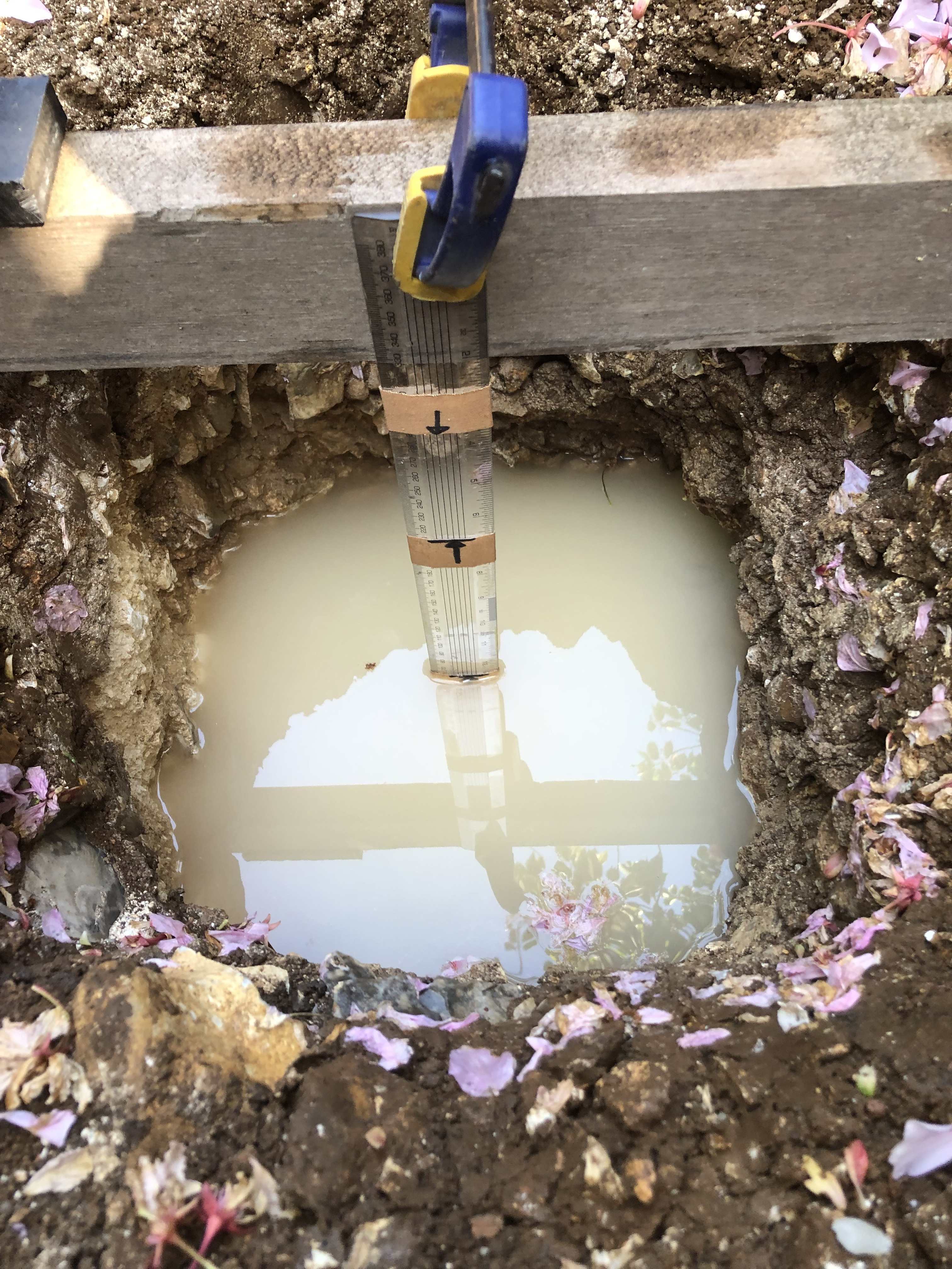

flanagaj Posted May 3, 2025 Posted May 3, 2025 Admittedly it has been very dry, but I dug to holes 1m down and then a 300 * 300mm square. One of the pits was into chalk bedrock and the other was soil and very heavy flint. I saturated both holes last night and then returned this afternoon to carry out a first test as 3pm and then another at 6pm. The results are below Chalk hole : Reading 1 (342 sec) Vp = 2,3 Reading 2 (462 sec) Vp = 3.08 Flint / Soil Reading 1 (780 sec) Vp = 5.2 Reading 2 (1140 sec) Vp = 7.6 So these readings are bad news, but I am struggling to understand how neighbours on both sides have treatment plants and leech fields. Anyone have any advice here. I obviously need to raise the height of the field so that the invert is not near the chalk bedrock. It states that it cannot be < 15 for it to be suitable.

flanagaj Posted May 3, 2025 Author Posted May 3, 2025 Here is the method I used. Was all done correctly. 1

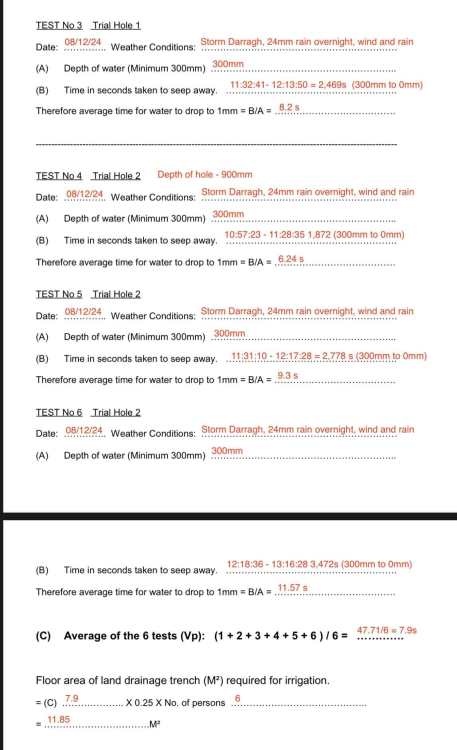

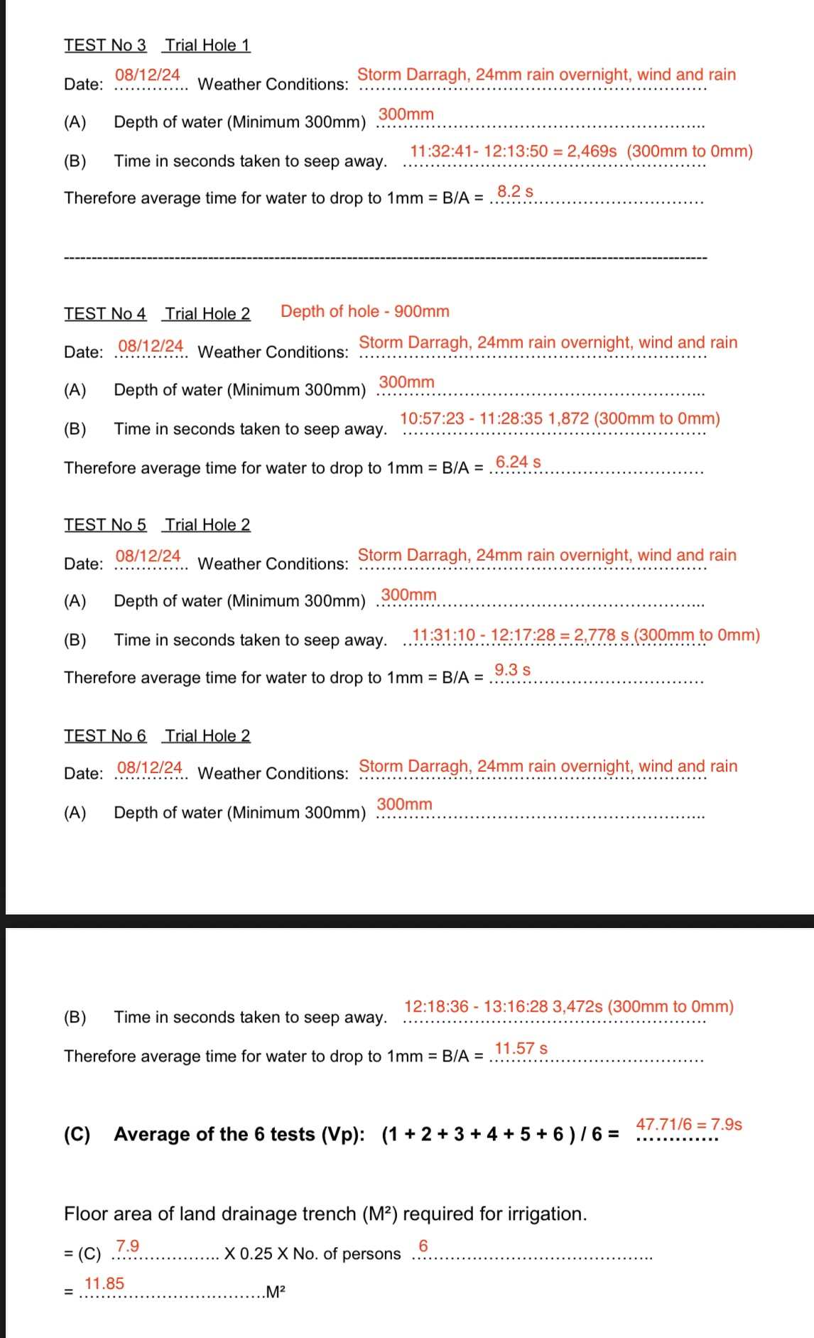

JohnMo Posted May 4, 2025 Posted May 4, 2025 5 minutes ago, flanagaj said: My question simply to do with a fast percolation reading. The rules are written around a base case assumption of a septic tank - a treatment plant provides primary and secondary treatment (so built in bulk separation, and treatment of waste water prior to leaving the plant). A treatment plant isn't a septic tank (page 30), if you fail a perc test you are not allowed to install a septic tank tank (base case) you have to install a treatment plant which is the primary and secondary treatment system. So if installing a treatment plant, it really doesn't matter if you fail a perc test, but planning I assume would want to see test results, so you need to test correctly? You are already doing the prescribed next step of installation of secondary treatment i.e. a treatment plant for a failed test. 1

torre Posted May 4, 2025 Posted May 4, 2025 15 hours ago, flanagaj said: saturated both holes last night How many times did you fill and refill the holes when saturating? Rule out the chalk hole, then the big slowdown between tests for the second hole suggests that ground may not have been saturated enough to give a reliable reading. I'd fill and drain that a couple more times and then repeat the tests over a day or two
flanagaj Posted May 4, 2025 Author Posted May 4, 2025 5 hours ago, torre said: How many times did you fill and refill the holes when saturating? Rule out the chalk hole, then the big slowdown between tests for the second hole suggests that ground may not have been saturated enough to give a reliable reading. I'd fill and drain that a couple more times and then repeat the tests over a day or two Ruling out the chalk hole as that was still draining far too quickly even today after 5 fills, the soil / flint hole readings are as follows. These are as follows. 2nd May 1800hrs - Filled hole and let drain overnight 3rd May 2 tests 1530 hrs : 13 minutes 1800 hrs : 19 minutes 4th May 2 tests 1200 hrs : 23m 35s 1529 hrs : 30m 48s As you can see. The readings differ wildly and it's left me somewhat confused. I am going to go up tomorrow and do another 3 readings of the hole. The hole now appears to have a layer of silt at the bottom. This is going to skew the readings as by it's very nature a silted hole will not be as porous. Should the silt layer be removed before each test?
JohnMo Posted May 4, 2025 Posted May 4, 2025 Test is fill with water, leave overnight, do perc test one next day. Fill leave overnight, do perc test two next day. Fill leave overnight, do perc test three next day. It takes three days. Random filling here there everywhere is rubbish. You aren't doing the test correctly. Crap in, crap out, using an intended pun. 1

BadgerBodger Posted May 4, 2025 Posted May 4, 2025 (edited) Three consecutive days? I know the first “fill” should be on day one and the other tests follow but I actually thought you were meant to test consecutively on the same day so you get a cumulative impact (making the test take longer each time) which results in a larger drainage field. This is more important with poor draining land but not to be ignored. Either way. I did my own test as above, and got pretty low values (as in fast draining) but they were accepted (using PSTP). Admittedly I didn’t follow the guidance entirely as it was the middle of storm darragh… but I think it helped my cause. I also did three trial holes and tests picking the worst two for my final result. I used this website for guidance… https://www.copeland.gov.uk/sites/default/files/attachments/percolation_surface.pdf Edited May 4, 2025 by BadgerBodger Clarity
JohnMo Posted May 4, 2025 Posted May 4, 2025 30 minutes ago, BadgerBodger said: used this website for guidance… https://www.copeland.gov.uk/sites/default/files/attachments/percolation_surface.pdf That's for a rain water soakaway site? So back to document I linked and you say have read, you don't record the time for 300mm of water to disappear for example like you have. You are not reading the building regs documents, it's all laid out and easy to follow. Will bow out now
BadgerBodger Posted May 4, 2025 Posted May 4, 2025 Apologies, you’re right. That one is for the surface water. I did not need that test in the end as we are using an existing pond which has been used for the same purpose for the last 30 years. I used a generic test from one of the tank suppliers. https://www.jdpipes.co.uk/knowledge/sewage-treatment/how-to-perform-a-percolation-test.html#:~:text=The procedure measures how long,will come from the drainage And you are right. I did it wrong. I should have measured the time from 225mm down to 75mm but with the weather and me being in a general rush to get done (doing 3 tests at once) I forgot that and explained it to the BCO at the time. People make mistakes. In reality, my point was faster speeds can be accepted and that you don’t have to do it on three consecutive days. Which so far as I can still tell, you don’t.
