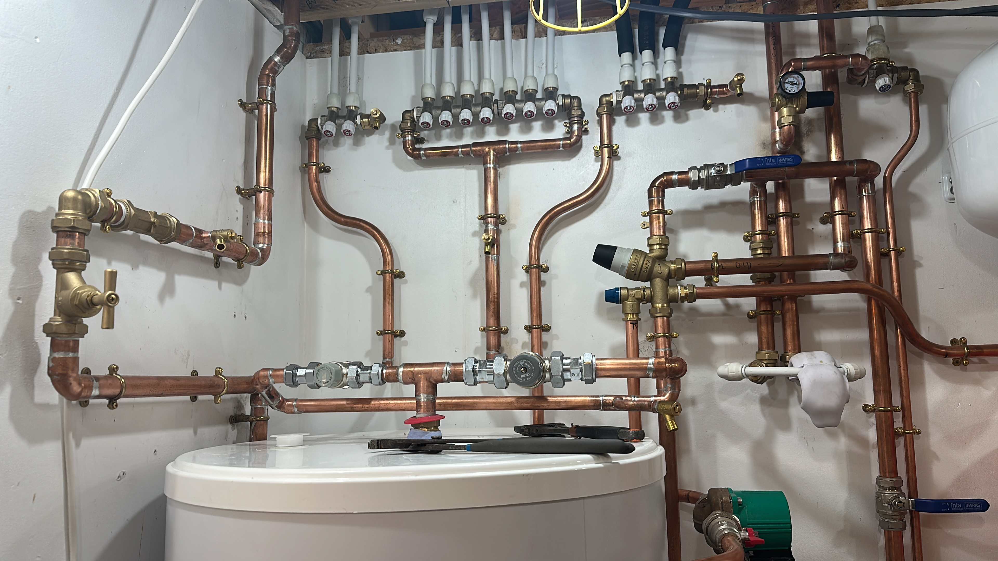

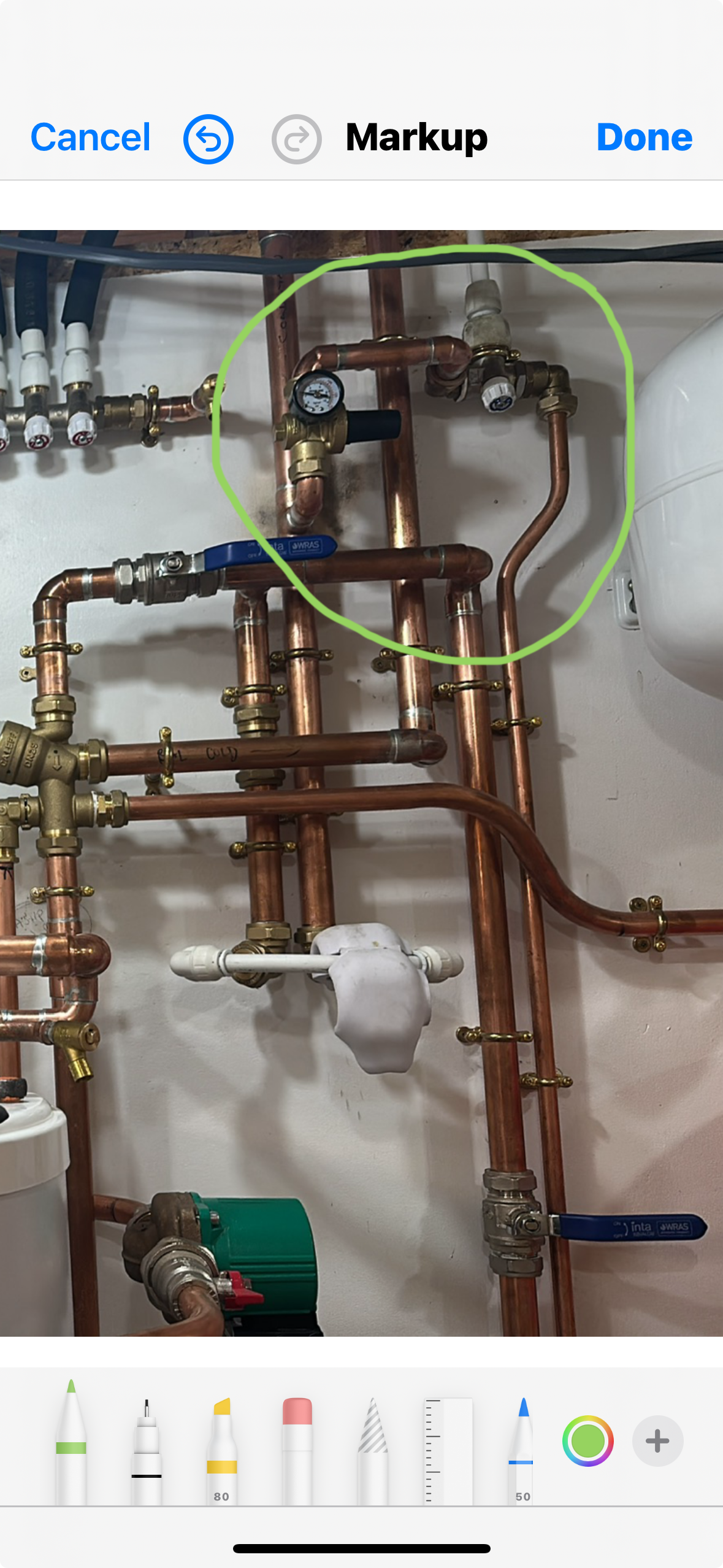

JohnMo Posted April 23, 2025 Posted April 23, 2025 Our system is slightly different as we added the UVC after. But in effect it works as you describe. Our original was a combi boiler. We have a pressure regulator valve as the mains water comes into house. So cold water manifold after that. Early build photo attached. Showing stop cock with no mains connection. Pipes going into floor are cold, pipes going up are hot. Top left pipe is feed from combi (now UVC) the white pipe going up is the cold feed to combi boiler (now UVC). But you would just feed everything from from the balanced feed. 1

JohnMo Posted April 24, 2025 Posted April 24, 2025 23 minutes ago, Oz07 said: didn't realise the manifold setup had to be so complicated It doesn't - look at my image, that's hot, cold distribution and all UFH

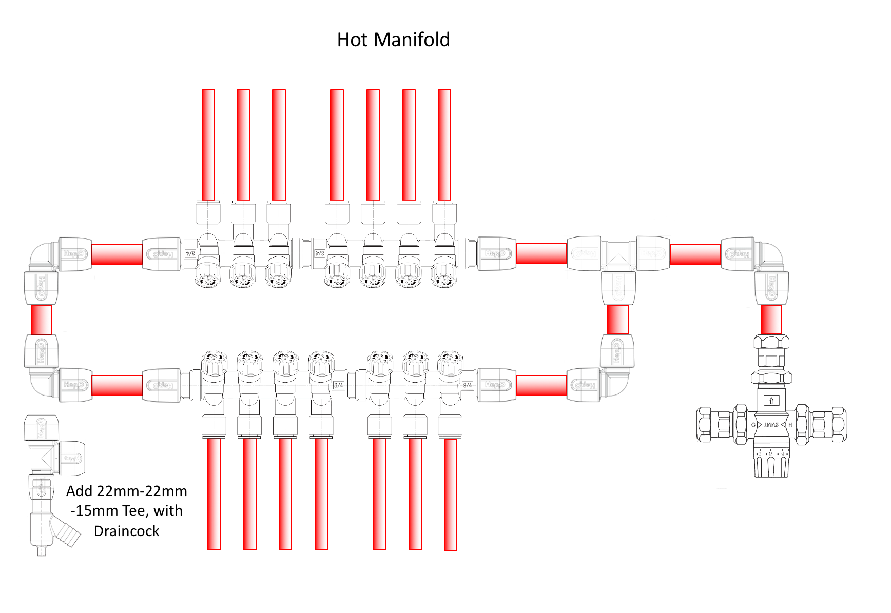

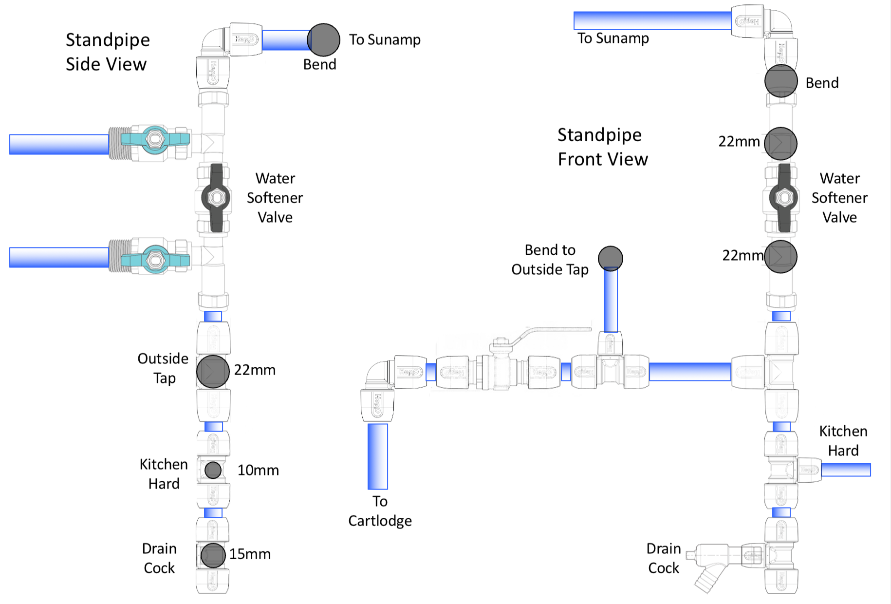

Nick Laslett Posted April 26, 2025 Posted April 26, 2025 (edited) On 25/04/2025 at 10:25, G and J said: Yet more evidence that I think incredibly slowly: Was laying awake last night thinking about plumbing, like one does. @G and J, I was the same. I found it very hard to get my head around the Hep20 plumbing and SVP. What worked for me was actually drawing a piping diagram in PowerPoint using jpegs of the Hep20 components. Here is the drawing showing from the incoming rising main, water softener, kitchen tap, outside tap to the Inlet Control Group valve before the Sunamp. (Note: the outside tap is plumbed slightly differently, because there is a non-return valve not shown.) Here is the drawing I did for the hot manifold. I have some hot pipes in the slab, like kitchen tap. The others are in the ceiling, which is why I have manifolds pointing up and down. Edited April 26, 2025 by Nick Laslett
