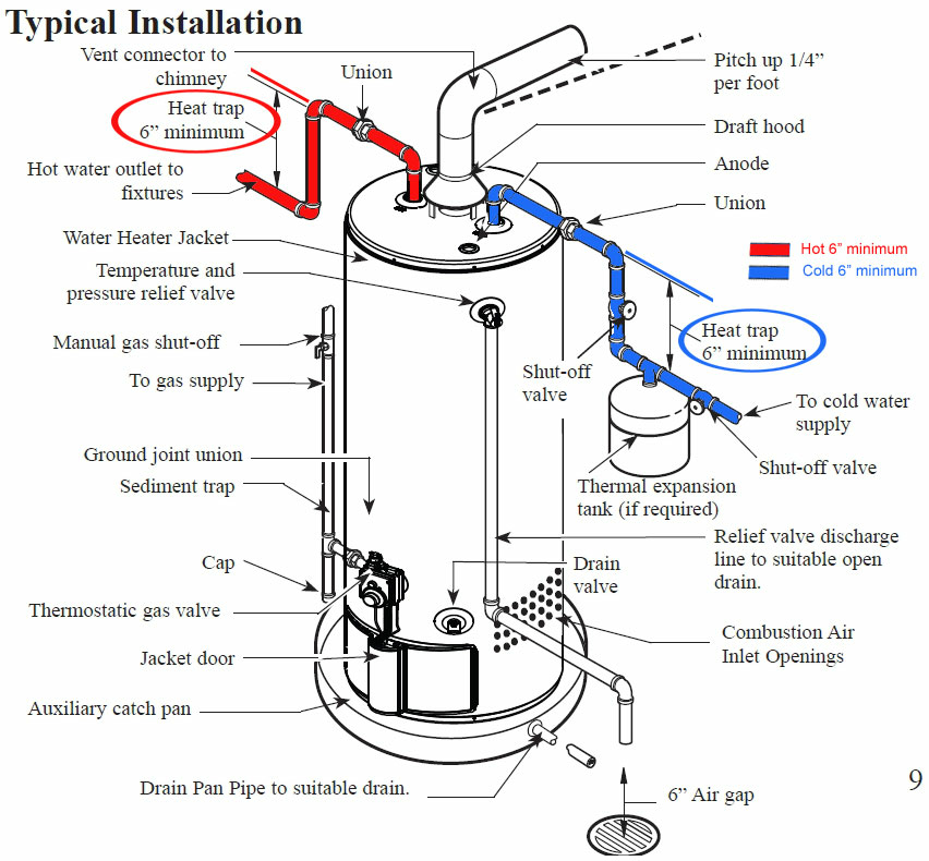

54 minutes ago, G and J said:
hot manifolds placed (as per current thinking) above the UVC in the utility room
Serious note, the manifold directly above the UVC may lead to a thermosyphon wicking away the hot water. You need to make a heat trap first. Once you have the heat trap you can do what you wish with the piping and have manifold above the UVC without risk of the thermosyphon occurring.
In my naivety when I plumbed here in ‘91 I put a nice fat pipe straight from the top of the hot water cylinder (that’s what we called ‘em in the old days) going up into the loft to be the vent pipe bent over the tank.  Perfect heat dissipation device.  Sigh.
How many litres of heating oil has that cost in the last 34 years I wonder.
I’m thinking an insulated copper pipe up from the UVC outlet, then three bends, then me manifolds starting with the 10mm ones for the sinks/basins.  I’ll draw it out beautifully, then the execution will look like spaghetti. But with the cupboard door shut it will look fine.
Not that I ever throw any spanner’s into any works……
18 hours ago, G and J said:
So I don’t have to allow room between UVC and anti thermal loopy thing and manifolds then.  Good news. Thank you.
……actually I’d think this through before making a bad choice ;).
In that pic you’ll see I’ve provoked (intentionally) this exact thing to happen, as with the last setup I did, and it’s how I will plumb the next, and the next.
Short lived will be your cunning and planned celebrations of the joys of foreseeing this ‘terrible loss of heat’, and the use of 10mm pipe to get your DHW swifter than a swift flying during a hurricane, as it’ll go tits up the second you do your anti-gravity / convention loop.
All the wasted (and useless) water volume held in that plus the fact it’ll either be 28 or 22mm pipe, will instantly negate all this as you’ll prob have longer to wait than if you’d run the feeds in 15mm.
By the time you get the dead leg out of the primary larger bore pipework and then premium (useful temp) DHW out of the average outlet you’ll be sadder than Mr.Bean when he lost his teddy bear as you will then realise it was the wrong choice to set it up this way.
The ACTUAL annual costs (perceived savings of stopping heat wicking up the pipework) would need to include the wasted cold mains water that you then draw off as useless dead leg, then you’re very much into the price of a decent meal for 2, in ACTUAL reality.
Then factor in that this primary DHW pipework will be well insulated plus the sobering reality that this aforementioned ‘runaway convection’ just won’t happen, (as you refer to with the open pipe / vent of yesteryear (which is entirely misleading and utterly irrelevant here btw!)), and then you place a cherry on top.
The cherry is, that with the large bore primary pipework already preheated by (local) heat wicking up it from the UVC, this then cancels out the delays caused by lengthening the pipework between the UVC and the hot manifold; viola!
The result you want from this is for the pipework from the UVC to the hot manifold, AND the hot manifold itself to be warm / hot as the default; insulated to stop latent losses as best as is practicable.
THEN, my dear Watson, your plan of using the 10mm feeds will be one of genius, but more importantly will then actually bear some fruit.
Convection (runaway) can’t happened here as there needs to be an unobstructed path from hot > cold to create a convection loop, as your taps / outlets will be closed, the case for this is closed.
Use this ‘problem’ to your advantage squire ;).
Anti convection loop would have to go between the UVC and the manifold.
But it doesn’t matter because you’re not going to install one……..😉🤝

Being serious I take your point @Nickfromwales re cold water volume in a heat trap.  We’ve just been discussing it and as J has pointed out, the UVC is in a drying cupboard, so the heat isn’t wasted.
All those litres of oil weren’t entirely wasted, we always had a nice warm airing cupboard - and being 60s kids that felt right.
