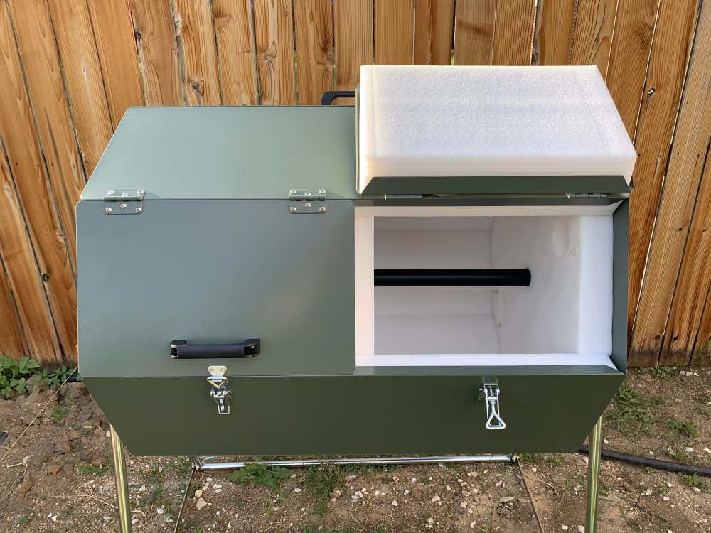

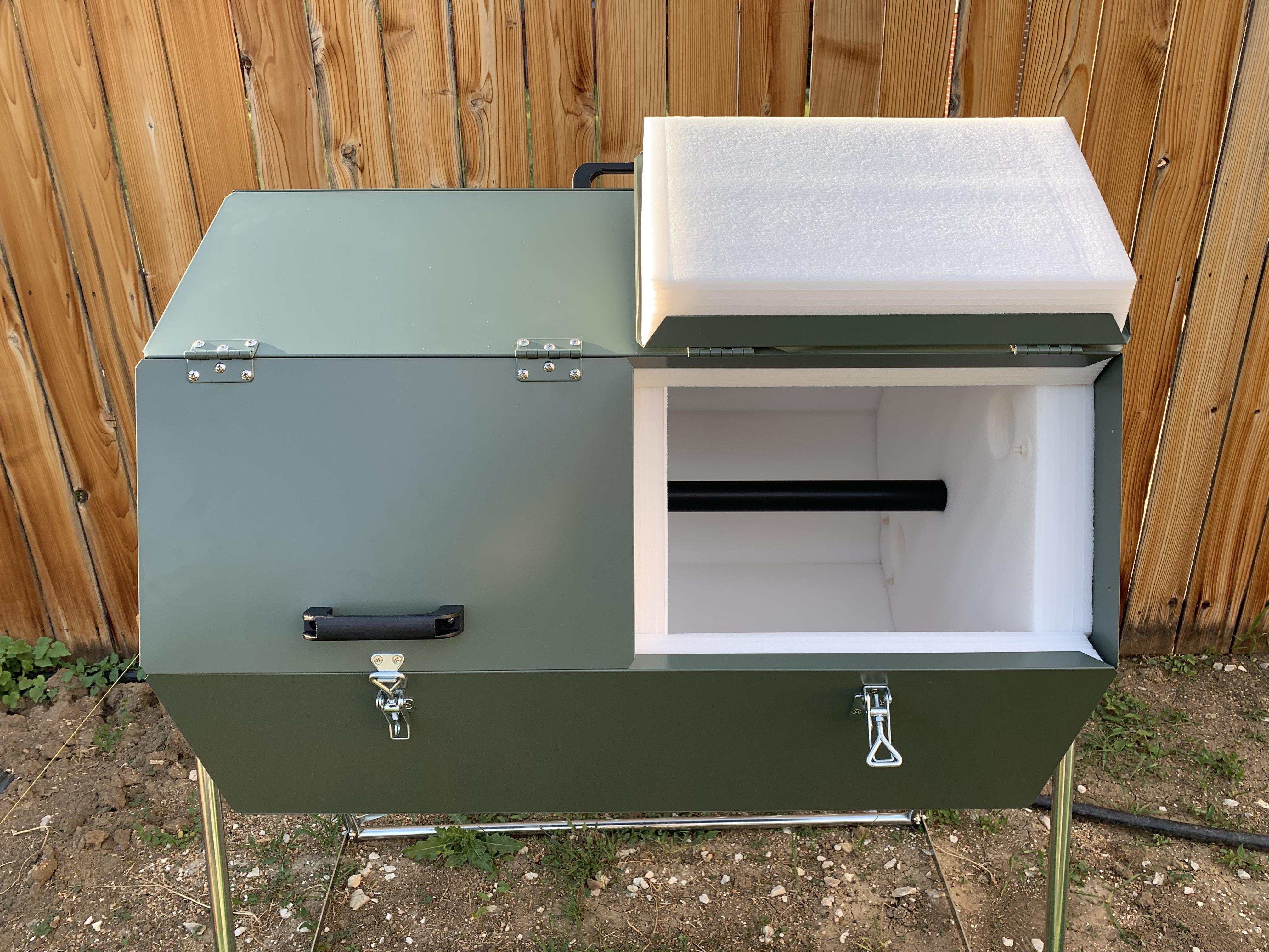

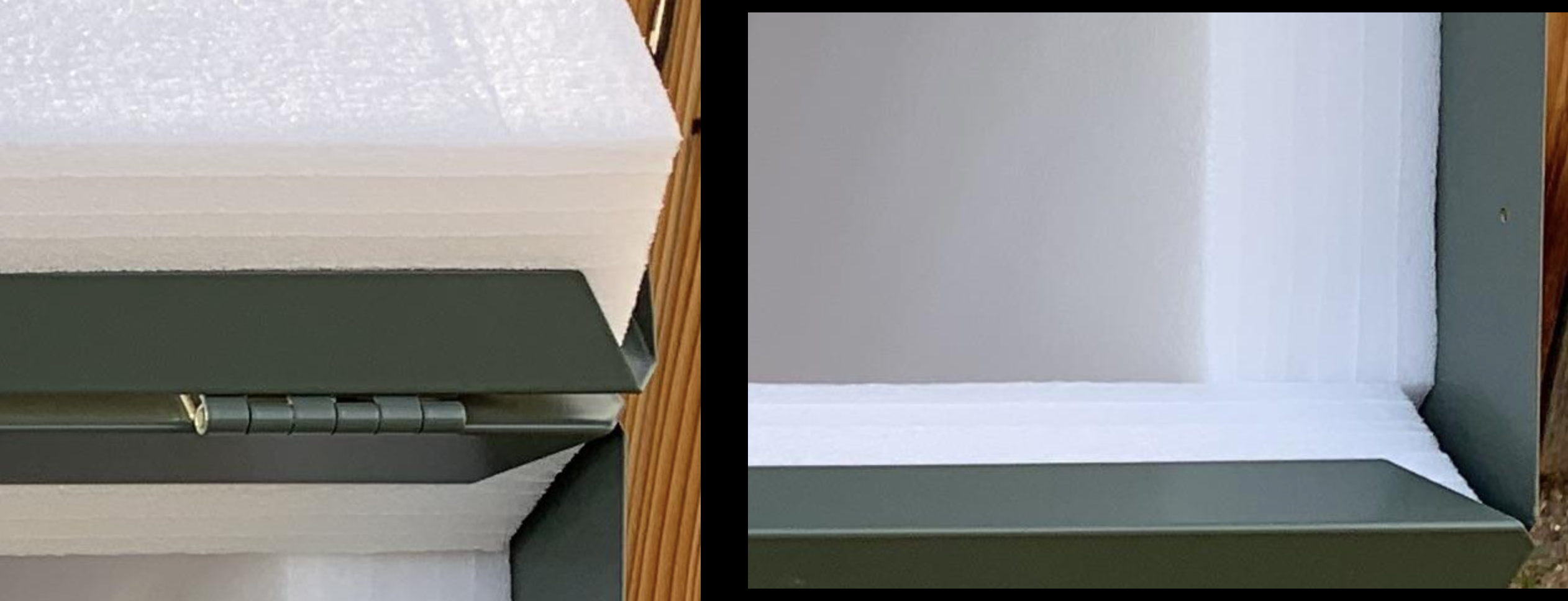

Sparrowhawk Posted April 20, 2025 Posted April 20, 2025 I can't justify paying the silly money for one of these composters, but I'd like to work out which insulation material they're using and how much insulation it's providing. I don't think it's PIR or EPS. Thes are the best photos I found online: From a close-up it looks layered, like packing material. Maybe polyethylene insulation?
Iceverge Posted April 20, 2025 Posted April 20, 2025 (edited) It's polyethylene foam I think alright. https://www.macropackaging.co.uk/product/closed-cell-polyethylene-foam-polylam-plank-sheets-1200mm-x-2000mm-x-50mm/ Edited April 20, 2025 by Iceverge 1
SteamyTea Posted April 20, 2025 Posted April 20, 2025 Looks a bit like EPS. EPS has a k-value to 0.036. PIA-brochure-Fundamentals-Symbols-and-Terminology-of-EPS-Thermal-Insulation.pdf
JohnMo Posted April 20, 2025 Posted April 20, 2025 8 minutes ago, SteamyTea said: Looks a bit like EPS Would doubt it's EPS, been working with it for a few weeks, and it would soon fall apart in a a rotating composter. Looks more like @Iceverge says.
Sparrowhawk Posted April 20, 2025 Author Posted April 20, 2025 17 minutes ago, Iceverge said: It's polyethylene foam I think alright. https://www.macropackaging.co.uk/product/closed-cell-polyethylene-foam-polylam-plank-sheets-1200mm-x-2000mm-x-50mm/ Bloody hell that's more expensive than PIR!
JohnMo Posted April 20, 2025 Posted April 20, 2025 Just now, Sparrowhawk said: Bloody hell that's more expensive than PIR! You could used XPS - Extruded polystyrene. It's pretty tough. But why do you need insulation? If you do make it inside out, hard stuff inside, EPS outside.
SteamyTea Posted April 20, 2025 Posted April 20, 2025 8 minutes ago, JohnMo said: Would doubt it's EPS Think you are right, I zoomed in a bit more on the phone screen. It seems to have that waxy sheen to it. k-value of 0.032 then.
saveasteading Posted April 20, 2025 Posted April 20, 2025 It has to be polyurethane foam, and closed cell. What claims do they make? If you have plenty of garden space then you don't need this. I have a couple of the tardis ones. they take all year to fill, as the bottom rots down. then I empty them and put any unfinished composting back in the again. They take all the kitchen veg and soft garden cuttings and weeds etc.. Sticky stuff goes in a bigger bin and I shovel the good stuff out of the bottom and let the rest settle. I got about 8 barrows of amazing compost this year. It has only saved me £100 of commercial stuff but very satisfying / sustainable, and I think it is better. 1
JohnMo Posted April 21, 2025 Posted April 21, 2025 I think the insulation material is this https://www.thepackagingdepot.co.uk/s-1241/1200mm-x-2000mm-x-25mm-white-foam-sheets/?srsltid=AfmBOormE9cYSfOuxypkmQFxMf25Te6Zgn3pYwoIJnoQGgXQ6KlRuT00z-g

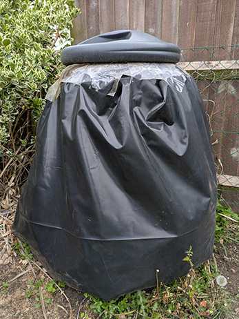

Sparrowhawk Posted April 21, 2025 Author Posted April 21, 2025 14 hours ago, JohnMo said: But why do you need insulation? Insulation allows hot composting, which makes compost in 90 days or so. A mow of our lawn mixed with brown stuff fills half a dalek, and I only have space for 1, so it was very handy when I had it working. 3 years ago I wrapped a Dalek composter in 50mm glass wool inside thick polythene sheet, and it worked brilliantly for the first year, keeping the contents at 45C+ for 2 weeks after every new addition. That winter the rats moved in and tunnelled within the glass fibre and made nests (should've wrapped it in chicken wire), the insulation slumped and got wet, and it stopped keeping things warm. Now in 2025 the bin is still slowly decomposing last year's clippings. 14 hours ago, JohnMo said: If you do make it inside out, hard stuff inside, EPS outside. Yes this would seem the sensible way, I assume they chose insulation on the inside to keep their product looking smart.

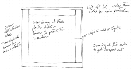

Sparrowhawk Posted April 21, 2025 Author Posted April 21, 2025 8 hours ago, saveasteading said: It has to be polyurethane foam, and closed cell. What claims do they make? They make no claims beyond it's robust and allows for hot composting. 8 hours ago, saveasteading said: Sticky stuff goes in a bigger bin and I shovel the good stuff out of the bottom and let the rest settle. What does sticky stuff mean here? Stuff in the compost bin that's gone into anerobic decomposition? 8 hours ago, saveasteading said: I got about 8 barrows of amazing compost this year. It has only saved me £100 of commercial stuff but very satisfying / sustainable, and I think it is better. Assuming that home compost is similar to the council-sold "soil improvers" made from green bin composting, which is £125 per cubic metre delivered (and I see plenty to say that it isn't - but those people also want you to buy their "bio" compost at £35 for 15 litres), the economics aren't there but as you say it is very satisfying to make. I find the height and shape of the dalek composers makes it hard to turn their contents every couple of weeks so I've got the idea of replacing them with an insulated cube, ideally held off the ground on blocks to make it harder for rats to attack (OSB or paving slab base?) Unless I can get offcuts of insulation to use it won't be cheap compared to my £25 insulation of the dalek, as this needs £75 of EPS, and that's before making a hard inner lining out of something, probably timber at the same cost again. Which is half-way to the cost of a ready-made hot composting bin. Wrapping a hard shell in insulation would be easier and potentially cheaper, but I haven't found many cube shaped plastic containers, and plastic barrels need flexible insulation like this polyethylene stuff plus I'm back to a shape that's poor for turning the contents to re-aereate it.
JohnMo Posted April 21, 2025 Posted April 21, 2025 14 minutes ago, Sparrowhawk said: this needs £75 of EPS The stuff I linked to wouldn't need the liner and is £25 a sheet.
