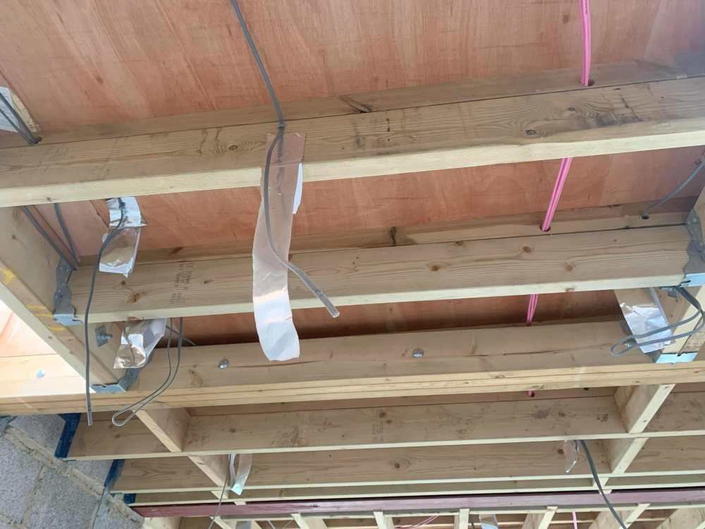

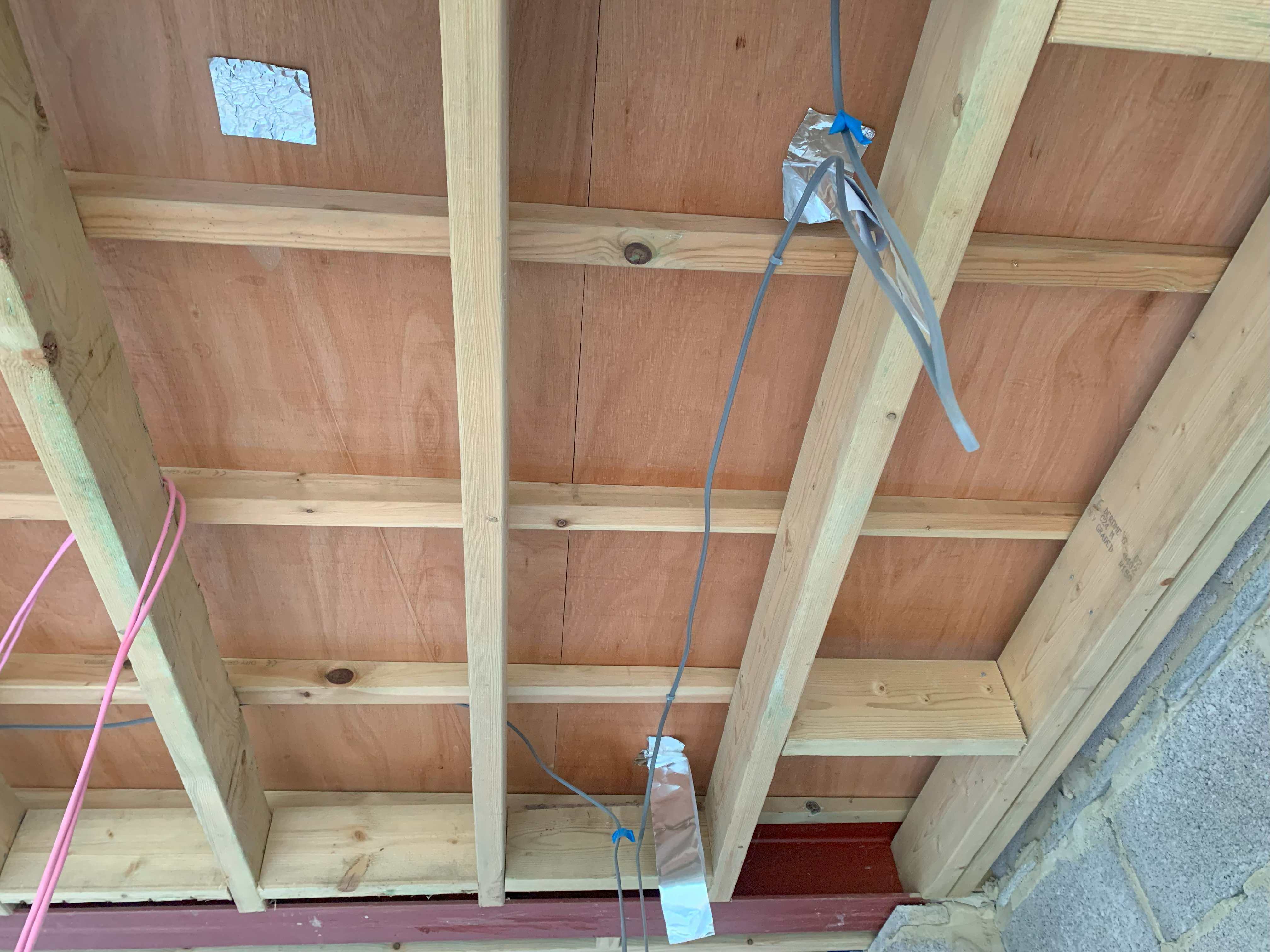

Spinny Posted April 18 Posted April 18 How much do you need to, or want to, raise the ceiling and therefore roof ? Perhaps it is feasible to build the new roof structure above the existing roof and then remove the original garage roof and ceiling structure from below ? Perhaps you could put a nice rooflight in the new roof ? Our warm roof has the ceiling joists - set level for a level ceiling - then firring strips on the joists to create the slight runs needed, then the plywood deck, then a vapour barrier/underlayer of bitumen type roof felt on the deck, then 150mm PIR, then a single ply PVC membrane adhered. Photos and piece of a drawing attached. As you can see internal gutters can be created in the insulation layer if you wish, and they don't necessarily need to run the same way as the roof slope i.e. they can be made to carry water around the roof to wherever you want a downpipe by sloping the bottom of the gutter that way.

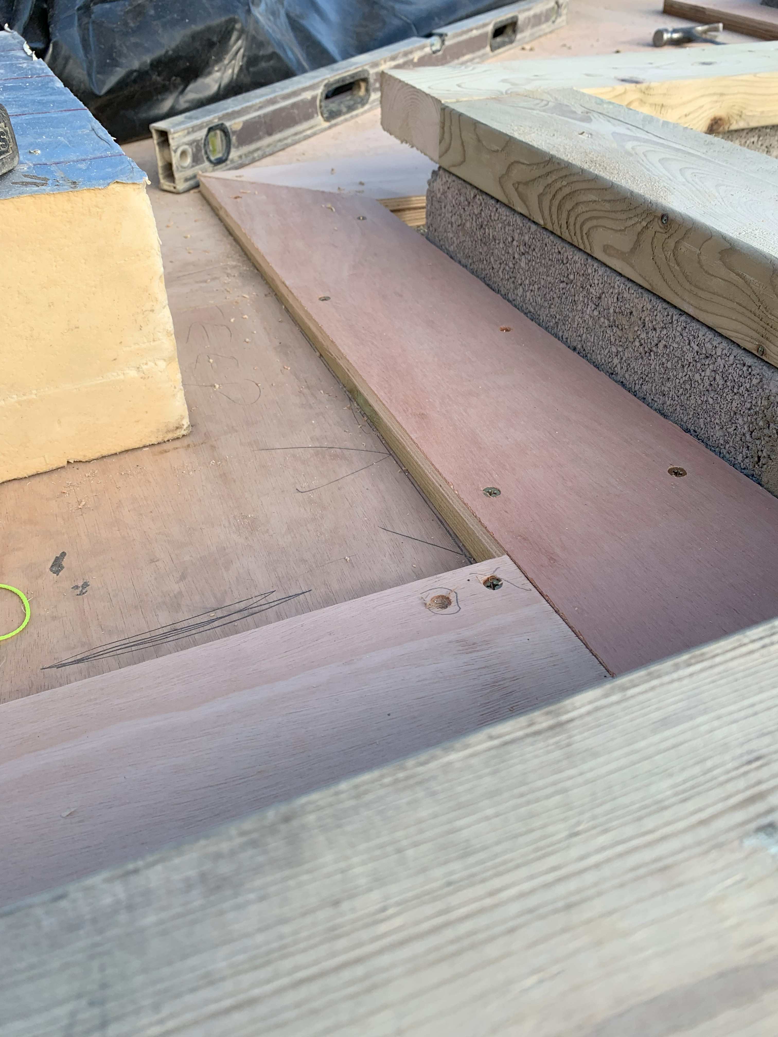

Spinny Posted April 18 Posted April 18 You can see the firring strips here. They can go parallel on top of joists, or transverse to joists depending on the slope(s) you want. The carpenter worked out the taper required and then got them precut (i.e. angled machine cuts down the length of timbers, so you get two firring strips out of one length of timber. (PS If you do add a rooflight, don't forget to work out how to get the back edge of it to drain properly - a bit of additional firring on top perhaps ? This was a glitch for us and we get some ponding behind the rooflight). Also make sure the roof is good enough to crawl/walk over when finished to facilitate cleaning. Also now I think of it there are also suppliers that can provide PIR boards cut to an angle so they fit together like a jigsaw to create the roof slope when laid onto a horizontal roof deck, here is one... https://ukflatroofing.com/tapered-insulation-boards?srsltid=AfmBOooDUJXxa7Ewu-xdJ5OhOos63D0eRS9mlahXWSUBBy1vSc5mBICy

Spinny Posted April 18 Posted April 18 I think you might want to strongly consider getting that lintel put in as part of putting the new roof on. You could actually have the joists for the new roof cut into the web of the steel to support them at that end - you can see how that is done in my ceiling joist photos above. Then you may achieve the steel being hidden in the ceiling structure - might depend which way the joists run in the ceiling in the main house.

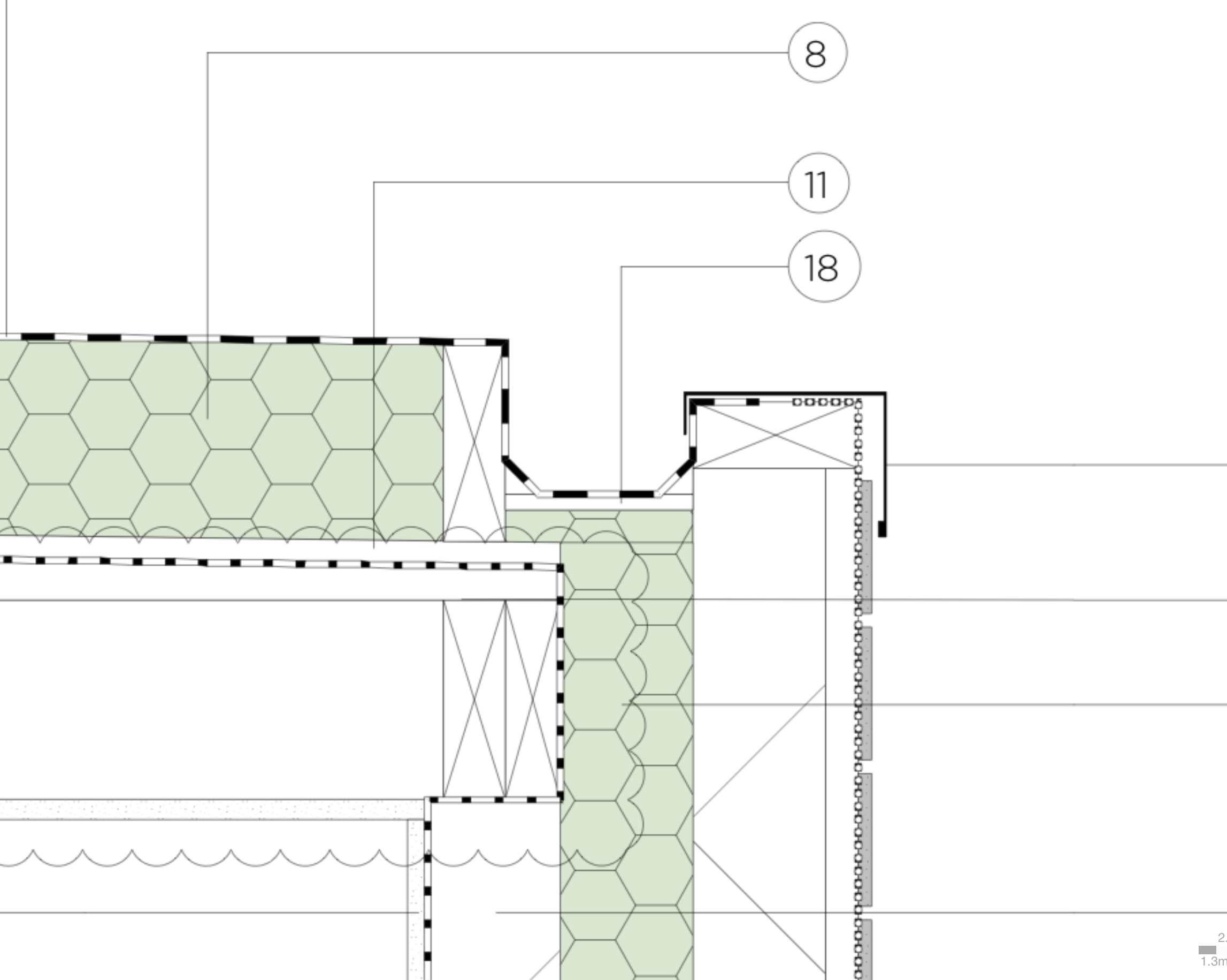

ETC Posted April 18 Posted April 18 I would always advocate full insulation below any gutter. Your detail shows a potential thermal bridge. 1
Spinny Posted April 22 Posted April 22 On 18/04/2025 at 20:18, ETC said: I would always advocate full insulation below any gutter. Your detail shows a potential thermal bridge. Expand @ETC Thanks. You have got me wondering, do you think I should be adding some insulation on the inside as sketched in red in the attached image ?
