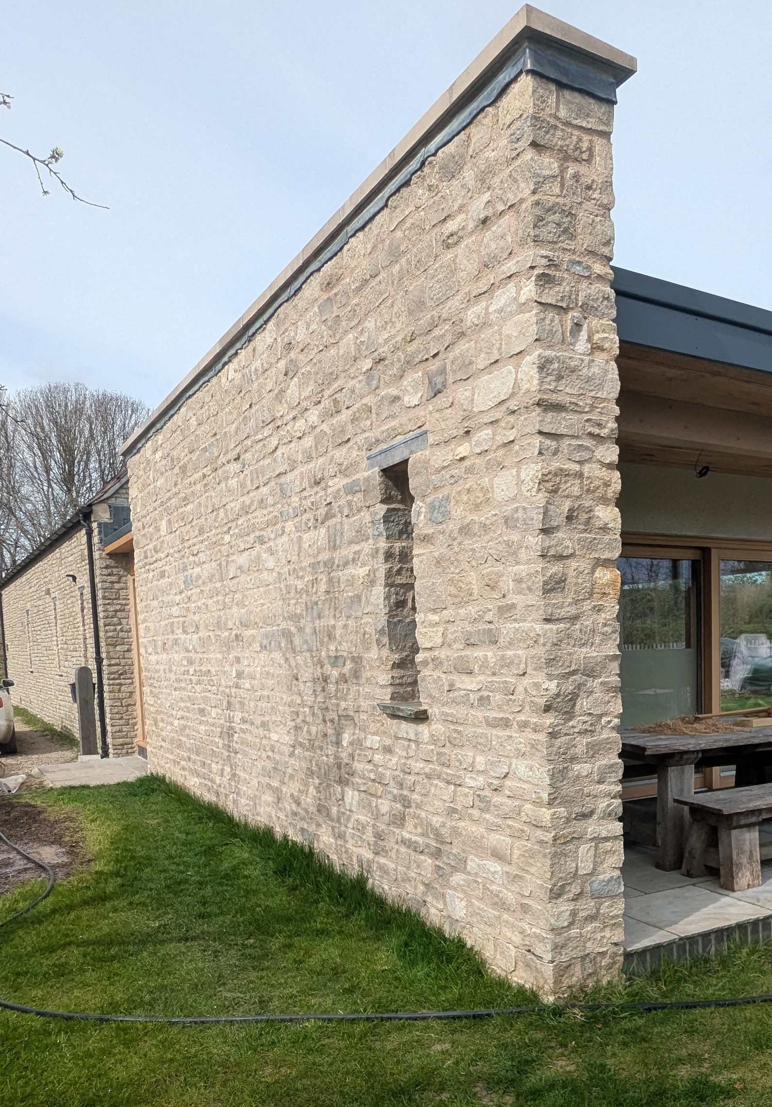

goodbyegti Posted April 7, 2025 Posted April 7, 2025 We used lime NHL 3 (otterbein), 1 part to 2 parts yellow sand and 1 part grit. It still looks great after a couple of years. It was hard getting a regular bricky to mix it properly. Luckily we found some good masons. You also have to beat it back at just the right time to pack it into the joint. I'd do it again! 2
Rishard Posted April 7, 2025 Posted April 7, 2025 (edited) Looks great! The stone here is very soft sand stone and would degrade even with an NHL. What is the brick you’re using? Edited April 7, 2025 by Rishard
goodbyegti Posted April 7, 2025 Posted April 7, 2025 Thanks! It's 125mm cropped Purbeck limestone and a bit of blue lias. Up against some Surecav except the end which is solid.

ToughButterCup Posted May 28, 2025 Posted May 28, 2025 On 07/04/2025 at 21:48, goodbyegti said: That is just beautiful. A real treat to the eye.
