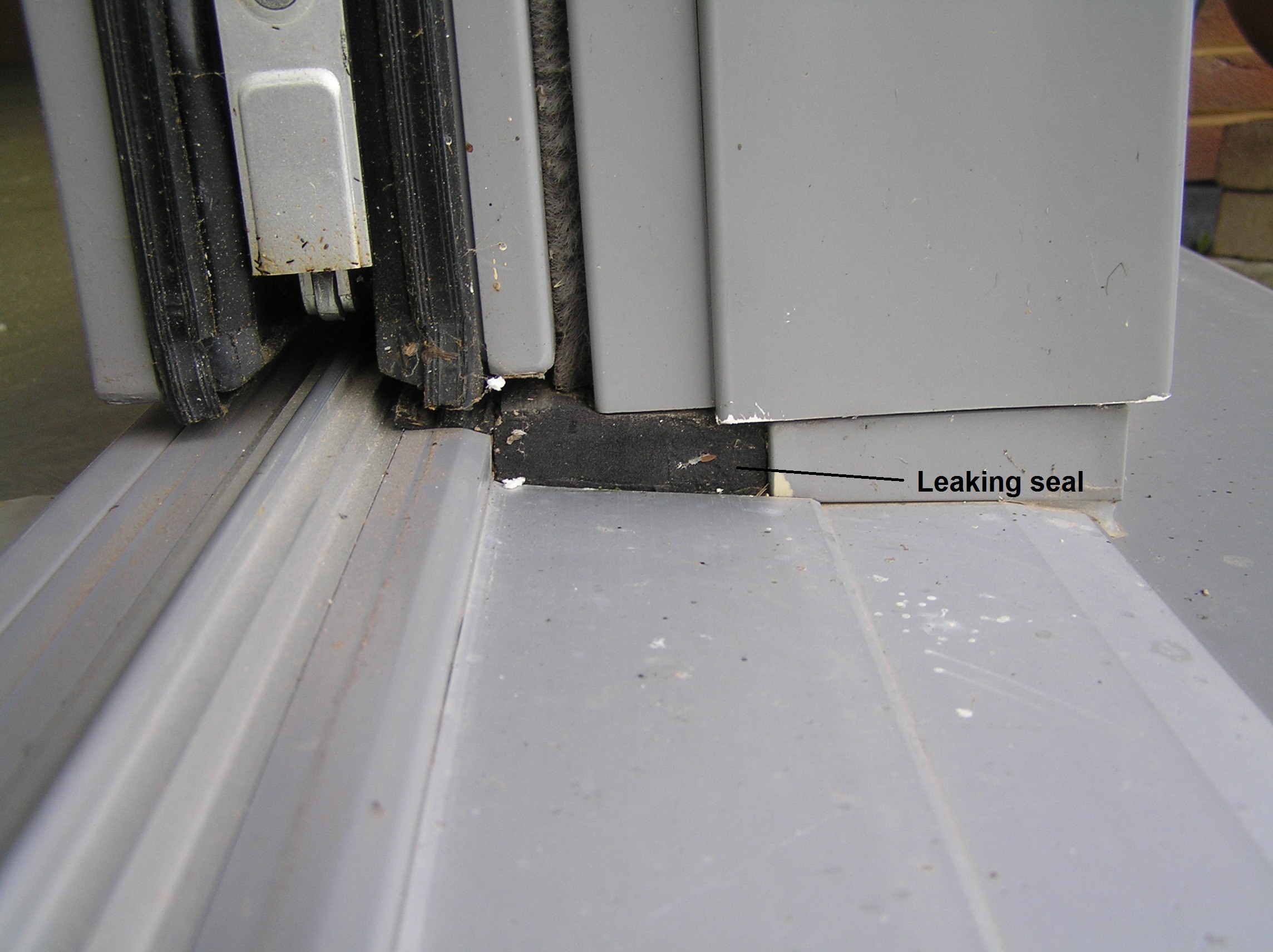

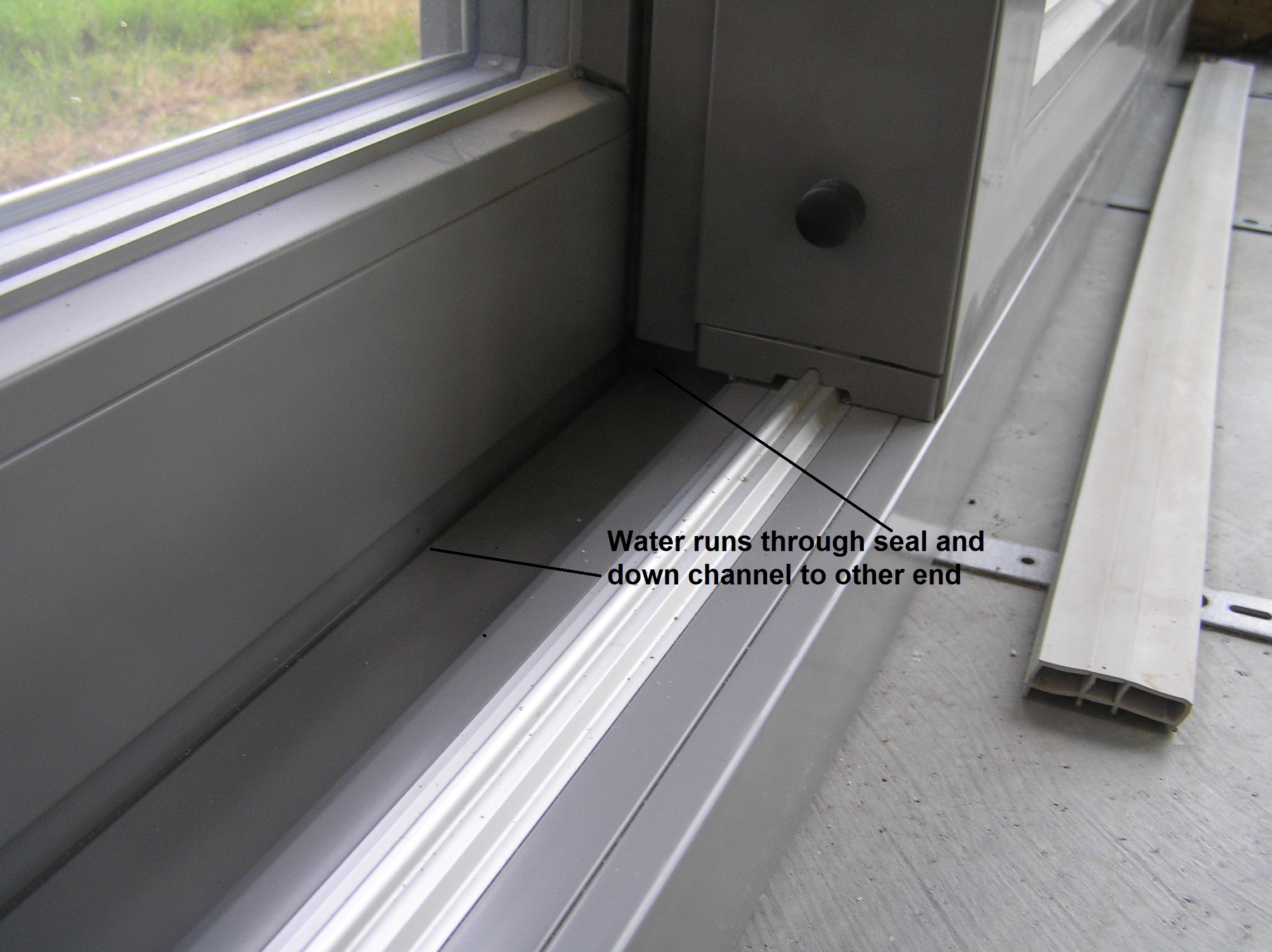

Our lift slide doors leaked for the first year and we thought the rain was coming in down the side of the frame. It wasn't, eventually we discovered it was leaking through the base seal where the doors overlap. These are the pictures provided to the suppliers.

The picture above looks like the detail of sliding door systems provided to many manufacturers from Seigena, very good systems. We have experienced similar issues in the past from non Austrian suppliers and replaced the foam pads and sealed it better. In newer models, this is no longer present.
A good way to determine where the water is actually penetrating, is the good old fashioned hose test.
